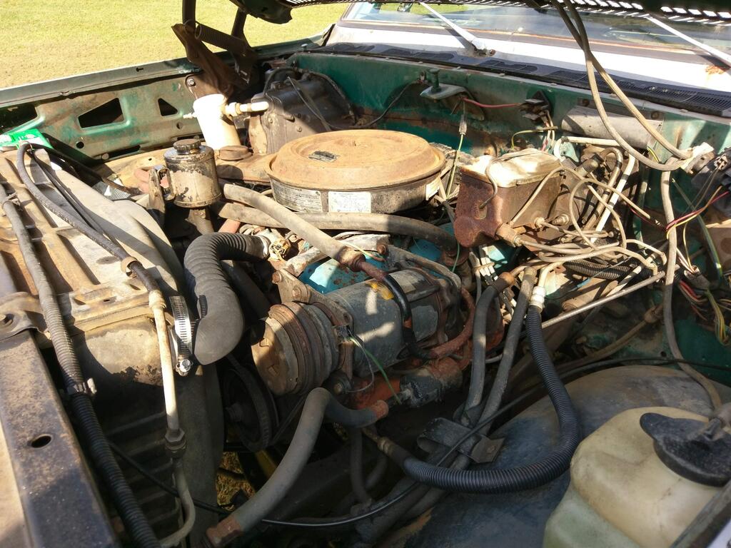

WVHillbilly520H 10,379 #8730 Posted January 17, 2021 1 hour ago, AHS said: Nice truck!! @WVHillbilly520H what’s it got? 350/ th400? A 4 speed manual? Factory 454 4spd with PTO Hydraulic bed, even had A/C Scottsdale pkg. 5 Share this post Link to post Share on other sites

AHS 1,701 #8732 Posted January 17, 2021 2 hours ago, WVHillbilly520H said: Factory 454 4spd with PTO Hydraulic bed, even had A/C Scottsdale pkg. What your saying is factory muscle and oodles of torque!! 💪💪 And a/c!! 😎 1 1 1 Share this post Link to post Share on other sites
WVHillbilly520H 10,379 #8733 Posted January 17, 2021 38 minutes ago, AHS said: What your saying is factory muscle and oodles of torque!! 💪💪 And a/c!! 😎 Yes sir, unfortunately the A/C was no longer working so off came 150#. Now it's 2 x 55 with those quarter wing vents and the one in the kick panel. 5 Share this post Link to post Share on other sites

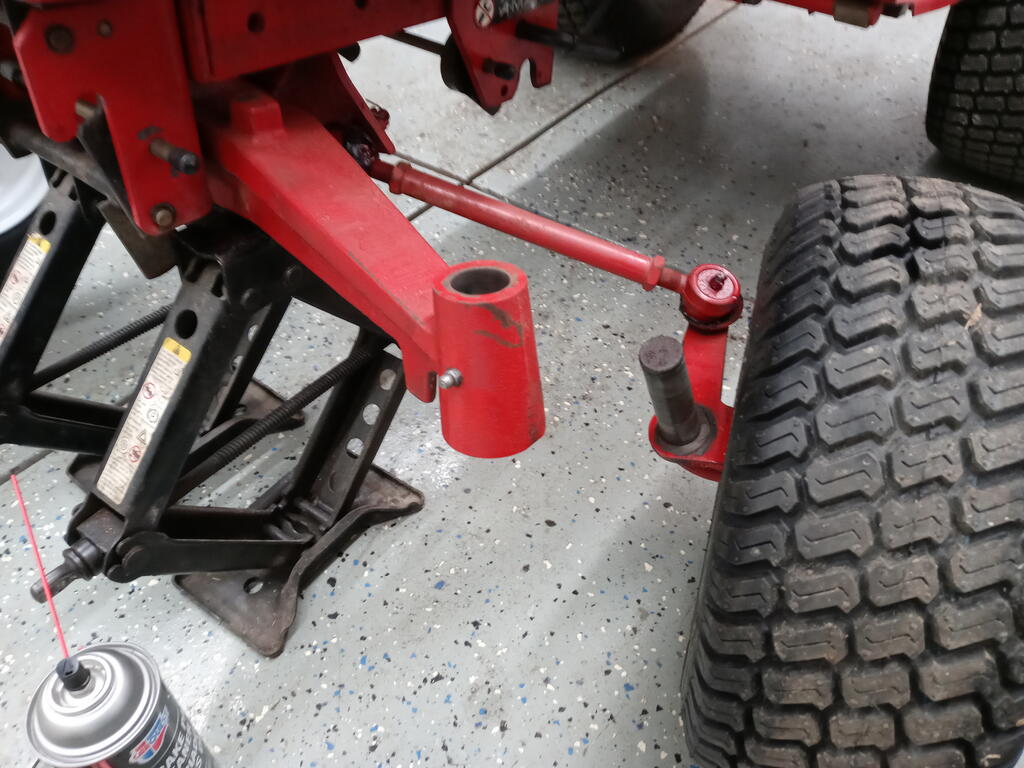

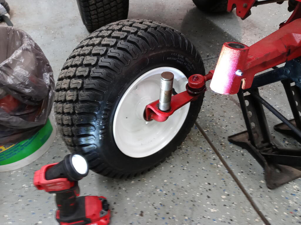

Horse Newbie 7,405 #8737 Posted January 18, 2021 (edited) Today I installed my thrust bearings that go between the axle and spindles on my 1994 520H... Ordered them from Lowell at "Wheel Horse Parts and More. Edited January 18, 2021 by Horse Newbie 5 4 Share this post Link to post Share on other sites
953 nut 69,696 #8738 Posted January 18, 2021 12 minutes ago, Horse Newbie said: I installed my thrust bearings that go bet ween the axle and spindles on my 1994 520H.. How much material did you have to remove from the axle to be able to put the snap rings back on the spindles? 2 Share this post Link to post Share on other sites

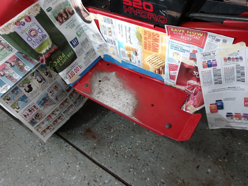

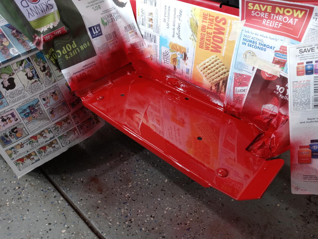

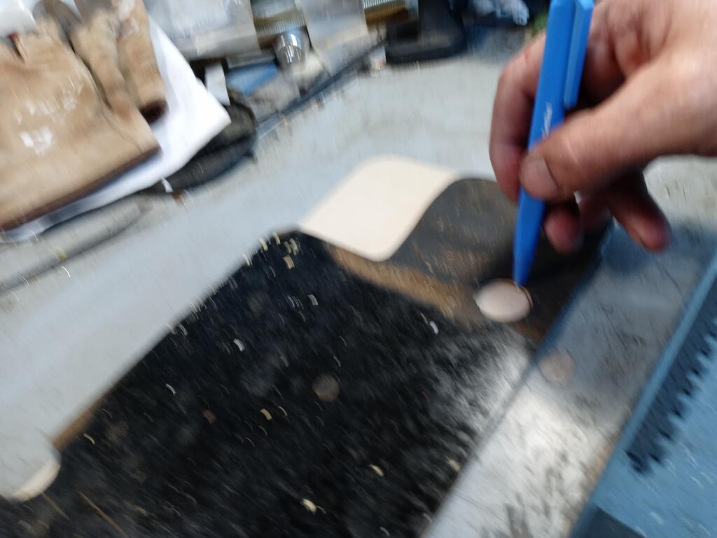

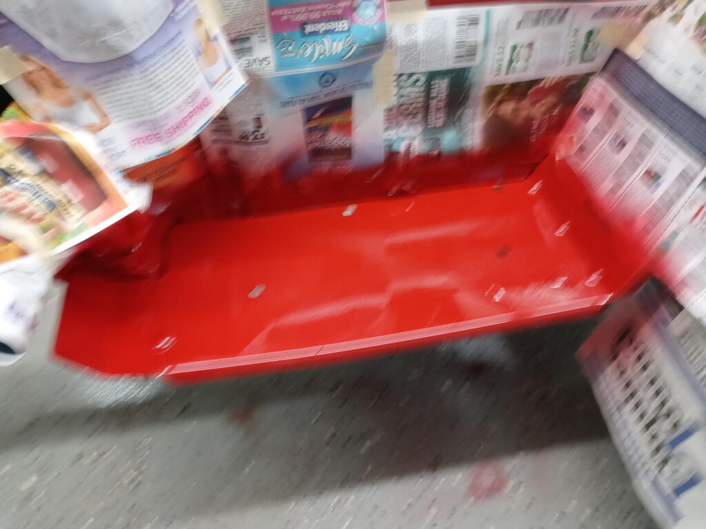

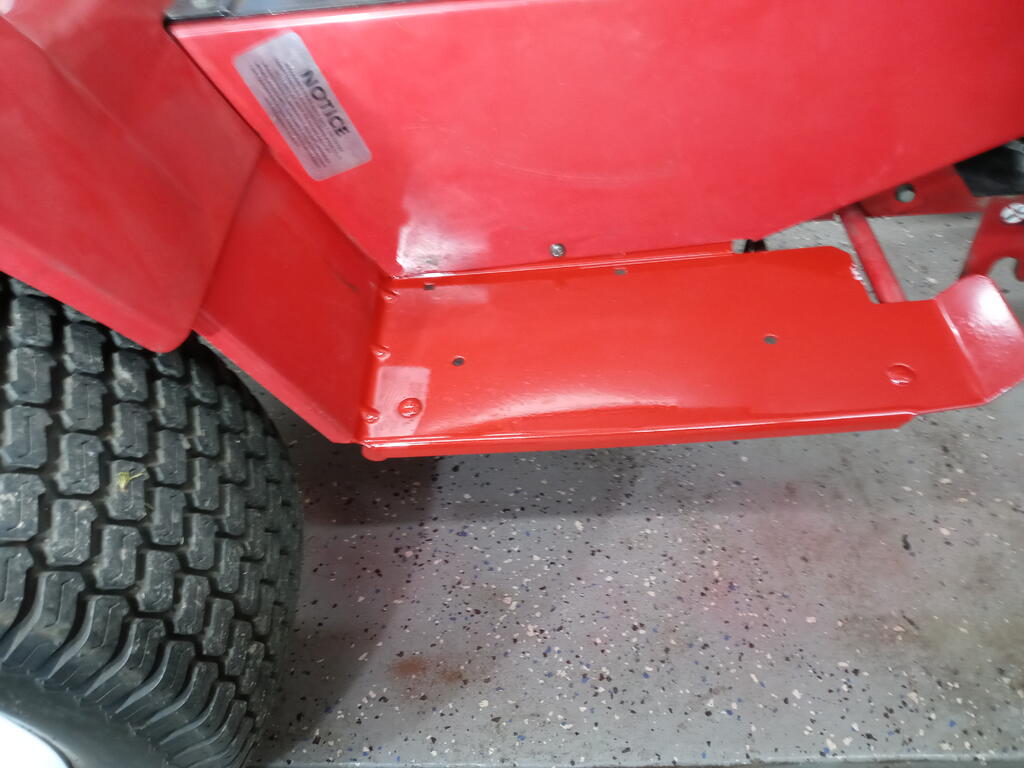

Horse Newbie 7,405 #8739 Posted January 18, 2021 Painted my footrests/ running boards on my 520H today, getting them ready for tread pads that I am making out of that "stick-on" sandpaper safety tread... Painted them Rustoleum Regal Red... 7 Share this post Link to post Share on other sites

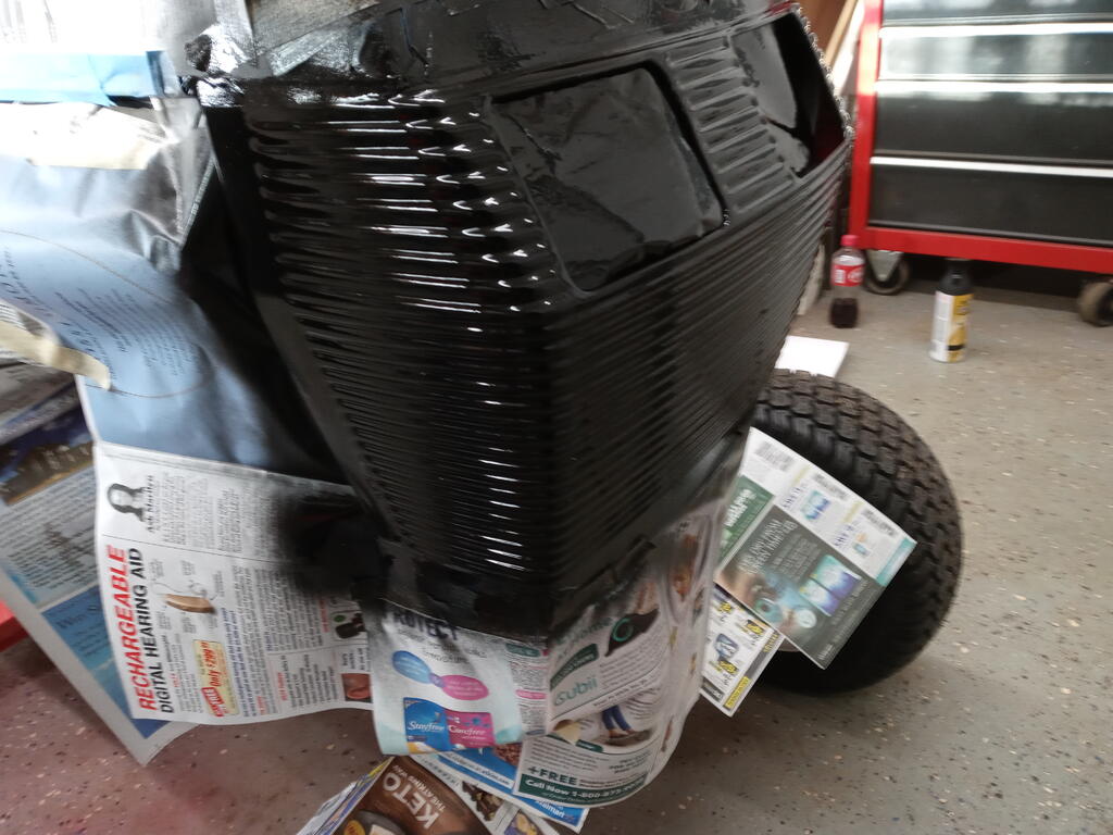

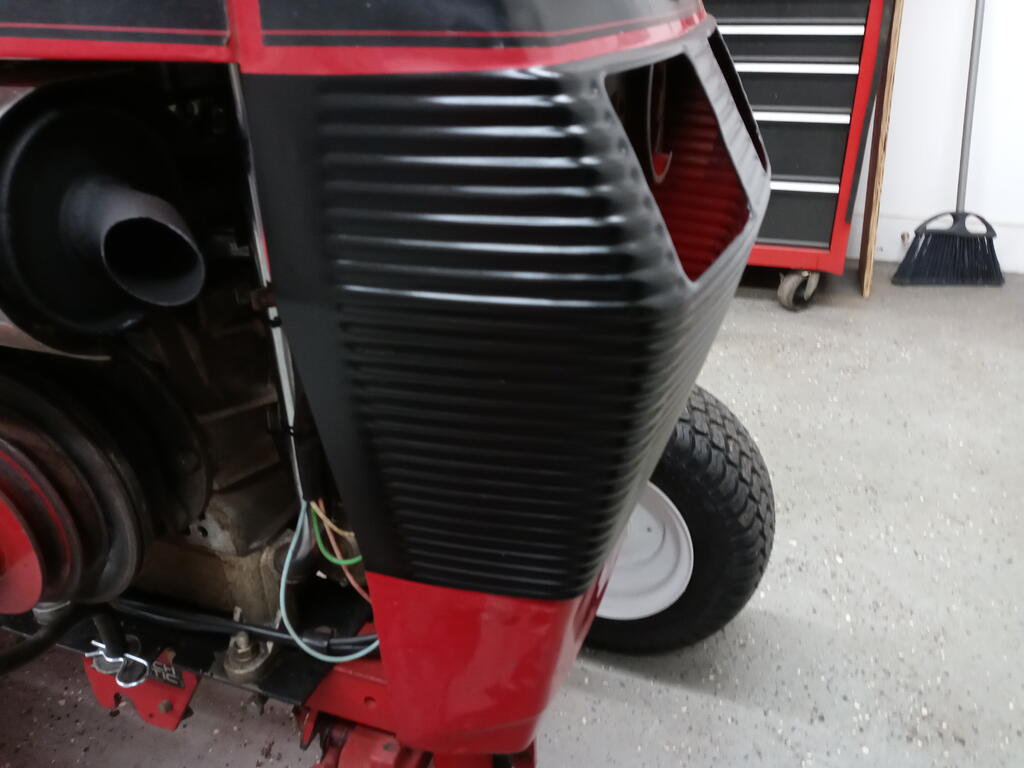

Horse Newbie 7,405 #8740 Posted January 18, 2021 Painted my grille and headlight bezels on my 1994 520H today...Rustoleum Black Satin... 9 2 Share this post Link to post Share on other sites
Horse Newbie 7,405 #8741 Posted January 18, 2021 10 minutes ago, 953 nut said: How much material did you have to remove from the axle to be able to put the snap rings back on the spindles? Do you mean crud in the groove ? Share this post Link to post Share on other sites

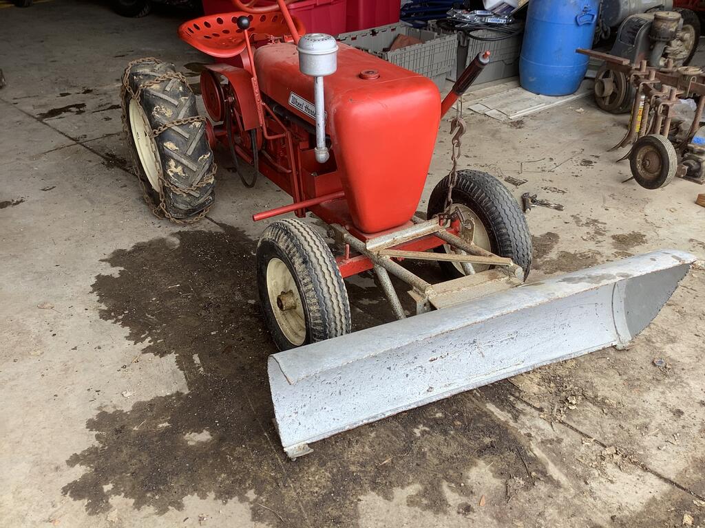

Pullstart 71,350 #8742 Posted January 18, 2021 I pushed a tiny bit of snow with Thirty Five and dragged in this 953 carcass too. That hand crank 24 hp. Kohler is destined to fit in there some day! 9 2 Share this post Link to post Share on other sites
WVHillbilly520H 10,379 #8743 Posted January 18, 2021 6 minutes ago, Horse Newbie said: Do you mean crud in the groove ? Usually one has to "grind" the top of the spindled housing to get the torrington bearings to fit and install the snap rings, not always but most times 3 Share this post Link to post Share on other sites

953 nut 69,696 #8746 Posted January 18, 2021 9 minutes ago, WVHillbilly520H said: Usually one has to "grind" the top of the spindled housing to get the torrington bearings to fit and install the snap rings, not always but most times That is why I asked, I had to remove about a 1/4" from the top with my bandsaw but didn't see any signs of that on his. 3 Share this post Link to post Share on other sites

WVHillbilly520H 10,379 #8748 Posted January 18, 2021 1 minute ago, 953 nut said: That is why I asked, I had to remove about a 1/4" from the top with my bandsaw but didn't see any signs of that on his. My 2 don't have the bearings but there's at least 1/16 -3/32" play to the snap rings. 2 Share this post Link to post Share on other sites
Handy Don 17,531 #8749 Posted January 18, 2021 18 minutes ago, 953 nut said: That is why I asked, I had to remove about a 1/4" from the top with my bandsaw but didn't see any signs of that on his. Whew! Glad that was already done by @Pilgrim when he sold me the 520 chassis as a roller! Share this post Link to post Share on other sites

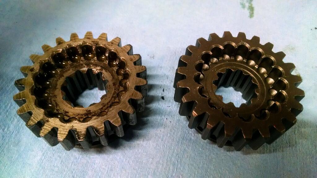

Achto 32,816 #8750 Posted January 18, 2021 (edited) I brought Radpferd in for some surgery today. I went through the transmission when I built him and thought that the gears look ok but obviously I thought wrong. With in the first 10hrs of run time he started rejecting 3rd gear. When ever I would pull on the throttle it would jump out of 3rd. I've had the parts to fix it since Jim's plow day this year but have been too busy to fix the issue. Today, after I disassembled the tranny I see that the 2nd/3rd gear has gotten much worse. The old one next to the new one for comparison. I also noticed that the gear on the input shaft had suffered some damage. After digging through my 5gal pail full of tranny gears, I was lucky enough to find a good input shaft. The one on the right is the one that was in my tranny. The first test ride after reassembly was very satisfactory. While in 3rd I worked the throttle from idle to wide open several times and the shifter stayed right where it belonged. Edited January 18, 2021 by Achto 3 5 Share this post Link to post Share on other sites
