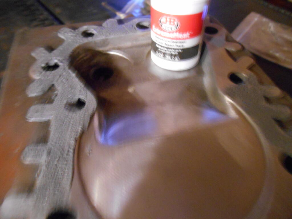

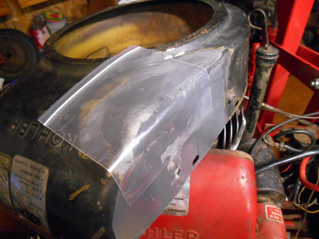

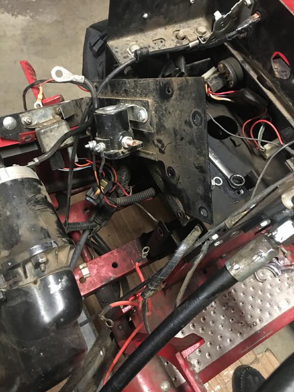

ohiofarmer 3,504 #7953 Posted November 26, 2020 (edited) I solved some important wiring issues. The Switch on one C-145 was a four position and somehow the starter circuit did not work, Put on the correct three position one and we are happy now. The previous owner was so frustrated with the problem he let it go really cheap. We are moving the coil an both of these 145s. The old coil tore out the engine cowl, so now the coli is mounted at the back of the engine as I have seen on some of the herd. Got two cowlings about finished with JB Weld. Like it never happened. Trying to fill in some pits in the head area. Using ultra high temp JB weld that the company website says works on aluminium. We'll see how it comes along, but i am optimistic as it is rated for 1500 degrees i think.. Anyway, I am workig on three--soon to be four tractors at once. I can snag one and spin it on a dime with the mobile 4 wheel mini lift., so it takes the cramp out of a small shop space and really saves my back You guys have a nice Thanksgiving. Mrs Farmer and I are gonna chill at home as covid rate is pretty high. The people are surviving at a higher rate, but a guy down the road really had a scare, and now his wife is infected. They are only in mid thirties.. Well, back to the tractors....The ultra high heat JB Weld is a water based product that hardens in air. It is also grainy, but we will see if it sands down well enough to fill the pitting and be ood enough for a gasket. Also shown is my sandwich bag trick with the regular JB. This is the third coat and it skims on really nice. All I had was a credit card that expired, and i used the plastic sandwich bag to smooth over the corner with my finger on the clean side of the bag. It works well to get it really close. It will be ready for final sanding tomorrow. Edited November 26, 2020 by ohiofarmer 7 Share this post Link to post Share on other sites

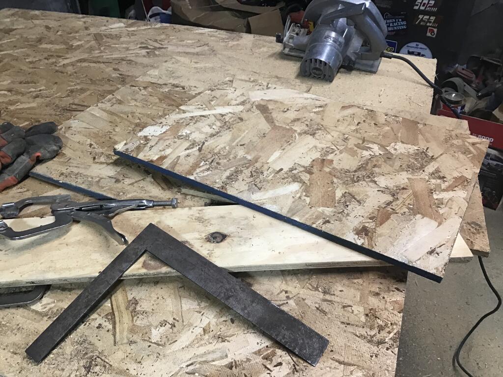

Pullstart 71,350 #7964 Posted November 27, 2020 Popped the hydro out of “Filly” tonight. Tossed a 3 speed on for mobility. Plaid with some osb for a bit. 3 1 Share this post Link to post Share on other sites

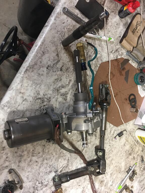

KrazeyOlDave 860 #7973 Posted November 27, 2020 And so it begins, power steering unit fits IF you remove everything on the firewall first, blah. Hopefully y’all had an excellent thanksgiving! 2 Share this post Link to post Share on other sites

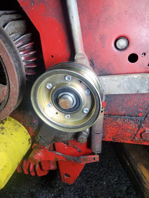

Jhook 849 #7975 Posted November 28, 2020 New idler pulley today from tractor supply. I have the toro part on order but need the machine moveable this weekend. Bought a new 5/8x84 belt as well. Thats what came off the tractor not sure if its original size as the motors been swapped. Well when the toro pulley arrives i may swap it on but i will try the tsc pulley, itll be nice to know if parts i can buy in store 5 mins away work well or not. 3 Share this post Link to post Share on other sites
