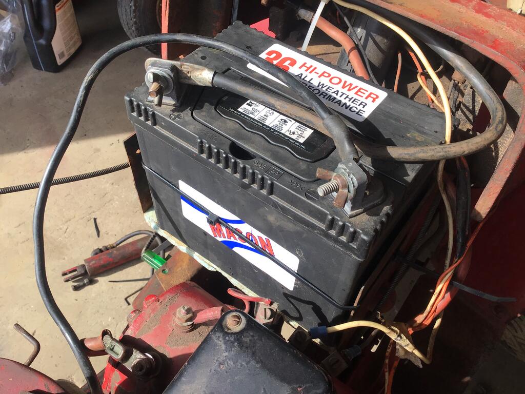

Pullstart 71,160 #7056 Posted October 13, 2020 Went to the Squonk’s School of Hard Knock Zip Ties today. Battery hold down? Check! 1 1 Share this post Link to post Share on other sites

ebinmaine 80,463 #7058 Posted October 13, 2020 45 minutes ago, pullstart said: Went to the Squonk’s School of Hard Knock Zip Ties today. Battery hold down? Check! Nice color match too 1 Share this post Link to post Share on other sites

Pullstart 71,160 #7060 Posted October 13, 2020 18 minutes ago, ebinmaine said: Nice color match too ‘Parently they last longer that way! 1 Share this post Link to post Share on other sites

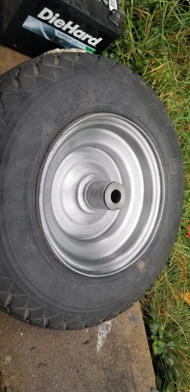

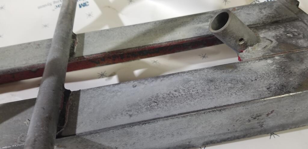

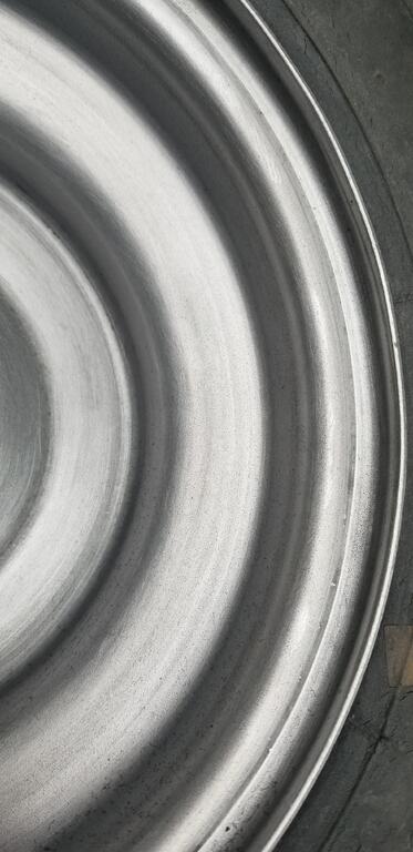

AMC RULES 37,259 #7064 Posted October 13, 2020 Made some more progress today with my current RJ resto. Thinking this stuff is almost clean enough to paint now. 5 2 Share this post Link to post Share on other sites

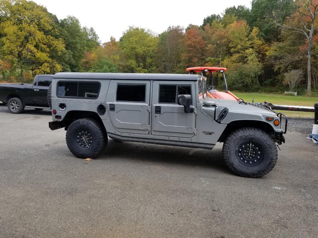

Shed 377 #7066 Posted October 13, 2020 Well it's not a wheel horse but it will find a few wheel horse projects I sold my 1998 hummer after 17 years of owning it 4 1 Share this post Link to post Share on other sites
peter lena 10,030 #7067 Posted October 13, 2020 ebinmaine , noting your battery hold down issue , get a door stop spring , slide it into a similar piece of hose , find a pull point behind dash , put a hook on the other end and hook up under battery tray , battery is secure , pete 1 Share this post Link to post Share on other sites
8ntruck 9,246 #7068 Posted October 13, 2020 55 minutes ago, Shed said: Well it's not a wheel horse but it will find a few wheel horse projects I sold my 1998 hummer after 17 years of owning it Wow. Remote tire pressure rig with run flats. The company I retired from did the development on those wheels. My desk was only a couple of desks away from the two engineers who were working on that project. Had several discussions about the computer stress analysis with one of them. 1 1 Share this post Link to post Share on other sites

Shed 377 #7071 Posted October 14, 2020 1 hour ago, 8ntruck said: Wow. Remote tire pressure rig with run flats. The company I retired from did the development on those wheels. My desk was only a couple of desks away from the two engineers who were working on that project. Had several discussions about the computer stress analysis with one of them. That's pretty awesome I dont have the run flats they weren't the best just an inner lock ring. But these rims are the best the aluminum ones were really impressive dot approved bead locks The air system the military still use on a lot of their vehicles. But that must have been a fun place to work making stuff like that. I just bill people for damaging state property 1 Share this post Link to post Share on other sites
8ntruck 9,246 #7072 Posted October 14, 2020 1 hour ago, Shed said: That's pretty awesome I dont have the run flats they weren't the best just an inner lock ring. But these rims are the best the aluminum ones were really impressive dot approved bead locks The air system the military still use on a lot of their vehicles. But that must have been a fun place to work making stuff like that. I just bill people for damaging state property We were a supplier to AM General. The AM General folks did the field testing. Would did lab testing. One of the engineers working on the Hummer also had a similar run flat/central pressure comtrol project going for the 5 ton 6x6 trucks. He did get an invite to a test session in the sand dunes on the shore of Lake Michigan. He has a picture of one of the trucks at the crest of a dune with the front wheels in the air - not because of the speed, but because of the full load in the truck and the grade of the dune. 1 Share this post Link to post Share on other sites

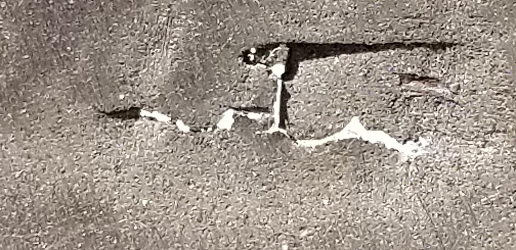

AMC RULES 37,259 #7074 Posted October 14, 2020 Sometimes I'd rather just not know. 3 2 Share this post Link to post Share on other sites
johnnymag3 2,646 #7075 Posted October 14, 2020 A case of judging a book by the cover I'd say...... It will be all purty when you are finished... John Share this post Link to post Share on other sites
