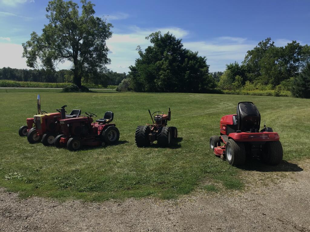

JCM 11,451 #6357 Posted August 31, 2020 Still have a small list of items to take care of on the 420 but those may have to wait until spring, time to have some fun with it. The grassy area behind the tractor is where we line up the WH's for the Meet. Started cleaning up the footrests on the 418-A, will recycle the footrest pads from the 420 and install them on the 418. Not sure if those will get done by the 12 th for the Meet, will trail ride it without them anyway. Patti and I did get the Porch/ Addition ready for the food area and beverages. Nice area in case the weather changes, a place to stay dry and have lunch etc. 5 8 4 Share this post Link to post Share on other sites

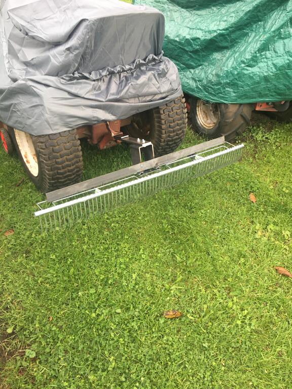

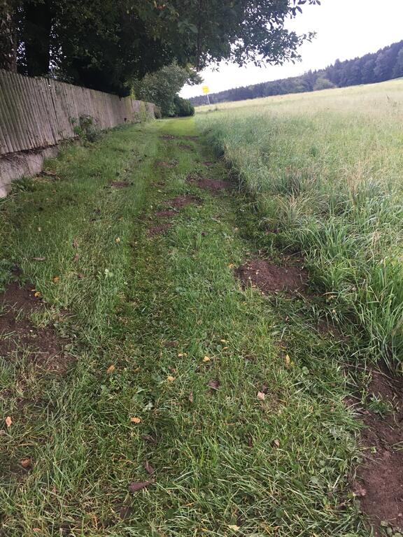

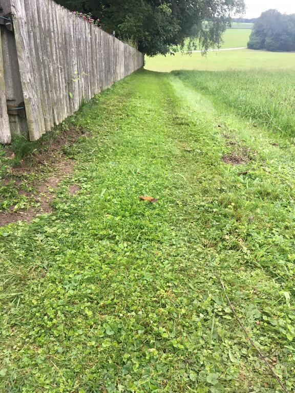

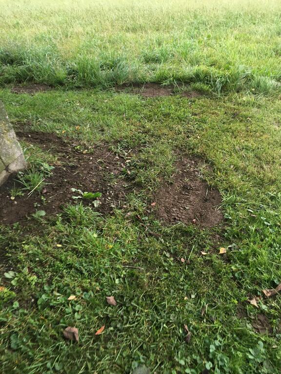

Tractorhead 9,218 #6359 Posted September 1, 2020 After several Day‘s of Rain some Moles arround the Property diggin hardly, some of that hill‘s reached 30cm in height. While i don’t wanna Mow over that molehills, or use the Deck as a Graderblade, i decide to build a pulled Rake to flatened the Molehills before mowing. So i fired up the Welder and build fix a quickmount Rake, i hoped this will do the Job. That‘s my first self building implement i built exclusiv for my 656 Horse. For the Construction i use a 5x 30 cm long flat Steel 10mm thick with an added 5 mm Topper, all that Material i had laying arround here, than i drilled few Holes in it to build a quick screwed mount. Than i build a Mounting Fork, what is directly Welded onto a Angle iron 5 by5 cm 1 meter wide. The Fork was built from a rect. Steelpipe with 10x6 cm 8 cm in height and 5mm thick where i cut one sidewall. - that should last 2 cheap hand Rakes will be sacrificed and simply bolted on, so in case of a damage i‘m able to fix it simply by screwing. on the undersite of the Angle iron i welded few Screws for the rake Attachement but that can be exchanged with some other implements, if i may have a need for. Screwed and bolted all together And while no rain occurs until, i give it a Try... and hoped i wan‘t blame myself with that construction. I love it when things work as expected - It seems it do it‘s job pretty well. it levels the hills straight and the grass is much higher than the hill‘s was before -> for me it’s a success. Even on the slopes it was just pure Fun to work with. The result is deeper as the cutting line. so if i first ride with the rake, i can after that mow without touching the Molehill‘s and saves a lot of resharpening time and even Blades. 3 9 1 Share this post Link to post Share on other sites

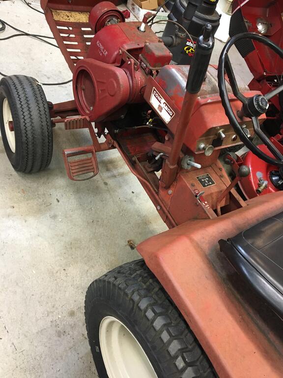

WHX?? 58,347 #6362 Posted September 2, 2020 (edited) Worked the brown welded foot rest on the 701. Went thru a full MC bottle of acetylene. Those tote torches are nice but doesn't take long to whiz thru bottles when the cutting tip is used. Some day I'll gradeate to big bottles. Anyhoo got it to swing almost full around and verify the snapped off hoobie doo is not holding it anymore. Letting penetrants work their magic for abit. Then on to the collar and clutch pedal. Yes @Achto I when I burned the moss off! Edited September 2, 2020 by WHX24 5 1 1 Share this post Link to post Share on other sites
Racinbob 13,286 #6363 Posted September 2, 2020 Unfortunately Jim, I think you'll find the hoobie doo is still gonna fight you. You've worn a groove around the rod. Now ya gotta get that groove to the end of the rod. Attempting that is what caused the demise of my footrest. Of course I had a happy ending when you were so kind to send me a replacement. 1 Share this post Link to post Share on other sites
953 nut 70,384 #6364 Posted September 2, 2020 10 hours ago, WHX24 said: Those tote torches are nice but doesn't take long to whiz thru bottles when the cutting tip is used. Some day I'll gradeate to big bottles. With the cost of refilling those little suckers the larger ones will pay for themselves. 4 Share this post Link to post Share on other sites
WHX?? 58,347 #6365 Posted September 2, 2020 (edited) 11 hours ago, Racinbob said: get that groove to the end of the rod. Agreed, Plan is to shim a bearing collar on it and pull it off... somehow.... ain't got that far yet... one battle at a time to win the war! But yeah these rests are cast and yes you know how cast breaks! Finding out this style, which is my favorite, are getting hard to find. Dan @Achto says he has an extra but doesn't know if his boot is on his left or right foot! May have to drill the hoobie hole larger and eventually re-tap to 3/8-16. Original these foot rests have 5/16 hoobies. Won't be correct but whose gonna complain! 1 hour ago, 953 nut said: cost of refilling those little suckers Not too bad 20 for the ac and 10 for the O2 & my company pays for it! Edited September 2, 2020 by WHX24 1 3 Share this post Link to post Share on other sites
Racinbob 13,286 #6366 Posted September 2, 2020 Good luck. That style is definitely getting hard to find. I'm sure you'll figure out a way. I could suggest my method but we know how that turned out. 1 Share this post Link to post Share on other sites

Achto 32,932 #6371 Posted September 2, 2020 26 minutes ago, WHX24 said: Agreed, Plan is to shim a bearing collar on it and pull it off... somehow.... ain't got that far yet... one battle at a time to win the war! Stop messing around! First suck down a couple of mixers so is you can see strait. Grab a 1/4" drill bit, a drill and drill that little PITA out. If your aim is true on the hole you will be able to run a 5/16" tap through the hole to clean the threads back out to the correct size. This is how I would handle the sitch. 2 1 2 Share this post Link to post Share on other sites
WHX?? 58,347 #6372 Posted September 2, 2020 2 minutes ago, Achto said: If your aim is true In my dreams! 1 Share this post Link to post Share on other sites
Racinbob 13,286 #6373 Posted September 2, 2020 If you'll remember Jim, I picked up a pair of those at the 2018 show. One of them had a sheared bolt stuck in it. I used Dan's method and it worked out good. I'm sure my aim wasn't perfect but I'm not sure it has to be. Your problem might be that it's stuck on a shaft and I was able to drill through. 1 1 Share this post Link to post Share on other sites
