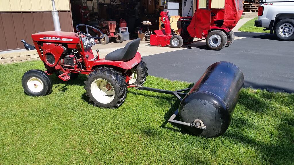

WHX?? 58,347 #6326 Posted August 29, 2020 (edited) 3 hours ago, ebinmaine said: You got a specific procedure there Jimbo? That's looks slick as.... Slick things.... Nope ... just polished the snot out of it and cc it. Was on the fence about cc when I did it. About 3 layers. Some guys here said yes some said no but after the effort in polishing I had in it was afraid of oxidation. Kinda like AL rims on a car. Granted this gal does not see road salt but she is a worker and gets regular baths. Wished I had a can of the Eastwood product when I did it tho. Pulling Dan's lawn roller. @dclarke Edited August 29, 2020 by WHX24 4 5 Share this post Link to post Share on other sites
953 nut 70,384 #6327 Posted August 29, 2020 11 hours ago, WHX24 said: Wished I had a can of the Eastwood product when I did it tho Good stuff. I have done Craigs trick on wheels, spray the color and go right over it with the Eastwood Diamond Clear. Very good results. 1 Share this post Link to post Share on other sites
19richie66 17,950 #6328 Posted August 29, 2020 12 hours ago, WHX24 said: Pulling Dan's lawn roller. @dclarke I need a roller like that 👍 3 Share this post Link to post Share on other sites

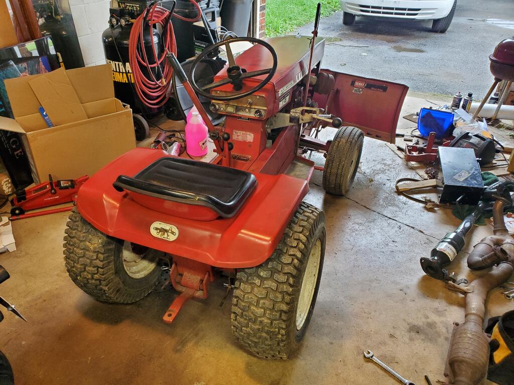

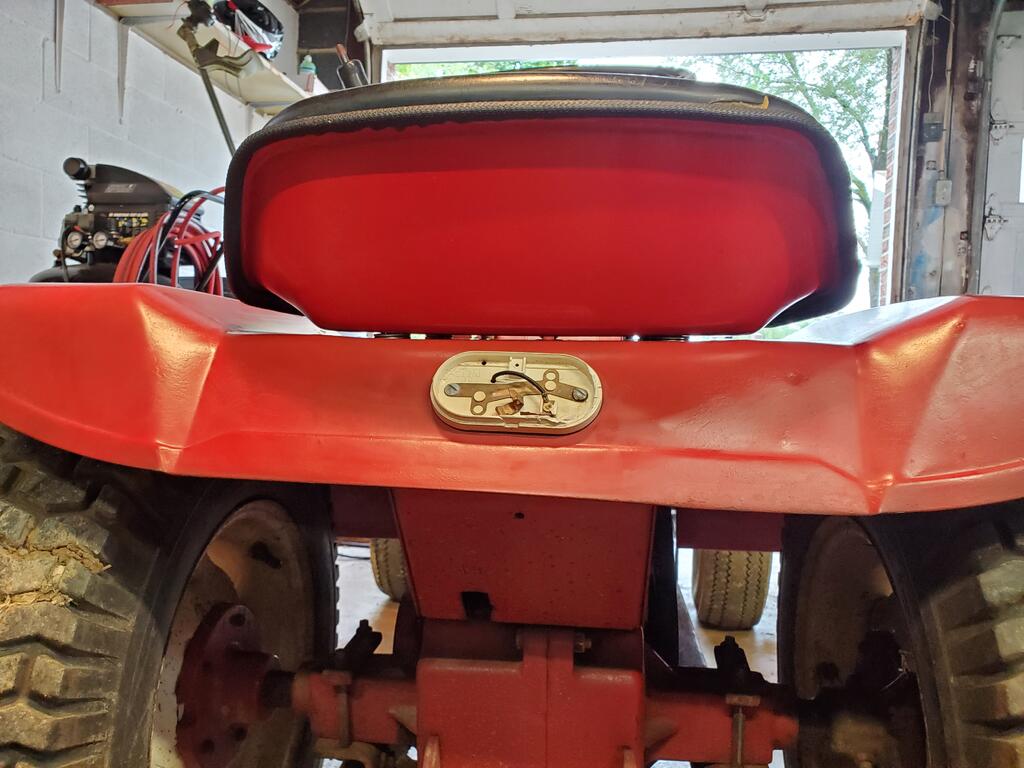

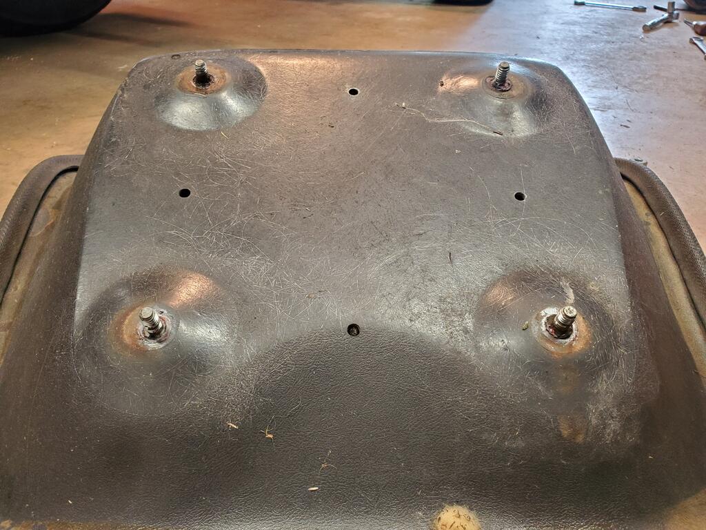

ArturHawk 195 #6329 Posted August 29, 2020 Had a belt noise on the Raider 10. Turns out the guard slid down a little bit and was rubbing on the top of the belt between engine and clutch pulley. Fortunately, it didn't hurt the new belt too bad...just a little bit of fraying on the seams. While I had the horse in the stable, I decided to swap seats. The old one had studs in the bottom and cups to keep it raised off the fender. Replacement didn't, so I added a couple washers to maintain clearance. Don't want anything trapped in there! I was skeptical reading that IH red was a good match for us, but I think it turned out pretty good. 7 3 Share this post Link to post Share on other sites
AMC RULES 37,260 #6330 Posted August 29, 2020 No doubt... same color they left the factory. 1 Share this post Link to post Share on other sites

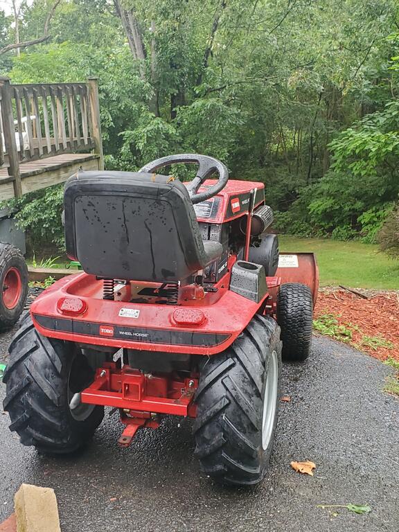

Jhook 849 #6331 Posted August 29, 2020 Well ags are on! Running 20 psi non loaded just air. Whats everyone else running for pressure? 1 Share this post Link to post Share on other sites
ebinmaine 81,164 #6332 Posted August 29, 2020 3 minutes ago, Jhook said: Whats everyone else running for pressure? Ours are around 8 rear, 10 to 12 front on air filled tires. 2 Share this post Link to post Share on other sites
WHX?? 58,347 #6333 Posted August 30, 2020 I would cut that back to 10 to 14 jhook depending what ply they are. Guessing just 4 but anything more you can durn near run them flat! 1 Share this post Link to post Share on other sites

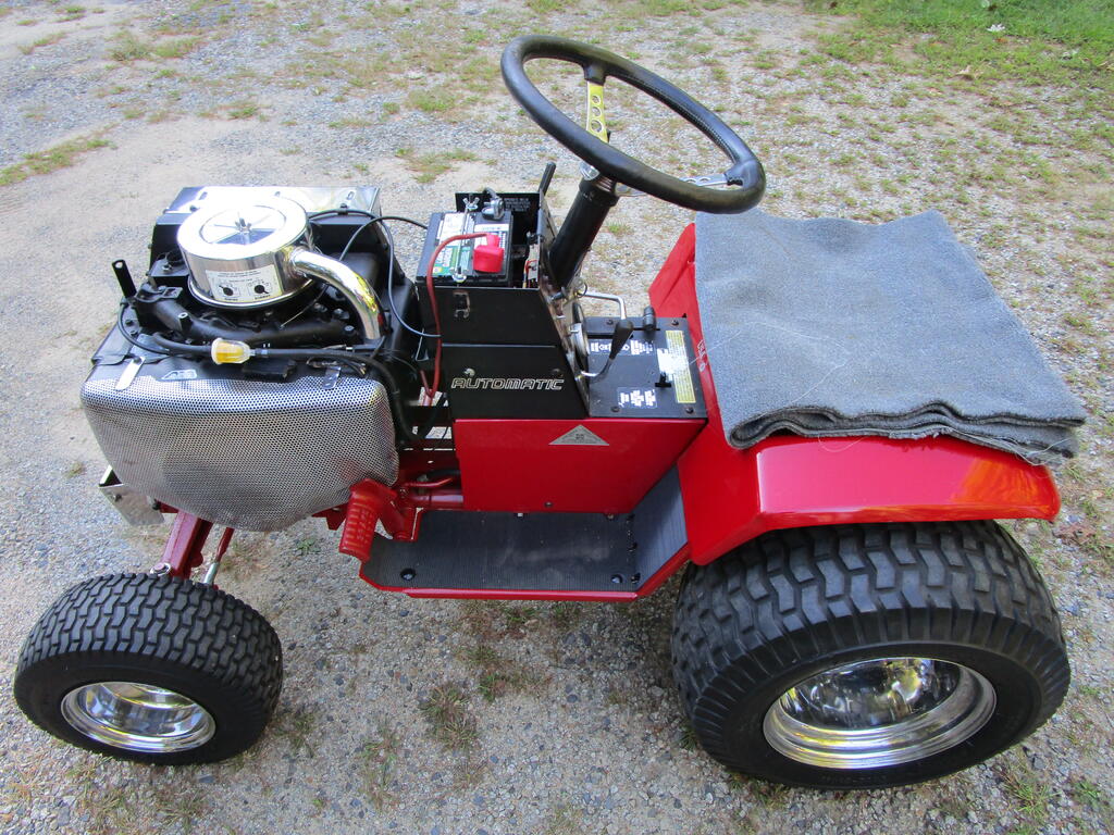

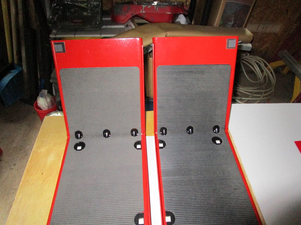

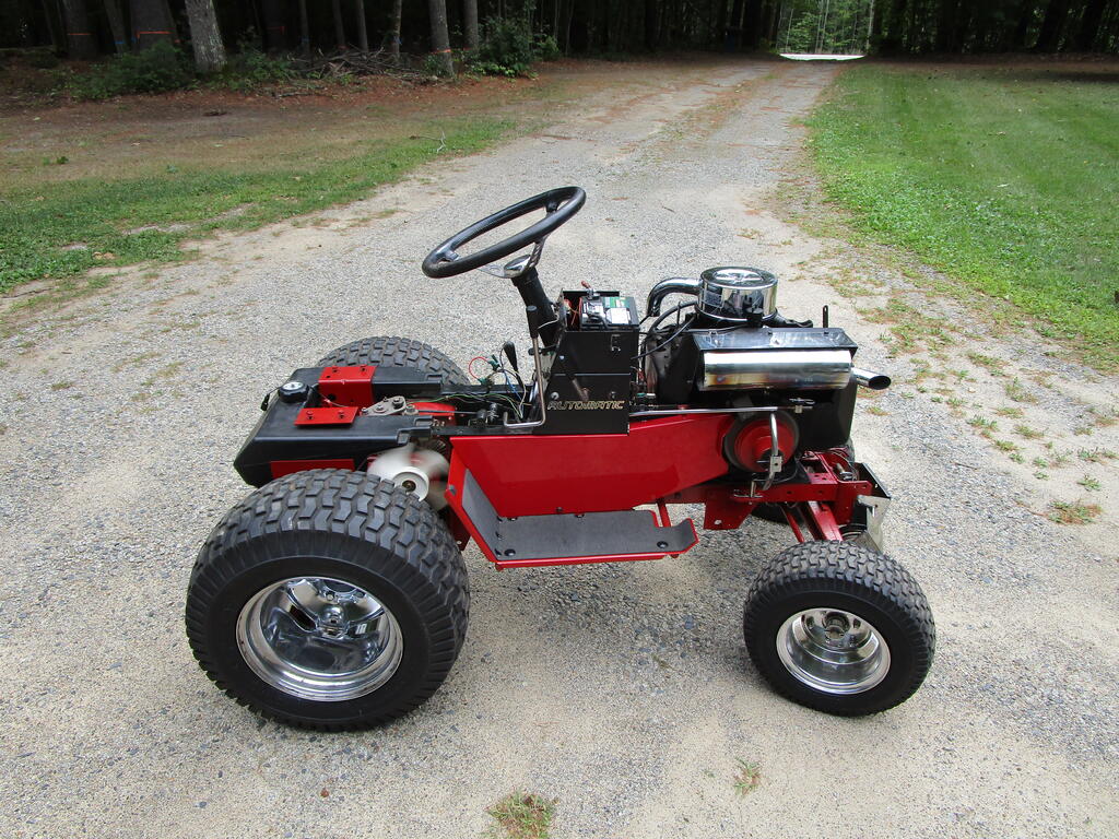

JCM 11,451 #6337 Posted August 31, 2020 Yesterdays accomplishments. Finished the footrests and proceeded to put things back together and go for a test ride complete with marine grade carpet seat. Those twin Kohlers have a sound of their own. 6 8 5 Share this post Link to post Share on other sites
ebinmaine 81,164 #6338 Posted August 31, 2020 1 minute ago, JCM said: marine grade carpet seat That's awesome. May need to permanently employ that on another ride. Seriously though.... That tractor is beeeyooootiful... 1 Share this post Link to post Share on other sites

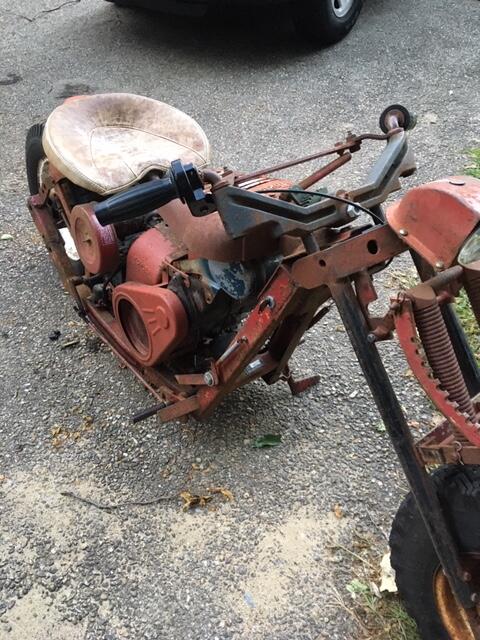

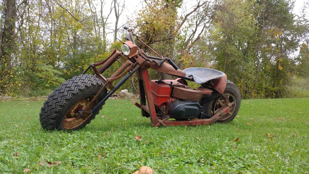

wallfish 20,737 #6341 Posted August 31, 2020 Did a new throttle for the WH bike, new starter belt, fixed the choke cable connection, carb clean and she fired right up. Looking forward to the M&G up in Maine. 3 8 1 2 Share this post Link to post Share on other sites
sqrlgtr 4,187 #6342 Posted August 31, 2020 6 minutes ago, wallfish said: Did a new throttle for the WH bike, new starter belt, fixed the choke cable connection, carb clean and she fired right up. Looking forward to the M&G up in Maine. got anymore pics of wh bike?? 1 Share this post Link to post Share on other sites

wallfish 20,737 #6344 Posted August 31, 2020 5 hours ago, sqrlgtr said: got anymore pics of wh bike?? Here's an old video and pic taken for LaGT magazine. Bunch of pics in the big show threads and did a build thread when it was made. Use the search feature and type "tractor Bike". Should show some more. 4 1 Share this post Link to post Share on other sites

sqrlgtr 4,187 #6346 Posted August 31, 2020 6 hours ago, wallfish said: Did a new throttle for the WH bike, new starter belt, fixed the choke cable connection, carb clean and she fired right up. Looking forward to the M&G up in Maine. got anymore pics of wh bike?? Share this post Link to post Share on other sites
sqrlgtr 4,187 #6347 Posted August 31, 2020 COOL thanks wall.... 1 Share this post Link to post Share on other sites
wallfish 20,737 #6348 Posted August 31, 2020 37 minutes ago, Sparky said: Umm...John, I didn’t read that you gassed it up ...I know how all your stuff seems to be running on fumes Umm, the plan was to let you ride it way out on the trail but ya caught me, again. Guess I'll have to fill'er up and tighten the plug now. Maybe next time 6 Share this post Link to post Share on other sites
Tractorhead 9,218 #6349 Posted August 31, 2020 Love that bike👍 Share this post Link to post Share on other sites
