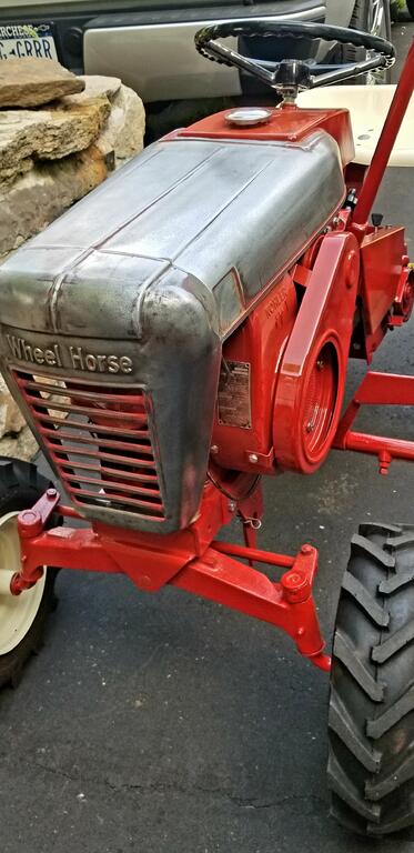

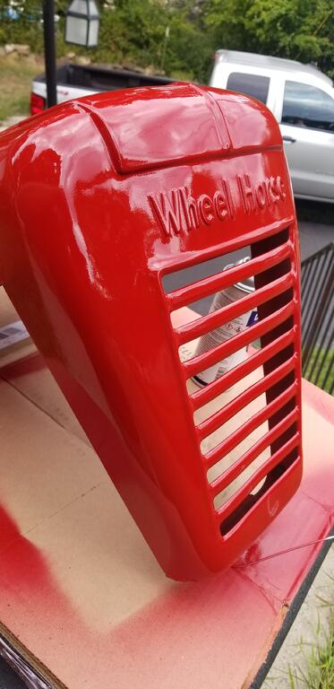

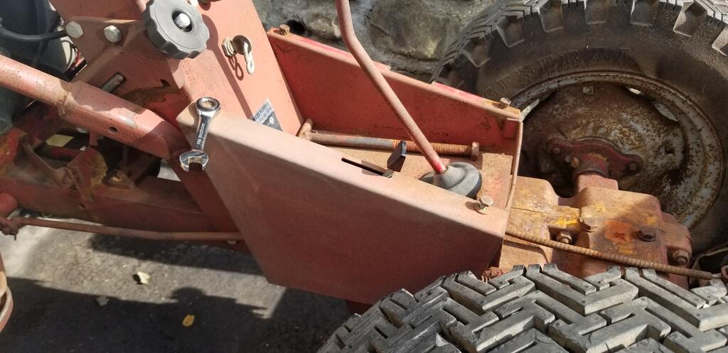

AMC RULES 37,260 #6277 Posted August 27, 2020 Went from this... to this today. 13 1 Share this post Link to post Share on other sites
johnnymag3 2,646 #6278 Posted August 27, 2020 (edited) Looks like a bent rim....axle looks to be intact and straight....gotta go for the good !!! Edited August 27, 2020 by johnnymag3 Share this post Link to post Share on other sites

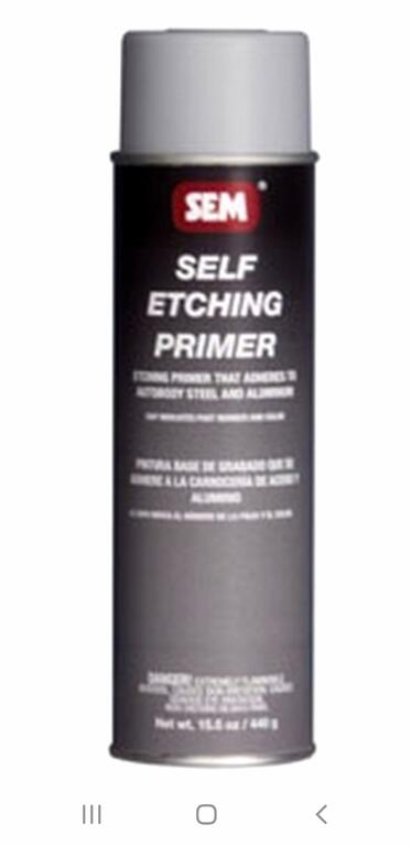

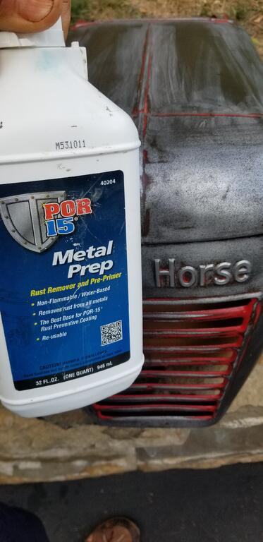

AMC RULES 37,260 #6284 Posted August 28, 2020 16 hours ago, AMC RULES said: Went from this... to this today. With this step inbetween. 3 1 Share this post Link to post Share on other sites

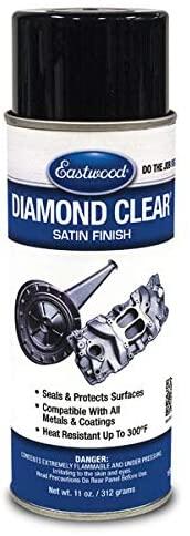

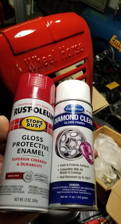

AMC RULES 37,260 #6285 Posted August 28, 2020 8 hours ago, D_Mac said: @AMC RULES Curious to know what kind of paint you are using. 3 2 Share this post Link to post Share on other sites
ebinmaine 81,164 #6286 Posted August 28, 2020 @AMC RULES Craig is there any particular reason you choose Eastwood clear instead of using the Rust-Oleum? Just curious. Share this post Link to post Share on other sites
AMC RULES 37,260 #6287 Posted August 28, 2020 Dries pretty much bullet proof. Lay down my clear immediately after the color goes on. As in, set down one can, pick up another. The Eastwood Diamond Clear easily cuts my painting cure time in half. Share this post Link to post Share on other sites
WHNJ701 4,173 #6288 Posted August 28, 2020 8 minutes ago, ebinmaine said: @AMC RULES Craig is there any particular reason you choose Eastwood clear instead of using the Rust-Oleum? Just curious. I am not a fan Rust-Oleum clear, for small parts yes, for large parts no, I have had it leave dry marks on larger parts, anymore I just spray the clear on the foot pedals 1 Share this post Link to post Share on other sites
AMC RULES 37,260 #6289 Posted August 28, 2020 Ditto, it's trash. Don't waste your money, no comparison the the Eastwood product. 2 Share this post Link to post Share on other sites
AMC RULES 37,260 #6290 Posted August 28, 2020 I was in the process of ordering it directly through Eastwood's site...wife found in on Amazon instead. UPS had it on my doorstep next day. 2 Share this post Link to post Share on other sites

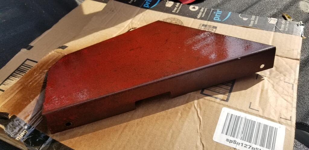

WHX?? 58,347 #6291 Posted August 28, 2020 (edited) Thoughts on using this for patina on original parts? Edited August 28, 2020 by WHX24 1 Share this post Link to post Share on other sites
AMC RULES 37,260 #6292 Posted August 28, 2020 Back in the day, the product was originally offered in two versions, one for painted, one for bare metal parts. Seeing now they have combined the two into one product. So yeah my dear Madge, see no reason why not to. 1 1 Share this post Link to post Share on other sites

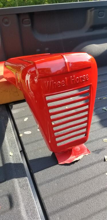

Lane Ranger 12,161 #6293 Posted August 28, 2020 (edited) 1 hour ago, AMC RULES said: Dries pretty much bullet proof. Lay down my clear immediately after the color goes on. As in, set down one can, pick up another. The Eastwood Diamond Clear easily cuts my painting cure time in half. Craig: So you use the Eastwood clear while the Red Rustoleum is still wet??? Edited August 28, 2020 by Lane Ranger 2 Share this post Link to post Share on other sites
AMC RULES 37,260 #6294 Posted August 28, 2020 Yep, then straight into the black bed of my truck to cook in the sun like an oven for the day. Surely does make that paint lay down! 5 3 1 Share this post Link to post Share on other sites
WHX?? 58,347 #6295 Posted August 28, 2020 5 minutes ago, AMC RULES said: does make that paint lay down Certainly does look automotive grade finish Madge! 2 Share this post Link to post Share on other sites
ebinmaine 81,164 #6296 Posted August 28, 2020 5 minutes ago, WHX24 said: automotive grade Agreed. That's one of, if not the best finish I've ever seen out of spray cans. At least in these pictures. 2 Share this post Link to post Share on other sites

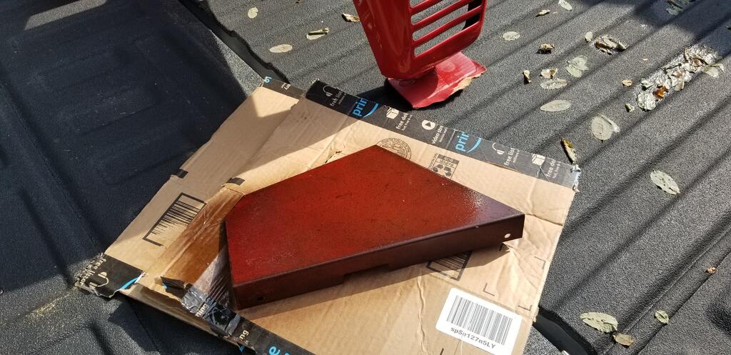

AMC RULES 37,260 #6297 Posted August 28, 2020 Never have been a fan of the glossy patina look, but... anything for you Madge! 3 3 2 Share this post Link to post Share on other sites
AMC RULES 37,260 #6298 Posted August 28, 2020 Pulled it directly off the tractor, didn't even wipe it off. 1 Share this post Link to post Share on other sites
