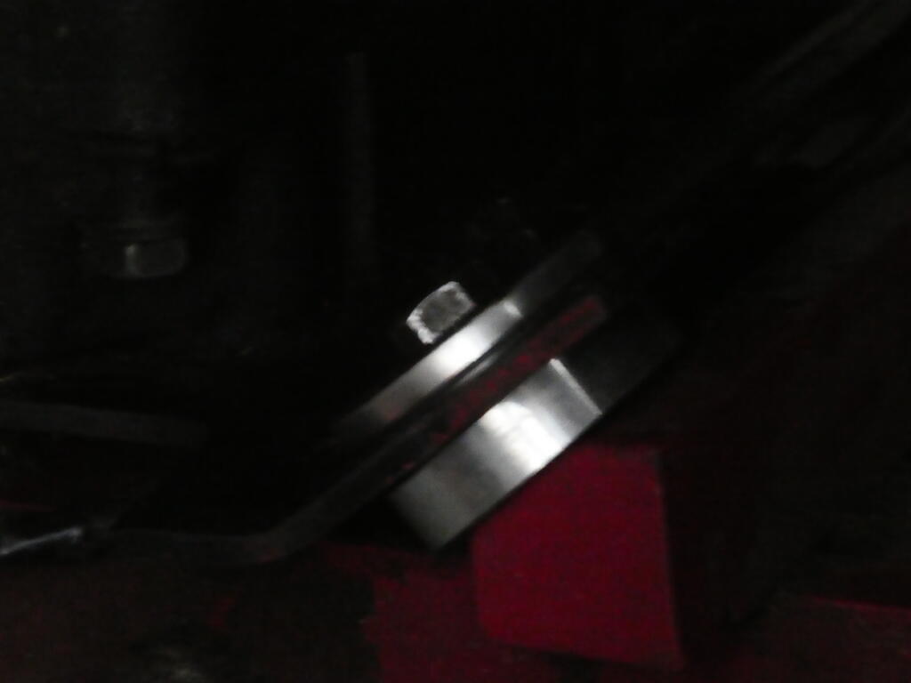

Stormin 9,988 #5677 Posted July 10, 2020 Replaced the rubber engine mounts on my C-125, for some nice solid ones that Mickwhitt knocked up for me. 5 1 Share this post Link to post Share on other sites

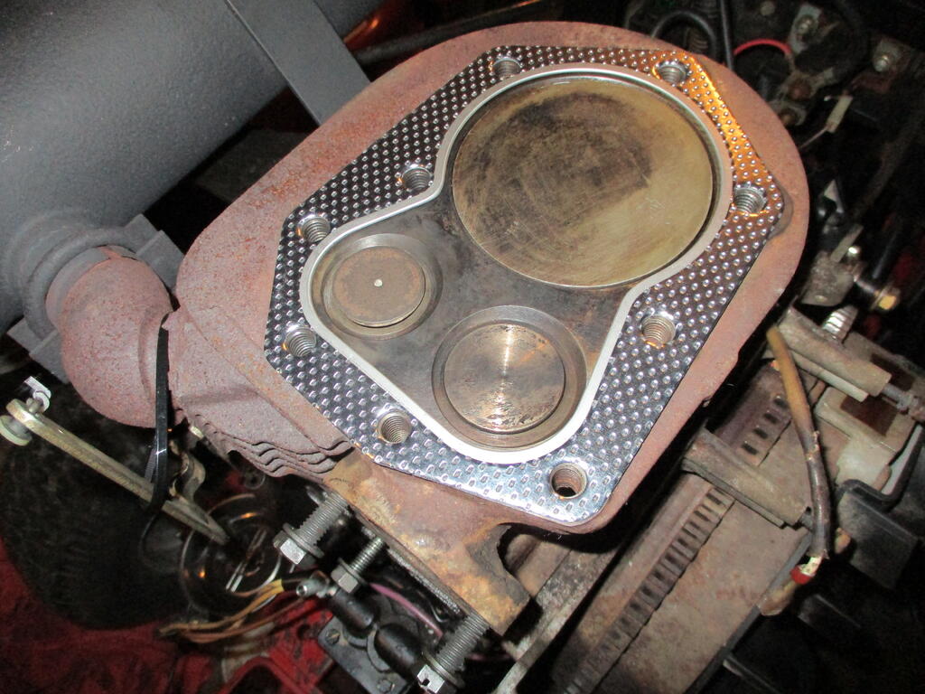

johnnymag3 2,646 #5682 Posted July 10, 2020 (edited) this is the engine that ran fine for an undetermined amount of time, then snorted, popped coughed.spit fire....then stalled. Starts right back up and runs fine....then if you run it at full throttle its good forever !...anything lower than 1/2 throttle it will start to do its jig/jag whenever....sometimes soon / sometimes later... Gas tank removed and cleaned, carb removed and cleaned, valves adjusted but were not too far out, new gas line, new filter, 3 of them....disconnected fuel line and did a feed with a fuel tank up high for a gravity feed....no fuel pump needed....fuel pumped checked and tested......no problems found and same results every time engine started and tested.....thought coil was bad.....not so sure now./ this no power to it when I turn the key on is a weird thing Took off head to check for carbon issue....nothing, valves seat perfectly Edited July 10, 2020 by johnnymag3 Share this post Link to post Share on other sites

D_Mac 9,337 #5689 Posted July 10, 2020 @Stormin hope you had an easier time with changing those mounts then I did. I got 2 on then struggled to the point that I had to walk away and come back next day to finish. Was very pleased with the results. With the rubber mounts at low RPMs the Kohler would shake like crazy. With the solids mounts.... nice and smooth. Share this post Link to post Share on other sites
Tractorhead 9,217 #5690 Posted July 10, 2020 @johnnymag3 This is a strange error what you describe. Ok, Let‘s go again all tests Step by Step. The Engine inside looks pretty Clean and in good condition. Put few dribbs i.eg of dieselOil arround the Valves and check if they closed completely and be tight if piston is on TDC the oil must stay even on the Valvesides without any loss. If that is ok, i would check the Flywheel to Crankshaft connection. pull the Flywheel and check the keeway if it‘s not sheared. if it‘s sheared, the timing goes worse. Complete the Engine again and check it for Compression. do a compression test once with complete cold Engine before any Start once with warm Engine directly after it stalls Values? Did you checked the Choke bowden on carb visualy (Let the chokelever as it is just remove the Airfilter and take a look if choke is completely wide open) next test i would release the magneto shutdown wire from the tractor Harness and isolate it from tractorground try, if the Engine than run‘s in idle, so a possible short of wire harness or any switch can be excluded. Share this post Link to post Share on other sites

Stormin 9,988 #5696 Posted July 10, 2020 40 minutes ago, D_Mac said: @Stormin hope you had an easier time with changing those mounts then I did. I got 2 on then struggled to the point that I had to walk away and come back next day to finish. Was very pleased with the results. With the rubber mounts at low RPMs the Kohler would shake like crazy. With the solids mounts.... nice and smooth. Got to admit, it was a fight. Not run it yet as no starter motor on. Share this post Link to post Share on other sites
