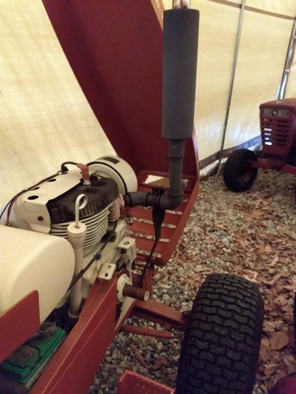

danweikert21 166 #4802 Posted May 18, 2020 I’m working on my exhaust and I want to put a vertical exhaust on it. Like the big farm tractors. Does anyone know how to do that and what parts I need. I’m new to this 4 Share this post Link to post Share on other sites
SylvanLakeWH 32,826 #4803 Posted May 18, 2020 May want to contact @jimkemp. He does the stack mufflers... 3 Share this post Link to post Share on other sites
ebinmaine 81,160 #4804 Posted May 18, 2020 6 minutes ago, Raider10danweikert said: I’m working on my exhaust and I want to put a vertical exhaust on it. Like the big farm tractors. Does anyone know how to do that and what parts I need. I’m new to this Couple different ways that you could do it is to purchase a muffler for a Cub model 125. Run a horizontal with an elbow out of your engine and over to the pipe that goes into the muffler. That becomes your stack effectively. Another way would be to contact a member of ours named Jim Kemp. Jim makes little stack mufflers for these garden tractors and does a great job at it. 1 Share this post Link to post Share on other sites
danweikert21 166 #4805 Posted May 18, 2020 3 minutes ago, ebinmaine said: Couple different ways that you could do it is to purchase a muffler for a Cub model 125. Run a horizontal with an elbow out of your engine and over to the pipe that goes into the muffler. That becomes your stack effectively. Another way would be to contact a member of ours named Jim Kemp. Jim makes little stack mufflers for these garden tractors and does a great job at it. Yeah thank you I appreciate it. Like I said I don’t have much experience with this stuff so I don’t know what to look for when I’m buying parts I’ll take a look at Jim’s profile 1 Share this post Link to post Share on other sites

ebinmaine 81,160 #4807 Posted May 18, 2020 6 minutes ago, Raider10danweikert said: Yeah thank you I appreciate it. Like I said I don’t have much experience with this stuff so I don’t know what to look for when I’m buying parts I’ll take a look at Jim’s profile I'm not actually sure how to find his profile. I do know how to send him a message but I'm not sure if that's his only contact. Possibly check the Vendors section and see if he's listed in there. If you want to see pictures of either of the two exhausts that I mentioned I could take a couple when I get home. Share this post Link to post Share on other sites

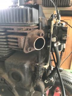

danweikert21 166 #4814 Posted May 18, 2020 question, I need to remove the old muffler but it is rusted on. Two hex polts are holding it to the block I cant seem to get it loose could i use a torch to heat it up causing it to loosen? Share this post Link to post Share on other sites
Pullstart 71,527 #4815 Posted May 18, 2020 14 minutes ago, danweikert21 said: question, I need to remove the old muffler but it is rusted on. Two hex polts are holding it to the block I cant seem to get it loose could i use a torch to heat it up causing it to loosen? could you share a picture of what you’re working with? Maybe you could cut the pipe and slip a stack on and clamp it? 1 Share this post Link to post Share on other sites

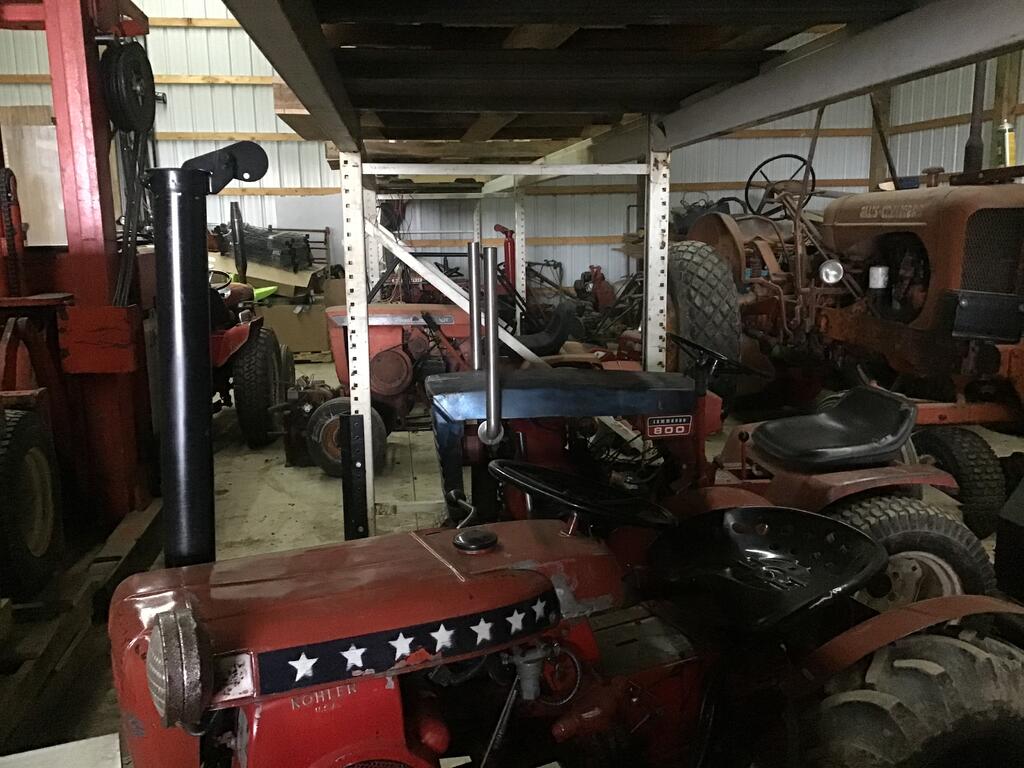

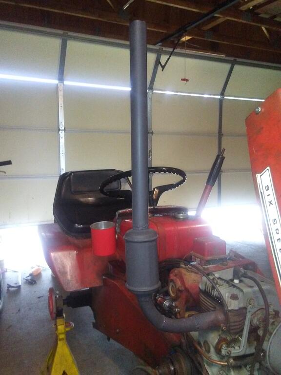

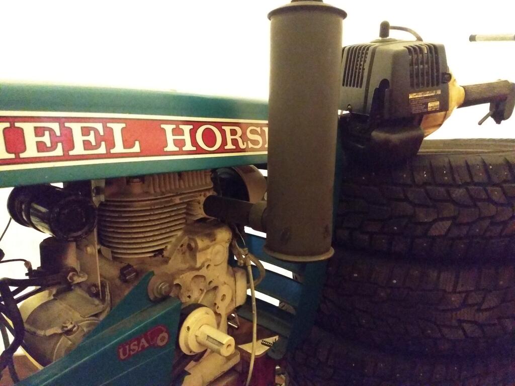

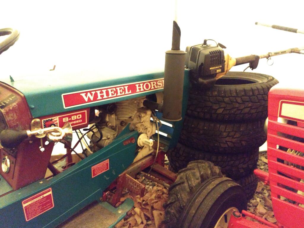

ebinmaine 81,160 #4820 Posted May 18, 2020 6 hours ago, ebinmaine said: see pictures of either of the two exhausts that I mentioned I could take a couple when I get home 6 hours ago, danweikert21 said: Sure that sounds good. thank you @danweikert21 Here's a few pics of the 2 I have. Patriot Horse (Red, white and blue) is an 8 horse Kohler using the Cub muffler turned up to be a stack. I normally have a piece of chrome pipe on top like the other one. Cinnamon Horse C160 has a @jimkemp custom on it with a piece of chrome bathroom floor drain pipe I cut/fit to add height and prettyfulness. Note the bracket I fabbed for the Cinnamon exhaust. It's a fair amount of weight and vibration to be relying on the engine block alone. 6 Share this post Link to post Share on other sites

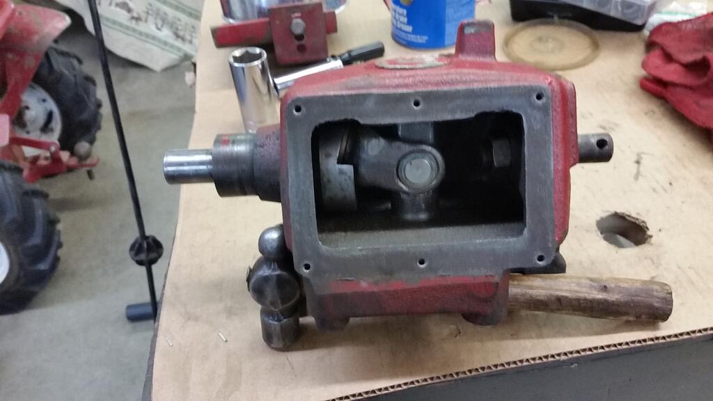

WHX?? 58,347 #4821 Posted May 19, 2020 (edited) Found out another one of our favorite tractor shows is cancelled.... got ticked off and went to the bar... sickel bar that is.... got the wobble box put together.... i think....now just to figure out how this pile of parts goes together. Thinkin this thing is gonna be a pita to put on a tractor so we all know what that means! Shus up ... she don't havta know it will fit on one we have... Edited May 19, 2020 by WHX24 6 2 Share this post Link to post Share on other sites
