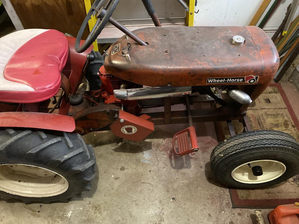

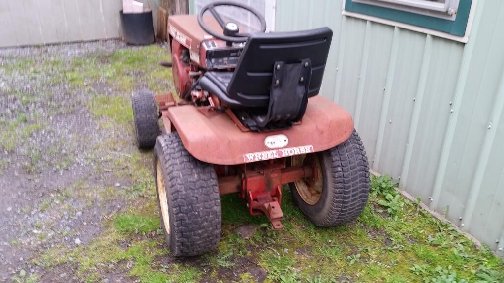

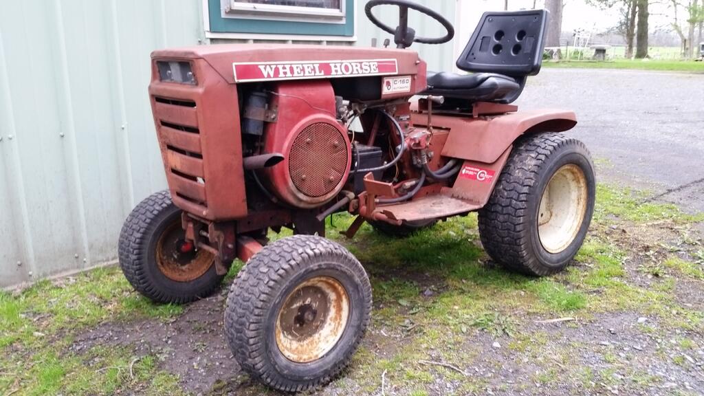

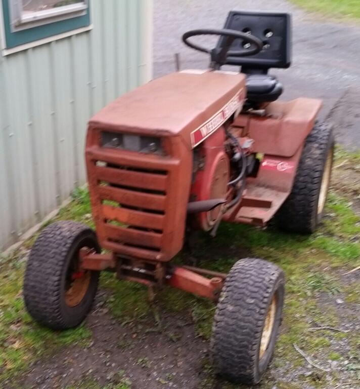

rjg854 13,329 #4653 Posted May 3, 2020 Spent the day going through the C-160 that I bought yesterday. I went through all the wiring and cleaned all the connections and grounds. Cleaned out the mouse nest and the fins, it just happens to be a 13 fin 16hp. Freed up the choke and throttle cables. The gas tank is plastic and looks like a new fuel line, and the fuel pump is good. The carb seems ok, I was able to make adjustments, but I probably will rebuild it. I had a better seat that wasn't waterlogged, so that got changed. Biggest problem was the throttle cable it was flexing all over the place. It works much better. Then went through the drive belt side , belt is so-so, but all the pulleys are in good condition. Lubricated everything. It runs and drives good. Quite happy with it. 3 7 Share this post Link to post Share on other sites
WHX?? 57,879 #4654 Posted May 3, 2020 Saaaaweeeeet Randy! 1 Share this post Link to post Share on other sites

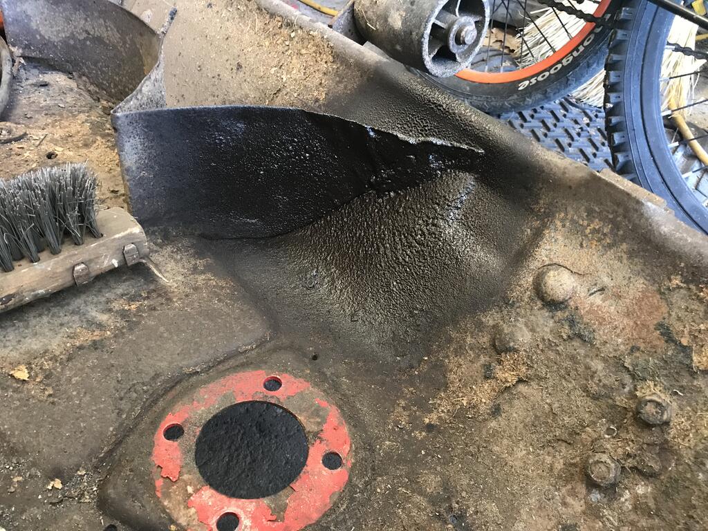

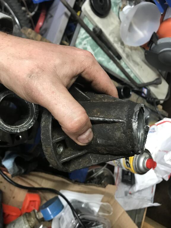

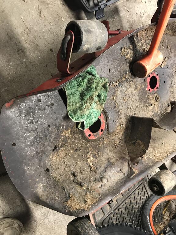

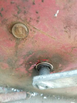

FAST 87 #4656 Posted May 4, 2020 Well I had a few other projects knocked out so I thought I would knock out the mower deck bearings today. I had gotten some much needed help and parts from @pullstart to complete the job. I started by straightening some bends in the deck and then straightened and welded the sheet metal as seen in the photo then I moved on to the bearing in the spindle mounts. As I pulled it apart I seen that the bottoms where the clip goes that holds the bearing in is broken off. So now I need two spindles lol. Now I’m feeling like I is should have just bought another deck. 😂 2 1 Share this post Link to post Share on other sites

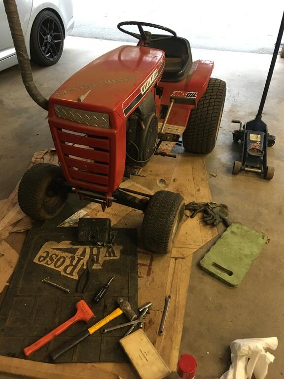

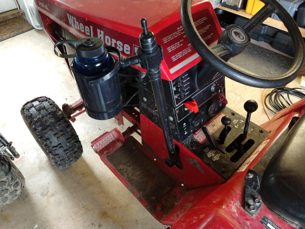

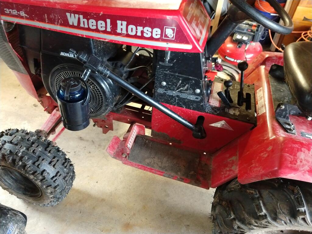

balconio 606 #4657 Posted May 4, 2020 I had Horsey II in the garage today. She got: - wire brushed and high temp painted the muffler - fresh motor oil change - new sparkplug - drained and filled the trans with fresh 80W/90 gear oil - new brake lining - fixed and lubed the choke cable - 2 position gimballed drink holder - reconnected the seat switch and wired in a dash toggle switch to arm/disarm the seat switch. This is for extreme off roading where there is a chance I might fall off and not be able to catch a runaway tractor. 2 2 1 Share this post Link to post Share on other sites

ebinmaine 80,449 #4659 Posted May 5, 2020 2 hours ago, balconio said: 2 position gimballed drink holder AWESOME 1 Share this post Link to post Share on other sites

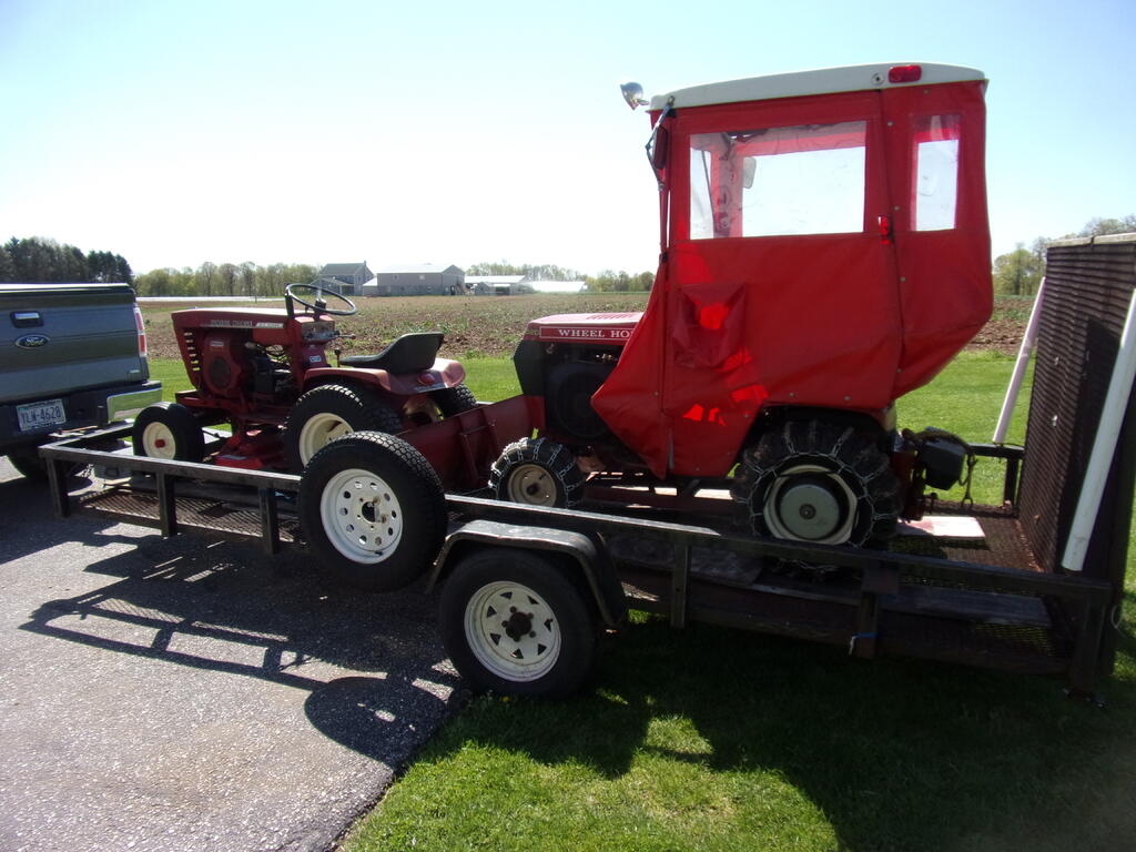

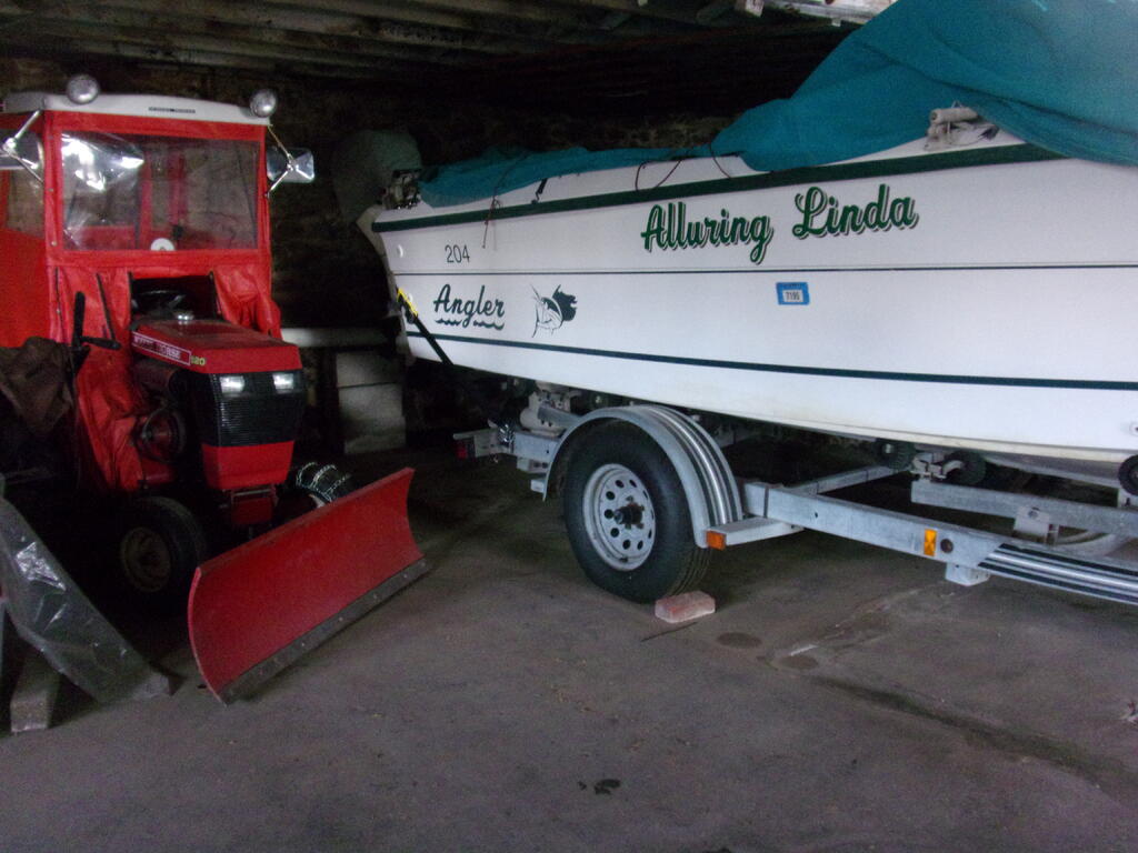

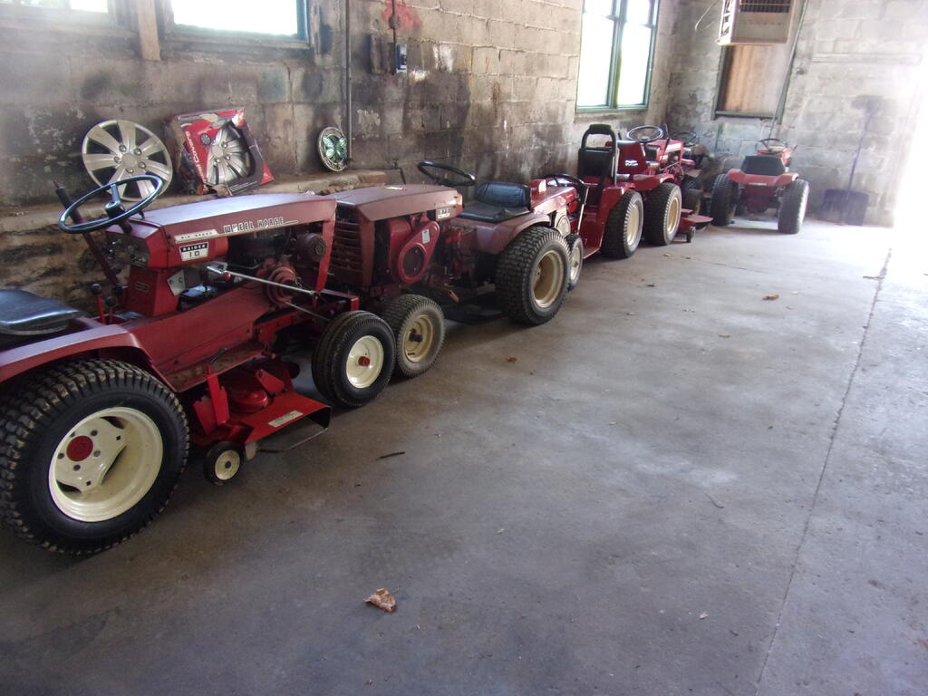

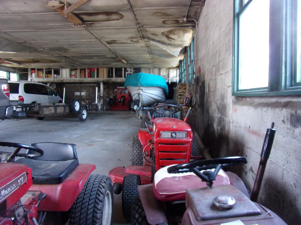

Ed Kennell 47,097 #4674 Posted May 7, 2020 With no tractor shows scheduled in the near future, I moved some tractors to the summer pasture. Now what to do with a couple trailer loads of WH parts that normally find a home at the shows. Oh well, it's time to charge up Linda. 7 4 Share this post Link to post Share on other sites
cafoose 3,821 #4675 Posted May 7, 2020 16 minutes ago, Ed Kennell said: Now what to do with a couple trailer loads of WH parts that normally find a home at the shows. Watcha got? Bring them to my house it's not far 4 Share this post Link to post Share on other sites
