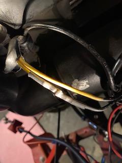

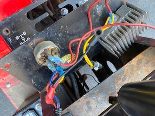

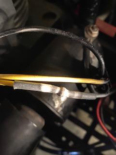

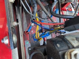

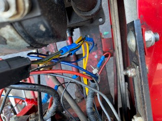

johnnymag3 2,646 #4629 Posted May 1, 2020 ok....so now that I exposed the wires.....where do I go from here? Why is there a rectifier in my 310-8? do I have a stator? or is that a diode in the factory line and I still have a alternator? Ive never seen anything like this.... Should I start it and measure the output of the 2 yellow wires coming from the shroud to the regulator? Will that give me an answer? I have never seen a regulator bolted or mounted to the back of a dash on a 310-8? wandering aimlessly and scratching my head.... Share this post Link to post Share on other sites
Tractorhead 9,217 #4630 Posted May 1, 2020 7 minutes ago, johnnymag3 said: ok....so now that I exposed the wires.....where do I go from here? Why is there a rectifier in my 310-8? do I have a stator? or is that a diode in the factory line and I still have a alternator? Ive never seen anything like this.... Should I start it and measure the output of the 2 yellow wires coming from the shroud to the regulator? Will that give me an answer? I have never seen a regulator bolted or mounted to the back of a dash on a 310-8? wandering aimlessly and scratching my head.... Do you have pic‘s Share this post Link to post Share on other sites
pfrederi 21,091 #4631 Posted May 1, 2020 9 minutes ago, johnnymag3 said: ok....so now that I exposed the wires.....where do I go from here? Why is there a rectifier in my 310-8? do I have a stator? or is that a diode in the factory line and I still have a alternator? Ive never seen anything like this.... Should I start it and measure the output of the 2 yellow wires coming from the shroud to the regulator? Will that give me an answer? I have never seen a regulator bolted or mounted to the back of a dash on a 310-8? wandering aimlessly and scratching my head.... You should start a separate thread in electrical system. To hard to find you pictures and previous posts buried in here. 1 1 1 Share this post Link to post Share on other sites
johnnymag3 2,646 #4632 Posted May 1, 2020 yes...look back a few posts, I posted them 12 hrs.ago. Thanks. In this thread Share this post Link to post Share on other sites
johnnymag3 2,646 #4633 Posted May 1, 2020 On 4/30/2020 at 3:32 PM, johnnymag3 said: Made some headway today on the 310-8. doing all of the wiring over......its a rats nest....but it does work !! Wire nuts, scotch locks...whatever he had in reach I guess Also found a regulator rectifier behind the dash plate...!!!!!!! Whats the deal here I ask. I thought it was one of those unregulated systems.... Hmmmmm I guess the previous owner may know....but maybe not. Remember he is 88 years old. This is part of my Covid….19....Corona deal 3 weeks ago HELP Share this post Link to post Share on other sites
johnnymag3 2,646 #4634 Posted May 1, 2020 21 hours ago, johnnymag3 said: this is what I found under the covering Share this post Link to post Share on other sites
pfrederi 21,091 #4635 Posted May 1, 2020 6 minutes ago, johnnymag3 said: Check the Ac voltage just on the yellow wire (unbroken one) mifht be tehhead light circuit. Try to read DC on the wire with the thing in it. If it is a diode it will be DC down stream Hard to tell from picture if that is a diode or just a connecter. Need to move this to and separate posting in Electrical. 1 Share this post Link to post Share on other sites
johnnymag3 2,646 #4636 Posted May 1, 2020 I moved it.....thank you also there is no broken wire, it appears that the seal on the yellow wire is factory. Do they put the diode in there? Thanks again Share this post Link to post Share on other sites

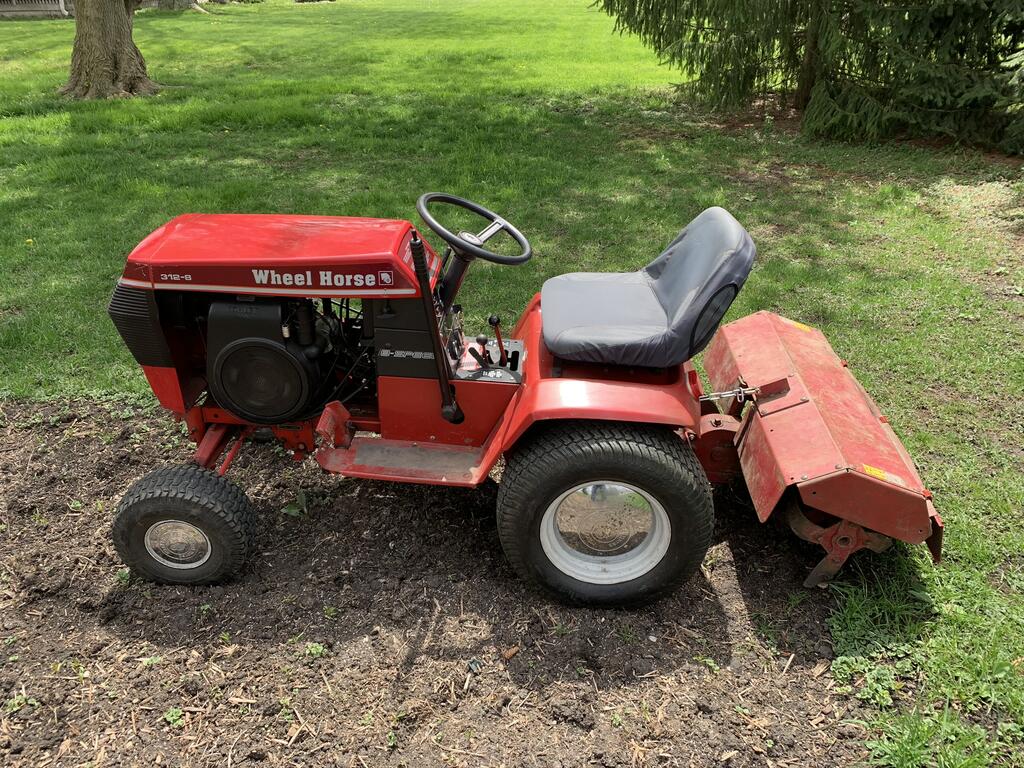

Andy N. 2,806 #4644 Posted May 3, 2020 Put the tiller on the 312-8 for a fun day of garden tilling! IMG_0350.mp4 2 3 Share this post Link to post Share on other sites

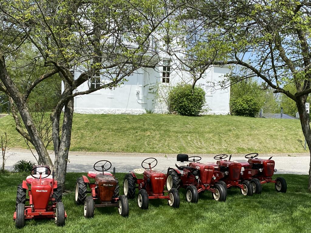

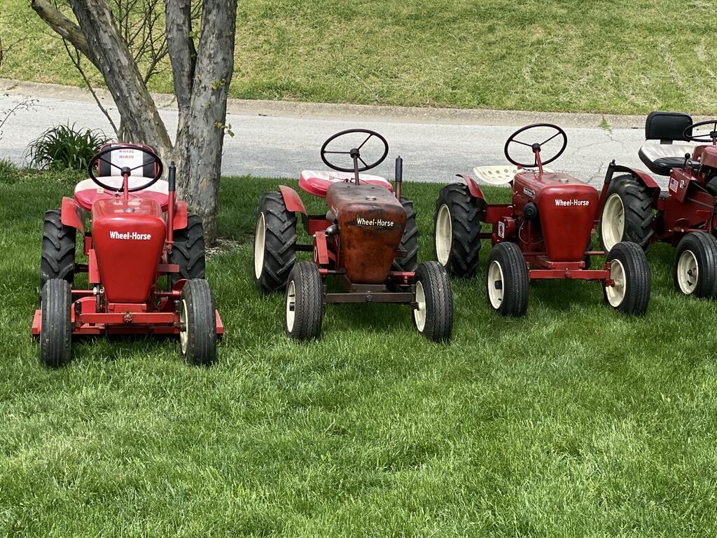

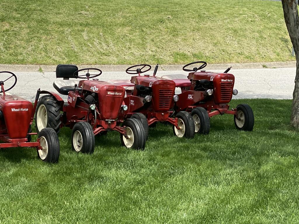

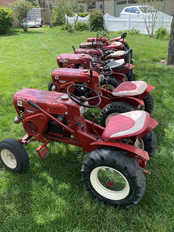

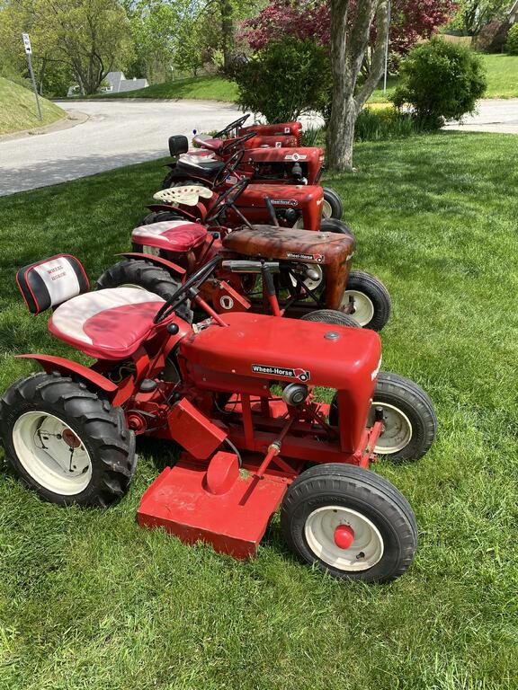

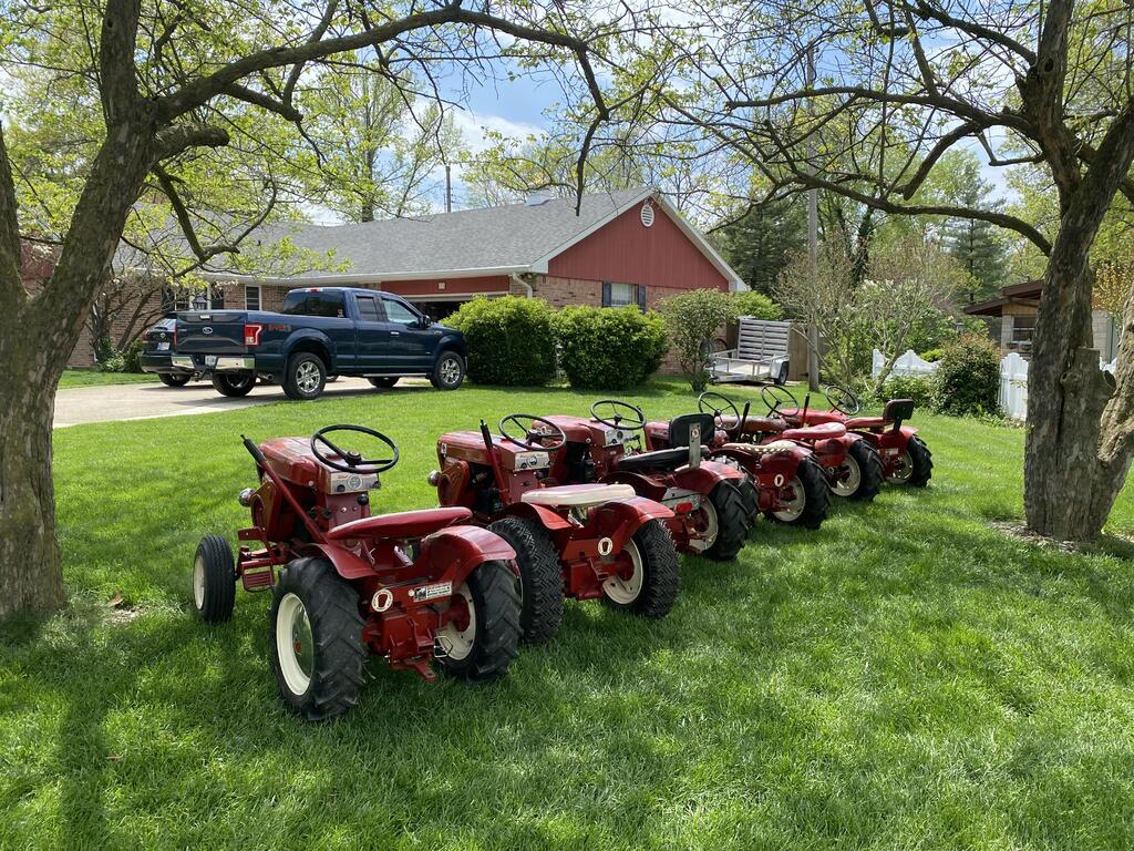

Lane Ranger 12,094 #4648 Posted May 3, 2020 Cleaned out the garage today! Took out six of my nine Wheel Horse tractors including all three RJ’s ! Still working on another RJ in garage . Nice day for it. All six tractors started and I even trimmed the lawn on the edges of the driveway with the RJ with the mower deck on it! 12 1 3 Share this post Link to post Share on other sites
Pullstart 71,149 #4649 Posted May 3, 2020 @Lane Ranger that middle RJ, is that the patina pattern or a shadow? It looks awesome! 2 Share this post Link to post Share on other sites
Lane Ranger 12,094 #4650 Posted May 3, 2020 Patina 1958 from Oklahoma. -no Date code on transmission so early 1 Share this post Link to post Share on other sites
