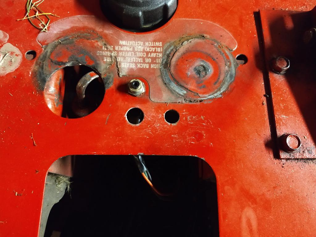

tom2p 2,394 #4618 Posted May 1, 2020 On 4/28/2020 at 10:13 PM, balconio said: Fixed the seat switch today, which was defeated by the previous owner. I figure it's a safety measure worth keeping on this tractor because I mow with it and would like to give that duty over to my sons in the next few years. hey - pay attention to where the seat springs contact when the seat is in the down position if the one spring contacts the top of the dip stick handle the other end of the dip stick can get chewed up by the internal transmission parts 1 1 Share this post Link to post Share on other sites

balconio 606 #4621 Posted May 1, 2020 9 hours ago, tom2p said: hey - pay attention to where the seat springs contact when the seat is in the down position if the one spring contacts the top of the dip stick handle the other end of the dip stick can get chewed up by the internal transmission parts oh man- thx for the pro-tip there. my next job on this tractor is to replace a leaking brake shaft seal and change the gear oil, so i'll definitely check the stick and look for metal shavings in the fluid i drain off. Share this post Link to post Share on other sites
tom2p 2,394 #4622 Posted May 1, 2020 (edited) 34 minutes ago, balconio said: oh man- thx for the pro-tip there. my next job on this tractor is to replace a leaking brake shaft seal and change the gear oil, so i'll definitely check the stick and look for metal shavings in the fluid i drain off. as eb would say - don't ask me how I know this ... lol one seat spring on my 312 was apparently rubbing / pushing on the top of the dipstick (handle) and it apparently caused the end of the dipstick to contact moving parts in the gearbox and ground a small notch in the end of the dipstick of course this happened after a recent trans fluid change ... so had to do it again the top of the dipstick should sit lower and/or the plate (the seat springs rest on) should be higher ... Edited May 1, 2020 by tom2p 2 1 Share this post Link to post Share on other sites
