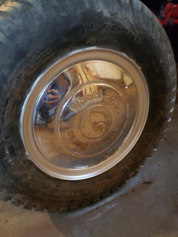

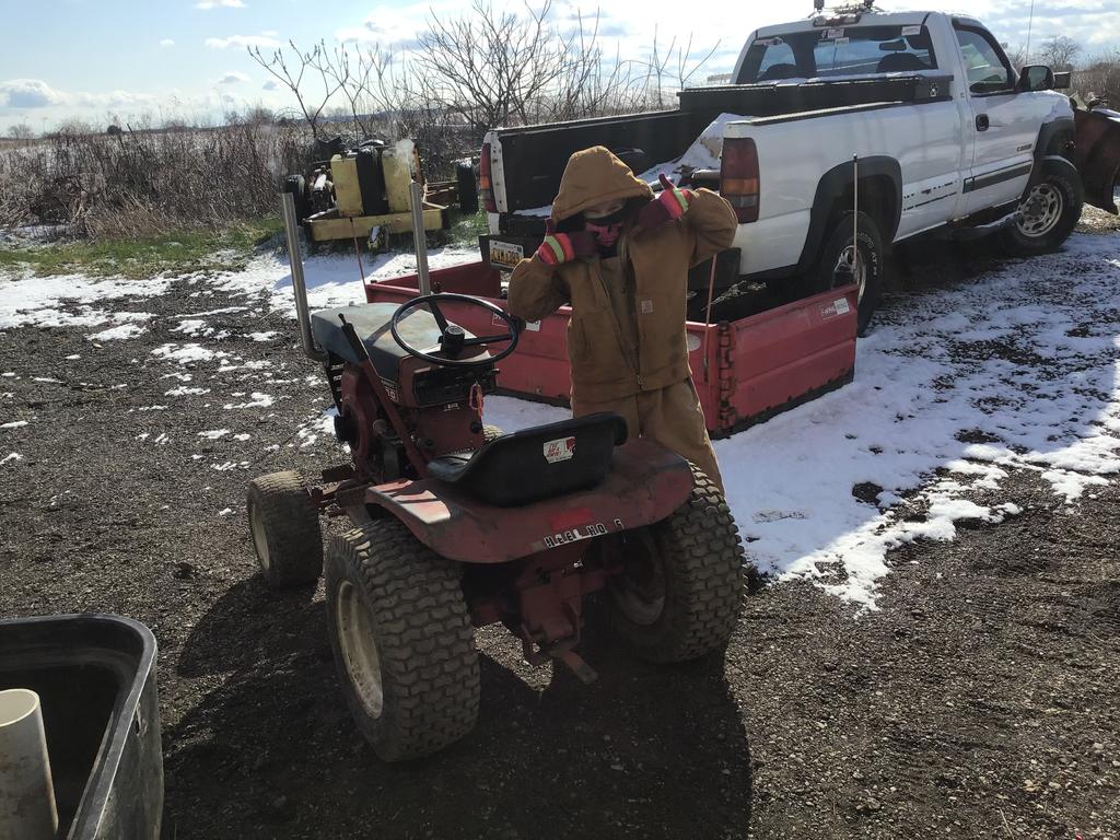

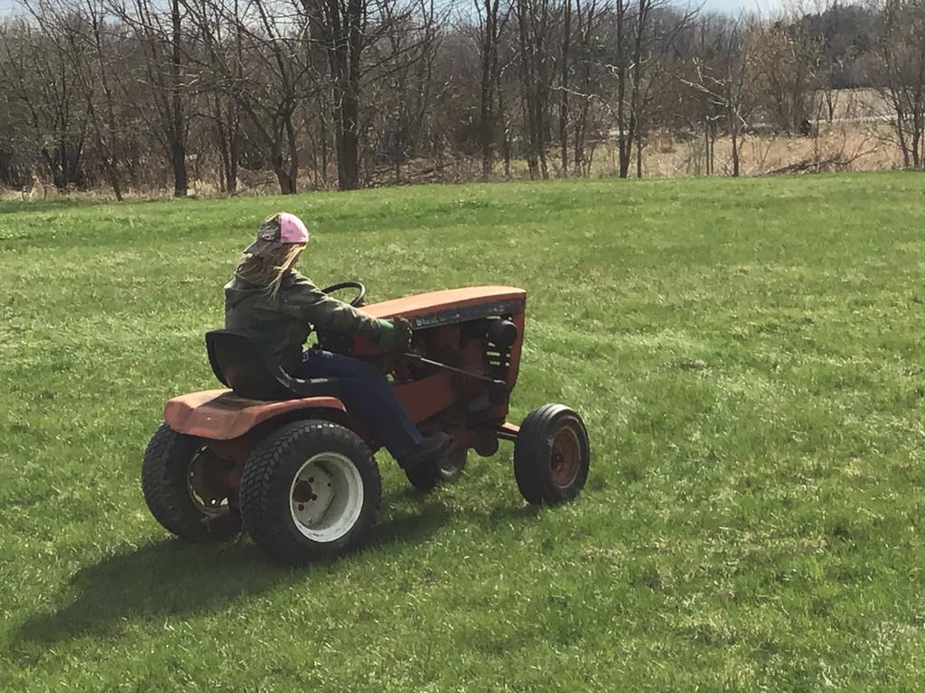

Pullstart 71,149 #4427 Posted April 14, 2020 Rylee learned the value of a breaker bar changing her tires on Filly today. We put a set of 23x8.50 BFG’s on before a hot lap in the cold. 2 6 Share this post Link to post Share on other sites

Pullstart 71,149 #4434 Posted April 15, 2020 35 minutes ago, ebinmaine said: I've never been even remotely close to small ish but I've had to put the end closest to the lug nut on a jackstand and a bar on the other end to uhhh. "Convince" some rusty lug nuts to move. Old School 4 way wrenches were real handy for that trick. She has learned from watching me, apparently. No jack stand, but she knew to support the extension vertically while she pushed down on the end of the bar! Proud daddy moment! 1 2 Share this post Link to post Share on other sites

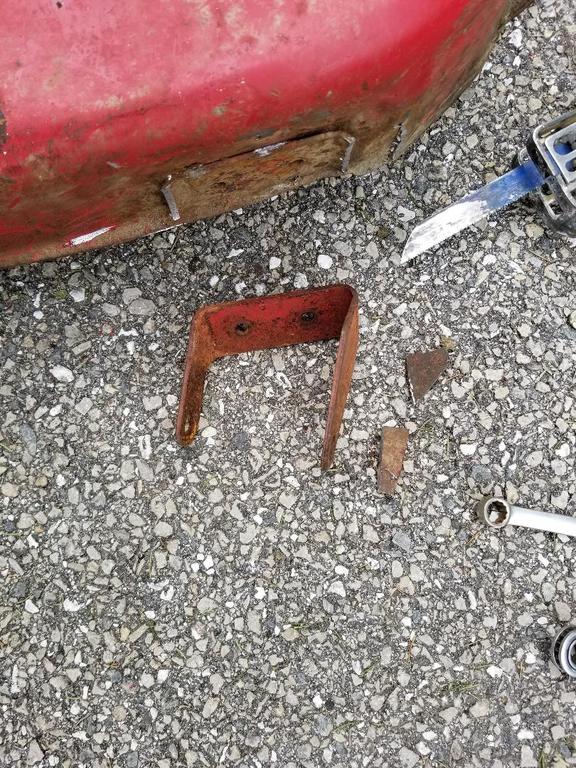

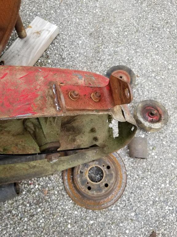

cafoose 3,821 #4440 Posted April 17, 2020 Mounted the front roller bracket I got from @Ed Kennell to the deck for my 417A. The PO put a caster on it I cut the old bracket flush with the deck and drilled through the deck and bolted it on 1 2 1 Share this post Link to post Share on other sites
SylvanLakeWH 32,267 #4441 Posted April 17, 2020 2 minutes ago, cafoose said: The PO put a caster on it Maybe to go around trees and shrubs quicker??? 4 Share this post Link to post Share on other sites
lynnmor 9,022 #4442 Posted April 17, 2020 1 hour ago, SylvanLakeWH said: Maybe to go around trees and shrubs quicker??? Now he went and ruined it, that caster worked in conjunction with the shrub trimming port on the side. 6 Share this post Link to post Share on other sites

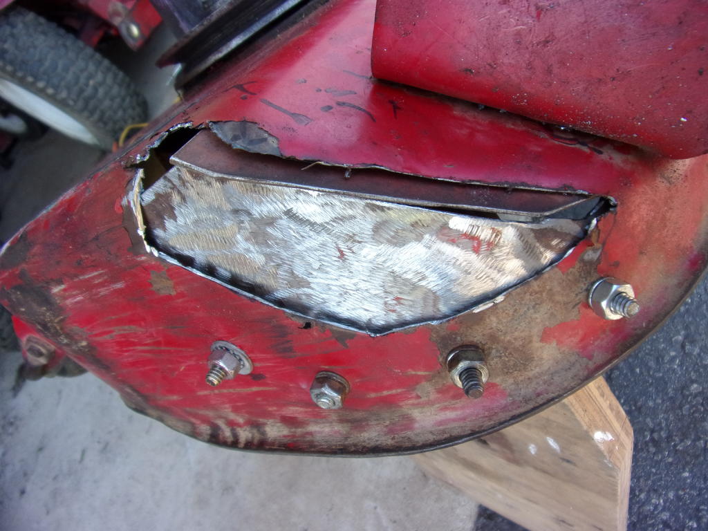

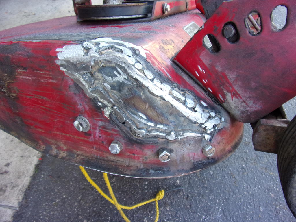

Ed Kennell 47,097 #4443 Posted April 18, 2020 Chuck, I thought you might switch all your deck parts to that good solid shell you picked up this morning. Share this post Link to post Share on other sites
cafoose 3,821 #4444 Posted April 18, 2020 Ed, actually the deck I had is solid except for the one hole on the left side which can easily be patched. I will keep the shell I got from you to eventually build another deck. Eventually I will find a rusty deck or enough parts so I can put the parts on that solid shell. Then I will have two good decks 2 Share this post Link to post Share on other sites

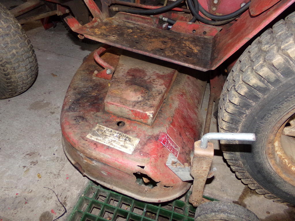

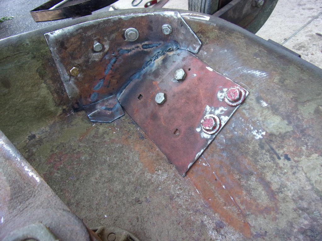

Ed Kennell 47,097 #4445 Posted April 18, 2020 Chuck, here are some pics of my 48" deck that had the same left side hole as yours. When rebuilding decks, I also always add a back up plate inside the deck for the height adjuster wheel brackets. 1 3 1 Share this post Link to post Share on other sites

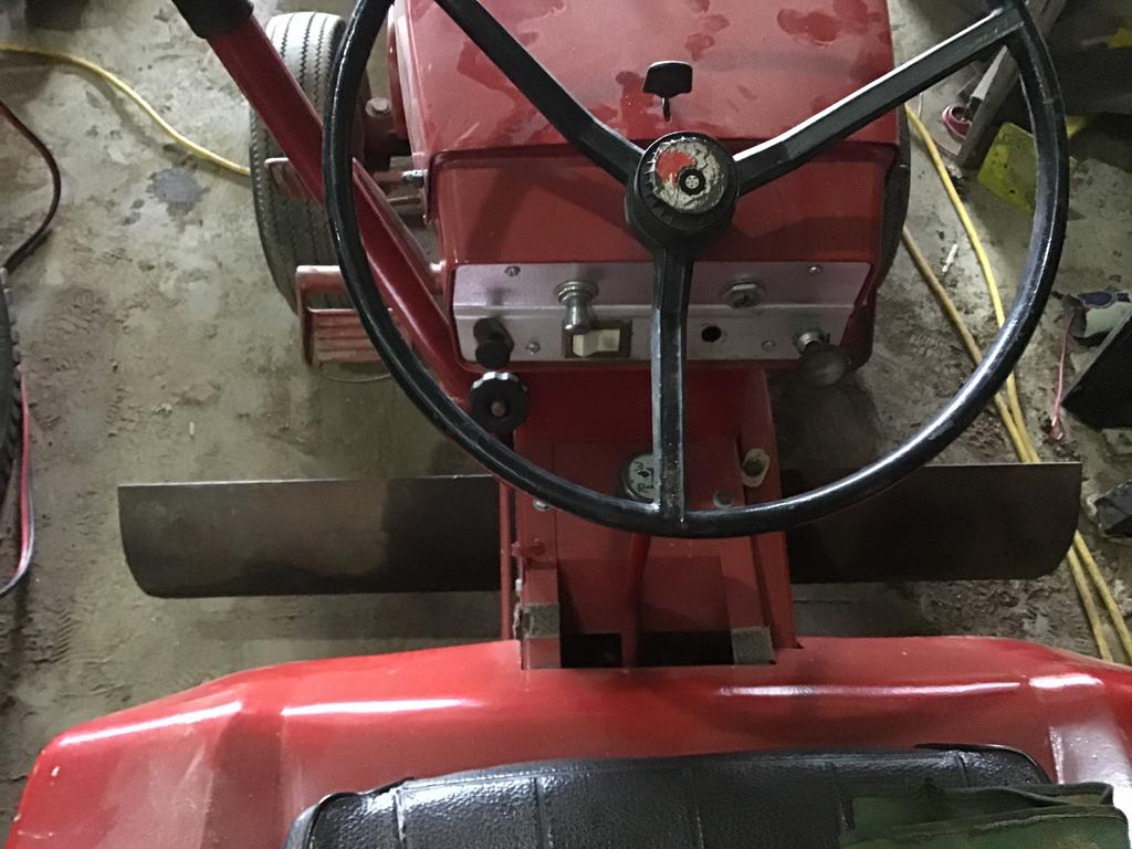

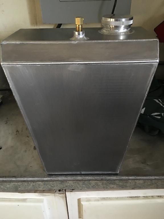

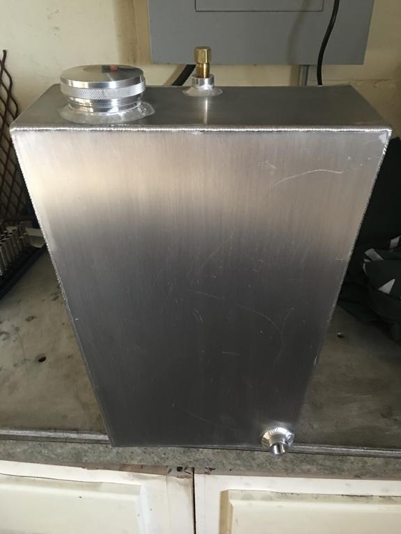

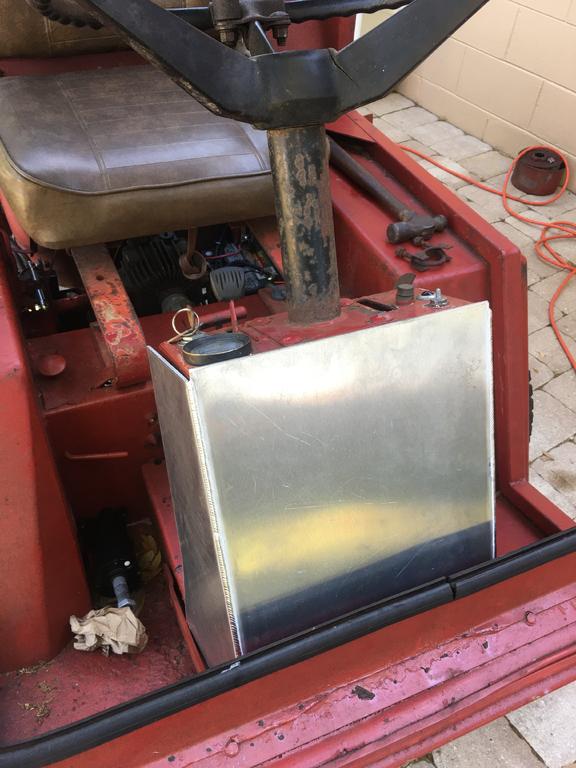

19richie66 17,932 #4449 Posted April 18, 2020 (edited) Finished another gt14 tank and made Lil’ Red a steering tower/ headlight cover assembly. Think I’m just going with an LED light bar instead of trying to fit factory style lights. Still have to trim it a little and not sure if I should paint it or not. Edited April 18, 2020 by 19richie66 6 1 2 Share this post Link to post Share on other sites
