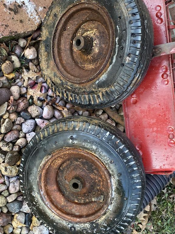

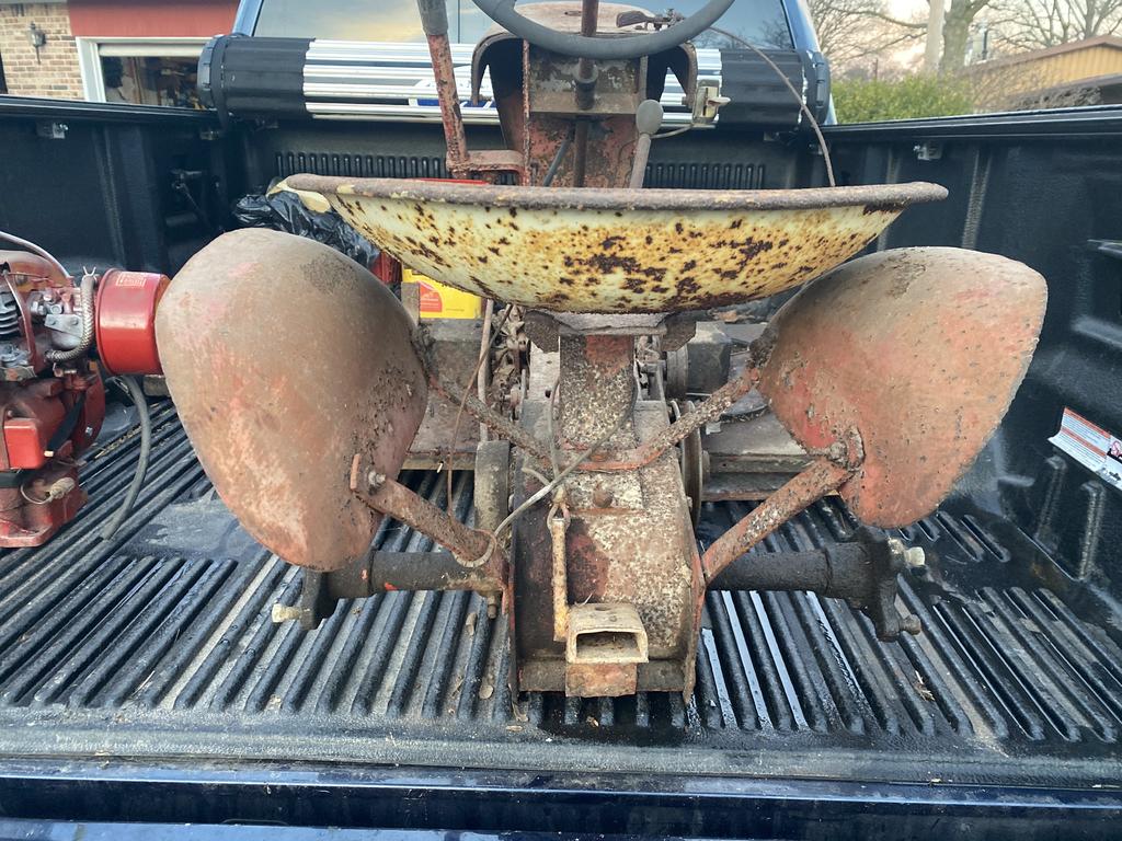

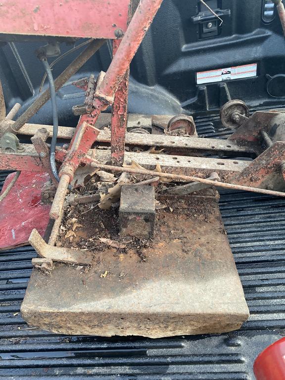

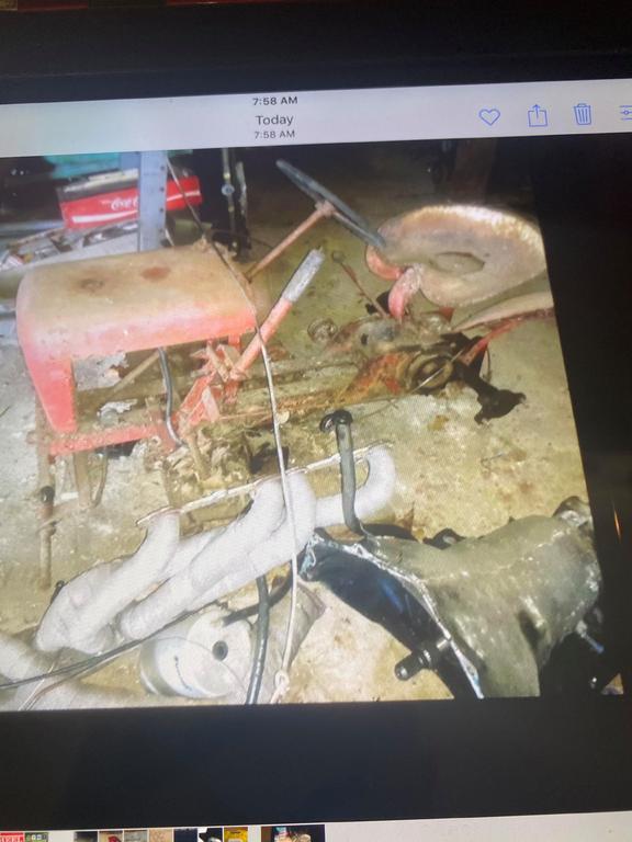

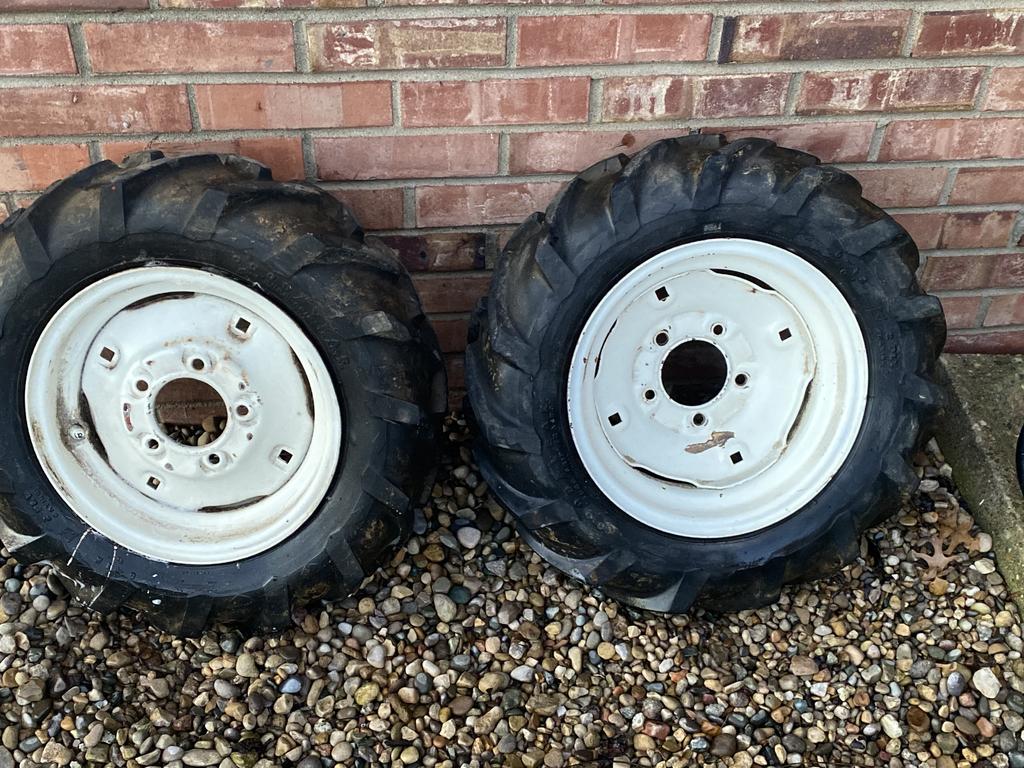

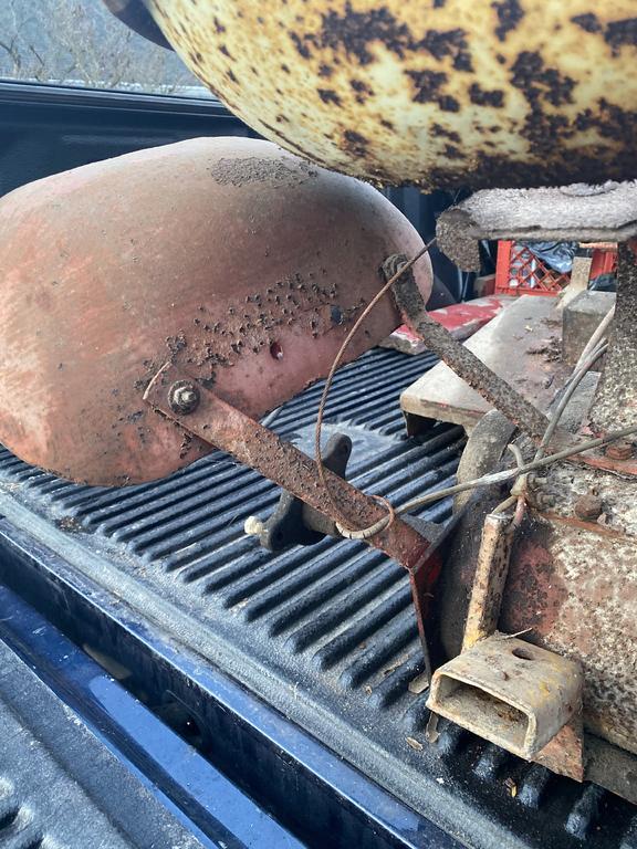

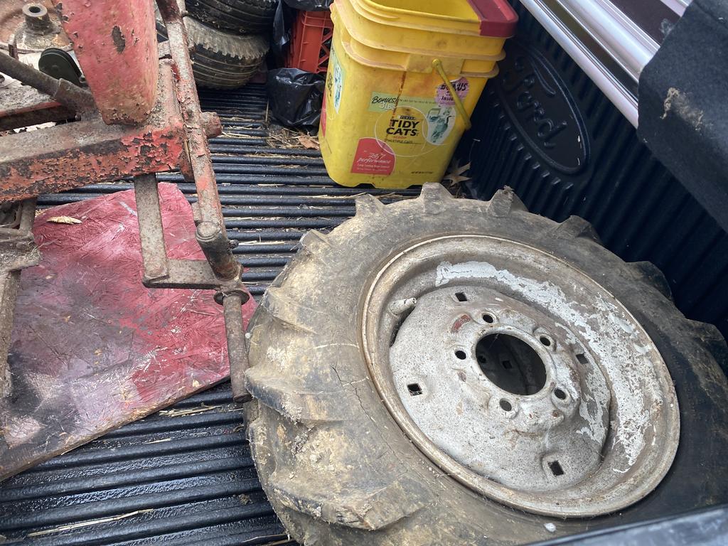

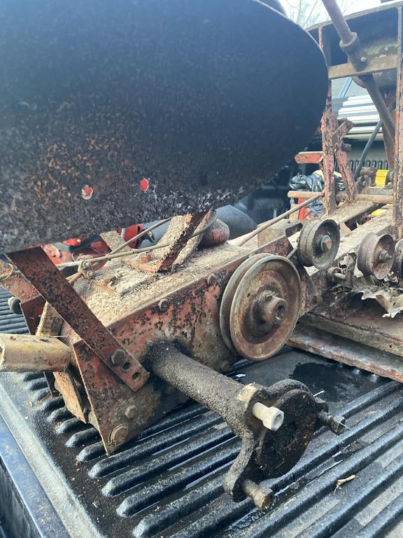

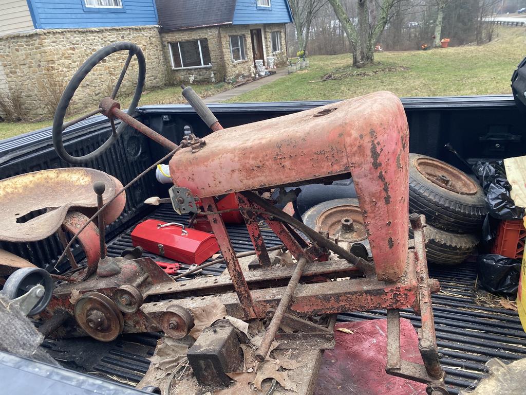

Lane Ranger 12,094 #4176 Posted March 13, 2020 (edited) Picked up another parts Wheel Horse RJ today! Saved for ten years by the previous owners father and he just did not get time to redo for his daughter. Three front wheels and two nice rear wheels. No motor nd steering tight. I bought mostly for the transmission which is very greasy and that is usually a good sign! Plus it has been inside for the last ten years! looks like I might be able to save the front wheels and rear wheels with Opps not B F Goodrich but Goodyear Sure Grips! Interesting set of genders and gender frame in this! I guess owner did not have the toolbox and Wheel Horse fender set on the tractor. And the RJ mower deck is not in terrible condition either! Not bad for all at $60 ! IMG_1158.MOV Edited March 13, 2020 by Lane Ranger 9 2 1 Share this post Link to post Share on other sites

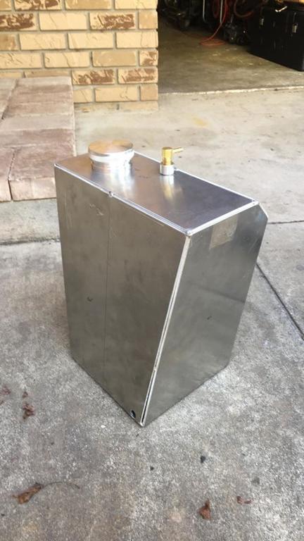

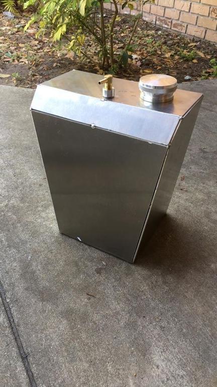

19richie66 17,932 #4177 Posted March 13, 2020 Not my wheelhorse but @Super-C 4 me is getting a new fuel tank. 4 4 1 2 Share this post Link to post Share on other sites
pkerot 73 #4178 Posted March 13, 2020 1 hour ago, 19richie66 said: Not my wheelhorse but @Super-C 4 me is getting a new fuel tank. That is VERY nice! Tell us about it. Did you make it? how much does it hold? Share this post Link to post Share on other sites
19richie66 17,932 #4179 Posted March 13, 2020 21 minutes ago, pkerot said: That is VERY nice! Tell us about it. Did you make it? how much does it hold? Thank you. We try. Its an aluminum fuel tank for a gt14. I cut it out and fit it. My son welds it together. It should hold just at 4 gallons. Little less than factory but hopefully will last a lot longer than the plastic one it came with. 👍 3 2 1 1 Share this post Link to post Share on other sites

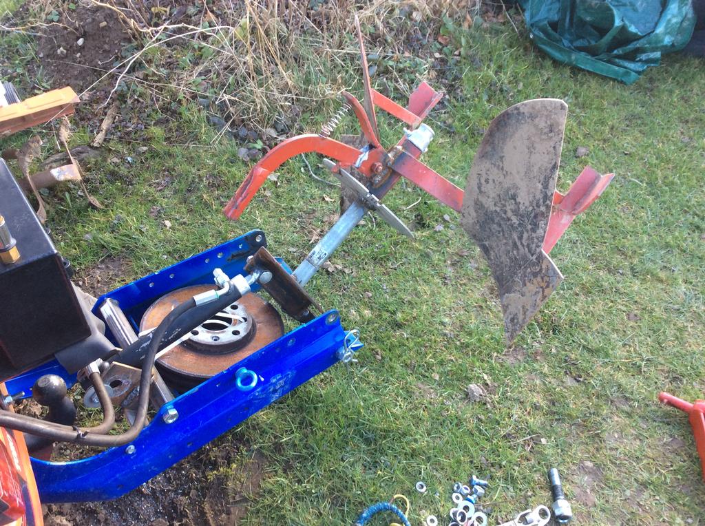

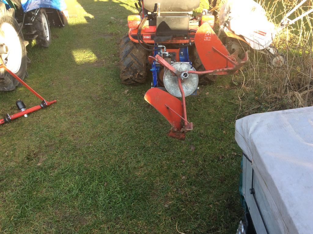

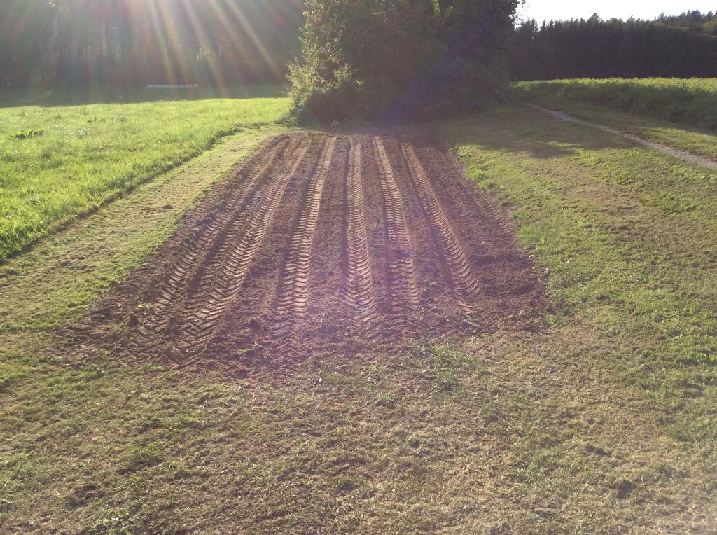

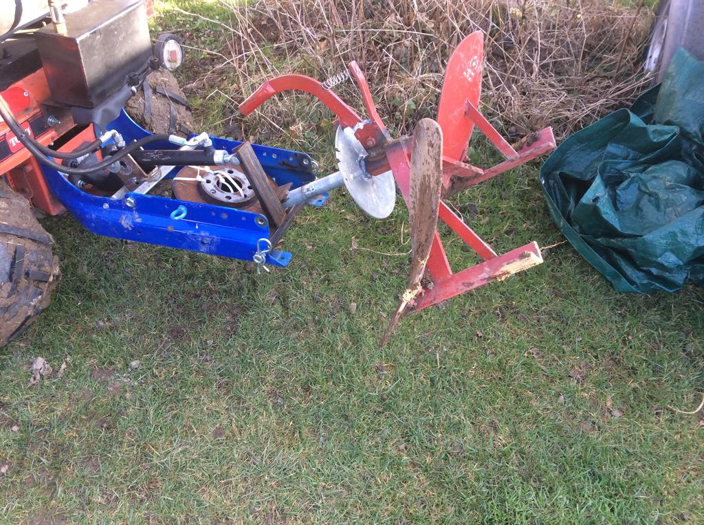

Tractorhead 9,217 #4180 Posted March 13, 2020 Looks very stylish, i like it and i bet it will last much longer than Plastic.👍 I do today a bit a rework on my turn Plow. So i set it deeper in the Mounting point, that the Load axle gets deeper. Why ? I read a lot about Plow’s and different setups on them and do several measurements. As i measured, the Pull angle seems too high, so my though was, if i reduced the height, it gets easier in the Soil and have a better down pressure on the rear axle after that change of Angle. After that change i try it in the muddy soil after and it seems my measurement works, i was able to pull it even in a muddy soil deeper than before, where the Soil was much dryer. It sticks if i try too deep, but with the hydraulics i can adjust it while in work. The slip can be seen left side on the grass. yes, it was on the grass not in the mud. Pretty cool. Not a good pict i know, while sundown. than i also redrilled the hydraulic cylinder lever, to have an better adjustment and a better setup. i also still prepared a three point rail (can be seen on the left side of the pict) for adapting the Plow onto the beast. But my first goal is, to use the Plow with the Horse. 2 6 Share this post Link to post Share on other sites

Tractorhead 9,217 #4186 Posted March 13, 2020 1 hour ago, 12Horse Paladin said: I am not a plow boy...indeed, do not undstand all the technical stuff you spoke of n did...but i like the looks of your results!😊 I think, maybe, i am starting an intrest into another aspect of this hobby😮 Which would mean...naturally, right?...a need for another Horse🤔 Uh-oh; Oh Lord...! Thanks, i feel honored. I also still not a plow boy before, but i love all technical Stuff. I like to construct things, if they senseful or not doesn‘t matter. I have my ideas and try them, also i try continousely update myself. once i working with microelectronics include programming but i like also rugged older Hardware. some of my projects are still running a few do not further, few i use continousely others are out of Service. But have another Wheel Horse, is allway‘s a good idea.👍 1 2 Share this post Link to post Share on other sites

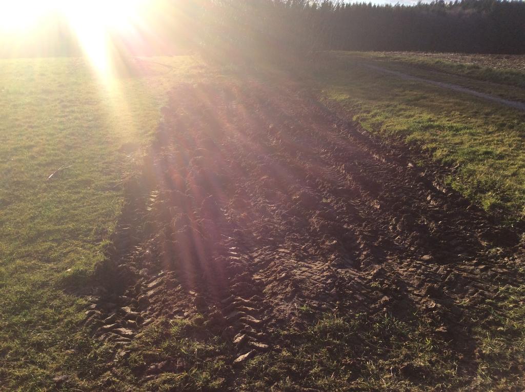

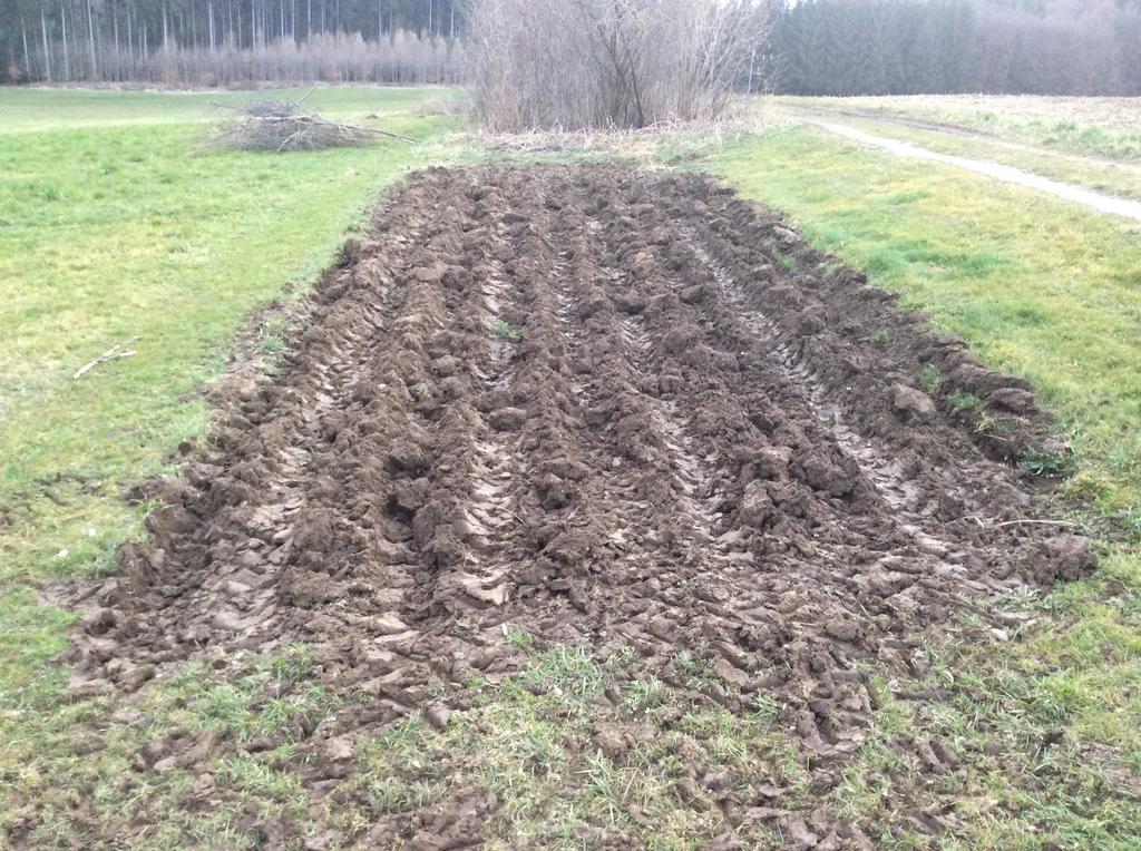

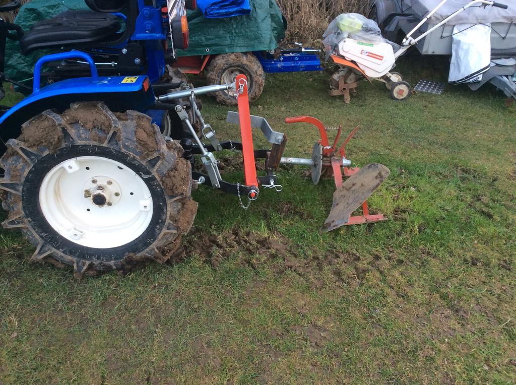

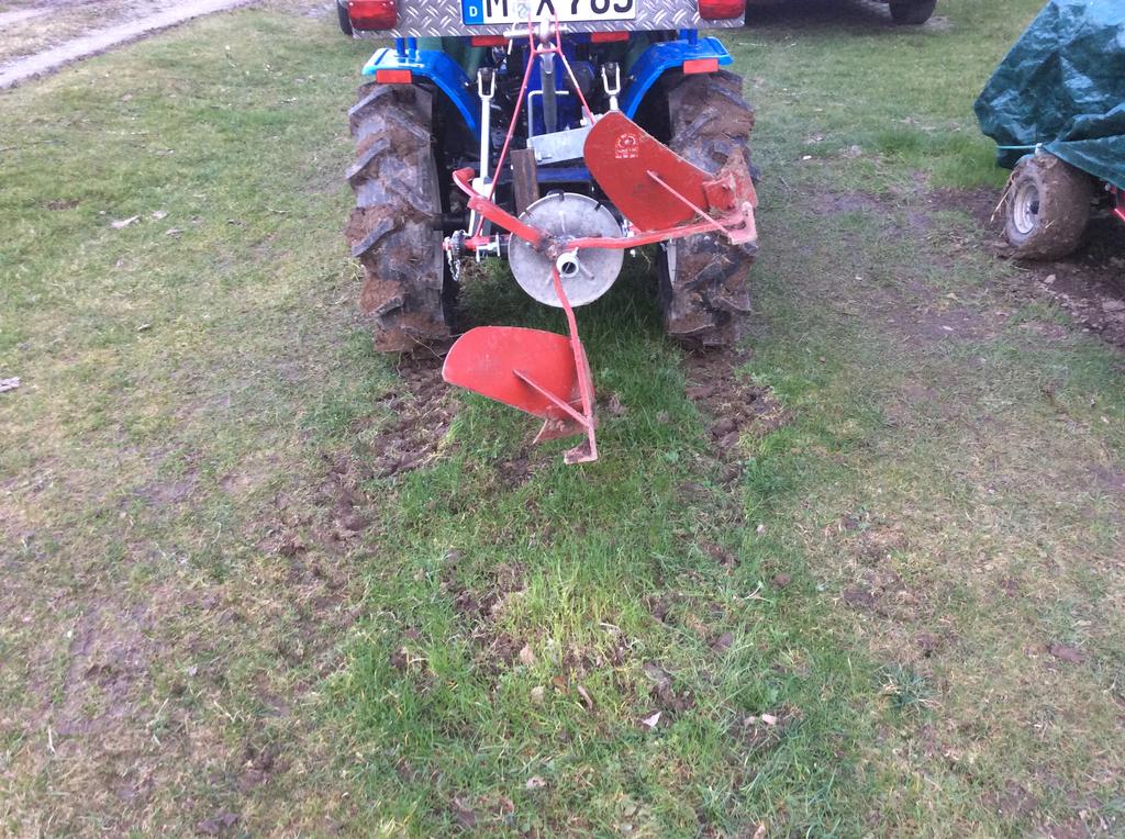

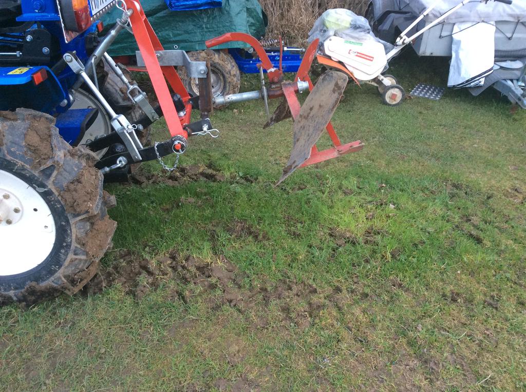

Tractorhead 9,217 #4194 Posted March 14, 2020 after a second try, the soil still was further too wet to get good traction and the slip was still too much to plow deeper, because of that i changed my plans. therefore i grabed my secret Weapon, the 4WD Beast. firstly i adapted the turn plow to the prepared 3 Point. For the horse i planing another adapt, what can be seen in background. Therefore i used a bended Metalplate, what works for my mounting point. As you can see on the tyres, it works. The own Weight of 650Kilos and the 4WD was a blast. if that‘s not enough, i have and difflock in spare. it pulls even in Idle complete to the ground. Because of the longer AS Paddles it develops more grip even in wet Soil. I be satisfied so far. Next will be the adaptation of the Tiller to the Back of the Horse 2 Share this post Link to post Share on other sites

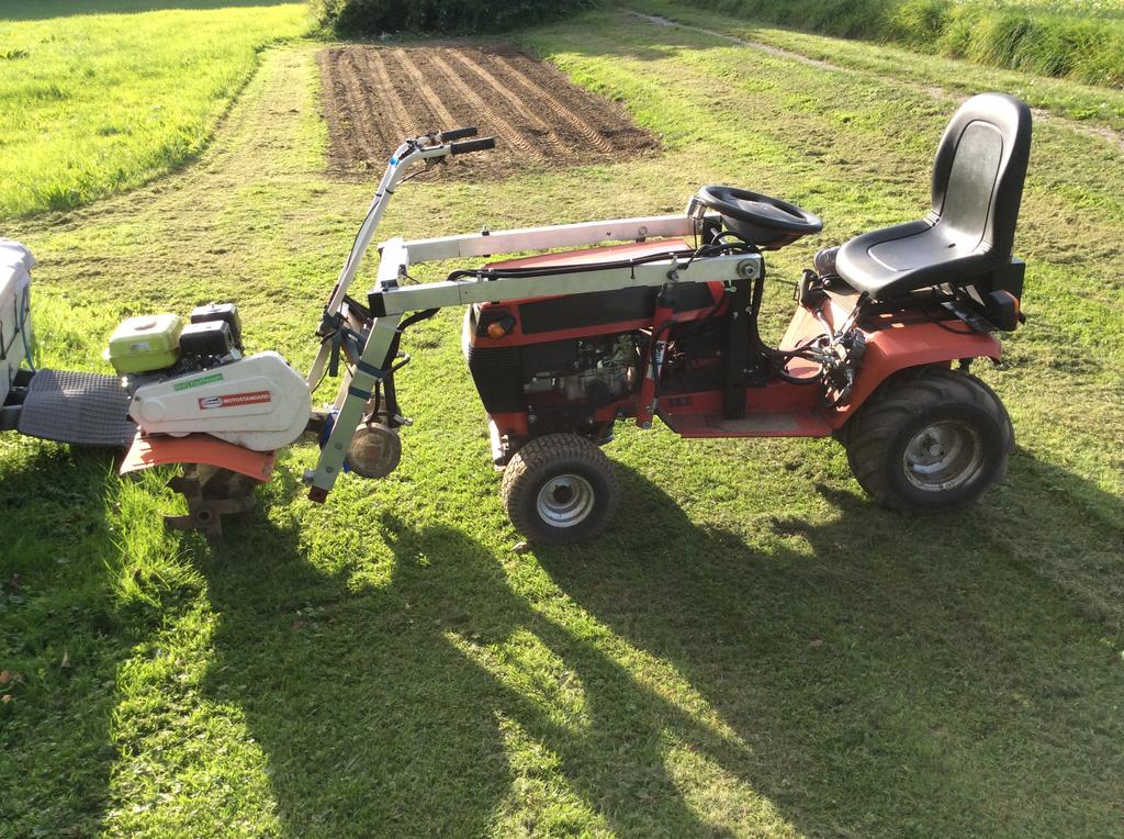

Ed Kennell 47,097 #4195 Posted March 14, 2020 22 minutes ago, Tractorhead said: Next will be the adaptation of the Tiller to the Back of the Horse Or put the tiller on the front. 2 1 Share this post Link to post Share on other sites
Tractorhead 9,217 #4196 Posted March 14, 2020 I did this in the last try, but i have to drove over the loosened soil an repress it. that was a proof of concept i‘m not satisfied with the result that much. i think if the tiller is in back, it works better. i like to do it in oposite, to keep the Soil 6 Share this post Link to post Share on other sites
ebinmaine 80,449 #4197 Posted March 15, 2020 1 hour ago, Tractorhead said: I did this in the last try, but i have to drove over the loosened soil an repress it. that was a proof of concept i‘m not satisfied with the result that much. i think if the tiller is in back, it works better. i like to do it in oposite, to keep the Soil Trina says tell him to go in reverse 1 Share this post Link to post Share on other sites
953 nut 68,747 #4198 Posted March 15, 2020 10 hours ago, ebinmaine said: Trina says tell him to go in reverse If you turn the tiller around and back up each pass there will be no compaction. 1 Share this post Link to post Share on other sites
The Tuul Crib 7,354 #4199 Posted March 15, 2020 On 3/12/2020 at 7:54 PM, Lane Ranger said: Picked up another parts Wheel Horse RJ today! Saved for ten years by the previous owners father and he just did not get time to redo for his daughter. Three front wheels and two nice rear wheels. No motor nd steering tight. I bought mostly for the transmission which is very greasy and that is usually a good sign! Plus it has been inside for the last ten years! looks like I might be able to save the front wheels and rear wheels with Opps not B F Goodrich but Goodyear Sure Grips! Interesting set of genders and gender frame in this! I guess owner did not have the toolbox and Wheel Horse fender set on the tractor. And the RJ mower deck is not in terrible condition either! Not bad for all at $60 ! IMG_1158.MOV 1.24 MB · 0 downloads Nice catch lane !! That should keep you busy for a while! Share this post Link to post Share on other sites
Lane Ranger 12,094 #4200 Posted March 15, 2020 4 minutes ago, The Tool Crib said: Nice catch lane !! That should keep you busy for a while! Yes it is a quarantined/sequestered special l! 1 1 Share this post Link to post Share on other sites
