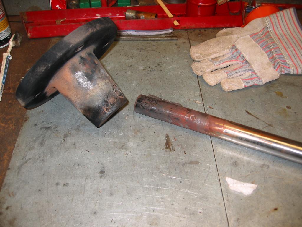

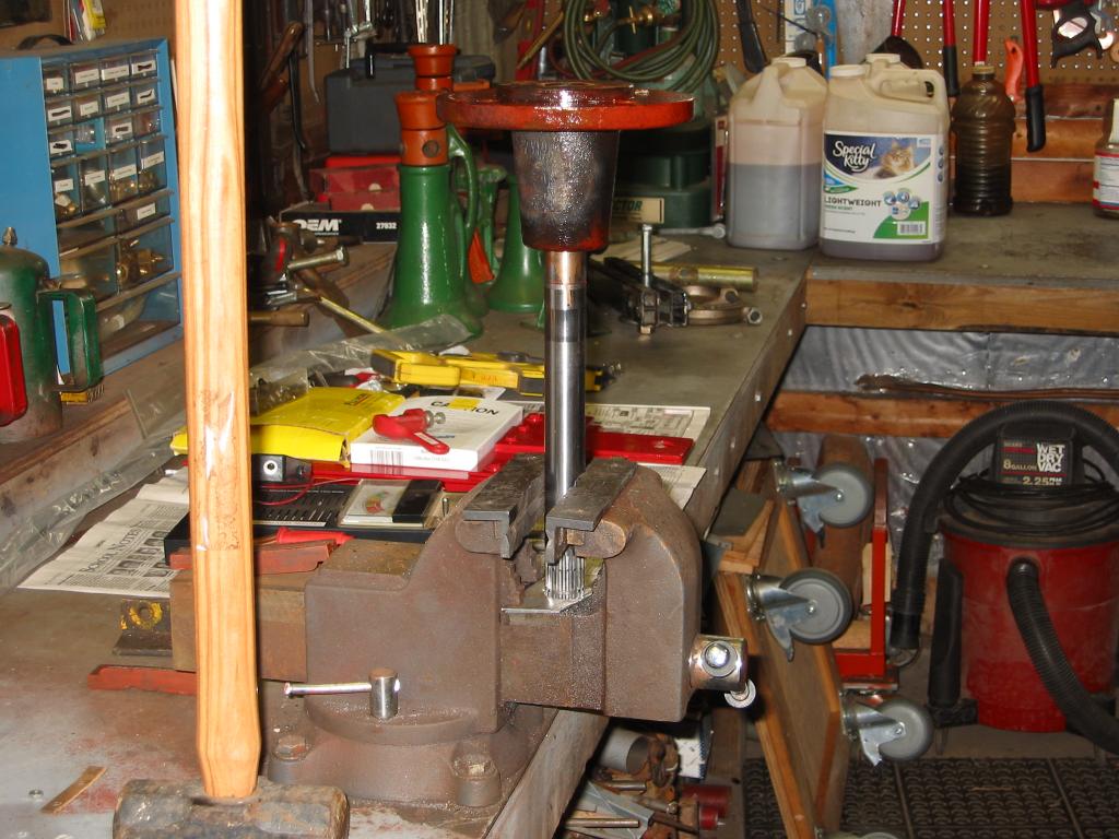

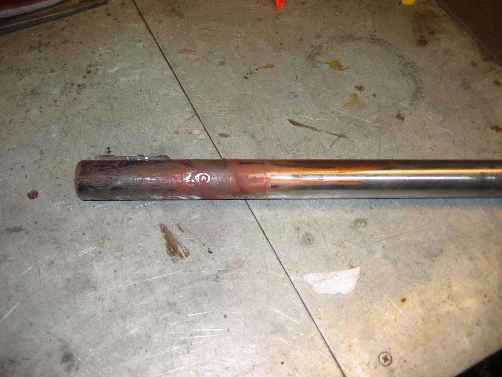

pfrederi 21,246 #3933 Posted January 19, 2020 Yesterday afternoon roasted it at 325 degrees for 45 minutes then plunged it back into the ATF/Acetone mix. Acetone boiled pretty good . Left it to cool then put it out in the snow this morning. Set it up in a vice with some aluminum under the axle splines and wailed away with a sledge (Pic 1). Nada. Back into the press still nada. Left it under pressure in the press and got out the torch set. heated it in the press till I just about ran out of gas. Still under pressure grabbed a ball peen hammer and wailed away at the side of the hub then a small snap sound and it had moved . I was pulling so hard on the press handle i had bent it had to use a tire iron and hang on it but i moved. It fought all the way out. The heating set all the residual ATF on fire and it got smokey. Didn't particularly love the smell but to paraphrase LTC Kilgore (aka Robert Duvall) it smelled like VICTORY!!!!! 9 Share this post Link to post Share on other sites

Shed 377 #3935 Posted January 19, 2020 Awesome glad to see that happen for you that was really on there 1 1 Share this post Link to post Share on other sites
ebinmaine 81,000 #3936 Posted January 19, 2020 @balconio. @Sparky Mike runs something similar to those. I seem to remember he likes them. @pfrederi AWESOME. Just excellent. Victory. Share this post Link to post Share on other sites
Tractorhead 9,217 #3937 Posted January 19, 2020 Congrats to your Victory after a long hard fight, what can be more satisfied. 👍 2 Share this post Link to post Share on other sites

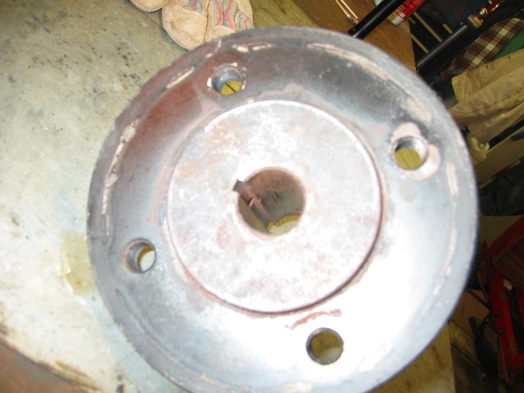

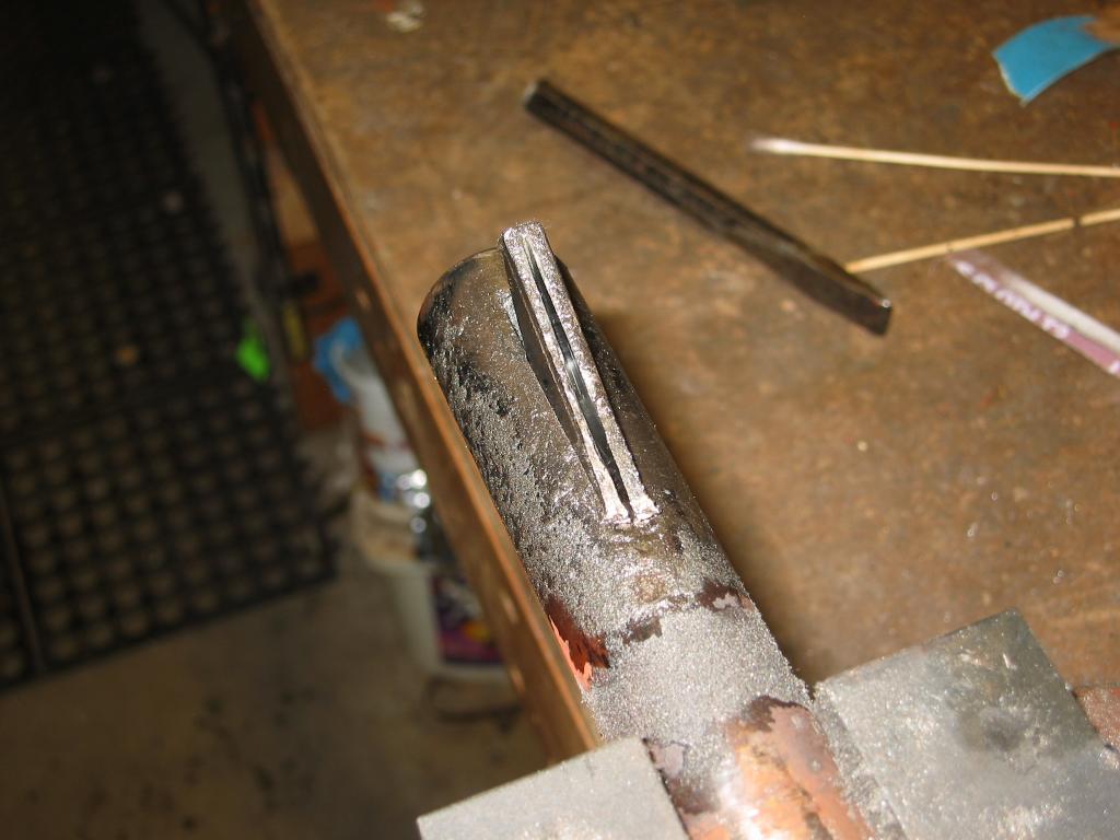

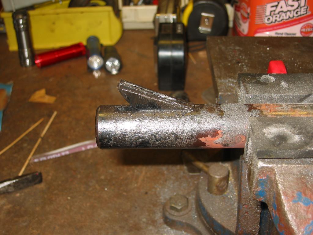

pfrederi 21,246 #3943 Posted January 20, 2020 One last fight...The woodruff key did not want to leave its home. Had to use the dremel cut off wheel to slit it then chisel to collapse the sides a bit. 3 2 1 Share this post Link to post Share on other sites
Tractorhead 9,217 #3944 Posted January 20, 2020 Oh whow, that looks it was grown together. no wonder, you had such a fight to remove the Hub.. 1 Share this post Link to post Share on other sites

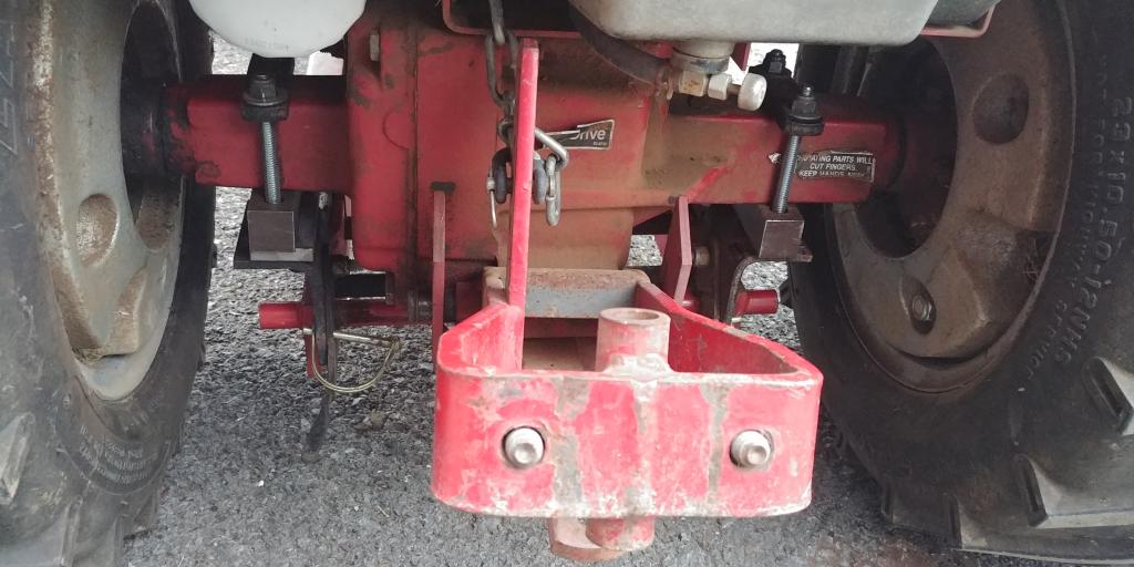

Lane Ranger 12,153 #3945 Posted January 23, 2020 (edited) Mowed up the last of the Fall leaves in the front yard today! Going to rain, snow and sleet the next four or five days according to the big storm weather reports so last good day to do this job without being in a muddy mess! plus I got the trailer out for a Saturday trip to round up some more round hoods! More What’s in My Rearview Mirror Pics will come on Saturday ! Edited January 23, 2020 by Lane Ranger spelling 2 4 3 Share this post Link to post Share on other sites
Tractorhead 9,217 #3946 Posted January 23, 2020 Nice gadget the front hook. no bad idea for easy directing a trailer into small places or edges 1 Share this post Link to post Share on other sites
Lane Ranger 12,153 #3947 Posted January 23, 2020 2 minutes ago, Tractorhead said: Nice gadget the front hook. no bad idea for easy directing a trailer into small places or edges Yes I bought on Ebay. Guy making them makes them so you can place the mule drive on and keep the front hitch attached at the same time. 2 2 Share this post Link to post Share on other sites
Tractorhead 9,217 #3948 Posted January 23, 2020 Good idea, definitely 1 Share this post Link to post Share on other sites

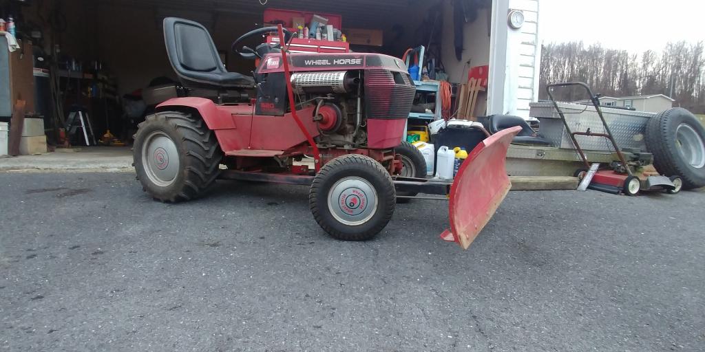

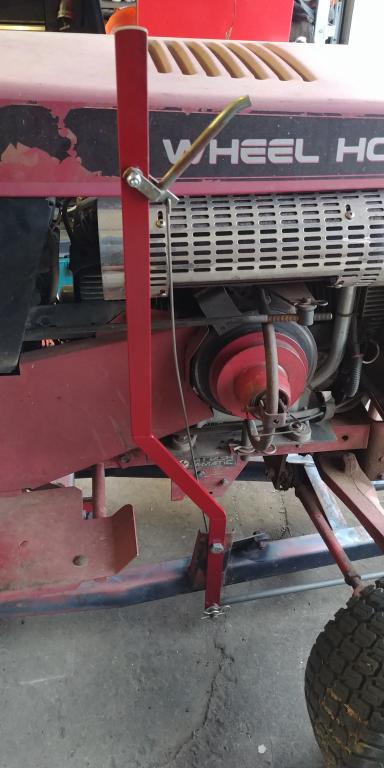

WVHillbilly520H 10,379 #3949 Posted January 24, 2020 Installed my riser blocks for the rear attach-a-matic to lift the snow/dozer blade higher on the 520H. Added an extra bit on the left side to "level" out blade from the twisted A frame. Also installed the new angle lever I fabbed up last spring. 4 8 Share this post Link to post Share on other sites
WHX?? 58,308 #3950 Posted January 24, 2020 Ya know Billy we don't particularly approve of hydros for plowing but with that rear end setup it would be interesting to drop a 12 on the back of that rig at my plow day just to see where the bear crapped in the buckwheat! Maybe just to see if we could light up the hi temp hydro light! Geez thinkin like a redneck now ... 5 Share this post Link to post Share on other sites
