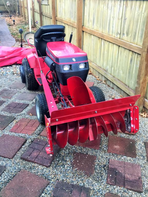

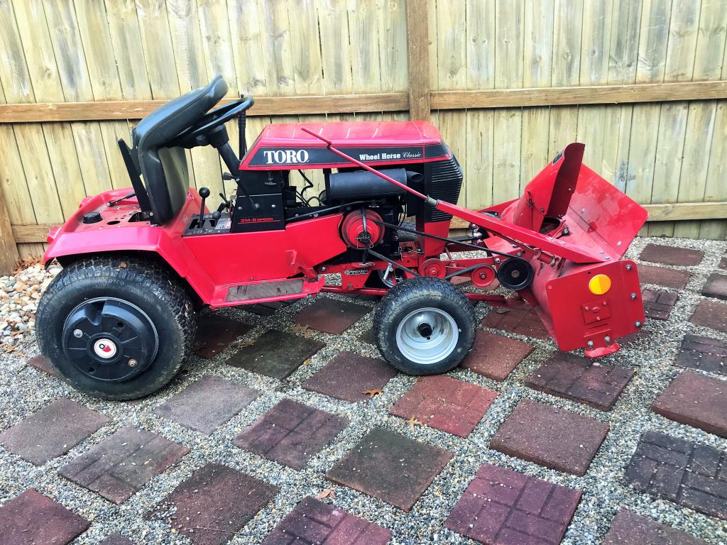

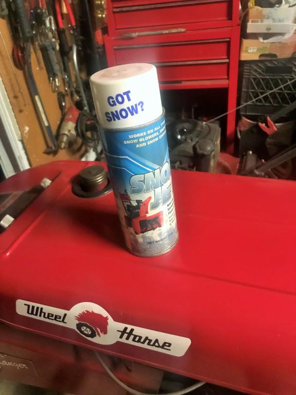

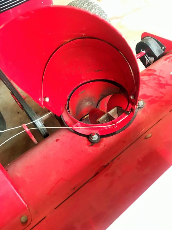

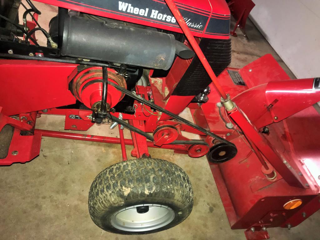

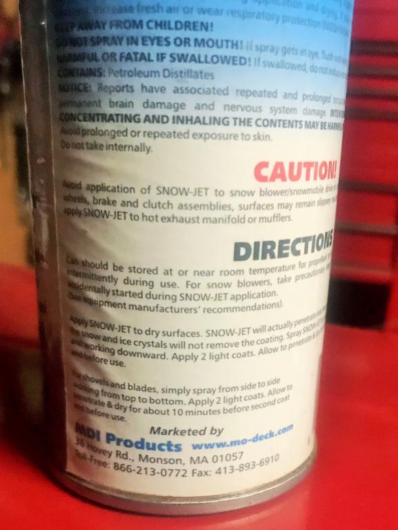

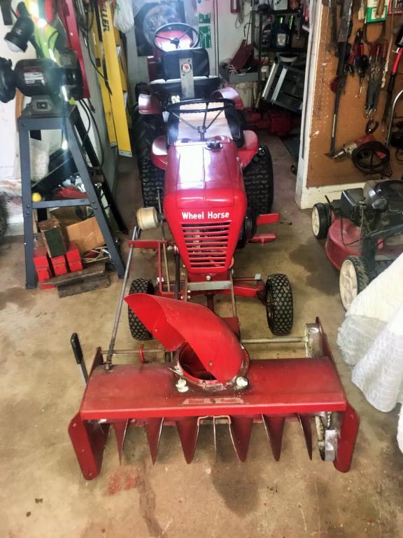

peter lena 10,098 #3730 Posted December 14, 2019 LANE RANGER , good going on that blower pick up, take advantage of its condition and thoroughly lubricate every moving frictional point. especially stay after the gear drive/ chain to auger area, and related chain tension. good picture of the belt pulley belt tension frame, lubricate every movement point for belt drive smoothness. also use a polymer snow spray on it to increase its function. i use a SERATED washer on the chain adjustment point to hold its tension. pete 1 Share this post Link to post Share on other sites

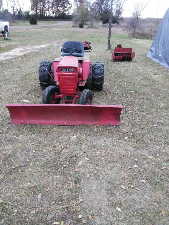

mr biggs 187 #3731 Posted December 14, 2019 On 12/10/2019 at 7:32 PM, ebinmaine said: Yepp.... Single tires. Chains. LOTS of weight. What in theeee world size is that plow??? It's a 72" plow it started out as a 54" but of course I had to make it great again LOL works good because my driveway is 350 ft and I run full speed with the plow at an angle turn around and come back really keeps the clean path 1 3 1 Share this post Link to post Share on other sites
Lane Ranger 12,153 #3732 Posted December 14, 2019 1 hour ago, peter lena said: LANE RANGER , good going on that blower pick up, take advantage of its condition and thoroughly lubricate every moving frictional point. especially stay after the gear drive/ chain to auger area, and related chain tension. good picture of the belt pulley belt tension frame, lubricate every movement point for belt drive smoothness. also use a polymer snow spray on it to increase its function. i use a SERATED washer on the chain adjustment point to hold its tension. pete Peter: I used chain lube on everything I could find. Hooked up the lift assist spring today on the flag. I had the old version and the new version lift flag with the spring. I use the lift assist spring on my tiller and I think it is heavier thatn the snowblower. When putting on the lift assist spring I has to use narrow wall washers to allow the eyebolt to clear the lift flag hole. All set now and she runs pretty powerful with the 14 horse Kohler Magnum as compared to my Lawn Ranger with 32 inch blower and a 6 HP Tecumseh. This will be my first winter using a full sized 42 inch snowblower on a wheel horse tractor. The bog snowblower clears my 314 front hitch also (which I was thinking I might have to remove to fit the blower on). 3 1 Share this post Link to post Share on other sites

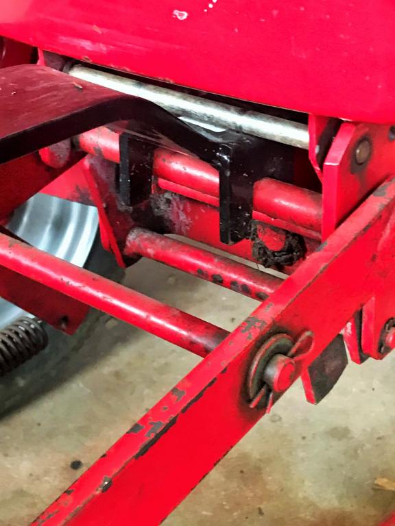

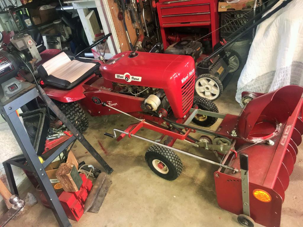

peter lena 10,098 #3734 Posted December 14, 2019 good talking lane, this what i did for blower lift assist , also added the chute direction smooth knob for mitten use, scary to think that we are trying to make things better and easier , i would like to swap/ exchange other improvements with you, if you would like just send me a " what are you doing about this " , have a good holiday , pete 1 Share this post Link to post Share on other sites

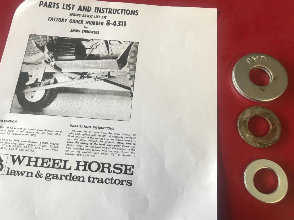

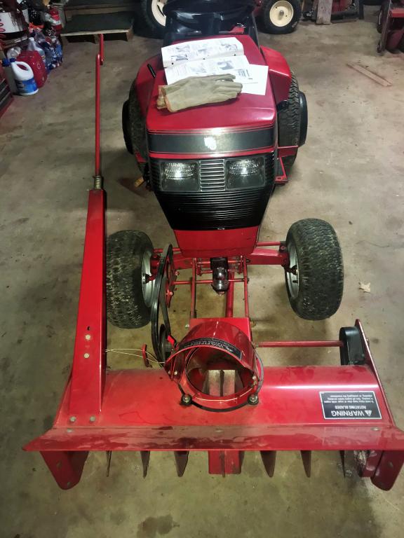

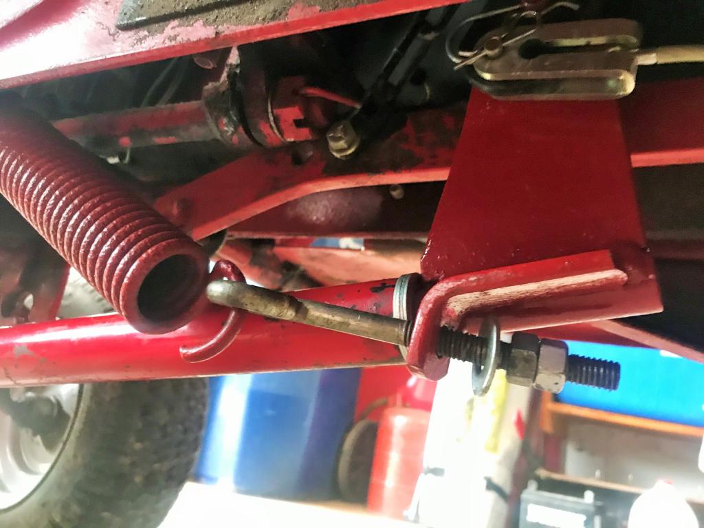

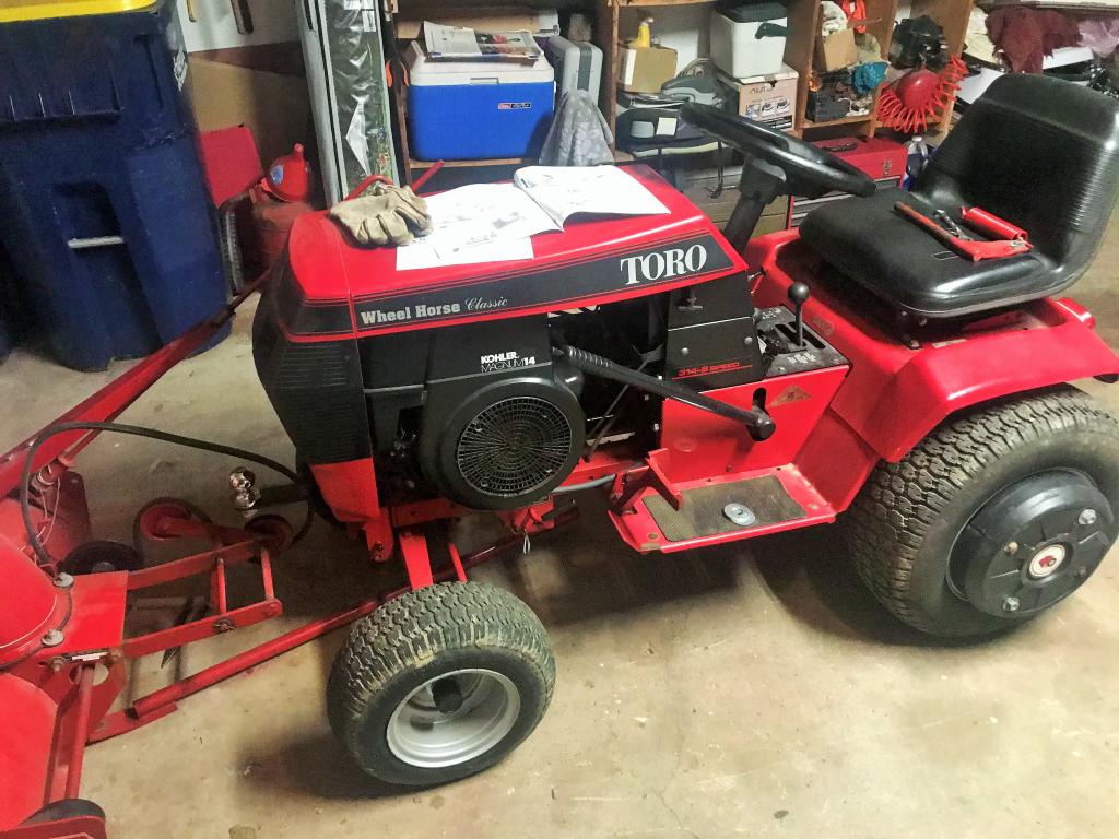

cleat 9,389 #3737 Posted December 14, 2019 4 hours ago, Lane Ranger said: Peter: I used chain lube on everything I could find. Hooked up the lift assist spring today on the flag. I had the old version and the new version lift flag with the spring. I use the lift assist spring on my tiller and I think it is heavier thatn the snowblower. When putting on the lift assist spring I has to use narrow wall washers to allow the eyebolt to clear the lift flag hole. All set now and she runs pretty powerful with the 14 horse Kohler Magnum as compared to my Lawn Ranger with 32 inch blower and a 6 HP Tecumseh. This will be my first winter using a full sized 42 inch snowblower on a wheel horse tractor. The bog snowblower clears my 314 front hitch also (which I was thinking I might have to remove to fit the blower on). You can likely use the side plates on that blower as well to gain a bit more width. I would think that 14 HP would still drive it. Good looking setup. 1 Share this post Link to post Share on other sites
Lane Ranger 12,153 #3738 Posted December 14, 2019 58 minutes ago, cleat said: You can likely use the side plates on that blower as well to gain a bit more width. I would think that 14 HP would still drive it. Good looking setup. I just set the side plates aside and wanted to see how it does this winter without them on first. 58 minutes ago, cleat said: Share this post Link to post Share on other sites

MikMacMike 494 #3741 Posted December 14, 2019 1 hour ago, cleat said: You can likely use the side plates on that blower as well to gain a bit more width. I would think that 14 HP would still drive it. Good looking setup. I'm still not sure as to the actual power difference between the magnum and the older k series, but there is a weight difference if you look at specs. I don't ever go by horsepower either.....always torque! Hp is just a timed equation of torque, hence all the combinations of bore n stroke motors not to mention velocity or momentum as with differing weight..." flywheels etc etc"......but i will say this if the magnum your using is anywhere comparable to the 12 horse K301( I use 12 horse only for labeling purpose) and my snowblower is also a single stage, be it a short shoot too, I can send dry fluff at any depth....1 foot up to 5 foot drifts at least 20 feet......5 footers I go in 1st with the blower raised in transport position while running, and as far as I can go before loosing all traction, I back up lower it and go in for the killer blow. Wet stuff is a mind of its own.....full throttle and slow, but make darn sure you haven't any rust in the shoot......it has to slide through completely unhindered...yes some use Teflon, wd-40 etc etc but nothing beats a glossy smooth shoot so as it wont stick and build up eventually clogging. I have had a bit of a idea Ive not tried yet but to hope to sometime is routeing the exhaust is critical areas that the wet snow sticks to.....whether it would work we will have to see, but i think a 14 has to equal or be may be a bit more stout the the k 12 hp and mine is old n need of a rebuild. Up here in the hinter land we get dumped on but good.....I do imagine some of the north easter coasters have some great bits to add also, they also go through tremendous dumps in glacier season!!! 1 Share this post Link to post Share on other sites
MikMacMike 494 #3742 Posted December 14, 2019 8 hours ago, mr biggs said: It's a 72" plow it started out as a 54" but of course I had to make it great again LOL works good because my driveway is 350 ft and I run full speed with the plow at an angle turn around and come back really keeps the clean path tower this is 747 wh, request landing! Holy crap....2 driveways at once, I dont think my chevy Tracker would bush that beast! Looks so rad though...........hey outta the way, comin through hahahahahah. 3 Share this post Link to post Share on other sites

ebinmaine 81,000 #3744 Posted December 14, 2019 9 hours ago, mr biggs said: 72" plow it started out as a 54" but of course I had to make it great again LOL works good because my driveway is 350 ft and I run full speed with the plow at an angle turn around and come back really keeps the clean path That's pretty awesome.... I'd be curious to see if you got the tires to heavy singles how it go. Share this post Link to post Share on other sites

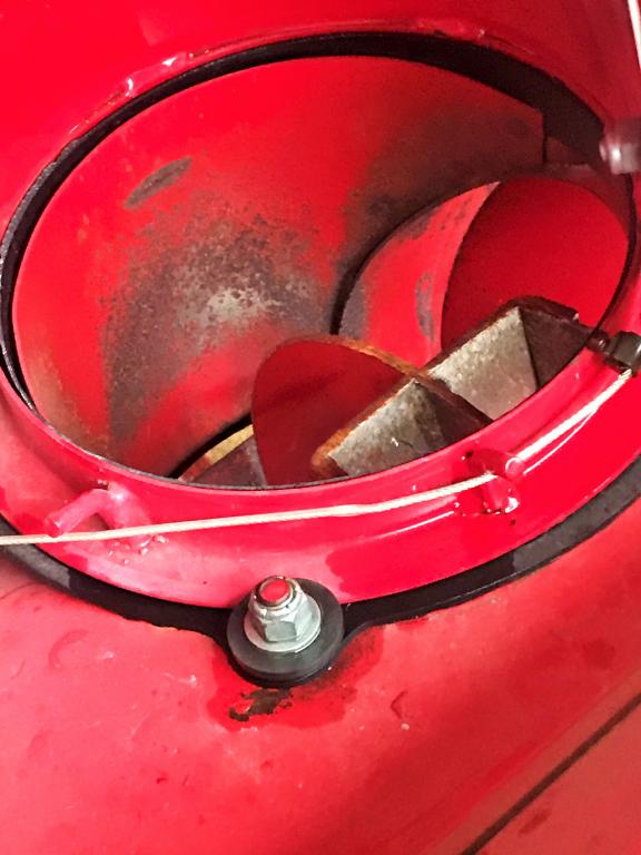

8ntruck 9,356 #3745 Posted December 14, 2019 You guys are talking about keeping the snow thrower chutes smooth and slippery. Anybody consider chrome plating the inside of the chute? A good copper/nickel/chrome plating job would be smooth, slippery, and durable. Might need special electrodes to get good coverage on the inside of the chute, though. 1 Share this post Link to post Share on other sites
Pullstart 71,451 #3746 Posted December 15, 2019 1 hour ago, 8ntruck said: You guys are talking about keeping the snow thrower chutes smooth and slippery. Anybody consider chrome plating the inside of the chute? A good copper/nickel/chrome plating job would be smooth, slippery, and durable. Might need special electrodes to get good coverage on the inside of the chute, though. Bill I imagine running over a pile of 100 dollar bills and running right up the shoot 1 1 Share this post Link to post Share on other sites
Lane Ranger 12,153 #3747 Posted December 15, 2019 (edited) 14 hours ago, MikMacMike said: I'm still not sure as to the actual power difference between the magnum and the older k series, but there is a weight difference if you look at specs. I don't ever go by horsepower either.....always torque! Hp is just a timed equation of torque, hence all the combinations of bore n stroke motors not to mention velocity or momentum as with differing weight..." flywheels etc etc"......but i will say this if the magnum your using is anywhere comparable to the 12 horse K301( I use 12 horse only for labeling purpose) and my snowblower is also a single stage, be it a short shoot too, I can send dry fluff at any depth....1 foot up to 5 foot drifts at least 20 feet......5 footers I go in 1st with the blower raised in transport position while running, and as far as I can go before loosing all traction, I back up lower it and go in for the killer blow. Wet stuff is a mind of its own.....full throttle and slow, but make darn sure you haven't any rust in the shoot......it has to slide through completely unhindered...yes some use Teflon, wd-40 etc etc but nothing beats a glossy smooth shoot so as it wont stick and build up eventually clogging. I have had a bit of a idea Ive not tried yet but to hope to sometime is routeing the exhaust is critical areas that the wet snow sticks to.....whether it would work we will have to see, but i think a 14 has to equal or be may be a bit more stout the the k 12 hp and mine is old n need of a rebuild. Up here in the hinter land we get dumped on but good.....I do imagine some of the north easter coasters have some great bits to add also, they also go through tremendous dumps in glacier season!!! Thanks Mike! Very good and detailed information. The chute on this snowblower I bought is so clean I just could not believe it was a 1985 model! I will get that one lower spot painted when warm weather returns in 2020! Looks like we may get some of the snow today and tomorrow in Central Indiana . We are seven miled north of I-70 which generally is a dividing line between snow and ice during storms from the west. North and northwest storms into Indiana tend to have the lighter, fluffier snows. I use Sno-Jet on my chute as a coating. Used it for years on my Lawn Ranger Snowblower chute. It was the recommended product the Ariens company recommended for snowblowers (this Wisconsin Company was one of the first snowblower manufacturers). Sno-Jet works very well when the snow is wet too. Edited December 15, 2019 by Lane Ranger 2 1 1 Share this post Link to post Share on other sites
MikMacMike 494 #3748 Posted December 15, 2019 3 hours ago, Lane Ranger said: Thanks Mike! Very good and detailed information. The chute on this snowblower I bought is so clean I just could not believe it was a 1985 model! I will get that one lower spot painted when warm weather returns in 2020! Looks like we may get some of the snow today and tomorrow in Central Indiana . We are seven miled north of I-70 which generally is a dividing line between snow and ice during storms from the west. North and northwest storms into Indiana tend to have the lighter, fluffier snows. I use Sno-Jet on my chute as a coating. Used it for years on my Lawn Ranger Snowblower chute. It was the recommended product the Ariens company recommended for snowblowers (this Wisconsin Company was one of the first snowblower manufacturers). Sno-Jet works very well when the snow is wet too. Thats the ticket. Share this post Link to post Share on other sites
