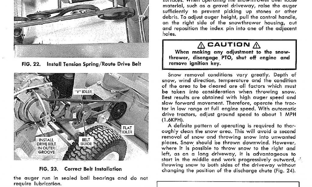

pfrederi 21,246 #3604 Posted December 3, 2019 1 hour ago, Stepney said: The bushing and bolt seemed pretty tight and I imagine the blower has little use, since I know the machine it came off of. (Pre Tach a Matic) I am on the inner PTO pulley, thats what the diagram in my owners book showed to use. Maybe so but other single stage manuals show the smaller outer pulley and that is what I use on Electro 16... try switching see if that helps??? Share this post Link to post Share on other sites

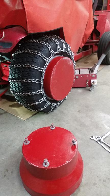

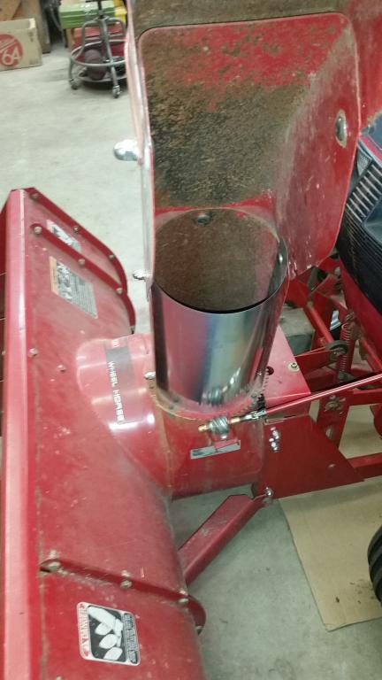

WHX?? 58,308 #3606 Posted December 3, 2019 (edited) FINALLY getting the final touches on this rig. Put these wheel weights on the 520 tonite on loan from Jack. Kind of pain to put on Josh but will be well worth it we get some snow I'm sure. Also fitted with Hillbillie's mandatory sno chute. Just waiting for Dan to get "grilling" and burn some things for me! Many thanks to Hillbilly Jeff, NEPA Kurt and Brian aka Super C for the lift rod and helping me put this thing together. Best advice to those who want to join the deuce bag club is buy one that is all there! Edited December 3, 2019 by WHX24 7 5 1 Share this post Link to post Share on other sites
PeacemakerJack 11,080 #3607 Posted December 3, 2019 those weights look good with some fresh red on them and they are yours now! I can’t wait to see some video of that beast clearing your driveway into the neighbors 1 2 1 2 Share this post Link to post Share on other sites
WHX?? 58,308 #3608 Posted December 3, 2019 (edited) They must have been for shallow dish rims Jack as I had to add 3/8 rod couplers and a 2 in piece of all thread for them to make the distance. Still very heavy and should work out fine. Might be better suited for a plow tractor?!? Edited December 3, 2019 by WHX24 1 2 Share this post Link to post Share on other sites
ebinmaine 81,000 #3609 Posted December 3, 2019 5 hours ago, WHX24 said: heavy Yeah... Them are about a weight and a half aren't they... Rig looks good Jim. 1 1 Share this post Link to post Share on other sites

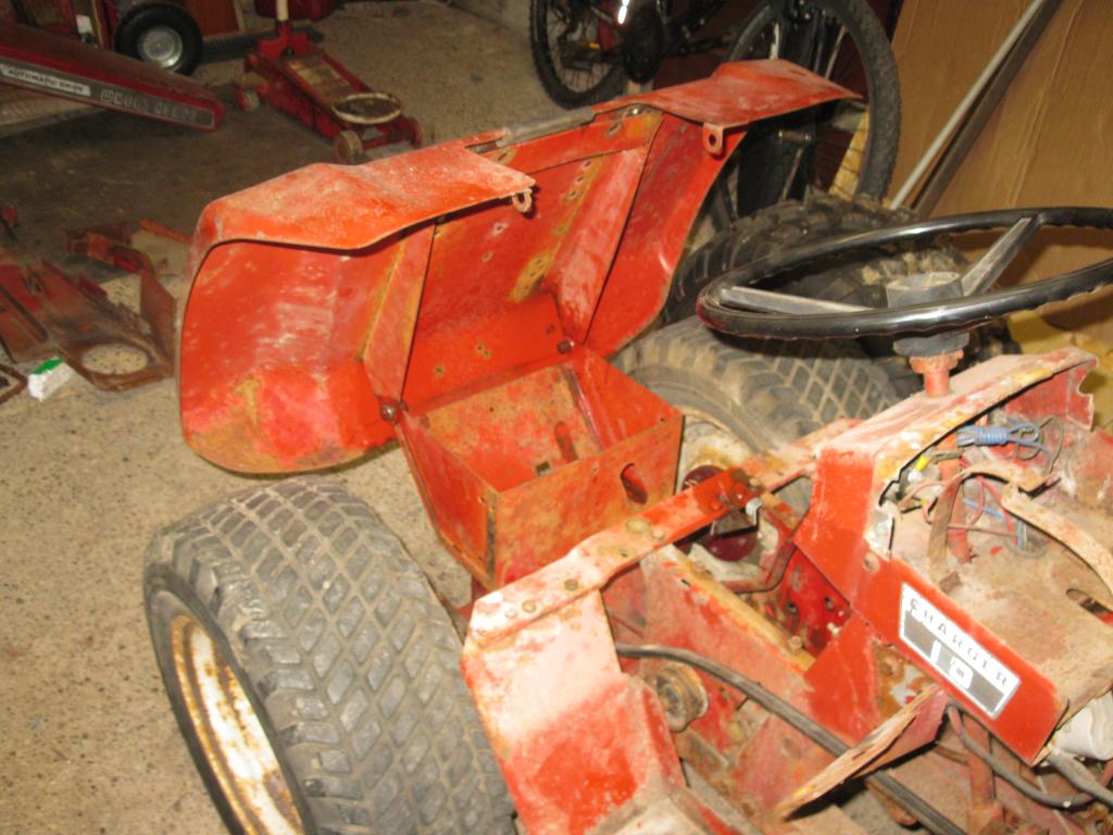

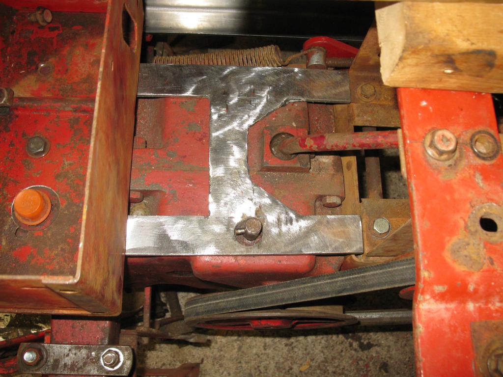

MikMacMike 494 #3612 Posted December 3, 2019 This is where the enlarged gas tank will be placed....still hidden....figure about 5.1 to almost 6 gal worth. I also needed clearance for the atv boots, Ill be changing the front spindles to full bearing 4 lug 8" rims. There sure is alot more room in the back once I replaced the Hydro to 8 speed. Not much room anywhere on wheel horses and it sure put a squeezing feeling on this old farts brain cells trying to fit what I want on it. 3 Share this post Link to post Share on other sites
Lee1977 7,805 #3613 Posted December 3, 2019 45 minutes ago, MikMacMike said: This is where the enlarged gas tank will be placed....still hidden....figure about 5.1 to almost 6 gal worth. I also needed clearance for the atv boots, Ill be changing the front spindles to full bearing 4 lug 8" rims. There sure is alot more room in the back once I replaced the Hydro to 8 speed. Not much room anywhere on wheel horses and it sure put a squeezing feeling on this old farts brain cells trying to fit what I want on it. May need to rasis the steering wheel to. i just raised my fender 1 3/4" on my 312-8 and raised the steering wheel 2 3/4". " 1 Share this post Link to post Share on other sites

MikMacMike 494 #3615 Posted December 4, 2019 6 hours ago, Lee1977 said: May need to rasis the steering wheel to. i just raised my fender 1 3/4" on my 312-8 and raised the steering wheel 2 3/4". " Oh absolutely, once I get a good seat and a measure on it. I needed the clearance to house the 25x11-12 boots. With 4 lbs. psi there just under 25" tall leaving me no room just in-case I put the chains on. There a good 26 to almost 27" at 12 to 18 lbs. I knew I was going to relocate the gas tank back there also and after measuring I came up with around 3" of lift. Lots of room for chains now, LOL.Dam whats the poundage on those weights? They look mighty serious too. Are they cast or steel? I was pondering of ripping all the old batteries apart and casting so lead weights, but those like I said look seriouse. Share this post Link to post Share on other sites

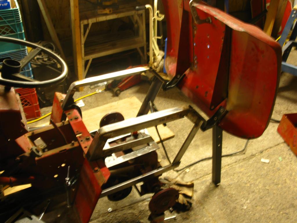

balconio 606 #3621 Posted December 4, 2019 9 hours ago, Lee1977 said: May need to rasis the steering wheel to. i just raised my fender 1 3/4" on my 312-8 and raised the steering wheel 2 3/4". " I just assumed 26x9x12 ATV tires (ITP mudlites with 1" deep treads) would fit my 312-8 by lifting the seat tins a bit with spacers. I see now running that size might be more of a problem clearing the footrest tins. I guess it'd be a good excuse to try out my brother's new plasma cutter or get crazy with the BFH. How exactly did you raise the steering wheel? Share this post Link to post Share on other sites

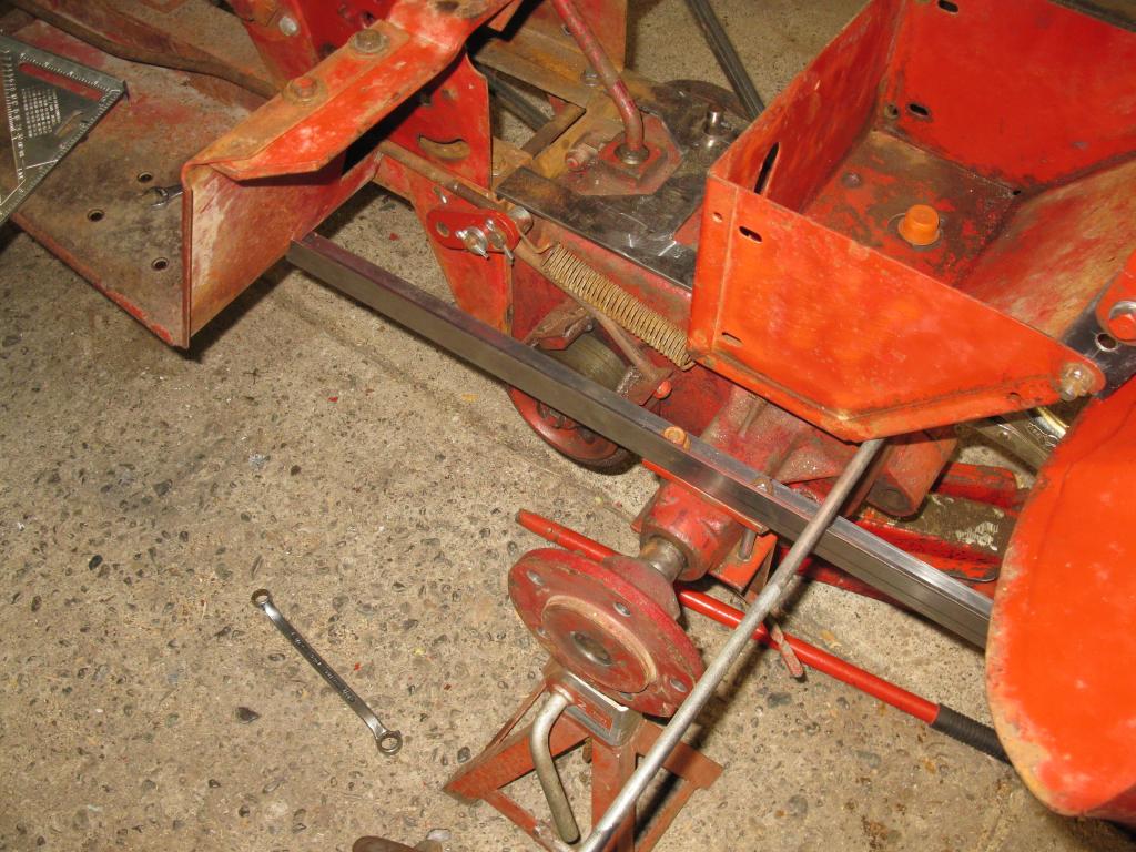

MikMacMike 494 #3622 Posted December 4, 2019 10 hours ago, balconio said: I just assumed 26x9x12 ATV tires (ITP mudlites with 1" deep treads) would fit my 312-8 by lifting the seat tins a bit with spacers. I see now running that size might be more of a problem clearing the footrest tins. I guess it'd be a good excuse to try out my brother's new plasma cutter or get crazy with the BFH. How exactly did you raise the steering wheel? Hello baconio, Sure no problem, at the moment ive got (lets call it the spacer cage) it apart because everything was just tacked together. Today Ill be welding it proper. But what Ill do is once its together I can show you in more detail. I havnt raised the steering wheel as of yet but I will say the steering wheel will be much easier. I too was far too close with the foot rests. I dont know if your machin has the same cross bar that attaches the foot rests and if it does I noticed that the foot restsmounted under that cross bar. So I unbolted the top and left the bottoms bolted in place for alignment. I carefully bent the foot rests upwards so as to mount on top of the cross bar. So the bolt holes to match back up I only bolted the cross bar to the foot rest NOT the center consle. this puts the cross bar on an angle toward the front of the tractor. Using 2 very large adjustable wrenches I pulled the cross bar back to a straight position (horizontal). Now youll notice the bolt holes where the crossbar mounts to the center consle doesnt align. But alas it only moves it about 1". I marked the holes from underneath, drilled them and voila it all came together. As for making a latch to keep the seat body and fenders closed, I havnt gotten to that point yet. 1st pic is the origonal position, as you can see I gain a sheesh load of room to where I am locating the gas tank by switching to 8 speed from hydro. If I run hydrolics Id rather run a proper pump right off the engine instead of tapping into the sunstrand. Pic 2 you can see the foot rest is now mounted above the cross bar. I just made sure when I was bending that the both footrests were still atached so as to make sure of alignment. pic 3 you can see in the upper right corner. The bolts are 1 " back on the cross bar. In fact its the cross bar that moves 1" forward. This gives me a ton of room. I hope this helps. These tires Im using as soon as you put anything around 10 to 18 lbs of air pressure the expand tremendously, plus in that state they dont have the wide look I wanted, an undersight on my part. But at 5 psi they settle down in size and look great. I just hope it all works or its back to the drawing board, LOL. Share this post Link to post Share on other sites

Lee1977 7,805 #3624 Posted December 4, 2019 13 hours ago, balconio said: I just assumed 26x9x12 ATV tires (ITP mudlites with 1" deep treads) would fit my 312-8 by lifting the seat tins a bit with spacers. I see now running that size might be more of a problem clearing the footrest tins. I guess it'd be a good excuse to try out my brother's new plasma cutter or get crazy with the BFH. How exactly did you raise the steering wheel? I cut it add a piece of 1 1/4 that we drilled out welded to bottom end and bolted the top. It will stil come out of the dash. 1 Share this post Link to post Share on other sites
Lee1977 7,805 #3625 Posted December 4, 2019 16 hours ago, MikMacMike said: Oh absolutely, once I get a good seat and a measure on it. I needed the clearance to house the 25x11-12 boots. With 4 lbs. psi there just under 25" tall leaving me no room just in-case I put the chains on. There a good 26 to almost 27" at 12 to 18 lbs. I knew I was going to relocate the gas tank back there also and after measuring I came up with around 3" of lift. Lots of room for chains now, LOL.Dam whats the poundage on those weights? They look mighty serious too. Are they cast or steel? I was pondering of ripping all the old batteries apart and casting so lead weights, but those like I said look seriouse. There is two 1 1/4" boiler plate cut outs each side around 80# each side. We turned the inside ones down to fit in the wheels. Share this post Link to post Share on other sites
