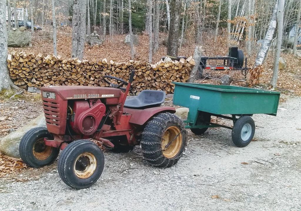

Trina and her mom spent some time moving and stacking wood that we'll be able to use next season.
This is her 867 known as "my otha tracta" or "pigpen".
The trailer is a 1976/77 Ohio Steel brand. Note the round tongue.

Oh dang thats exactly what I was wondering about on the geni starter shroud. The other one I saw was closed on the cooling intake. The one in your pic is open. I think if I go with the geni starter set up definitely have to search for one of those shrouds. Oh and also a great calendar pic Id say!! This wheel horse is so close looking to mine....I love the old tiny ones but this style front end I think is by far the best looking too.

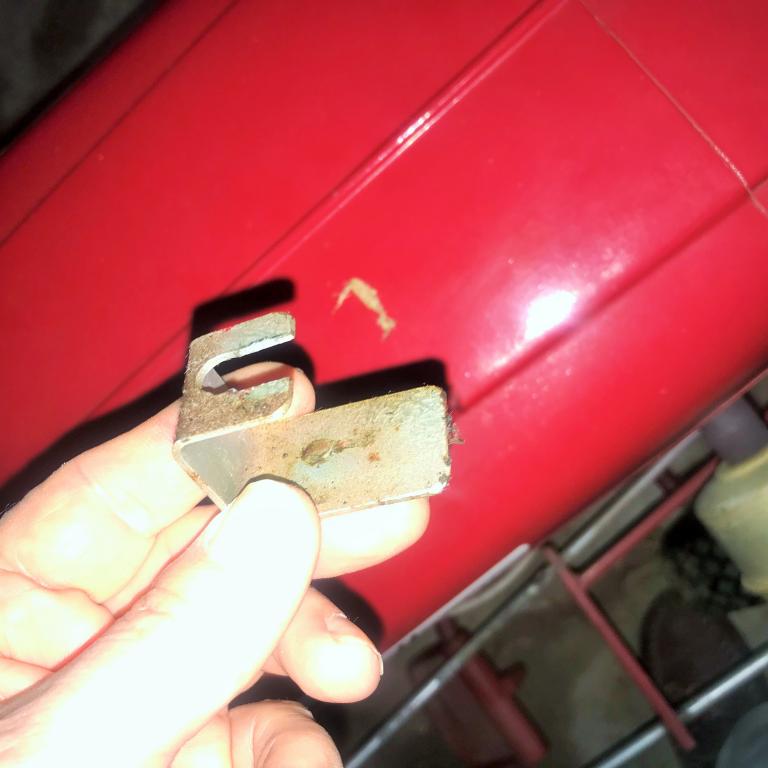

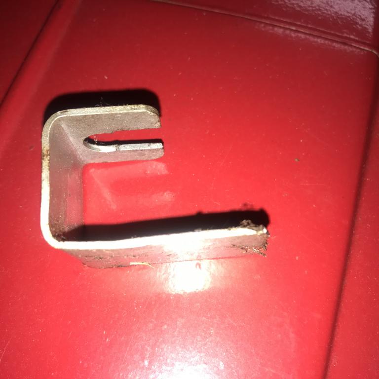

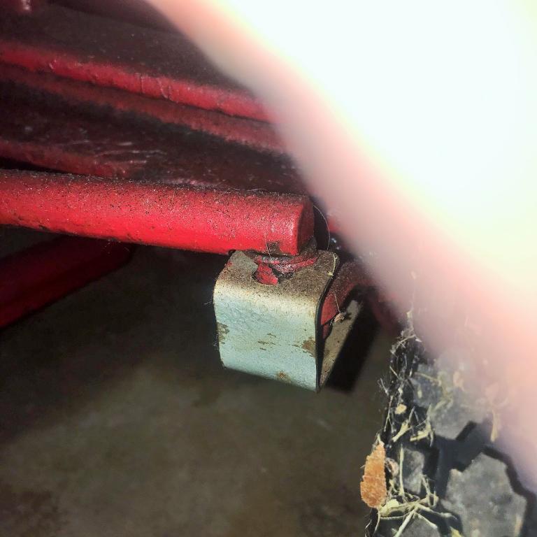

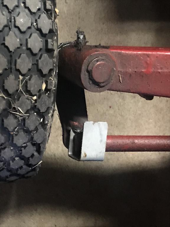

Lee :  Your re enforcing weld job on the Wheel Horse spindle reminded me of a neat trick that a  90 year old Wheel Horse owner taught me.   (Earl McEvers of White Hall, Illinois passed away in December 2016)
Earl would make and sell two pieces of metal shaped to go over the ball joint on the Wheel Horse steering tie rods so that the tie rod would not come off even when it was very worn.    He use to sell these two pieces for $5 and I bought several from him.  They work great and I have had on several of me tractors.
I am posting as some folks may want to make a set or two for your own tractors.
Oops,  got the metal upside down in the pics!
Here is the way it is suppose to go:

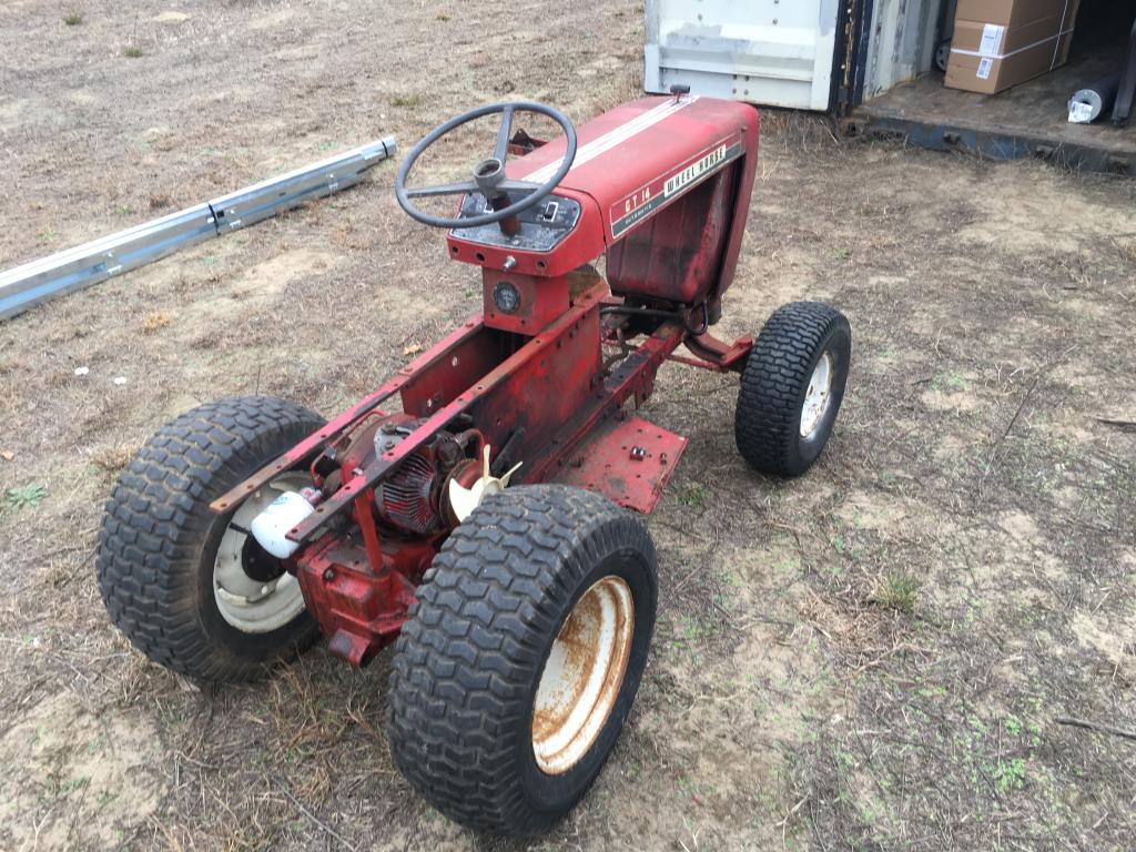

decided to put the 56 on the table.
What are your plans for that one Tom?
Shynon
Take it all apart,  new bearings and bushings,  one hub is broken.  Little wet sanding, paint rims, see what the Clinton needs

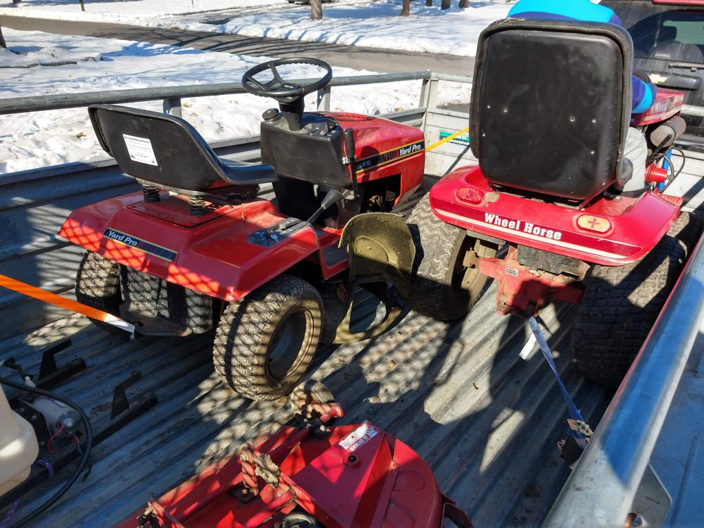

funny you should say that- i have a pic of one 312-8 next to the YardPro 12hp on the trailer. it looks like a toy sitting next to the Horse. the rears on the YardPro are 16x6.50x8, which is the same size as the FRONT tire setup i want for the 312-8. My 9yo son is stoked since he's getting the keys to the YardPro, not sure if it's going to stay a mower or not yet. it might have the deck ripped off and get some ATV/Snowblower tires on it for trail riding.

I went one better not near as cheap, but should last a life time. The frist ones have been on since 1989, Heims Joints.  This set up with 1/2" heims joints runs around $50.00
I have been there when I needed to mow and the tie rod fell out. That why all my Wheel Horses have heims joints.

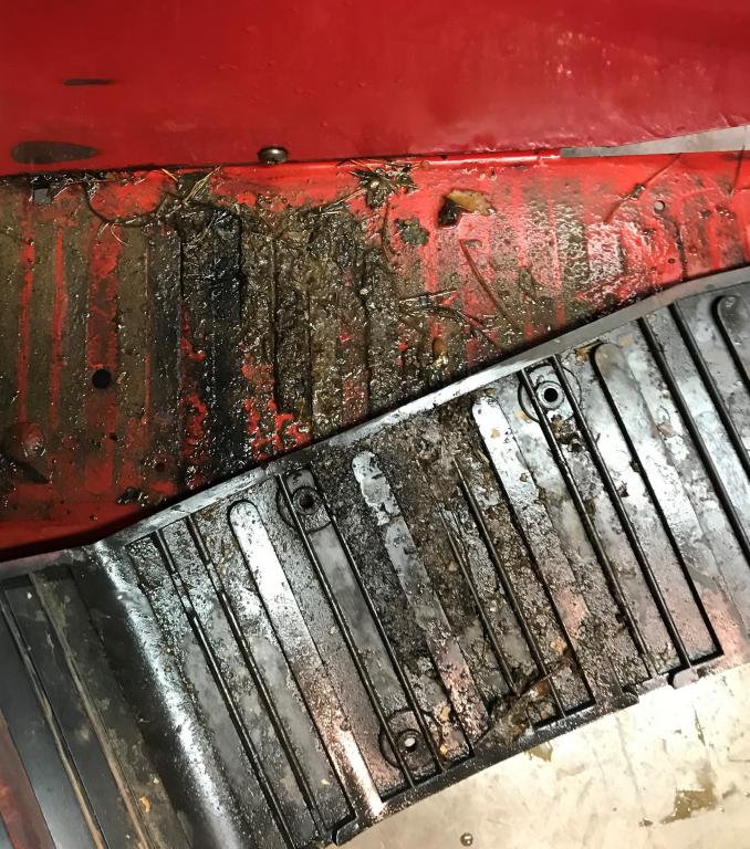

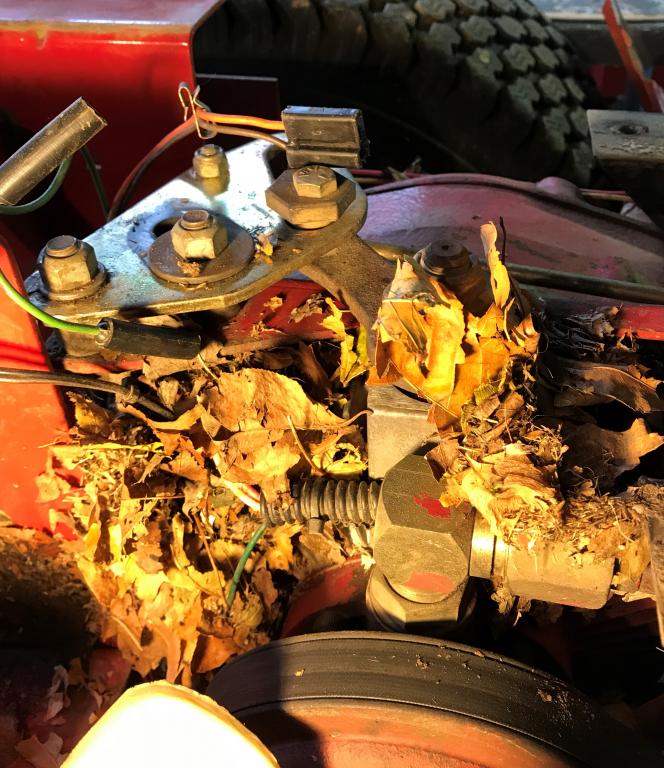

As part of my Fall-Winter changeover, I clean out the accumulated debris by removing the seat, fender, gas tank and floor mats.  The following photos are of a 520H that was clean and only used for the Fall cleanup.  It was given a quick wash with a garden hose before the parts removal.  If this were not cleaned, major over-heating and rust will happen.  While apart, I oil all moving parts that are exposed.
Hydro stuffed.
Leaves that were brushed out.  The remainder was removed with Gunk and garden hose.
Crud under floor mat that will cause rust.
