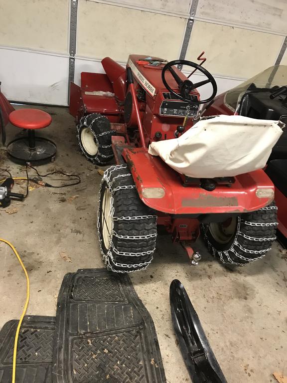

FAST 87 #3476 Posted November 17, 2019 Didn’t like slipping all over when the last snow fell last week so I got chains and installed them today. And fixed the chain the broke on the thrower. 7 2 Share this post Link to post Share on other sites
ebinmaine 81,000 #3477 Posted November 17, 2019 2 hours ago, FAST said: Didn’t like slipping all over when the last snow fell last week so I got chains and installed them today. And fixed the chain the broke on the thrower. Any weights? Share this post Link to post Share on other sites

FAST 87 #3480 Posted November 17, 2019 6 hours ago, ebinmaine said: Any weights? Yeah it has metal weights bolted inside the rear rims. Not sure how heavy they are. I am going to fill the tires with RV antifreeze next though as that will add another 100 ish pounds to the rear as I understand it. 2 Share this post Link to post Share on other sites
ebinmaine 81,000 #3481 Posted November 17, 2019 4 minutes ago, FAST said: Yeah it has metal weights bolted inside the rear rims. Not sure how heavy they are. I am going to fill the tires with RV antifreeze next though as that will add another 100 ish pounds to the rear as I understand it. Should hold about 6 gallons in an 8.5 wide tire. 8.3 pounds per gallon. 12 gallons. If you have access to Rimguard in your area that around 11 pounds per gallon and only a dollar or two more. 2 1 Share this post Link to post Share on other sites

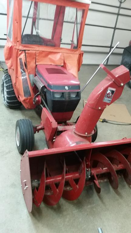

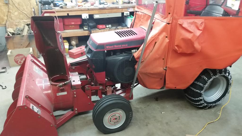

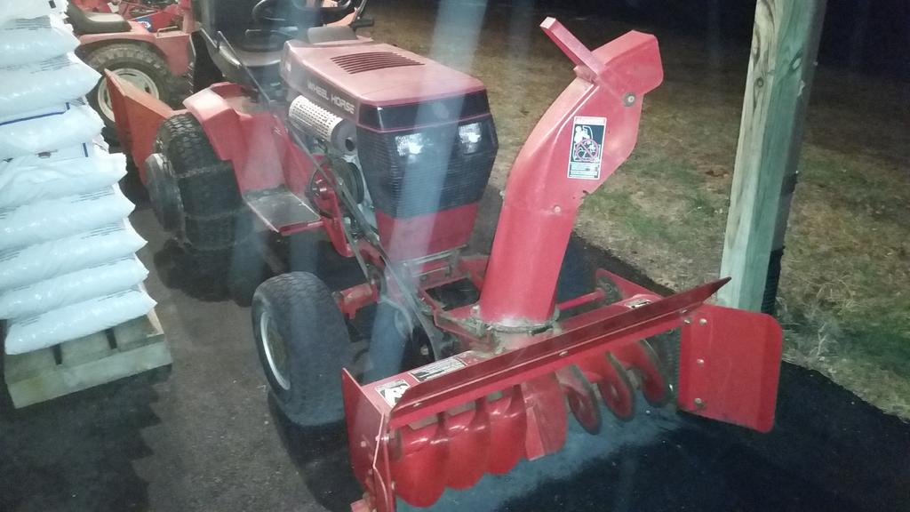

WHX?? 58,308 #3484 Posted November 18, 2019 Did get some horsing around done today tho.... Whomever said a different tractor for every attachment is spot on. Took me four hours to swap blowers on tractors but did not help that I am a newbie! Fitted the deuce up to the main squeeze and put the single on Mr. Backup. I think somebody said once those deuces are heavy! Finnish up the chute rotator and some skids be ready to rock. Put some weights on that @PeacemakerJack loaned me and good to go...... hopefully. . 5 5 Share this post Link to post Share on other sites

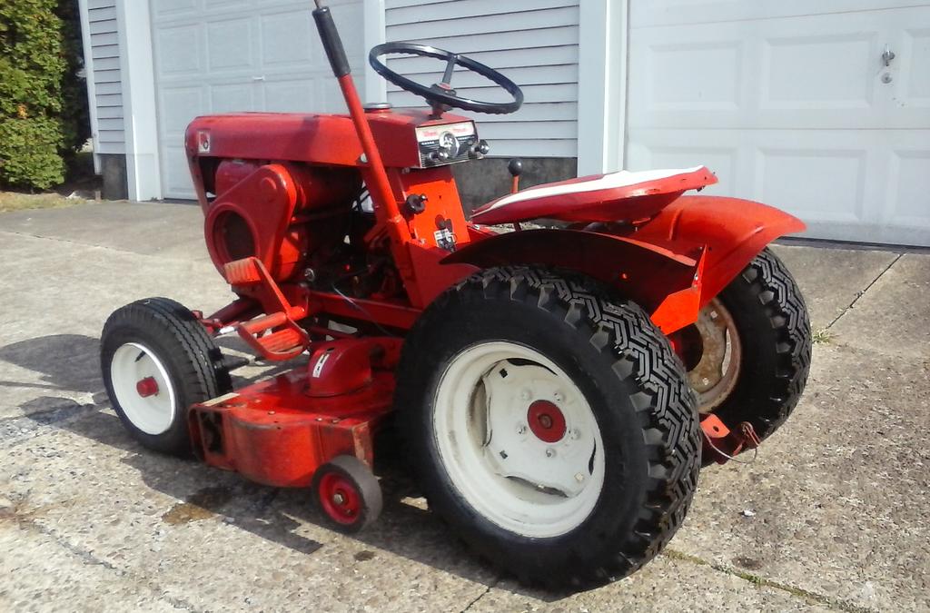

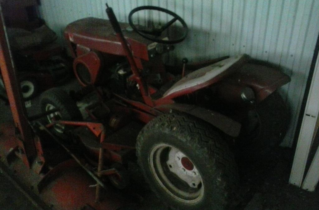

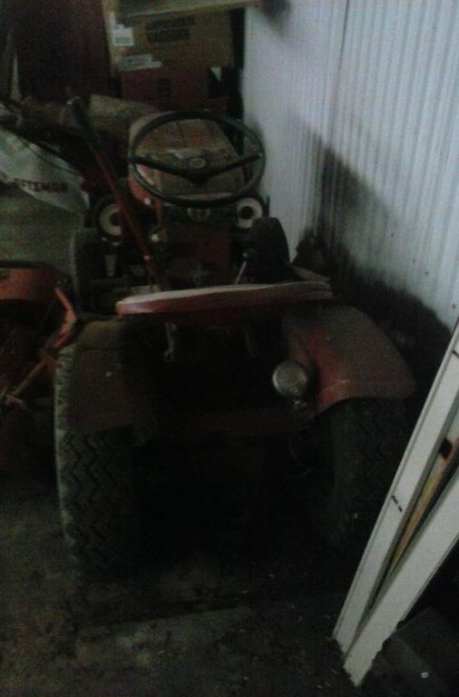

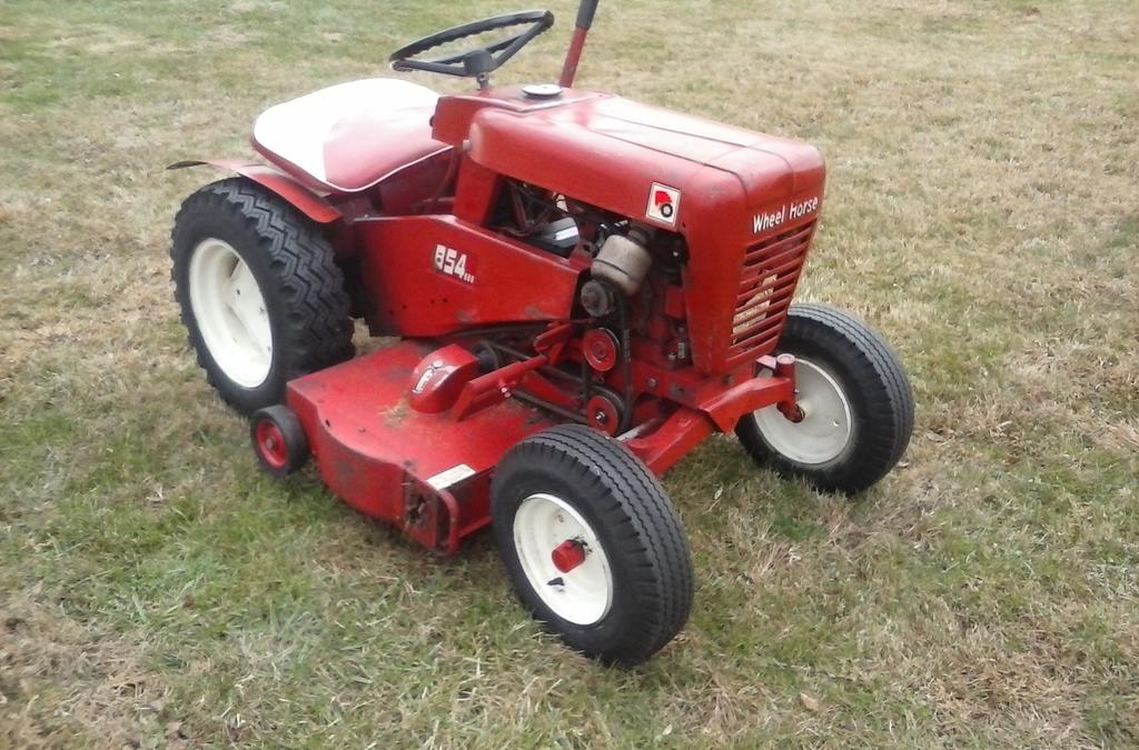

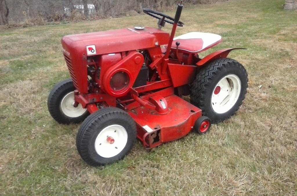

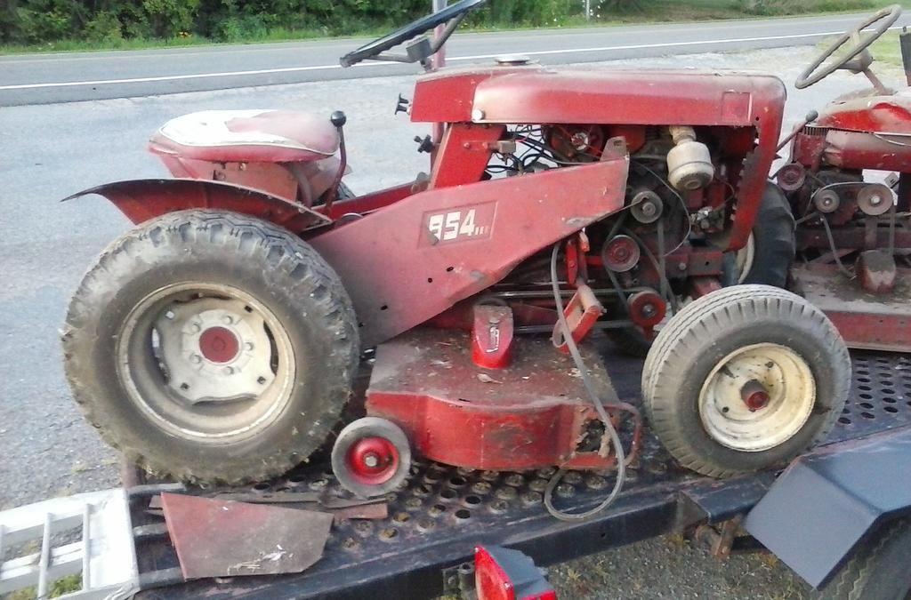

76c12091520h 4,290 #3485 Posted November 18, 2019 Drove my 854 today for the 1st time ever! I picked this up back in August from the closed dealership we cleaned out. It had to have been there at least 25 yrs and the dealers wife had no idea why it was there. It had the side covers off the left and right sides but appeared intact otherwise. Bought it , brought it home, cleaned it up , and started investigating. Replaced all the wiring, new Kohler points and condenser, and we had spark. Pulled the carb off and it looked like brand new inside (sat so long it never saw this horrible ethanol gas ) . Cleaned the glass sediment bowl under the tank and replaced the seal , new fuel line , put in a battery , and it fired up like it was used last week! But it wouldn't shift. Loosened the set screw on the shift lever, pulled the lever out , realigned everything , reinstalled the shifter, and life was good! Looks like it still has all the original belts on it too. Even mowed a small strip of grass with it . The first 2 pics are where we found it, #3 is out of the garage for the first time , # 4 is after a bath, and #5 & #6 are today. Other than what I paid for it , I have $3.00 in it. 4 8 2 Share this post Link to post Share on other sites
PeacemakerJack 11,080 #3486 Posted November 18, 2019 9 hours ago, WHX24 said: ...and good to go... Jim—that looks great on there. I’m hoping that whenever we get that first big snow that you can get some video of that thing blowing the powder. A WH deuce is a snow mover for sure! 1 1 Share this post Link to post Share on other sites

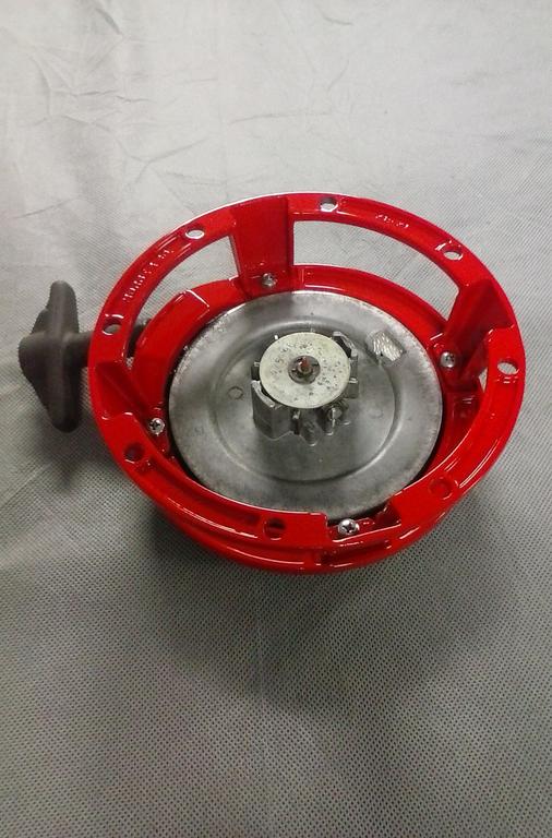

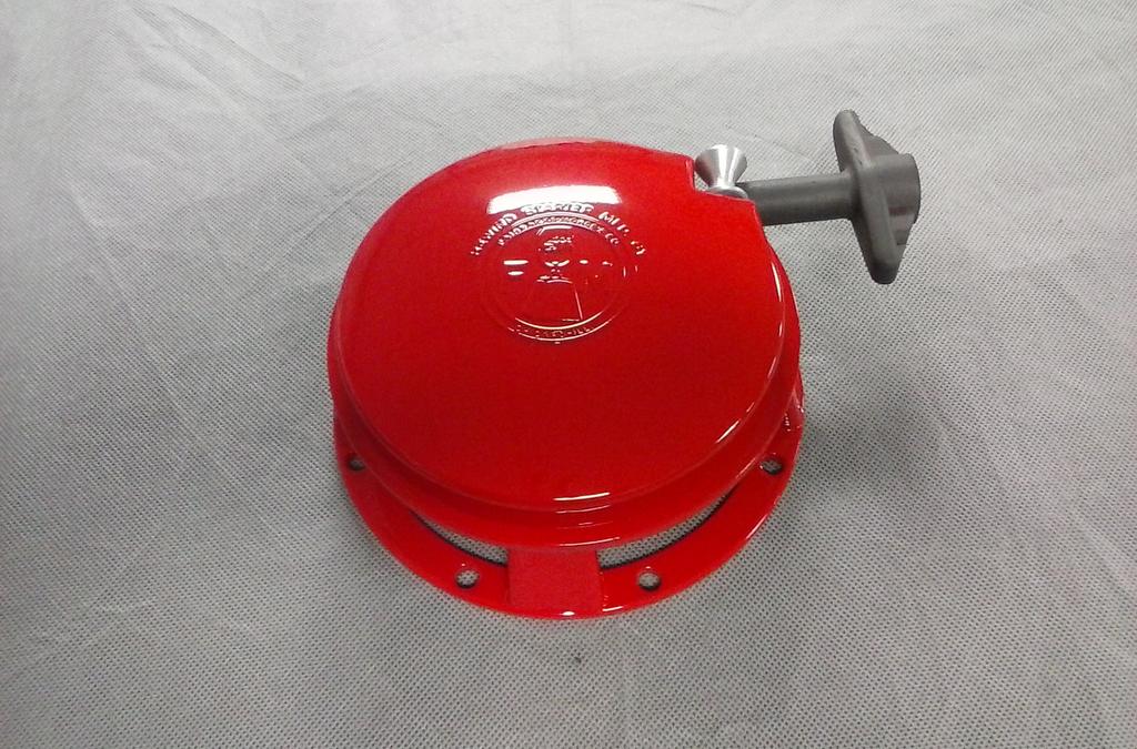

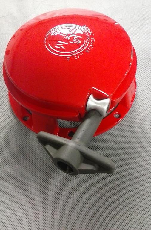

76c12091520h 4,290 #3500 Posted November 20, 2019 Finally got my Fairbanks rewind assy finished that I got at the Big Show : 1 6 Share this post Link to post Share on other sites
