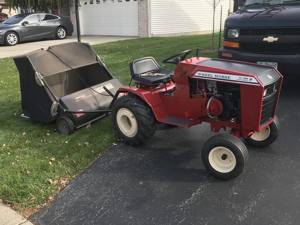

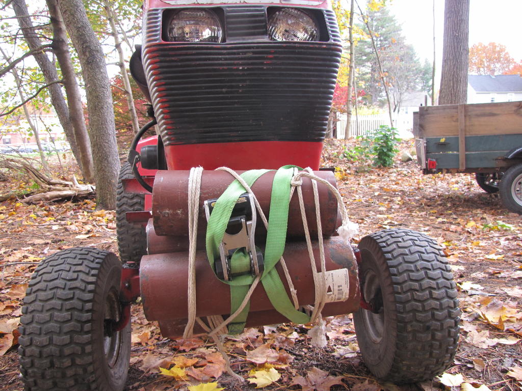

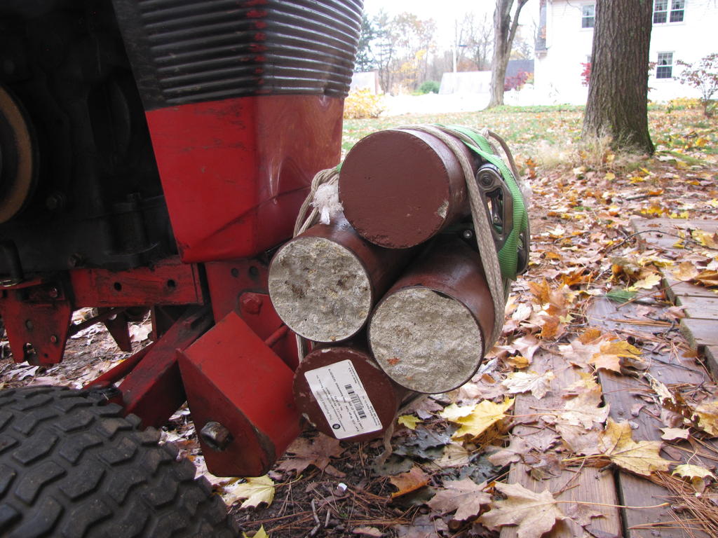

CCW 1,519 #3426 Posted October 30, 2019 Added front weight to my 312-8 using discarded concrete post used in home building. These were the sections cut off at a construction and they were going to be trashed. Lashed to an extra mule drive and add approximately 65 pounds to the front end. Helps to reduce the wheelie issue. 4 1 Share this post Link to post Share on other sites

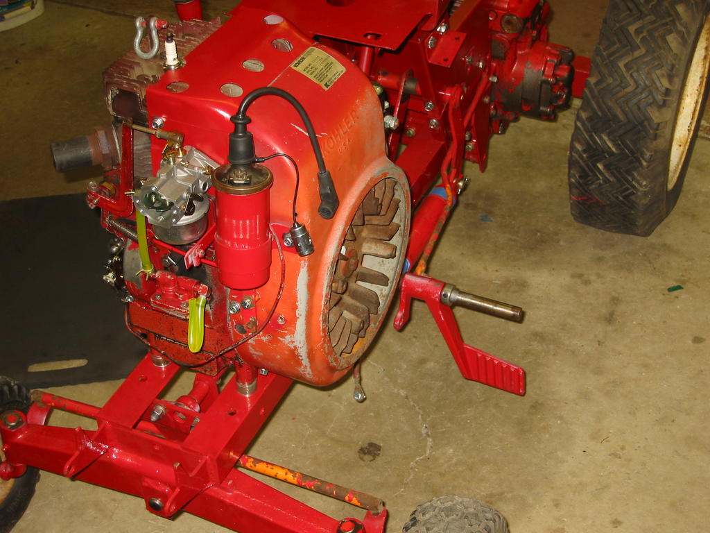

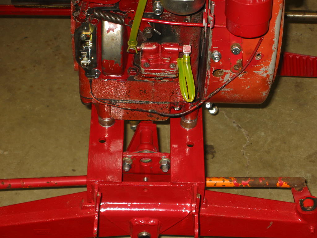

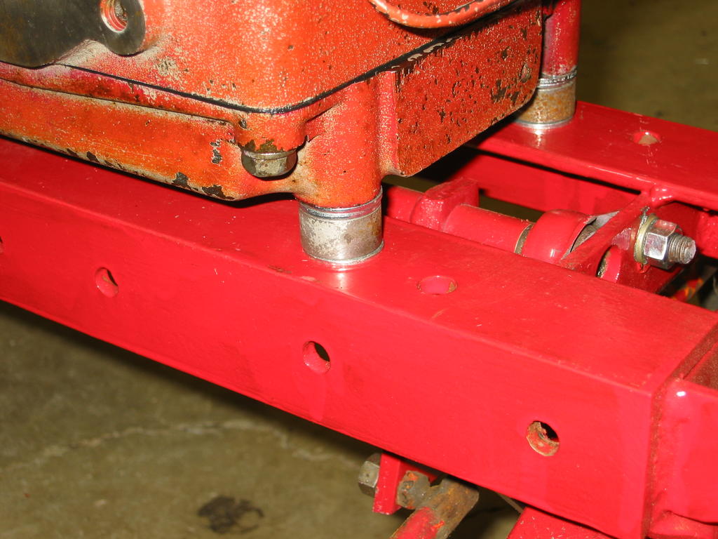

pfrederi 21,246 #3427 Posted October 31, 2019 Getting the K341 small base mounted on an Electro12 frame. Had to drill some new holes in the frame. Needed spacers found out the spacers used on K181 shaker mounts plus 3 SAE washers exactly matches the rise of a shaker mount. 7 2 Share this post Link to post Share on other sites
ebinmaine 81,000 #3428 Posted October 31, 2019 5 minutes ago, pfrederi said: found out the spacers used on K181 shaker mounts plus 3 SAE washers exactly matches the rise of a shaker mount That is some good information to tuckaway in the memory files Share this post Link to post Share on other sites
pfrederi 21,246 #3429 Posted October 31, 2019 33 minutes ago, ebinmaine said: That is some good information to tuckaway in the memory files Your memory files must work a heck of a lot better than mine.. 2 Share this post Link to post Share on other sites
ebinmaine 81,000 #3430 Posted October 31, 2019 6 minutes ago, pfrederi said: Your memory files must work a heck of a lot better than mine.. No sir. No they do not. Share this post Link to post Share on other sites

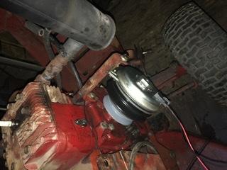

RJ59 17 #3432 Posted November 1, 2019 Wheel horse 800 special project of mine, had to remove busted drive pulley. New pulley and pto mounted in this picture, almost done currently reassembling the tractor. 2 Share this post Link to post Share on other sites

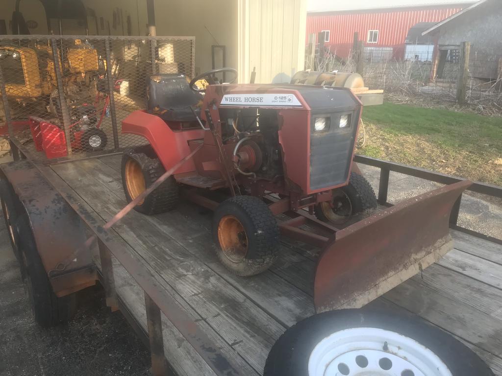

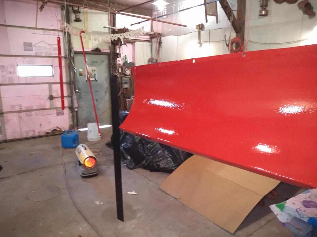

Achto 32,857 #3438 Posted November 4, 2019 (edited) Got one step closer to having a tractor ready for snow plowing. Finished making the parts that I was missing for the pivot arm to work, and sand blasted the plow blade. Then gave every thing 2 coats of self etching primer & 3 coats of paint. Not a show quality paint job, but it should be good enough to keep snow from sticking to the blade. Now that this is done, I'll soon be ready to hang it on the tractor. Then "Bring on some snow!!" Edited November 4, 2019 by Achto 9 3 Share this post Link to post Share on other sites

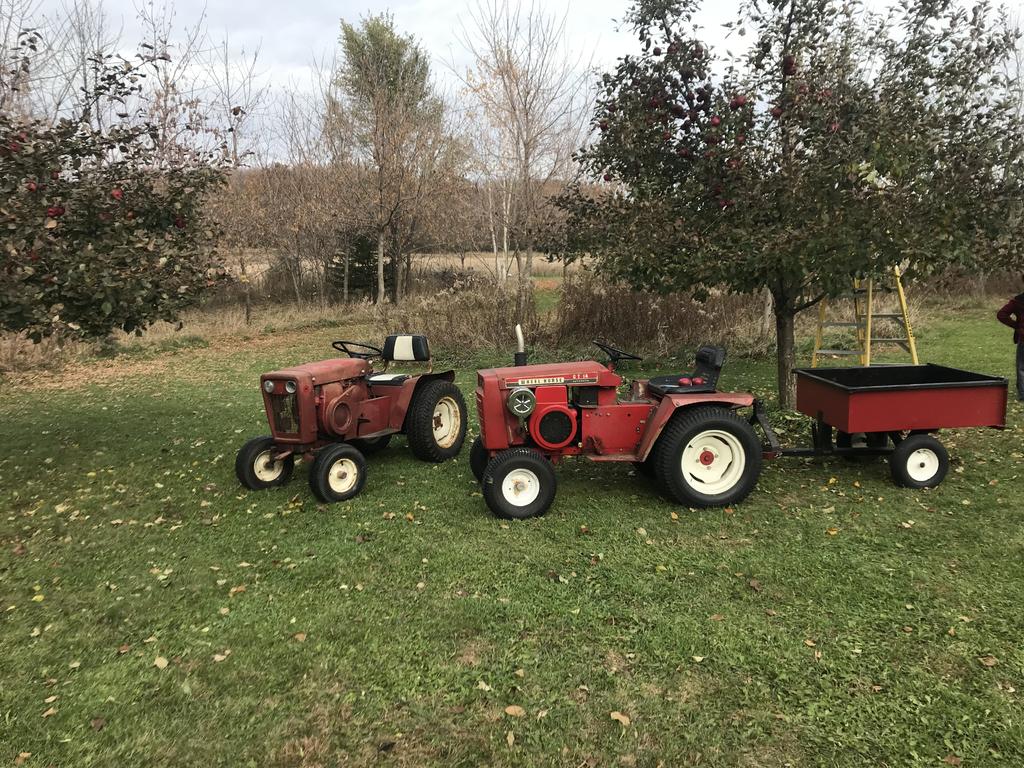

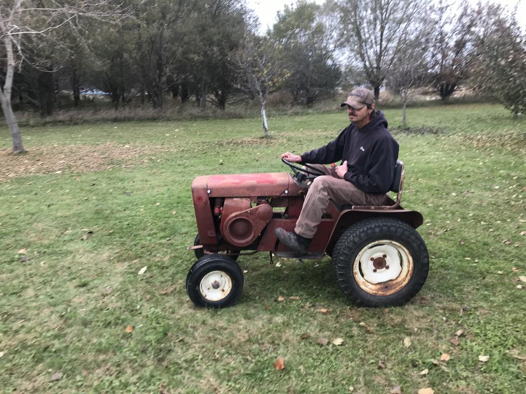

PeacemakerJack 11,080 #3439 Posted November 4, 2019 (edited) Got the big wheels out today to clean up the rest of the nasty apples off the trees. Caleb and Judge has fun shaking the trees and making “baskets” with the old apples into the trailer. About the time we were finishing, Achto stopped by and so I asked him if he wanted to drive Rusty up to the shed... Of course he took me up on it! We both agreed that it could use a new seat and some fresh “linen” paint on the wheels. I need to get Terry’s decals on it too...Fun afternoon Claudia picked through a couple of the “good” apples that Caleb found and made a scrumptious apple pie! We just finished eating some of that—yum! Edited November 4, 2019 by PeacemakerJack 4 3 2 Share this post Link to post Share on other sites

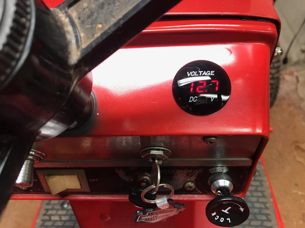

McGrew 461 #3447 Posted November 5, 2019 About a month ago, I was using my Raider 10 for yard work. It required lots of shutting the engine off and restarting. Toward the end of the day, the tractor would barely start, and I had to jump it to put it away. I found the original regulator (dated 1971) had gone belly up. I replaced the regulator, and all is fine. I decided to add a volt gauge so I could monitor the charging system. Ebay to the rescue! $7.64 later, I have a voltage gauge... I didn’t realize how nasty the steering wheel was... Danny 6 2 1 Share this post Link to post Share on other sites
Achto 32,857 #3448 Posted November 6, 2019 20 hours ago, McGrew said: Ebay to the rescue! $7.64 later, I have a voltage gauge.. That is a very cool looking volt meter!! Care to share a link to it?? I also like the little cotter key that keeps you throttle knob from spinning on the shaft. Great idea! Share this post Link to post Share on other sites
Pullstart 71,445 #3449 Posted November 6, 2019 Hot Wheels has the same volt meter, maybe @953 nut knows the source too? Share this post Link to post Share on other sites
