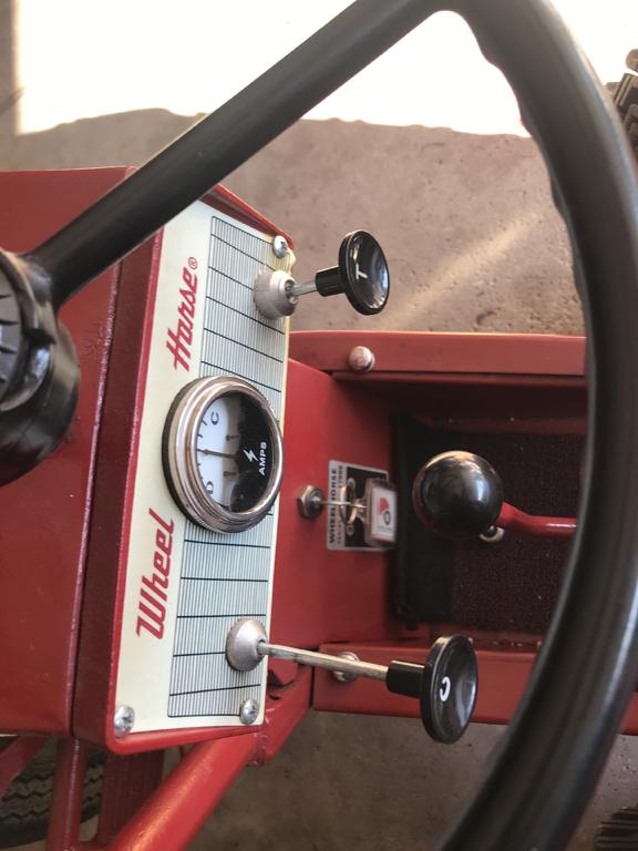

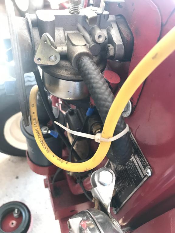

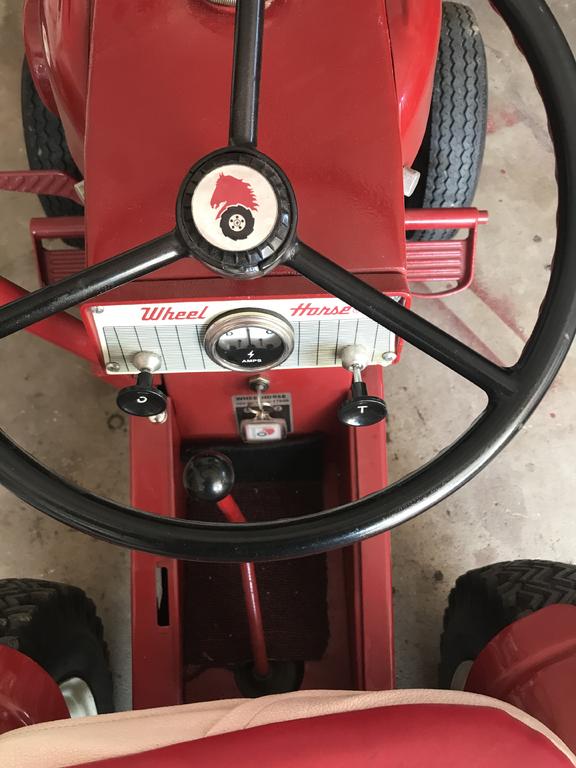

Lane Ranger 12,153 #3278 Posted October 15, 2019 Shortened my 702 choke cable today. I have been wanting to do this ever since it was installed on a redo two years ago! Just now getting it done! dash looks a little better now and choke works fine. This is probably my best 7 ho Kohler as it was rebuilt and really runs nice. 3 3 Share this post Link to post Share on other sites

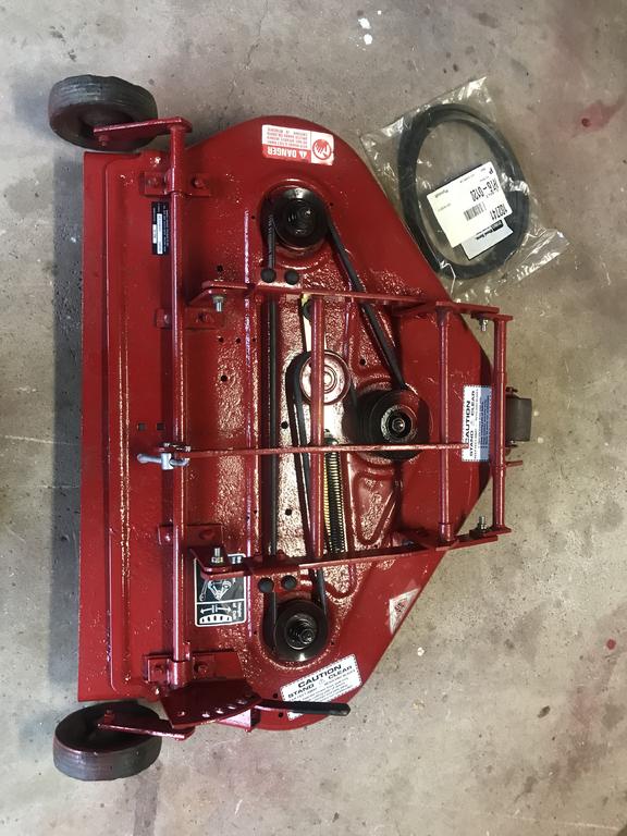

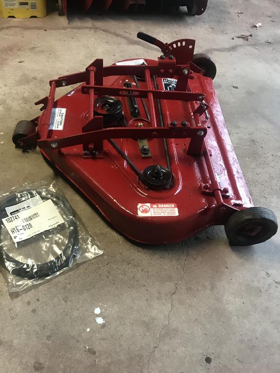

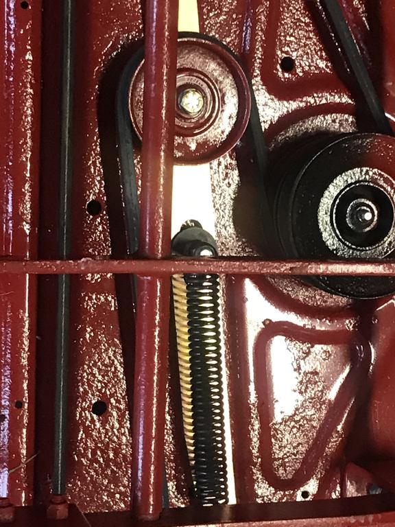

Lane Ranger 12,153 #3283 Posted October 15, 2019 Finished up redoing the 36 inch Wheel Horse rear discharge deck that Rodney Burger brought me from Florida. Needed a new idler bar and the two special bushings. Spindles all tight and good , new belt, some new belts and a paint job with new decals over the surface that was picked mark with rust but no rusty holes! I am going to put on my B-80 tomorrow! 8 Share this post Link to post Share on other sites

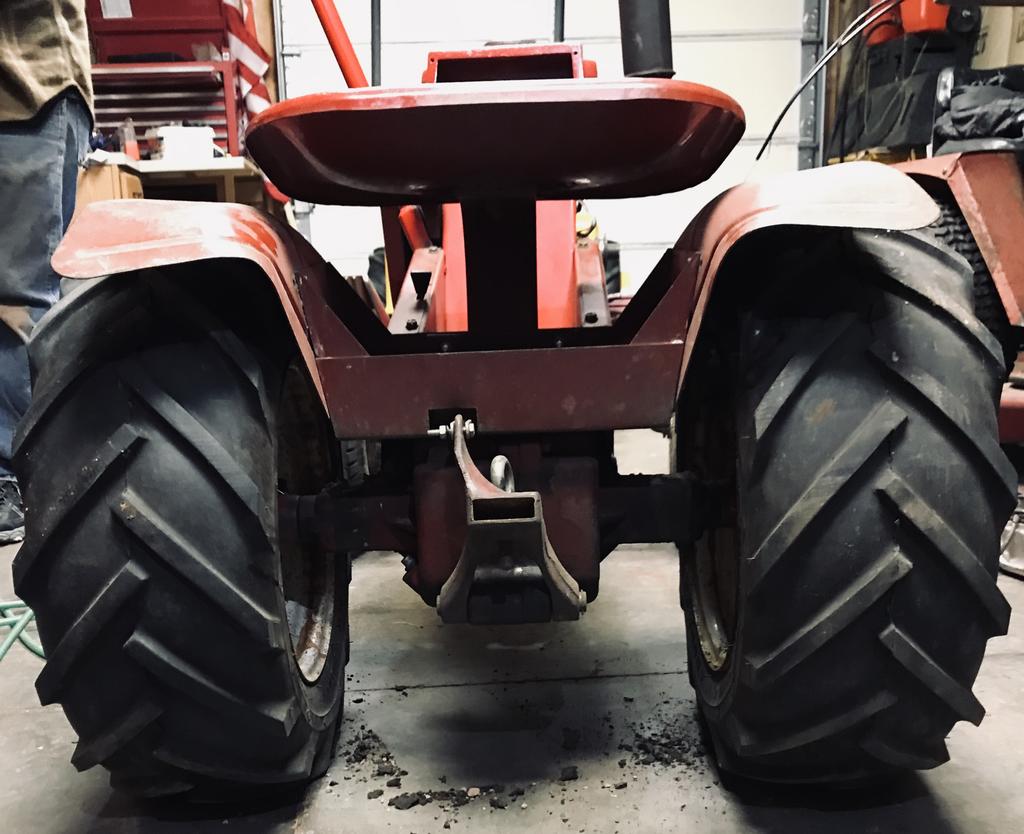

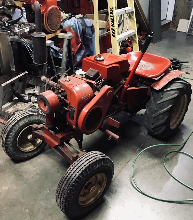

Coulter Caleb 538 #3284 Posted October 16, 2019 Me and my dad tonight started working on Comanche again only this time we took off the 6x12’s and changed them to my fluid filled 23x8.50-12’s. That added almost 90 pounds to the tractor! Some more weight to compensate for my skinny butt 5 6 1 Share this post Link to post Share on other sites

WHX?? 58,308 #3286 Posted October 16, 2019 (edited) Trim those ty-wraps Lane! one of my pet peeves! No hose clamps on the gas lines? Those HL's are just killer too! That deck looks real nice, just something about new paint over the pitting I like! Just says new old I guess! Edited October 16, 2019 by WHX24 1 Share this post Link to post Share on other sites
WHX?? 58,308 #3287 Posted October 16, 2019 Is that a bushing for the steering I spy sitting on the gas cap Caleb? Let us know how the sloppy steering shaft fix worked out. 3 Share this post Link to post Share on other sites
Stormin 9,988 #3288 Posted October 16, 2019 2 hours ago, WHX24 said: Trim those ty-wraps Lane! one of my pet peeves! No hose clamps on the gas lines Aye! Get 'em cut off. 1 Share this post Link to post Share on other sites
Lane Ranger 12,153 #3289 Posted October 16, 2019 I just noticed those ties ! Twice in fact! I will have to get those cut! I Share this post Link to post Share on other sites
Coulter Caleb 538 #3290 Posted October 16, 2019 4 hours ago, WHX24 said: Is that a bushing for the steering I spy sitting on the gas cap Caleb? Let us know how the sloppy steering shaft fix worked out. Will do Jim! Does anyone know the size of the machine screws that hold the dash on to the one piece tank. We need to pick up some... Share this post Link to post Share on other sites

PeacemakerJack 11,080 #3296 Posted October 17, 2019 18 hours ago, Coulter Caleb said: Will do Jim! Does anyone know the size of the machine screws that hold the dash on to the one piece tank. We need to pick up some... Found out it was a 10/32. We are gonna do just a little customizing “bling” here since the tank will be a non stick item and we will have the original on the shelf. Stay tuned to the Comanche thread for the result...Plow Day is coming fast!!! 2 1 Share this post Link to post Share on other sites
Lane Ranger 12,153 #3297 Posted October 17, 2019 (edited) Sometimes the 10/32 will not do the job of holding the dash plate in well as the holes are worn out. You can use a metric machine screw to replace if that is the case. Chrome ones do at some "bling" also~! Edited October 17, 2019 by Lane Ranger 1 1 Share this post Link to post Share on other sites
