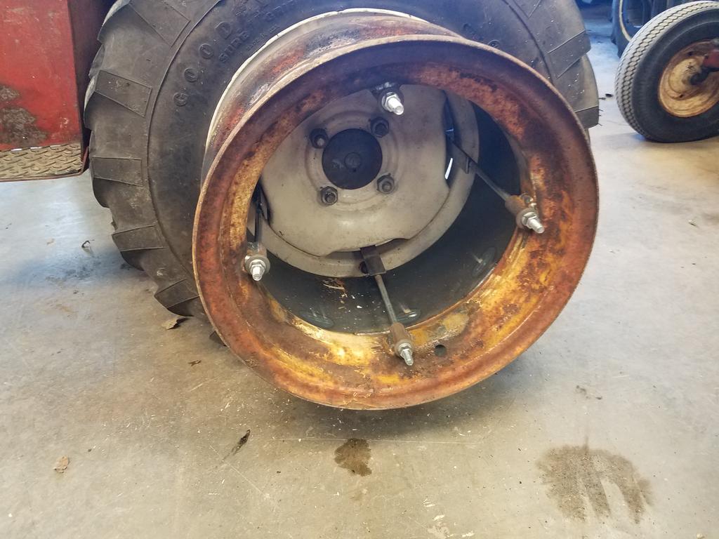

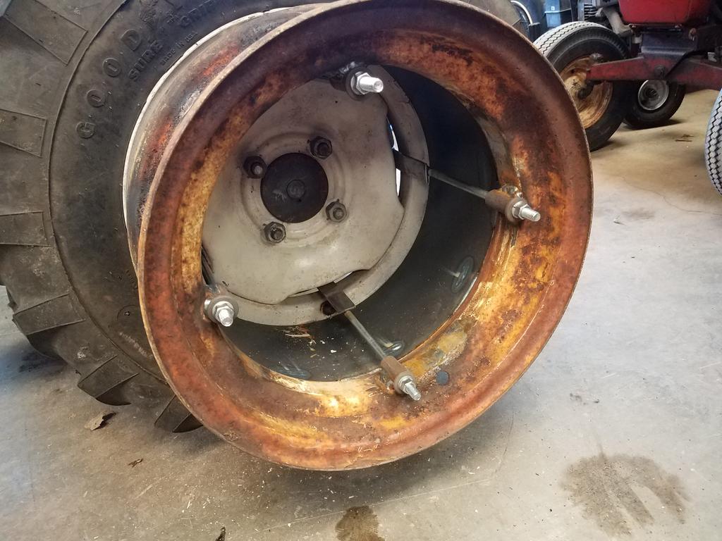

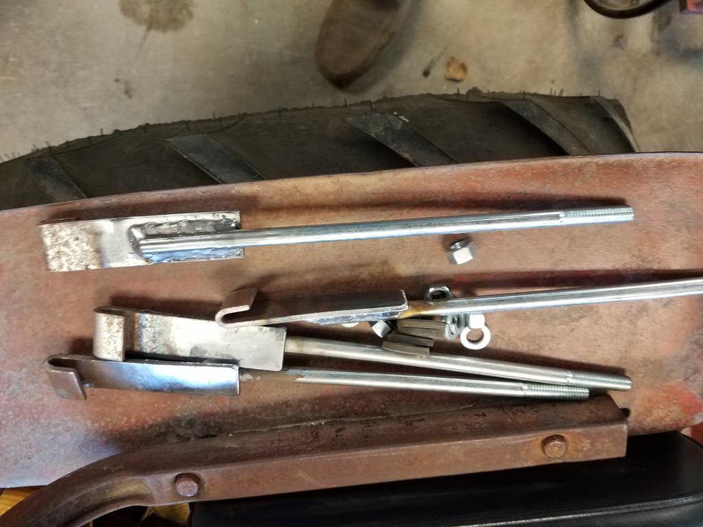

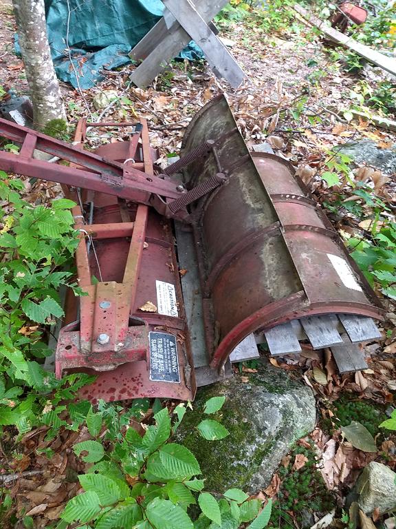

Shynon 7,723 #3126 Posted September 28, 2019 Clamps made and bolted on, little paint and a tire. 3 6 Share this post Link to post Share on other sites

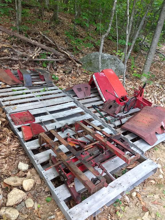

ebinmaine 80,917 #3128 Posted September 28, 2019 My honey and I had a great day of yard puttering and organizing. She spent a lot of today disassembling, sanding, and repainting the wood stove that we will be putting upstairs. I'll post a couple pics of that in another section. I did a bunch of organizing. Cleared out a spot in the forest next to the parts and project tractors for some pallets so I can lay my parts assortment out in a much more organized and protected manner. I still have a few things to put out there but for the most part everything is in its place and just waiting to be covered. I also took a little while and messed around with the idler pulley on the Cinnamon Horse. I tried installing a cast-iron idler and I wasn't super pleased with the way the belt set on it. It was high in the groove... so I took it back off. I managed to remove the dust seal from the bearing in the existing idler and I sprayed it out with brake clean and then put dry lube in there. Ordered a new part but this one should be okay for a little while more. 4 1 Share this post Link to post Share on other sites

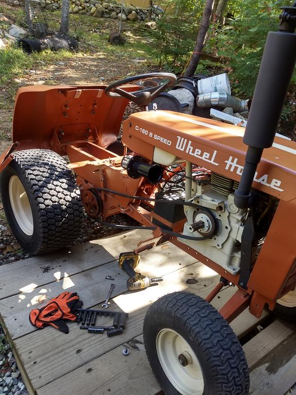

squonk 48,215 #3129 Posted September 28, 2019 Been smelling gas in the garage for a week. Didn't see any stains on the concrete or puddles. This morning I opened the overhead door and could smell it from 100 ft. away. Found the leak in the C-160 gas tank. Thought it was a bad grommet but turned into a seam leak. I still had a tank off of a parts tractor in my basement. Been there for about 8 yrs. 4 Share this post Link to post Share on other sites

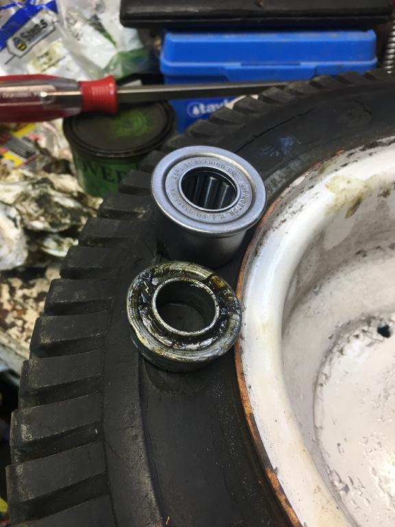

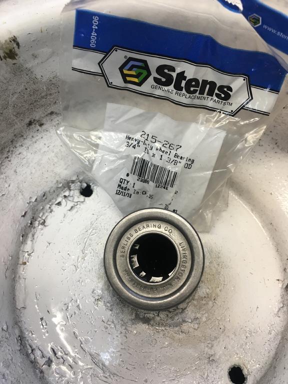

Burnerman 759 #3138 Posted October 2, 2019 My new wheel bearings showed up today. 👍 I was very pleasantly surprised by the fact they’re super beefy compared to the ones it my front rims. But even happier to see they’re made in USA about 40 min away. 3 5 Share this post Link to post Share on other sites

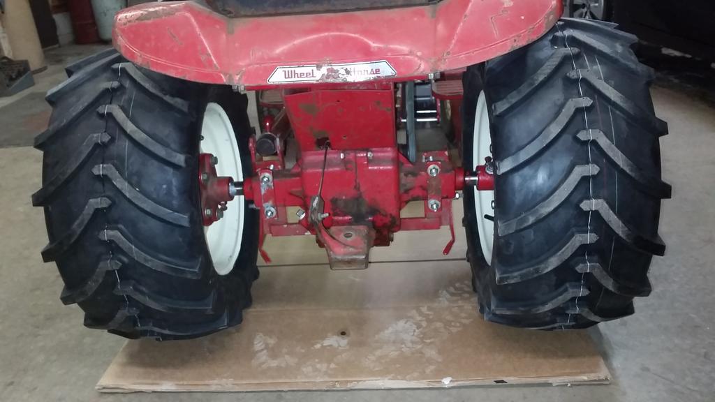

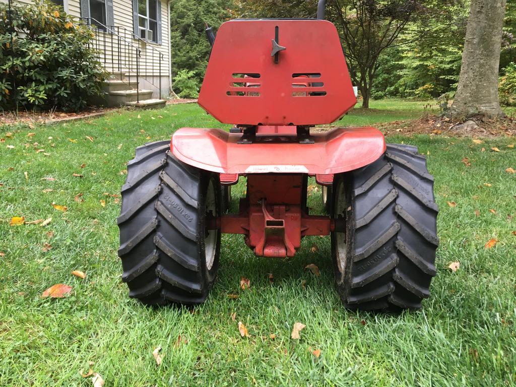

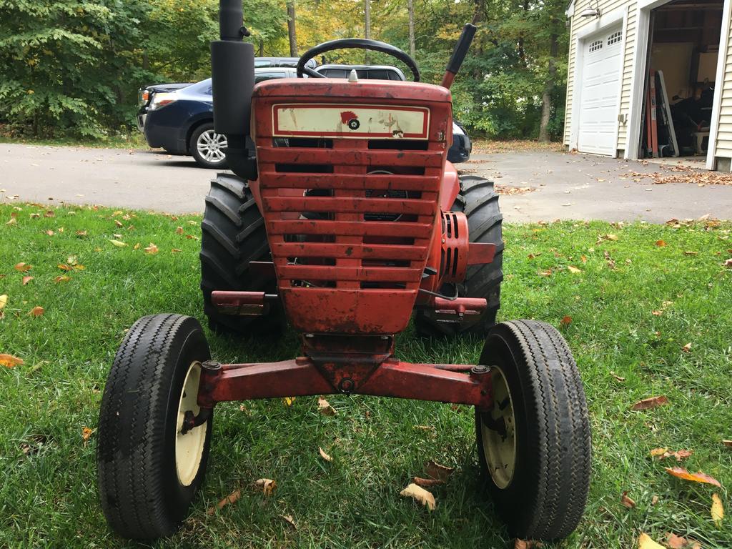

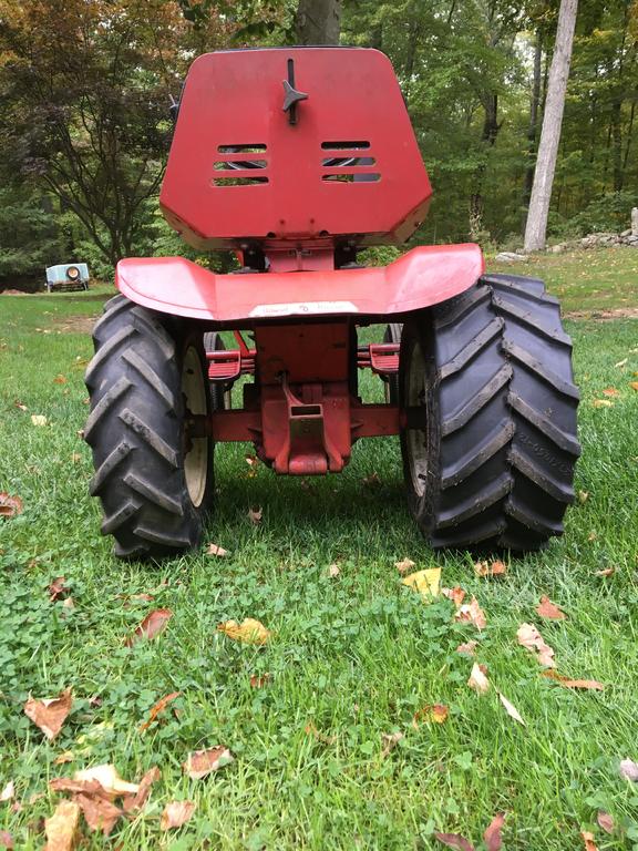

Sparky-(Admin) 26,493 #3142 Posted October 3, 2019 Swapped to the fatties on my cruiser for this weekends tractor/machinery show. 5 7 3 Share this post Link to post Share on other sites

WHX?? 58,302 #3147 Posted October 4, 2019 Lol Sparky... I would make him pay on said date! Those tires look to be similar to the ones on my plow tractor and they do run wide for just 10.50's 3 1 Share this post Link to post Share on other sites
