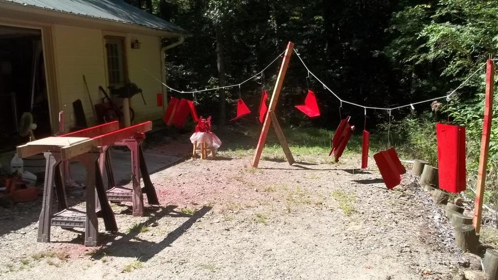

953 nut 68,174 #3026 Posted September 6, 2019 (edited) Since I had to remove so much sheet metal from the GT-14 to remove and repair the transmission I decided to spray some IH RED and make it look more presentable. Edited September 6, 2019 by 953 nut 8 7 Share this post Link to post Share on other sites

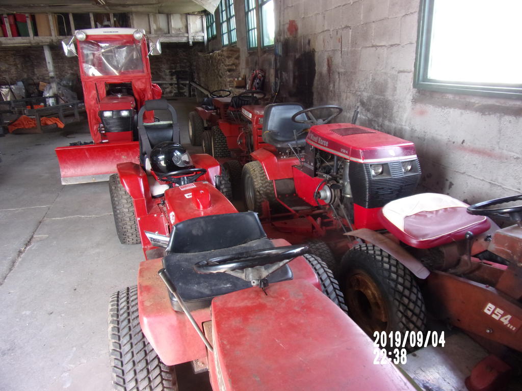

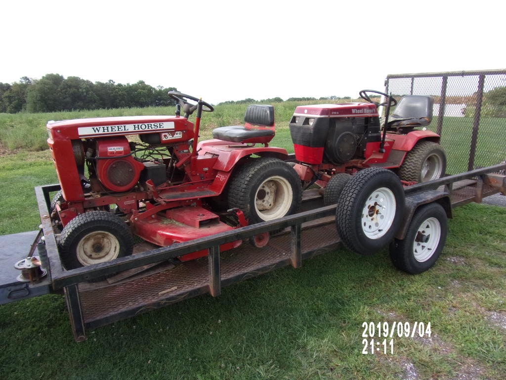

Ed Kennell 46,798 #3028 Posted September 6, 2019 I moved a couple mower horses to their winter pasture. Organized the herd to make room for Mikes new boat. The snow mover came back home for winter duty. The 854 and 877 are waiting for the 2010 Big Show. 6 1 1 Share this post Link to post Share on other sites

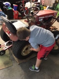

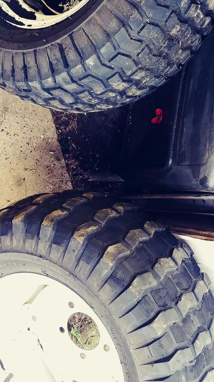

TonyToro 1,189 #3030 Posted September 7, 2019 My son did some last minute tire swapping before the tractor pull tomorrow. 8 3 Share this post Link to post Share on other sites

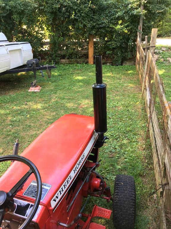

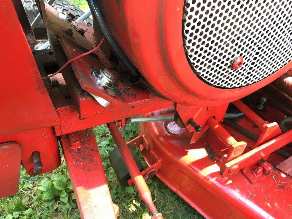

Burnerman 759 #3034 Posted September 7, 2019 Installed new fuel line, fuel filter and a new air filter. Also installed the new solid engine mounts from Zach Kerber. What a difference!! There’s actually less vibes now. I had 2 bad rubber isolators and the engine shook all over. Not anymore! i also made a stack from a cheap TSC muffler but it’s way to loud for yard work. My stocker rotted out and was melting my air filter. I may try one of jimkemps when he gets a few more made. I wish I could really get it quiet. 5 1 1 Share this post Link to post Share on other sites
chip61 666 #3035 Posted September 8, 2019 Nice looking stack. I had one like that a few years ago-as you found mine was too loud also. Low tree branches were the real issue. I want to try one of Jim kemps stacks it looks short enough tree branches won't be such a hazard Share this post Link to post Share on other sites
ebinmaine 80,088 #3036 Posted September 8, 2019 14 hours ago, Burnerman said: stack Nice job on that one! 6 hours ago, chip61 said: stack If you both are looking for "QUIET" then a cub muffler turned to face up is the least noisy I've found. I have one of @jimkemp's mufflers on the Cinnamon Horse. The quality is Absolute Top Shelf! I have a cub muffler on the Patriot horse. It does have a bit deeper tone. 1 1 Share this post Link to post Share on other sites
Burnerman 759 #3037 Posted September 8, 2019 8 hours ago, chip61 said: Low tree branches were the real issue. I want to try one of Jim kemps stacks it looks short enough tree branches won't be such a hazard Lol. I got a handful of dead pine needles down my back after driving under the pine. 😁 I’m going to keep messing with this one. I’m going to try and add a baffle to it but will prolly end up with one of @jimkemp‘s. 1 Share this post Link to post Share on other sites

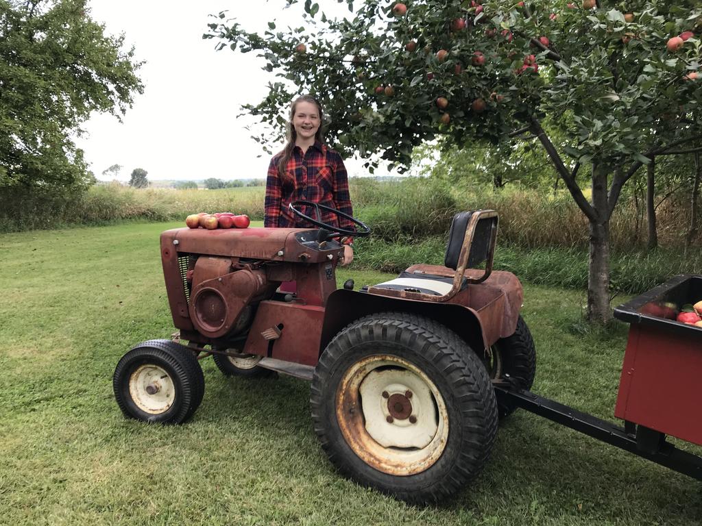

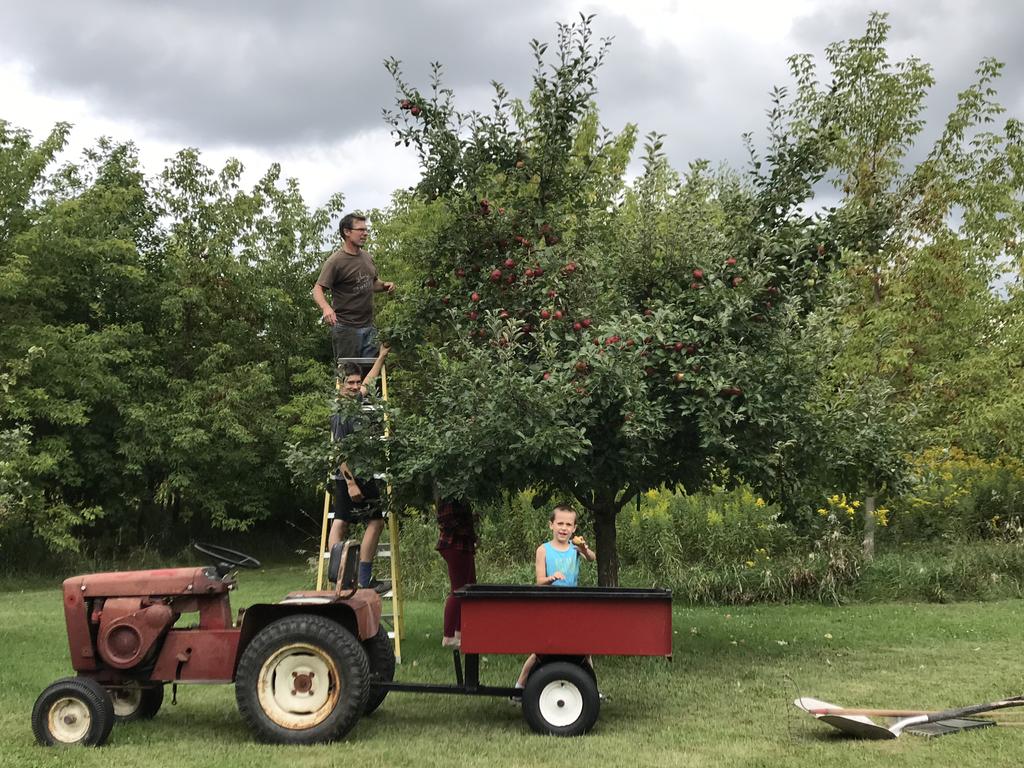

PeacemakerJack 11,023 #3038 Posted September 8, 2019 (edited) Tomorrow I leave for a two week missions trip to Kiev, Ukraine and do this afternoon I’m doing some stuff with the kids. We got rid of a bunch of the nasty apples and used the 1054 to haul the cleanup trailer... Works great and looks vintage doing it. We will call this tractor...”Rusty”! Edited September 8, 2019 by PeacemakerJack 5 5 Share this post Link to post Share on other sites

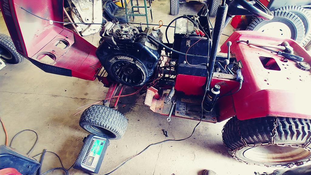

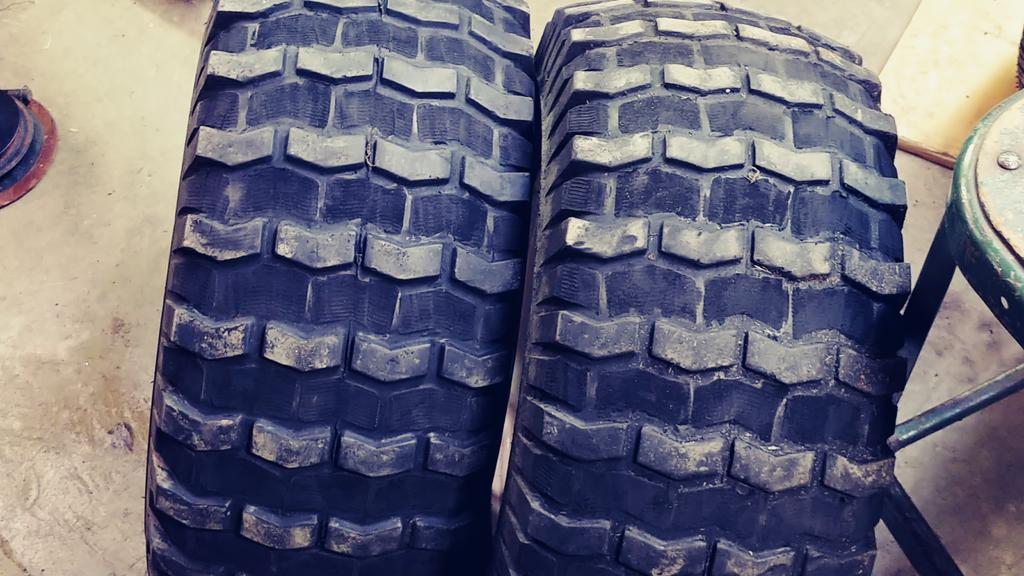

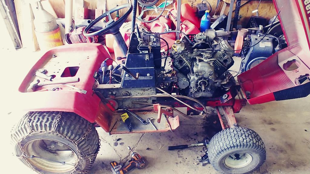

Ralph S 342 #3040 Posted September 9, 2019 Out with the 10 and in with an 18 twin. I call it my 310+8. I experimented with cutting tires too. I think the turned out well for the first time. It's going to be my transfer sled puller. 10 Share this post Link to post Share on other sites
Ed Kennell 46,798 #3041 Posted September 9, 2019 @Ralph S , what did you use to cut the tires? 1 Share this post Link to post Share on other sites
Ralph S 342 #3042 Posted September 9, 2019 15 minutes ago, Ed Kennell said: @Ralph S , what did you use to cut the tires? One of those harbor freight vibrating saws you'd use to cut trim boards. It cut like a hot knife through butter. It took me about 45 minutes to do both tires. 2 2 Share this post Link to post Share on other sites

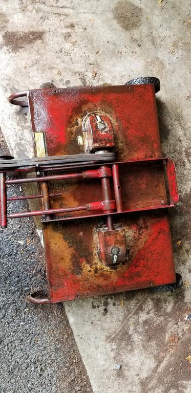

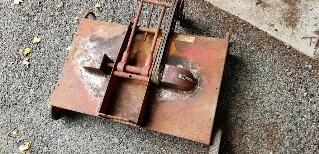

FarmboyFresh 69 #3045 Posted September 9, 2019 On 9/6/2019 at 3:56 PM, AMC RULES said: A thorough cleaning and bit of maintenance is all it took to save this deck from the our local scrap dealer today. What are your plans with it and what will it fit on? Share this post Link to post Share on other sites
gwest_ca-(File Mod) 12,418 #3047 Posted September 10, 2019 On 9/6/2019 at 4:56 PM, AMC RULES said: A thorough cleaning and bit of maintenance is all it took to save this deck from the our local scrap dealer today. Is this 1962 deck a 32" or 36"? Garry 1 Share this post Link to post Share on other sites

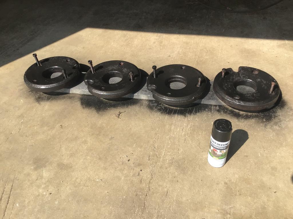

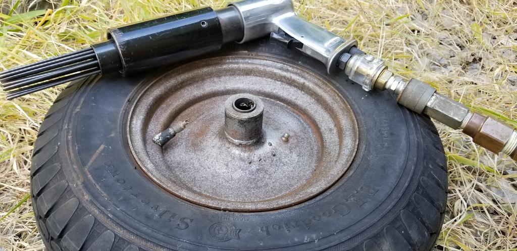

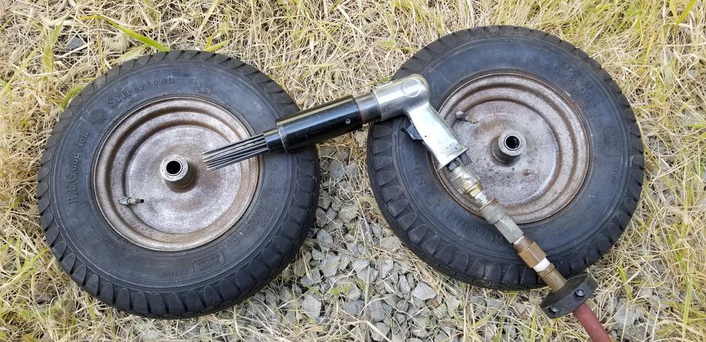

Pullstart 71,008 #3048 Posted September 10, 2019 Getting “HAMMERED” with my freebie wheel weights today... 6 Share this post Link to post Share on other sites
AMC RULES 37,259 #3049 Posted September 10, 2019 7 hours ago, gwest_ca said: Is this 1962 deck a 32" or 36"? Garry 32" Share this post Link to post Share on other sites
gwest_ca-(File Mod) 12,418 #3050 Posted September 11, 2019 13 hours ago, AMC RULES said: 32" Thank you. Click on the picture Garry 1 Share this post Link to post Share on other sites
