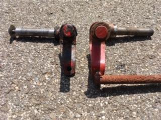

TonyToro 1,190 #2880 Posted August 16, 2019 On 8/14/2019 at 7:04 AM, pullstart said: I’m glad nobody was hurt! Without a picture of the damage, I’d suggest heat and a hammer will put it back for ya! I smash on it for while to get it “Good Enough”. I’ll take a picture of the spindle tomorrow. Share this post Link to post Share on other sites

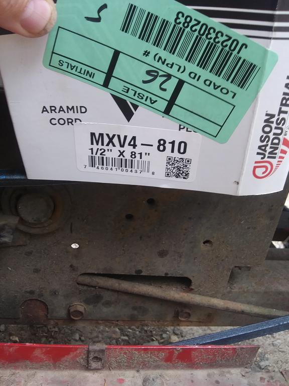

posifour11 723 #2881 Posted August 16, 2019 On 8/10/2019 at 1:12 PM, 953 nut said: Meed to put a belt guard on that woods tractor. Lot less gear grinding then. @953 nut, I did you one better. Because I remembered that I stole this drive belt off of a parts tractor and it was in bad shape to start with. I replaced it today and I'm going to put the belt guard on in the morning. You guilted me into being a good horse owner. 😁 1 2 Share this post Link to post Share on other sites

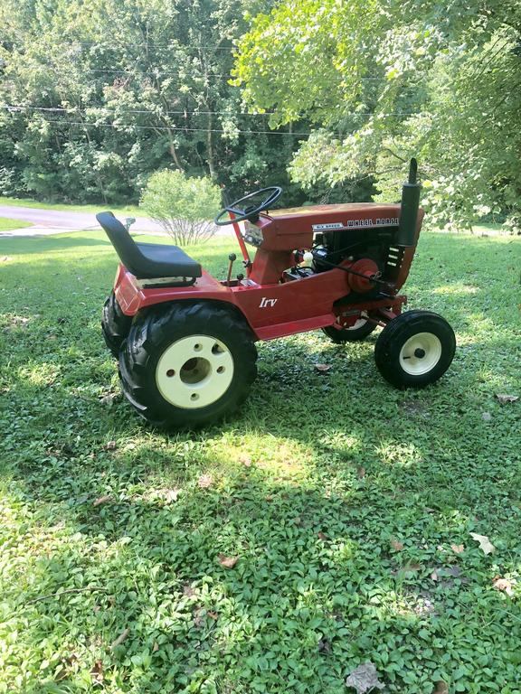

The Tuul Crib 7,354 #2883 Posted August 17, 2019 Paint was cured enough on my wheel weights to put them on the tractor today. Sure did improve the looks! 2 6 1 Share this post Link to post Share on other sites

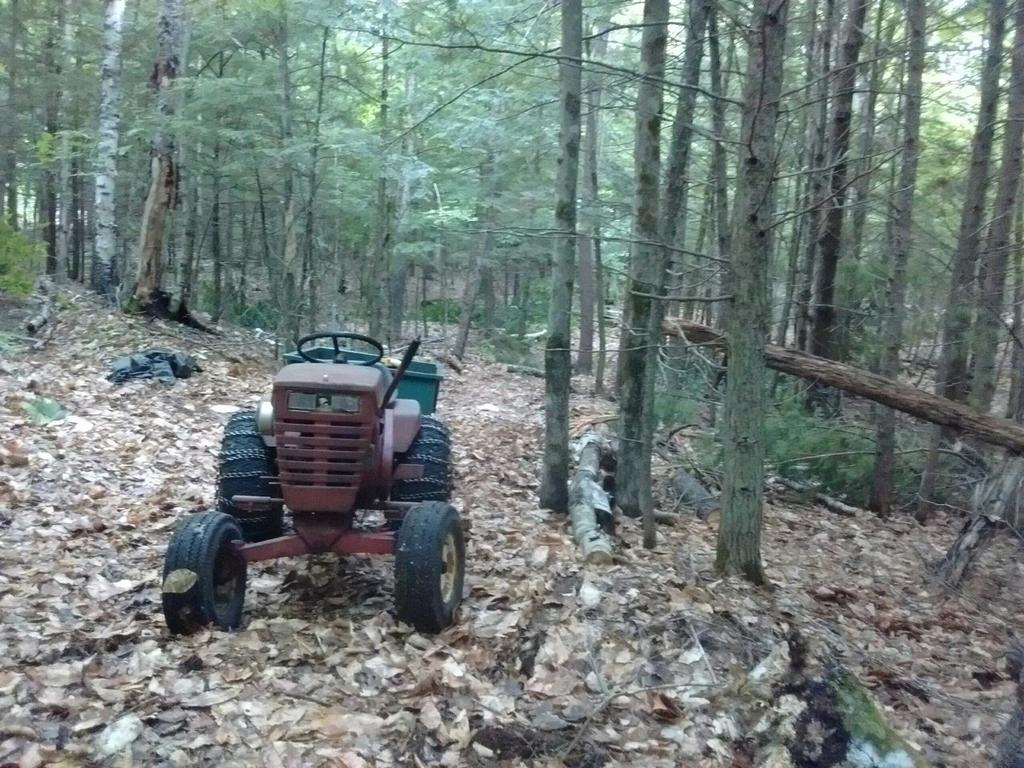

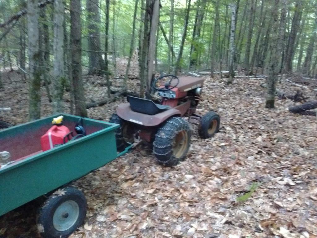

ebinmaine 80,910 #2884 Posted August 17, 2019 We just spent about 4 hours cutting wood and clearing brush. We cleared about 250 - 350 feet of path. Almost to the back of the property now. Also cut down a BUNCH of small white pines to give breathing and sun space to the hardwoods. Also cut up a red oak which will be for firewood in a season or two. This section of the path begins back around the white poplar that's laying on the forest floor. Zoom in just above the tractor seat and you can see the pile of oak fire wood. There's a path cut from here to there... Then to the left and around the corner and another couple hundred feet down in... We're almost all the way to the back of the property now. Awesome. 8 1 1 Share this post Link to post Share on other sites

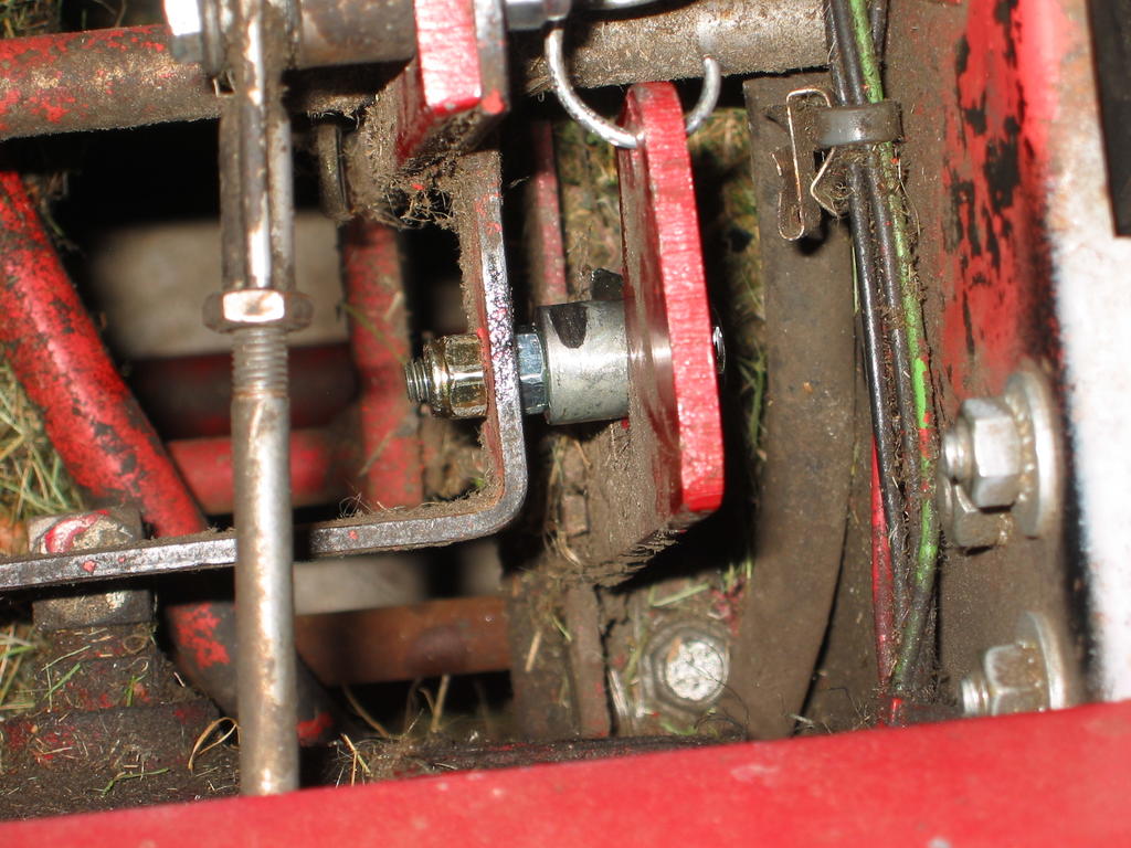

pfrederi 21,217 #2885 Posted August 18, 2019 Made a modification to Matts Foot Control on my 418A. Bought it several years ago and then took a couple years to install it. It gets really hard to work sometimes. Turns out the steel bushing that slides up and down in bracket #2 Doesn't slide nicely. Getting lube on it is not straight forward and if you look at the picture you can see where a groove has been worn in the bushing. I put in a longer bolt and a jam nut on tighten it to the bracket so now the bushing can spin on the bolt. I know this will wear over time but if it works out I will come up with a oilite bearing on the bolt and a steel bushing over that. 3 1 Share this post Link to post Share on other sites

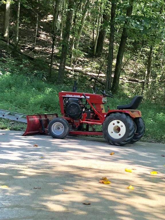

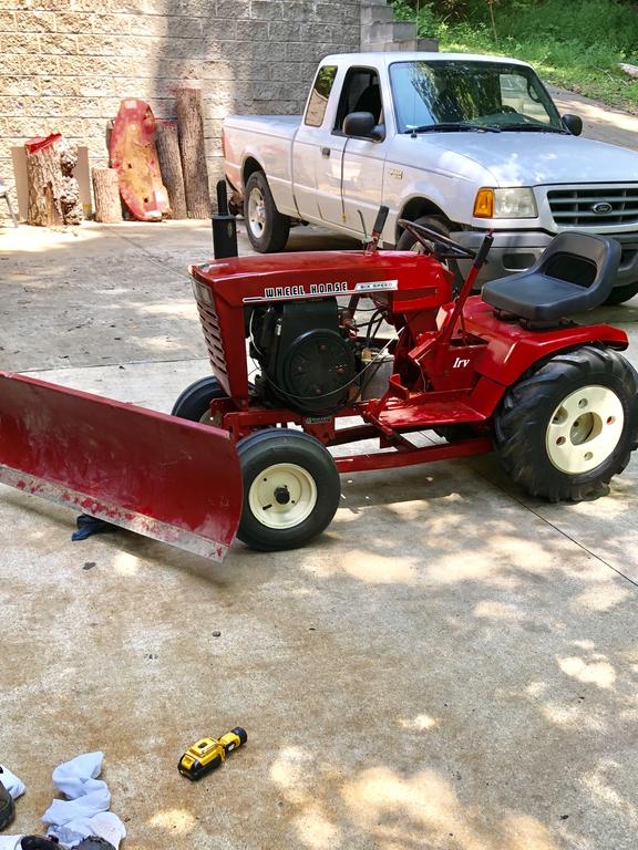

The Tuul Crib 7,354 #2886 Posted August 18, 2019 Put the blade back on IRV proceeded to push some dirt in the woods back behind my house. This is one strong a little beast. It's amazing what a little weight will do for the backend of these machines. 3 Share this post Link to post Share on other sites

Herder 2,356 #2888 Posted August 18, 2019 10 minutes ago, The Tool Crib said: Put the blade back on IRV proceeded to push some dirt in the woods back behind my house. This is one strong a little beast. It's amazing what a little weight will do for the backend of these machines. Ya and they look good too. 1 Share this post Link to post Share on other sites

The Tuul Crib 7,354 #2891 Posted August 18, 2019 19 minutes ago, Herder said: Ya and they look good too. I had to switch out the wheels on the front to my 6 inch because I'm having troubles getting the blade to go down low enough. So the wheels don't match ! Oh well dont really care about style its all about functionality ! 1 Share this post Link to post Share on other sites
TonyToro 1,190 #2892 Posted August 19, 2019 On 8/15/2019 at 8:38 PM, TonyToro said: I smash on it for while to get it “Good Enough”. I’ll take a picture of the spindle tomorrow. Here is the left spindle that was bent along side of the parts tractor spindle. I used a pipe wrench and a 3lb hammer to get it close enough to use. I am thinking I should make a pair of adjustable tie rods. 1 Share this post Link to post Share on other sites

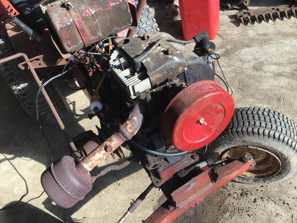

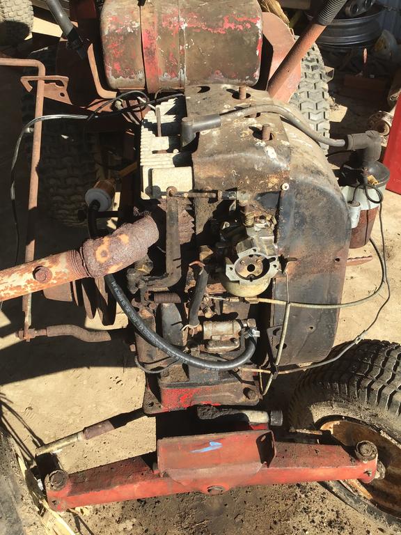

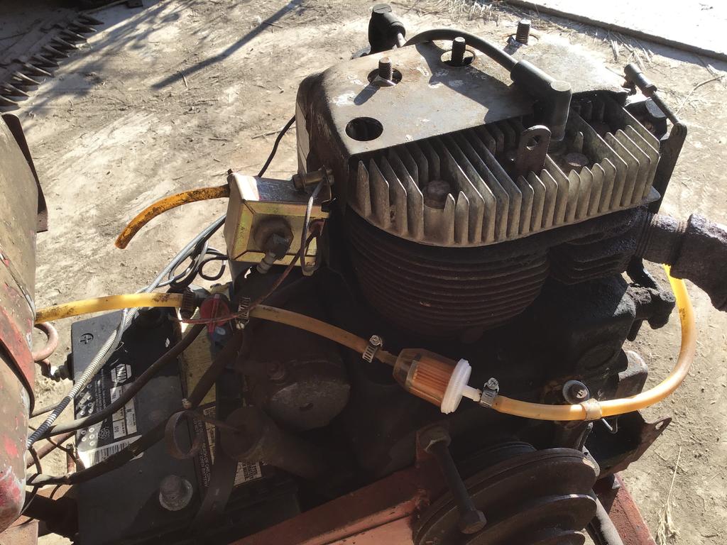

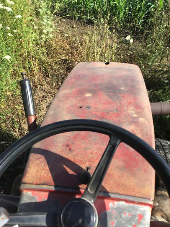

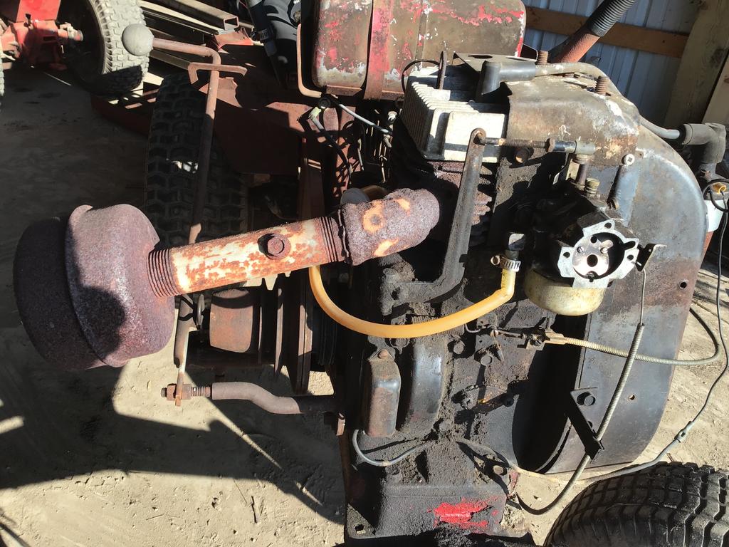

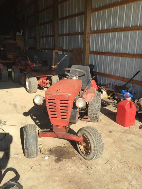

Pullstart 71,360 #2894 Posted August 19, 2019 Big Junky is getting some attention today. To pull fuel into the carb, I normally have to cover the carb completely with my hand and make sure the tank is full. I’ve been meaning to swap on a pump from a broken rod engine.... since this tractor has obviously had some fuel issues in the past. It’s now pumping and will start on it’s own! Why should I work on this beast, when I’ve got nicer looking workers? It’s heavy and has a drawbar AND slot hitch... so I can spread chicken poo from a trailer AND disc the food plot... that’s why Some day, Big Junky will be complete when this Big Junky stack finds it’s way on! 3 3 Share this post Link to post Share on other sites

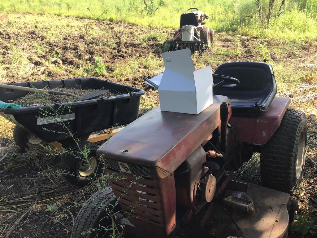

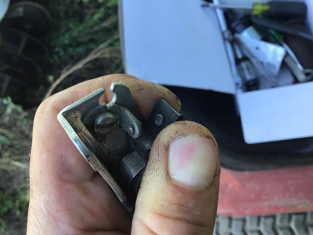

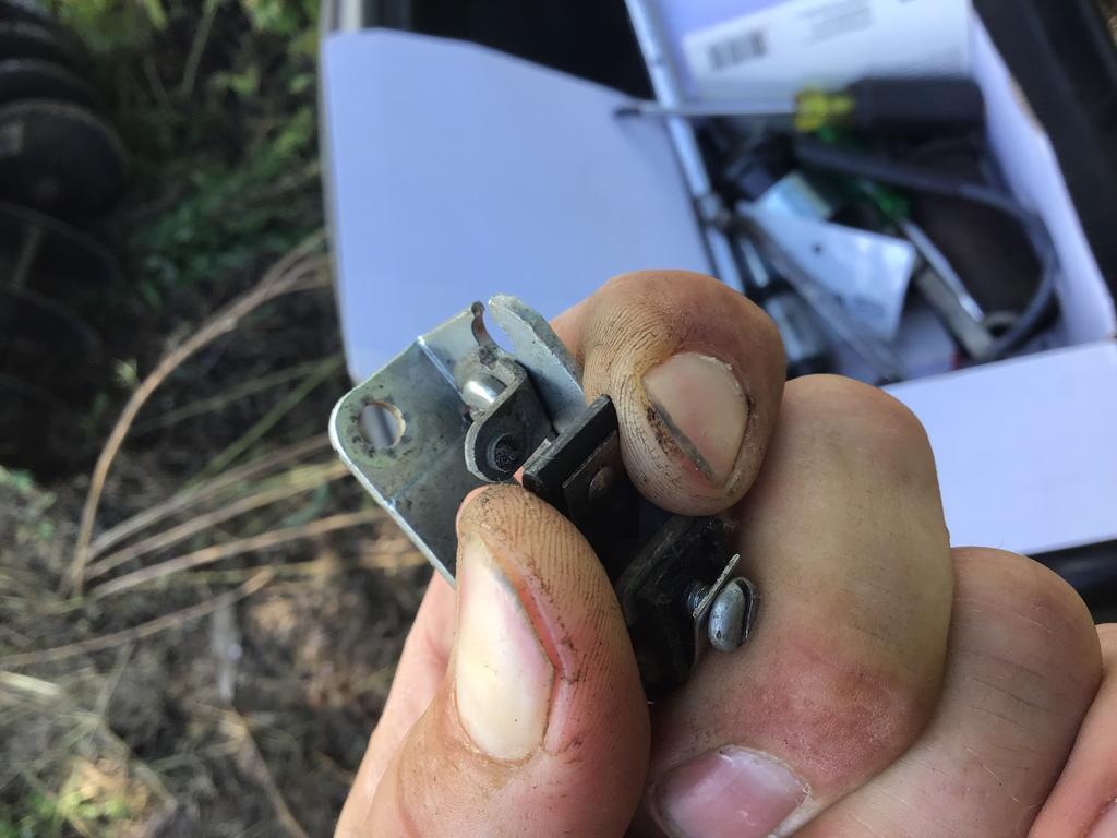

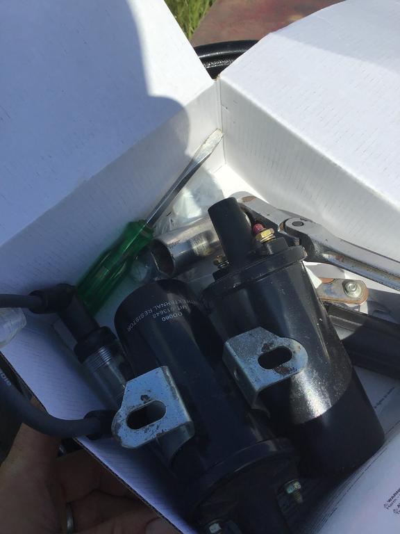

Pullstart 71,360 #2895 Posted August 19, 2019 What more fitting, than using the Polished Turd to bring spares out to Big Junky! I was cruising along and believe to have lost spark. I have two coils and a new set of points to try out today! 4 2 1 Share this post Link to post Share on other sites
Pullstart 71,360 #2896 Posted August 19, 2019 I believe my issue was the points, but the funny thing was that it ran great for a few minutes, died, sat for a while, fired back up... like a weak coil would act. I replaced the coil, and it did the same thing. I never touched the points, trying one thing at a time. It fired back up, ran for a few minutes, then died again! I swapped my spare set in and whalla! It worked and I’m back in business! 5 2 Share this post Link to post Share on other sites
