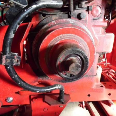

Bill D 3,167 #26707 Posted September 10 21 minutes ago, adsm08 said: And how does one go about checking those? I am not particularly familiar with this style PTO setup. Does the PTO look like this? If so, the bearing on the end that connects to the clutch hoop fails. Under load it won't spin easily. If it feels rough, change it. I'm not familiar with the 1075, so if it has a different PTO I apologize for the confusion. Share this post Link to post Share on other sites
ineedanother 2,879 #26708 Posted September 10 23 hours ago, adsm08 said: but the blades could be sharper. Wife found a 312-8 that needs a fuel pump and two tires for $175 tonight. Maybe it just needs a Magnum re-power. I'm leaning toward these. Sharp, clean blades would be my first and most frugal thing to rule out though. Share this post Link to post Share on other sites
adsm08 5,193 #26709 Posted September 10 3 minutes ago, Bill D said: Does the PTO look like this? If so, the bearing on the end that connects to the clutch hoop fails. Under load it won't spin easily. If it feels rough, change it. I'm not familiar with the 1075, so if it has a different PTO I apologize for the confusion. It's similar to that style. Share this post Link to post Share on other sites

Lee1977 7,801 #26711 Posted September 10 9 hours ago, adsm08 said: And how does one go about checking those? I am not particularly familiar with this style PTO setup. Another thing to check on the PTO if it's cutting is the C-clip on the out side bearing on the short shaft. If it comes out of the groove you can't keep it adjusted. I have replace the c-clips and the short shaft and out side bearing a couple of times on my C-120 in the last 49 years. Share this post Link to post Share on other sites

peter lena 10,082 #26713 Posted September 10 @Bill D those pto bearings are cake , outer sealed bearing is available at NAPA , inner needle bearing , hangs up due to engine heat lubrication failure , carefully clean out , like carb cleaner , then , LUCAS EXTRA HD CREEN CHASSIS GREASE , WHY ? 550 deg flash point , also polyurea rated , anti sling , VERY SPARINGLY , excess slings to clutch face , this is the KEY TO SMOOTH LEVER ENGAGEMENT . my 3 horses have this in use for years , never burned out a clutch disc , does any of this make sense to you ? TRY , ENGAGE , TRY ? does it work ? is it better ? is it worse ? thats how I ELIMINATE REPEDITIVE PROBLEMS . ironically , if you paint related areas / red / black , they literally disappear .just TRY SOMETHING ! inspire / encourage yourself , that changes how you look at problems , BTW there is a simple spring pull on the PTO swing lever , down to related , frame HITCH PIN CLIP , STOPS LINKAGE BUZZING ! my picture problem also needs elimination , pete 1 Share this post Link to post Share on other sites

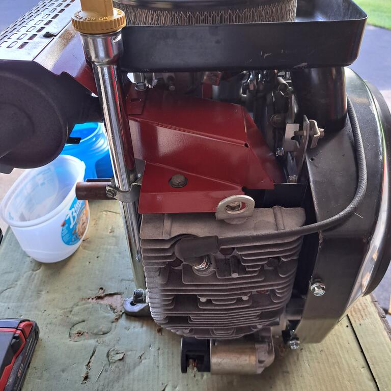

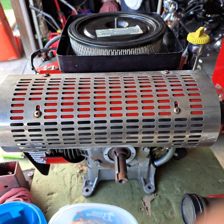

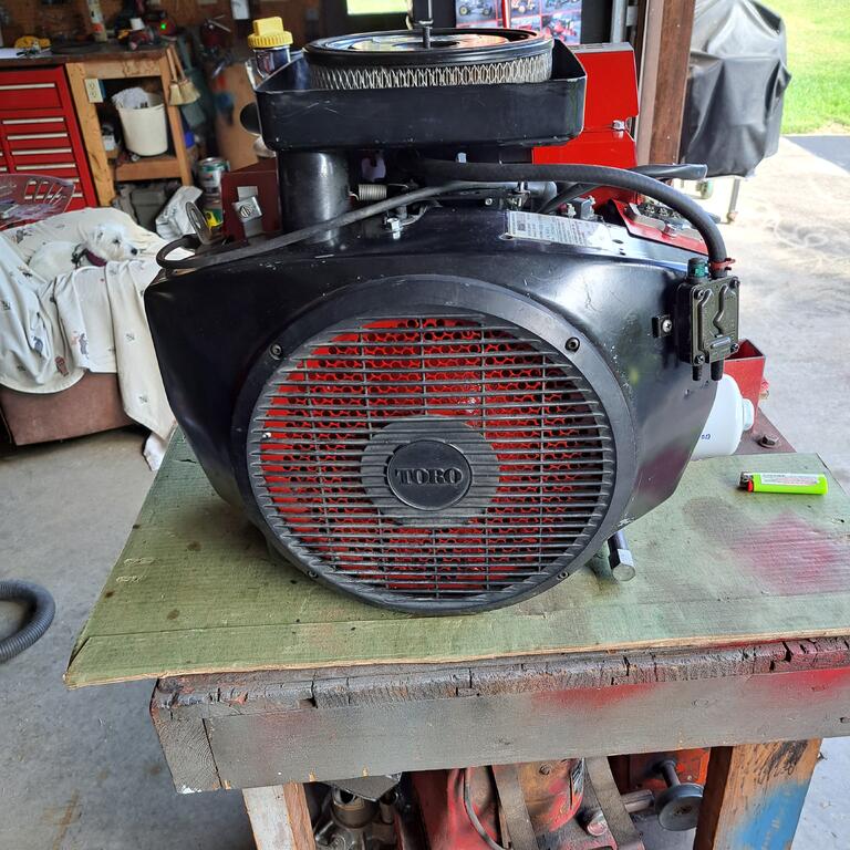

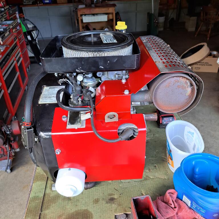

WHX?? 58,298 #26714 Posted September 10 Killing time to go to the last tractor show so finished up a Onan I got from @Blasterdad at Pullstart's plow day. Should have left the heat shield off 'till after retorque heads run. I have high hopes for this being a decent shelf motor for the 520s. Hope you like the color changes. Just something different. 4 11 Share this post Link to post Share on other sites

squonk 48,209 #26716 Posted September 11 On 9/9/2026 at 9:28 PM, adsm08 said: It's similar to that style. Outer bearing fails a lot # 204rr6 Share this post Link to post Share on other sites

lynnmor 9,050 #26720 Posted September 11 On 9/10/2026 at 11:04 AM, WHX?? said: Killing time to go to the last tractor show so finished up a Onan I got from @Blasterdad at Pullstart's plow day. Should have left the heat shield off 'till after retorque heads run. I have high hopes for this being a decent shelf motor for the 520s. Hope you like the color changes. Just something different. Don't forget the grommet, gasket, seal or whatever it's called today, that seals around the oil filter. I know that you are aware of that but I thought it might be a good time to remind others in this crowd. I do wonder why the oil filter is so far from center of the opening, it appears that the tins need to move back. 3 Share this post Link to post Share on other sites

CRF857 1,200 #26722 Posted September 11 12 hours ago, squonk said: Outer bearing fails a lot # 204rr6 Just replaced one of those today. Easy-peasy. Less than ten minutes. 1 Share this post Link to post Share on other sites

WHX?? 58,298 #26725 Posted September 12 11 hours ago, lynnmor said: the grommet, gasket, seal or whatever it's called today, that seals around the oil filter. Nope haven't forgotten that. Going to see how it runs first. We talked about this in another thread and may try slitting some automotive vacuum sizes and make one. I'm cheap and they are as pricey as oem gaskets. Don't know why the filter is not centered but there's not much wiggle room on the tins unless I slot holes. Share this post Link to post Share on other sites
