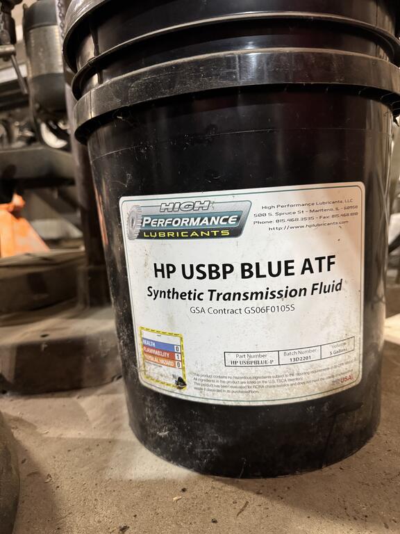

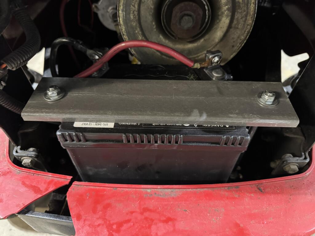

Bugzilla46310 56 #26680 Posted September 6 Going through the 520xi I just purchased as leaf vacuuming season will be here shortly. Besides new air filter, greasing, changing tranny and engine oil and filters, the mower didn’t have a battery hold down bracket so I made one of those. One of the lift rods was broken and the PO had it tied up with rope so I fabricated one of those also, as the $80 price I saw for a OEM one was totally ridiculous. Went with synthetic transmission fluid and with the little I drove it, it seemed to drive better. Forgot I bought new plugs so I still need to replace them. Have bearings for poor man’s power steering but that will be a separate project. The battery on my AC916H that I sold that I have been nursing along for a few years of course died the day the buyer came to get it so it got the 520xi battery and the 520xi got a new one. 3 Share this post Link to post Share on other sites

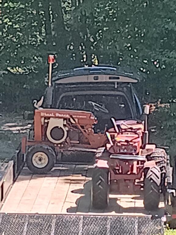

ebinmaine 80,893 #26682 Posted September 6 Started separating the Herd for transportation to @JCM & @Raven 's annual North Berwick Meet n Greet. 5 Share this post Link to post Share on other sites

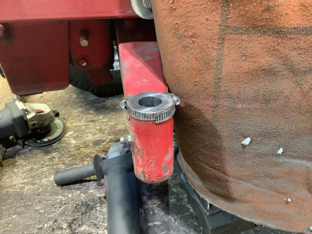

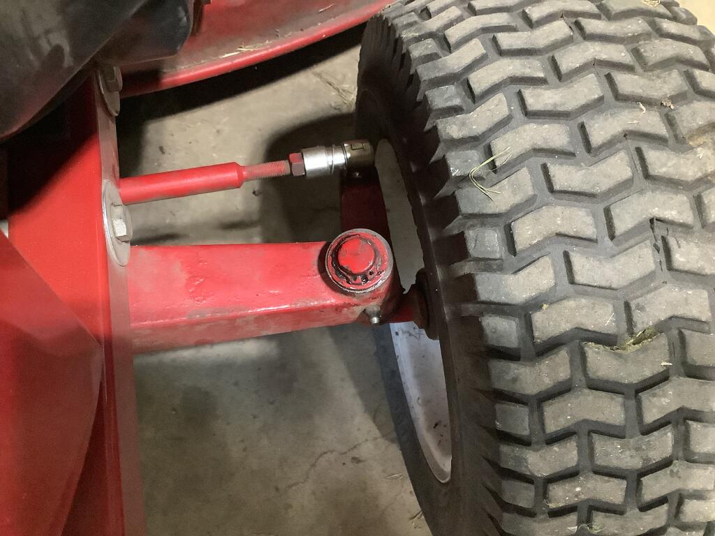

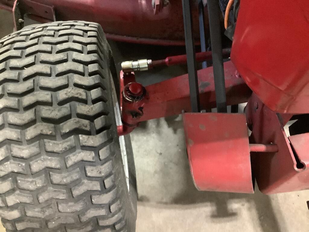

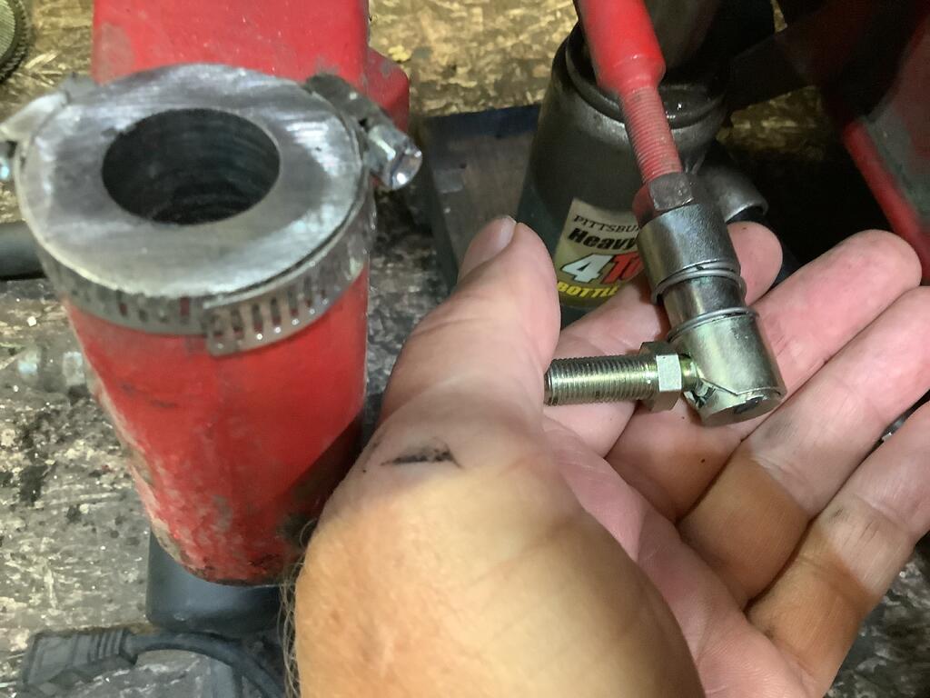

CRF857 1,200 #26683 Posted September 6 Installed thrust bearings on the spindles today. Didn’t take long to do, made a big difference. Used two narrow hose clamps to use as a guide. Then started cutting with a part off blade, and finished the final depth of material removal with a flap disc wheel. Reassembled with a goodly amount of Red and Tacky grease. In disassembly I discovered the left side tie rod end was froze up. Replaced both sides with new spring loaded ones. Made setting the toe in easy. 8 3 Share this post Link to post Share on other sites
cleat 9,380 #26684 Posted September 6 1 hour ago, CRF857 said: Installed thrust bearings on the spindles today. Didn’t take long to do, made a big difference. Used two narrow hose clamps to use as a guide. Then started cutting with a part off blade, and finished the final depth of material removal with a flap disc wheel. Reassembled with a goodly amount of Red and Tacky grease. In disassembly I discovered the left side tie rod end was froze up. Replaced both sides with new spring loaded ones. Made setting the toe in easy. I have never seen those tie rod ends before. 3 Share this post Link to post Share on other sites
ebinmaine 80,893 #26685 Posted September 6 39 minutes ago, cleat said: I have never seen those tie rod ends before. 40 minutes ago, cleat said: tie rod end spring loaded ones. Me either. What's the spring do? Share this post Link to post Share on other sites
Bill D 3,167 #26686 Posted September 6 Those are quick disconnect tie rod ends. 2 Share this post Link to post Share on other sites
ebinmaine 80,893 #26687 Posted September 6 1 hour ago, Bill D said: Those are quick disconnect tie rod ends. Nevah hoid of it! 1 1 Share this post Link to post Share on other sites
Bill D 3,167 #26688 Posted September 6 7 minutes ago, ebinmaine said: Nevah hoid of it! Me neither, but Google had. 1 1 Share this post Link to post Share on other sites
Lee1977 7,801 #26689 Posted September 7 Me either, I have good quality heims joints on five of my tractors. don't think I would ever try them. 2 Share this post Link to post Share on other sites
sqrlgtr 4,084 #26690 Posted September 7 11 hours ago, ebinmaine said: Nevah hoid of it! Hillbilly translation "Aint never even heard of them before" 1 1 Share this post Link to post Share on other sites

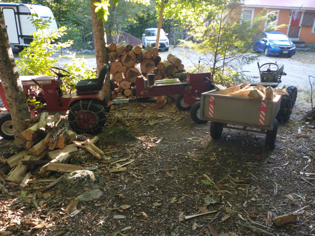

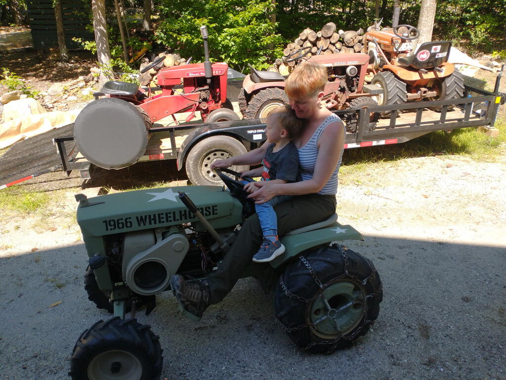

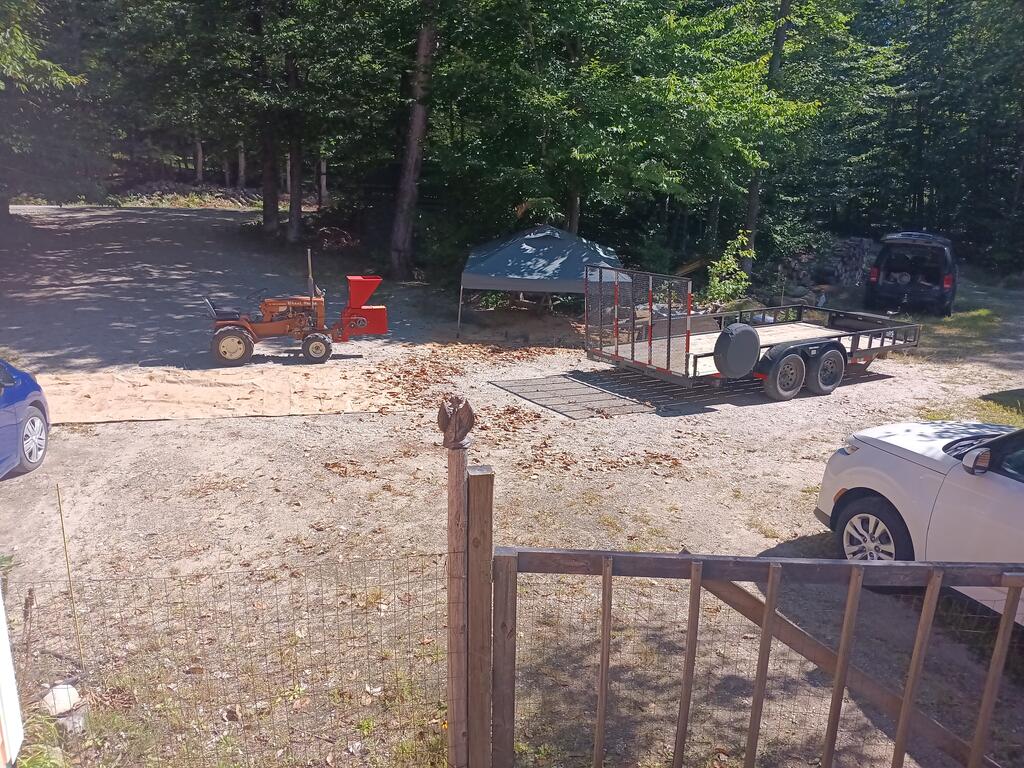

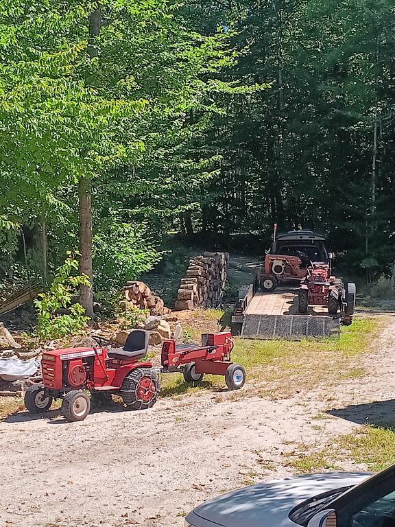

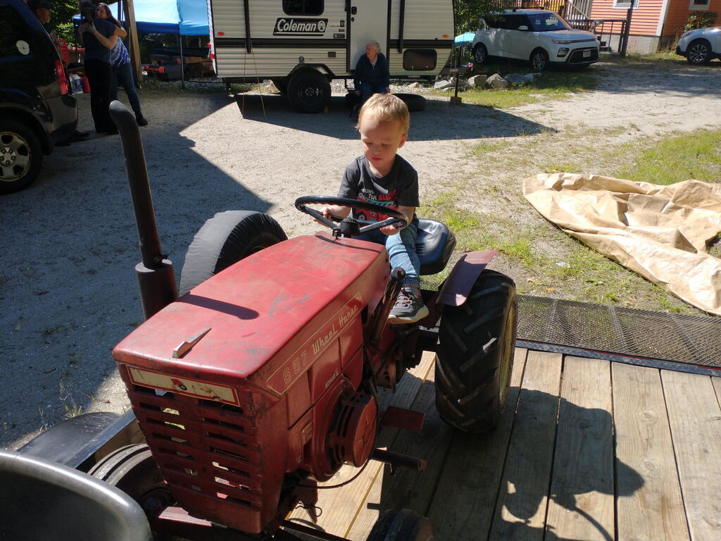

ebinmaine 80,893 #26691 Posted September 7 Very busy day here this Labor Day. Trina's family was here for a mid day gathering and meal. The grandson HAD to have some tractor time. Won't be long before he's driving on his own. He gave the Sparky tractor a little test today. After all that was done Trina kept going as usual. More firewood processing with The Ugly Bruce tractor hauling the splitter and Millie pulling the loads of split wood. 1 3 4 Share this post Link to post Share on other sites

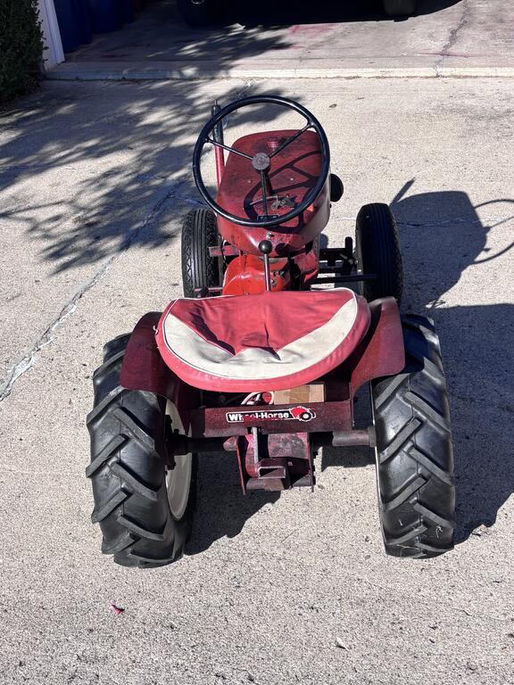

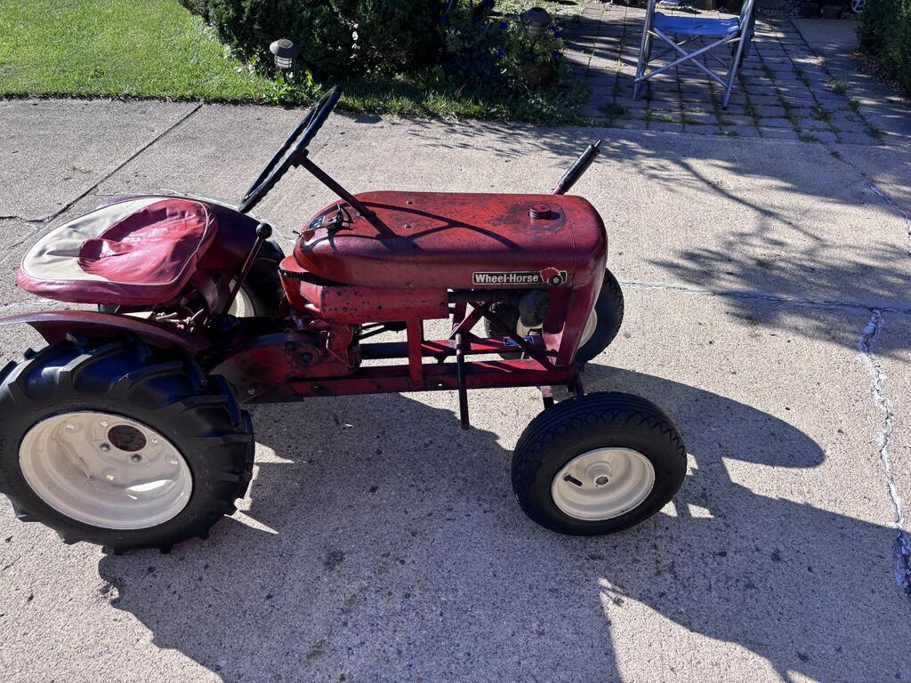

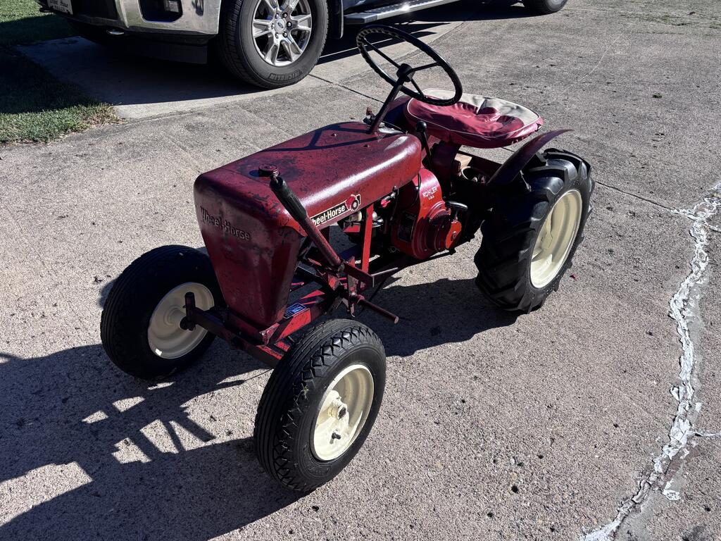

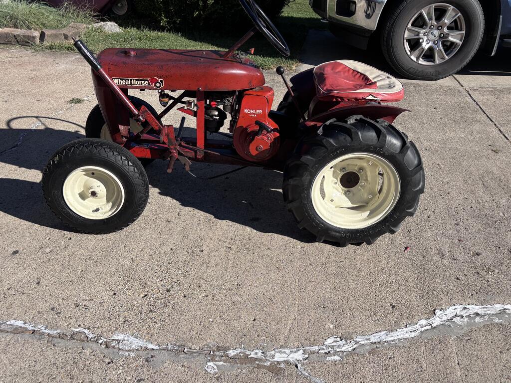

Lane Ranger 12,131 #26694 Posted September 8 Put my second coat of boiled linseed oil on my 1958 patina Wheel Horse RJ i bought last August in Indianapolis! i really love this one! Joe Papke just finished redoing the Schnacke recoil o put back on with one of my stainless steel hex nuts i had made for a Kohler Schnacke application. I had the Hex nut made so you could reverse it if it wears groves in the hex from The three metal dogs in the recoil! This one has the original oil bath air cleaner and amazingly a hood with no cracks in the metal around the gas tank neck hole! Yes motor smokes some and i really have not run it much but thats ok with me! It started on the very first pull of the Schnacke after i turned the gas line valve open and set the choke door on the carburetor! IMG_4493.mov IMG_4495.mov IMG_4492.mov 1 10 Share this post Link to post Share on other sites
peter lena 10,082 #26695 Posted September 8 @CRF857 been road testing steering heim joints for years , never had a failure , also on my plow blade swing arms , pto lever shaft to mule drive , greatly enhances any movement , pete 2 Share this post Link to post Share on other sites
