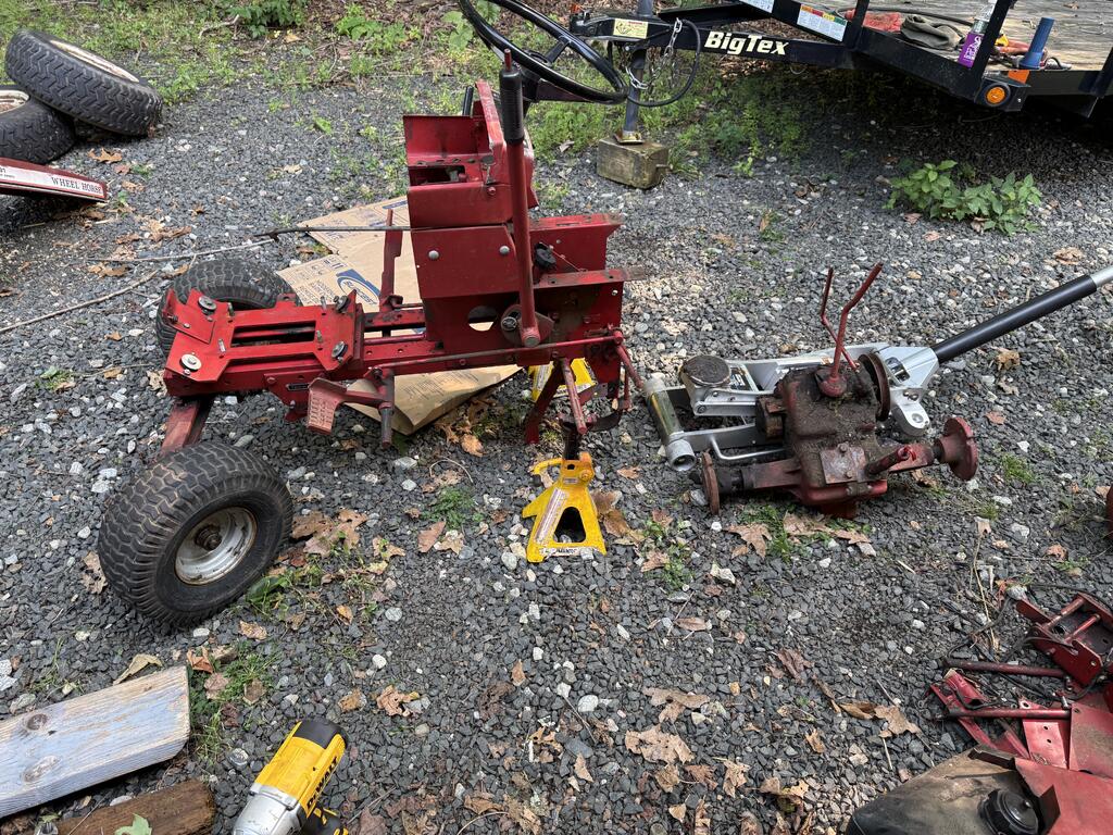

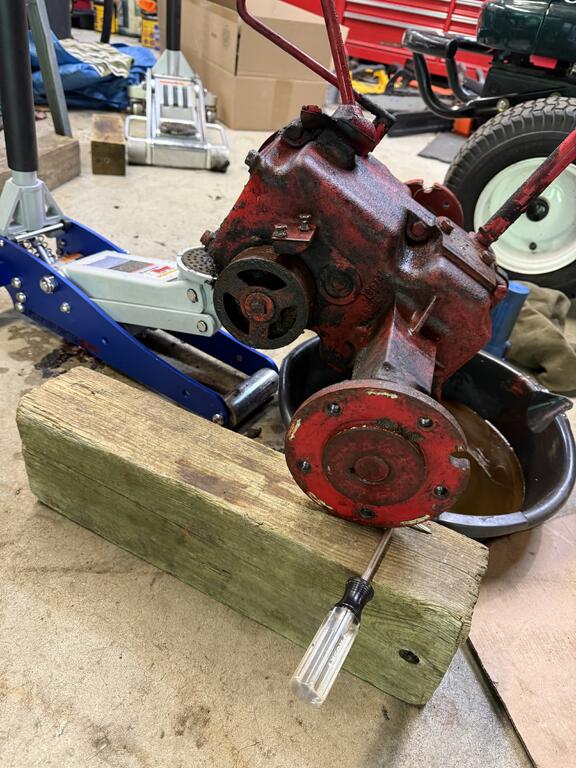

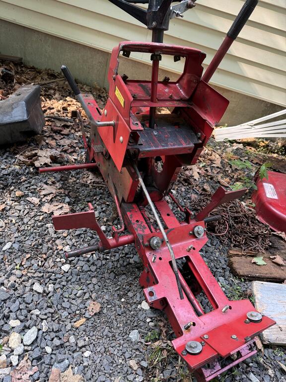

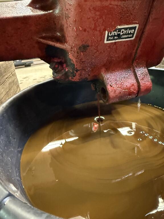

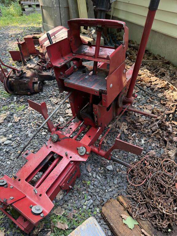

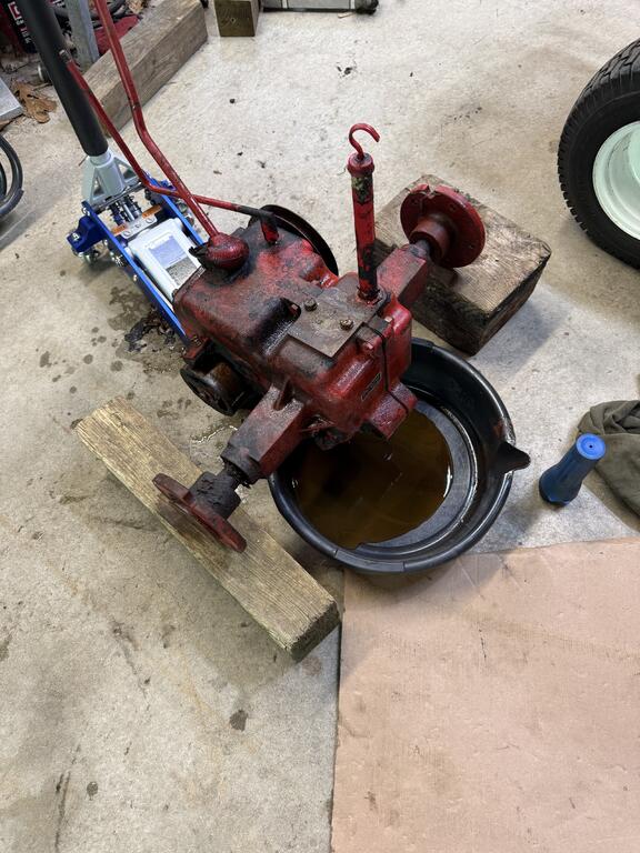

Sparky-(Admin) 26,716 #26551 Posted August 9 Doing an 8 speed gear oil change..easier to just remove the trans right 1 1 8 1 Share this post Link to post Share on other sites
SylvanLakeWH 32,837 #26552 Posted August 9 Well... er... uhm... it works... I guess... 2 1 Share this post Link to post Share on other sites
C100guy94 127 #26553 Posted August 9 5 minutes ago, SylvanLakeWH said: Well... er... uhm... it works... I guess... I'm with you. I mean no,but yea,nope not really,but like yea I kinda get why you would, but why did you. Lmao yep Id have done the same so no room to talk on my part haha 1 Share this post Link to post Share on other sites
MainelyWheelhorse 3,202 #26554 Posted August 9 @Sparky that works. It makes it easier to fill too.😀 Share this post Link to post Share on other sites

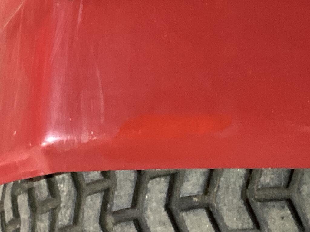

MainelyWheelhorse 3,202 #26555 Posted August 9 Today after work was touch up and detail painting, fixing scrapes and chips day.. much nicer. 1 Share this post Link to post Share on other sites

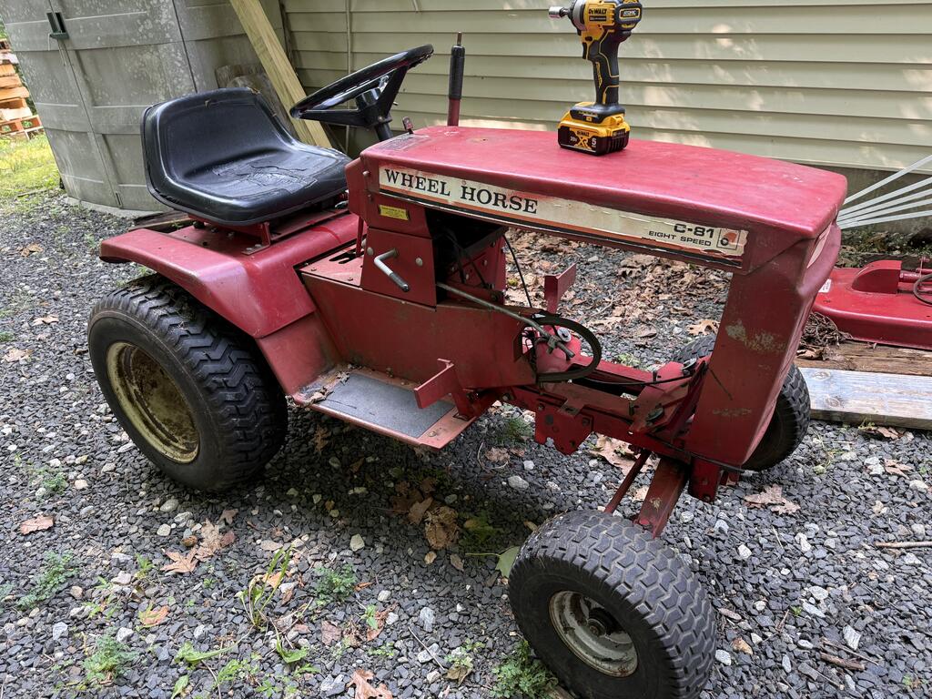

Sparky-(Admin) 26,716 #26556 Posted August 9 3 hours ago, SylvanLakeWH said: Well... er... uhm... it works... I guess... LOL! This C-81 is a parts rig and I decided to strip it down today..trans will sit on a shelf as a spare but I wanted fresh fluid in it before it gets stored away. 6 2 Share this post Link to post Share on other sites
C100guy94 127 #26557 Posted August 9 (edited) Now that makes sense. Super clean for a parts rig Edited August 9 by C100guy94 Share this post Link to post Share on other sites

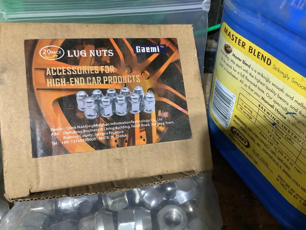

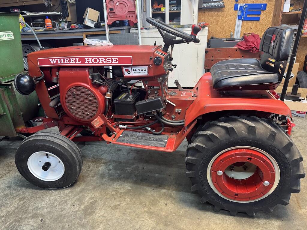

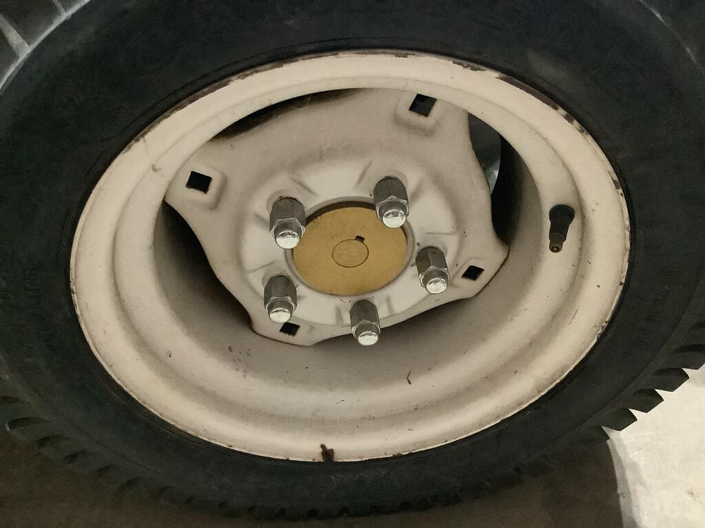

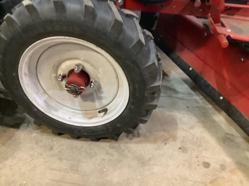

CRF857 1,401 #26558 Posted August 10 5 hours ago, peter lena said: @CRF857 like the bolt on stud hubs , noting your rear seat under spring , have regularly enhanced mine to this type of bolt on compression spring , also added , stiff vibration pad strips under seat frame rails , for more height , more to my liking . all my paints are lubrication soaked , staged , recovery . where did you get the bolt on stud hubs ? thanks , pete Those are the original hubs. Full threaded bolts installed from the backside, with lock washers and loctite. Have done that on most of my tractors. I will at minimum put in one or two bolts that way. Makes hanging a tire/rim a lot easier. I usually use chrome acorn lug nuts for some added bling. On the 520 the studs on the spacer looked a little long for the acorn lug nuts I have. Plus I would be 3 pieces short. Need to get more. 1 2 Share this post Link to post Share on other sites

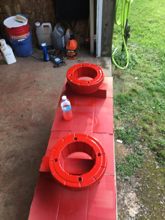

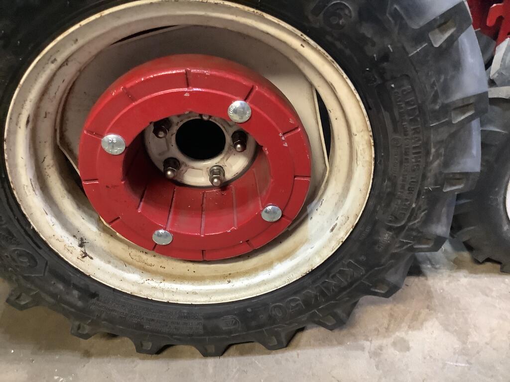

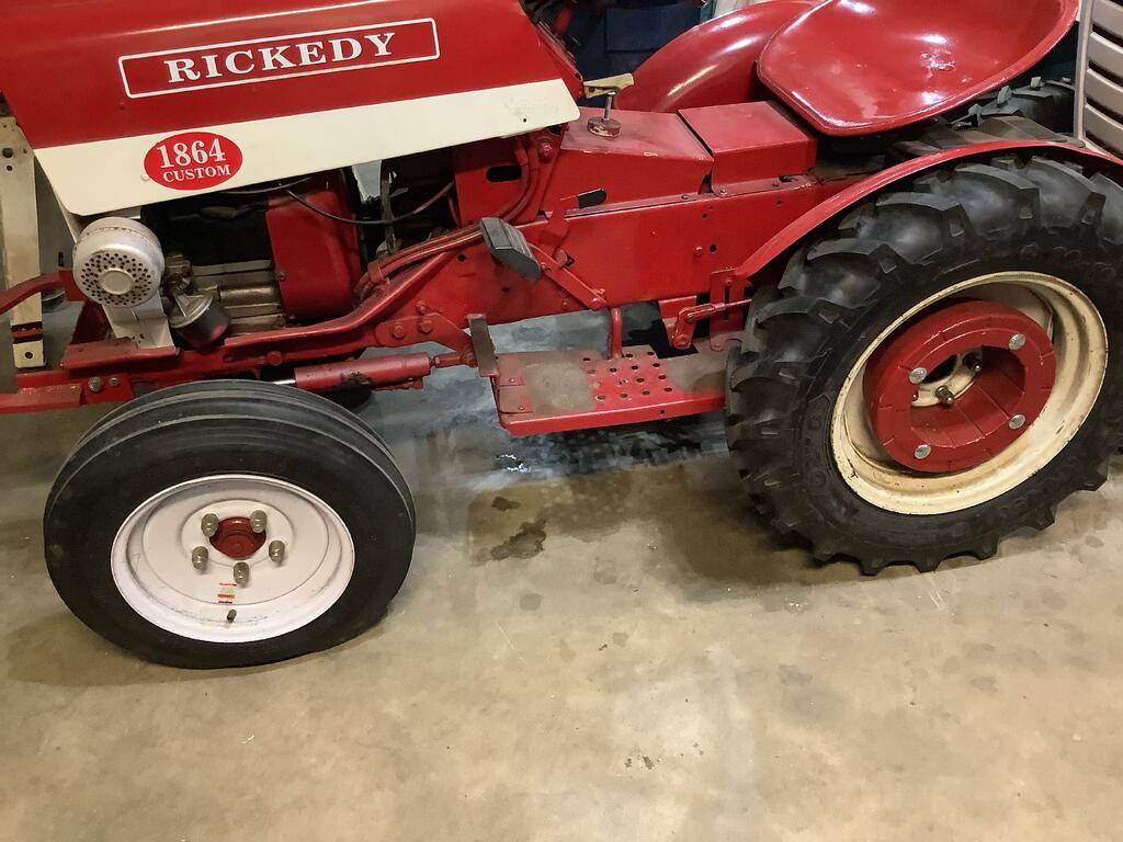

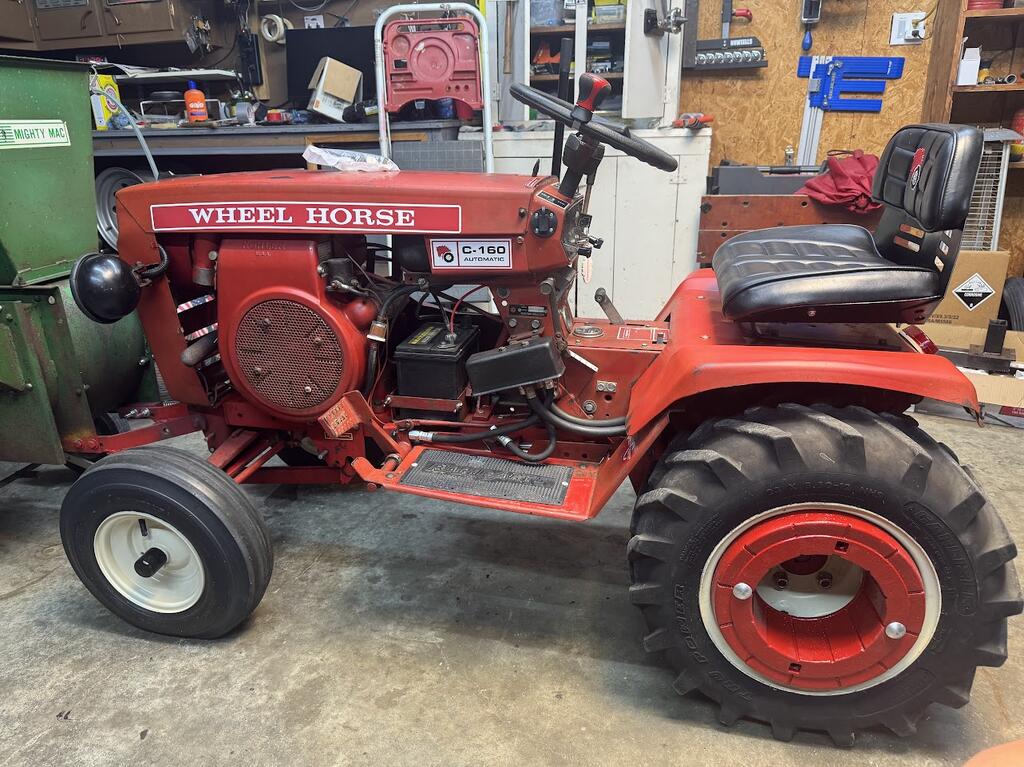

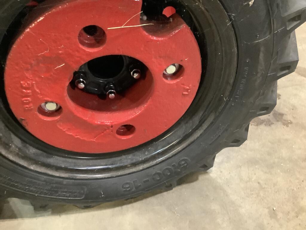

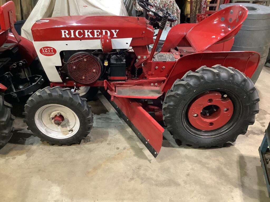

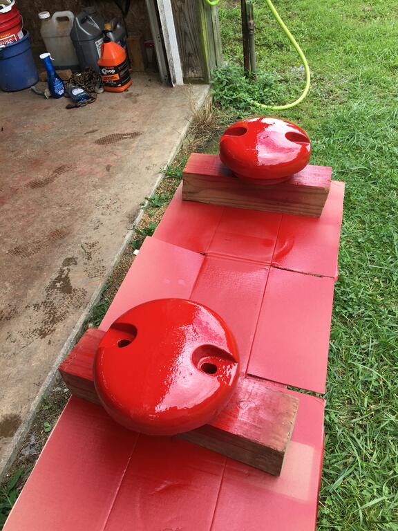

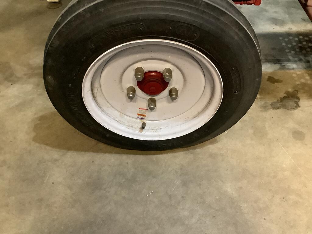

Bar Nuthin 3,545 #26559 Posted August 10 (edited) Decided that painting these wheel weights was worth the effort. Now I just need to pull the front wheels and get rid of that bright white that somebody painted them with. UPDATE: Edited August 10 by Bar Nuthin 3 8 Share this post Link to post Share on other sites
Wheelhorse#1 1,998 #26560 Posted August 10 22 hours ago, Sparky said: LOL! This C-81 is a parts rig and I decided to strip it down today..trans will sit on a shelf as a spare but I wanted fresh fluid in it before it gets stored away. Sure is nice to have spare parts tractors around especially as these things become more expensive and hard to find. Share this post Link to post Share on other sites
sqrlgtr 4,192 #26561 Posted August 10 Painted some WH rear wheel weights and some JD front weights red today. 8 4 Share this post Link to post Share on other sites

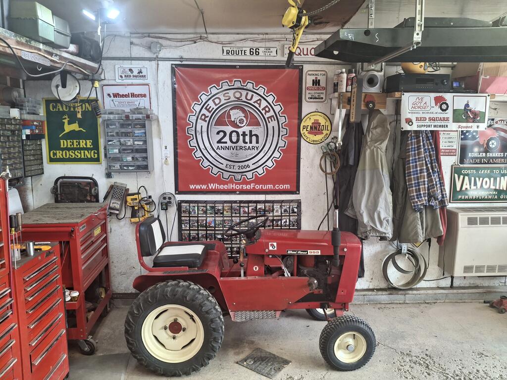

squonk 48,354 #26562 Posted August 11 Not really a "done to" but got my RS 20th anniversary banner hung up after moving a bunch of other stuff around. 3 10 2 Share this post Link to post Share on other sites
sqrlgtr 4,192 #26563 Posted August 11 19 minutes ago, squonk said: RS 20th anniversary banner hung up Looks great hate I didnt get to make this year show. Btw what is next years featured tractor? 2 Share this post Link to post Share on other sites

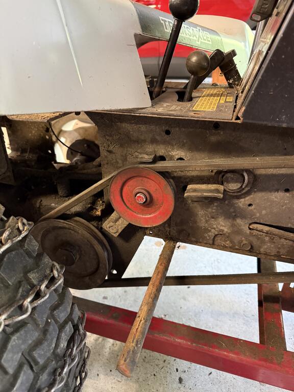

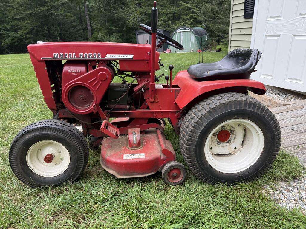

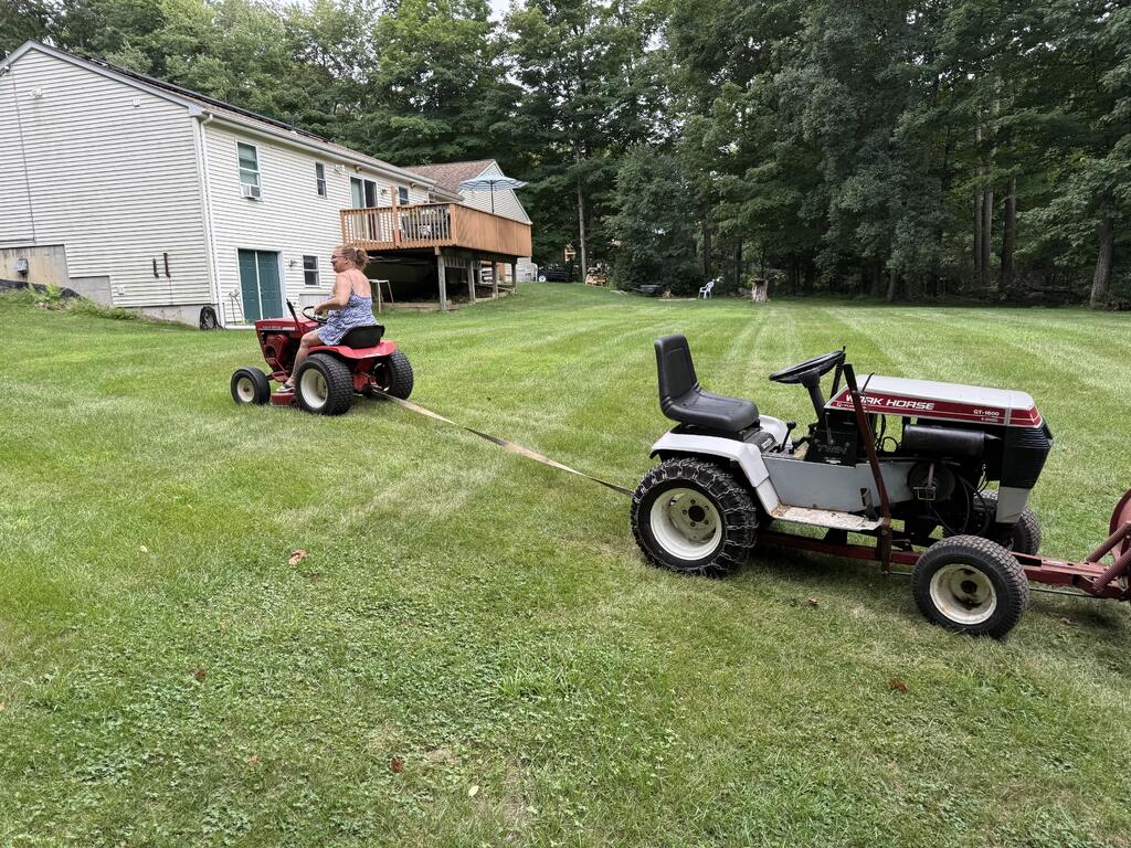

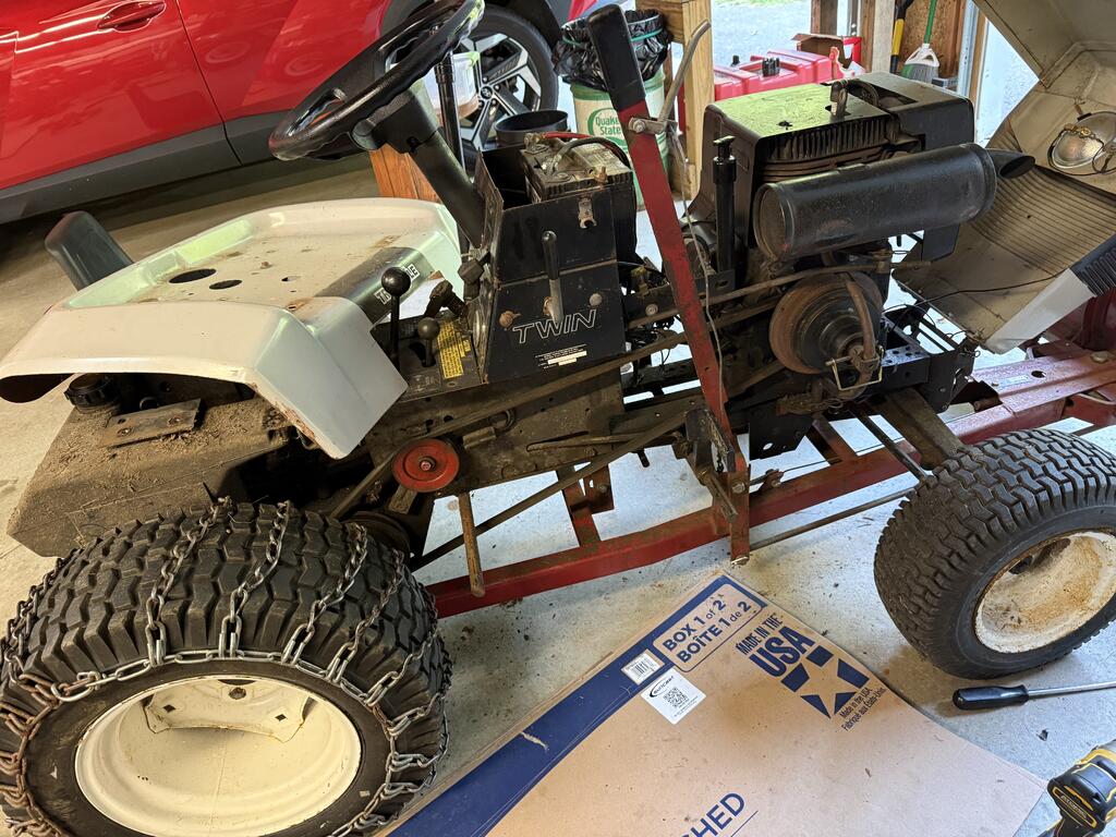

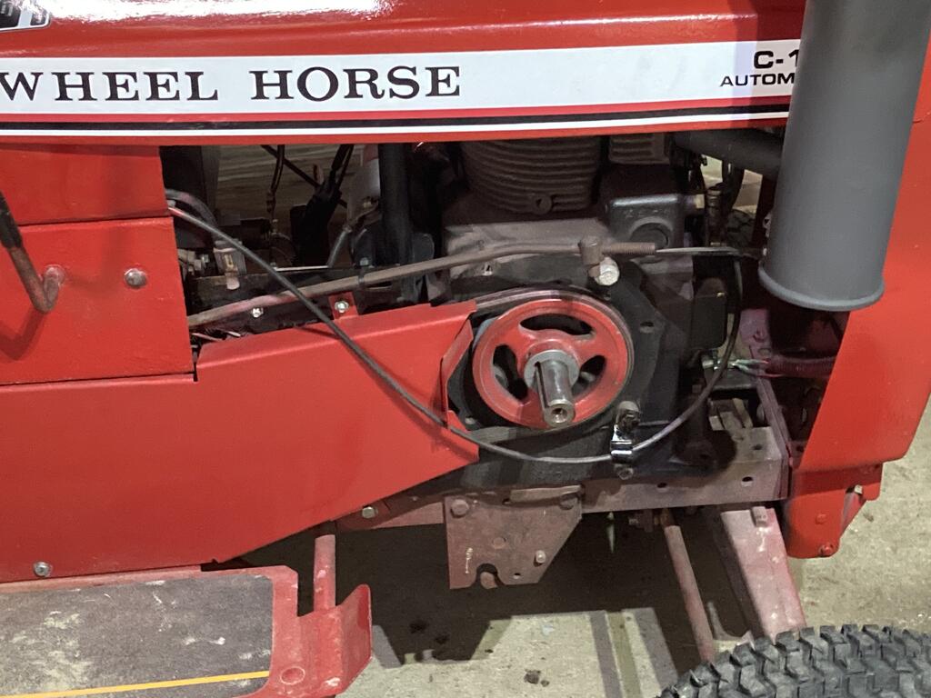

Sparky-(Admin) 26,716 #26564 Posted August 11 The 67 towed the 83 from the back shed up to the garage for a drive belt swap. Thought I was saving a few $$ using the belt I just removed from a junk C-81..but it ended up being a little shorter and she just doesn’t declutch like it should. Grinds the gears a bit. Crud!! I guess I’ll be using a brand new belt I picked up at this years WH Show. The idler pulley was shot on the 83 (GT-1600) so the C-81 did donate a nice smooth one so there’s that 5 1 Share this post Link to post Share on other sites

cleat 9,410 #26568 Posted August 12 3 hours ago, Sparky said: The 67 towed the 83 from the back shed up to the garage for a drive belt swap. Thought I was saving a few $$ using the belt I just removed from a junk C-81..but it ended up being a little shorter and she just doesn’t declutch like it should. Grinds the gears a bit. Crud!! I guess I’ll be using a brand new belt I picked up at this years WH Show. The idler pulley was shot on the 83 (GT-1600) so the C-81 did donate a nice smooth one so there’s that That Twin cylinder Briggs looks a lot like a single cylinder Kohler......JK looks great. 3 Share this post Link to post Share on other sites
Sparky-(Admin) 26,716 #26569 Posted August 12 8 hours ago, cleat said: That Twin cylinder Briggs looks a lot like a single cylinder Kohler......JK looks great. Good eye Cleat!! She now has a Kohler 14 Magnum single under the hood! 3 Share this post Link to post Share on other sites
cleat 9,410 #26570 Posted August 12 Funny, I rebuilt a GT1600 and converted it to hydro a couple of years ago and am now in the process of rebuilding a 314 that has a Kohler M14. 2 1 Share this post Link to post Share on other sites
sqrlgtr 4,192 #26571 Posted August 12 3 hours ago, Sparky said: Good eye Cleat!! She now has a Kohler 14 Magnum single under the hood! Decepticon 1 Share this post Link to post Share on other sites

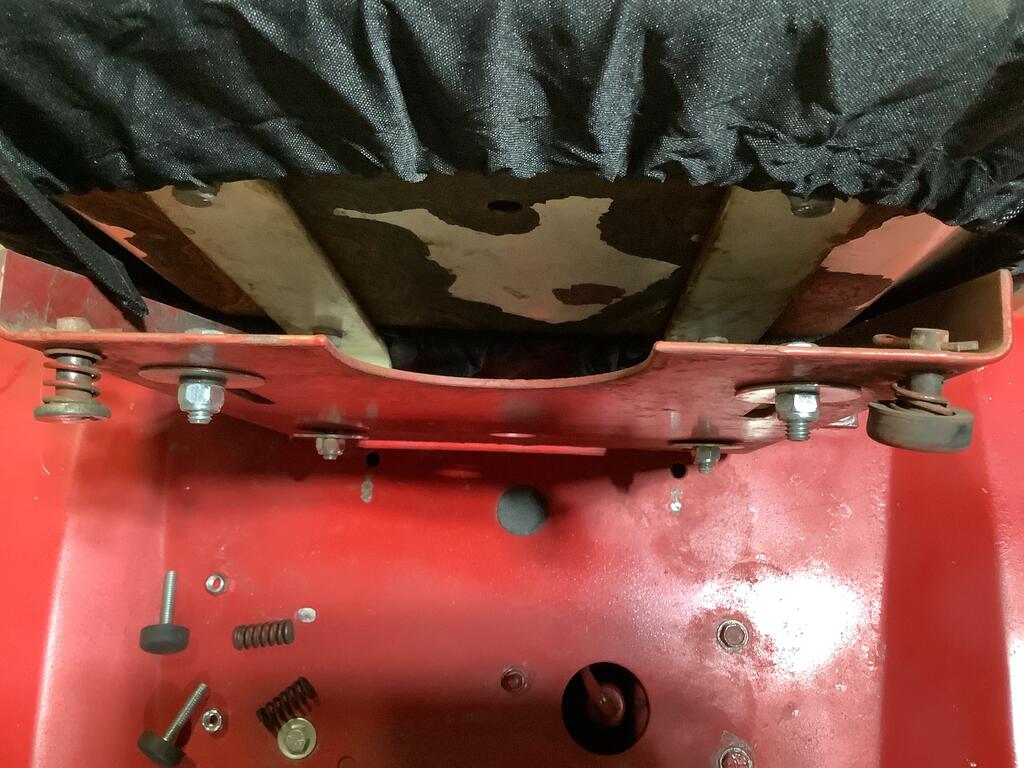

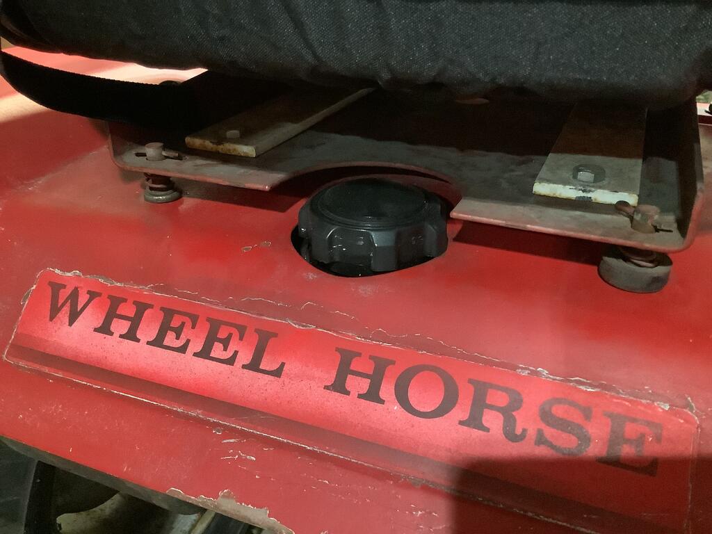

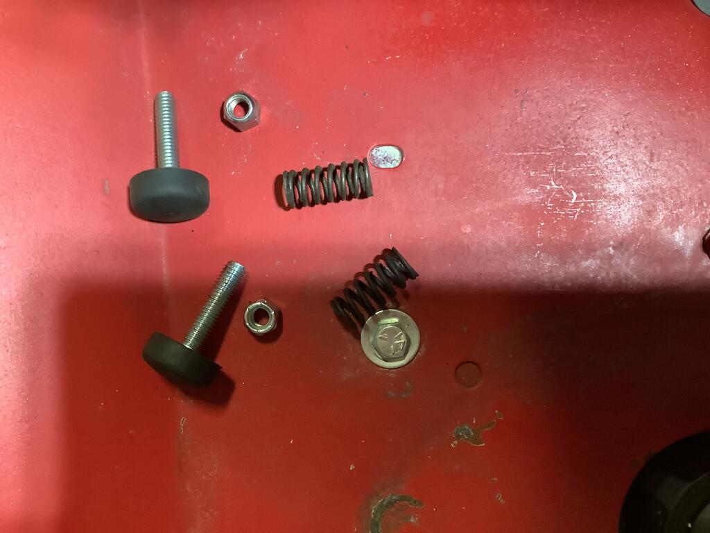

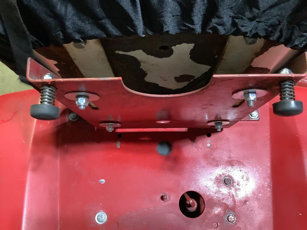

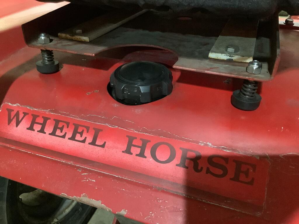

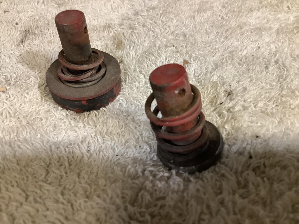

CRF857 1,401 #26572 Posted August 13 The C41 has two rubber stops and springs under the seat/spring mounting plate. one spring was broken and one rubber stop was missing. After scrounging through the “extra parts” I found two heavier springs and two rubber stops. A few minutes later they were installed. 7 2 Share this post Link to post Share on other sites

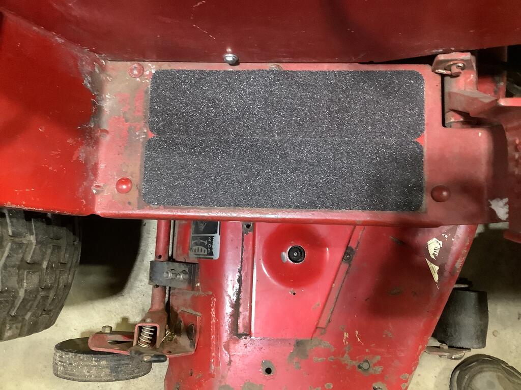

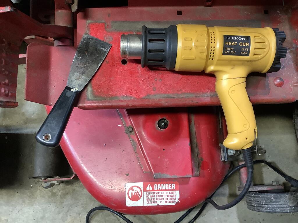

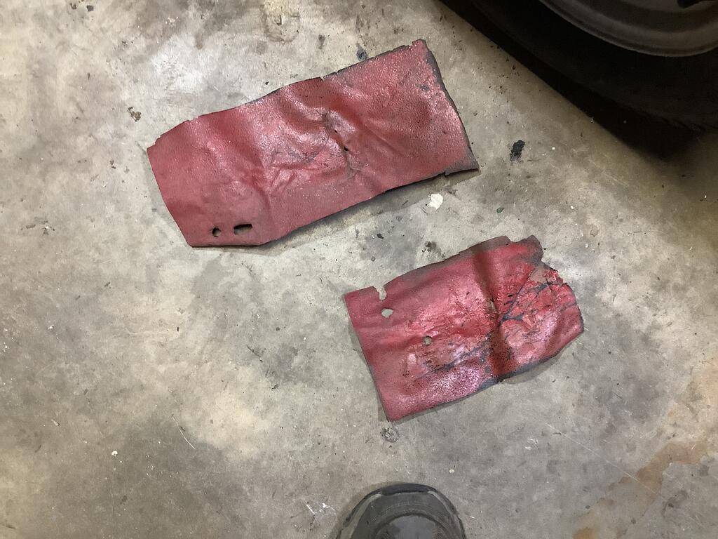

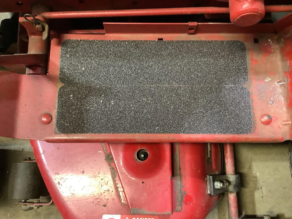

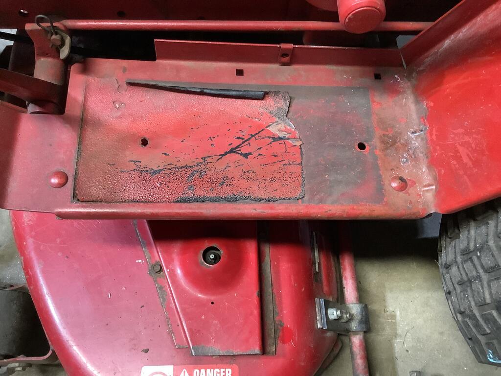

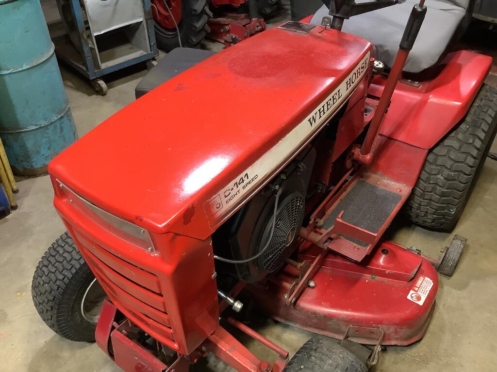

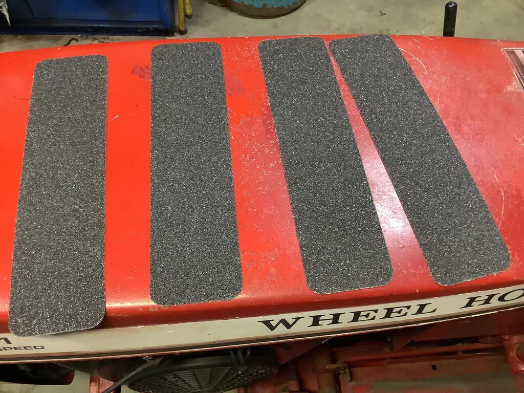

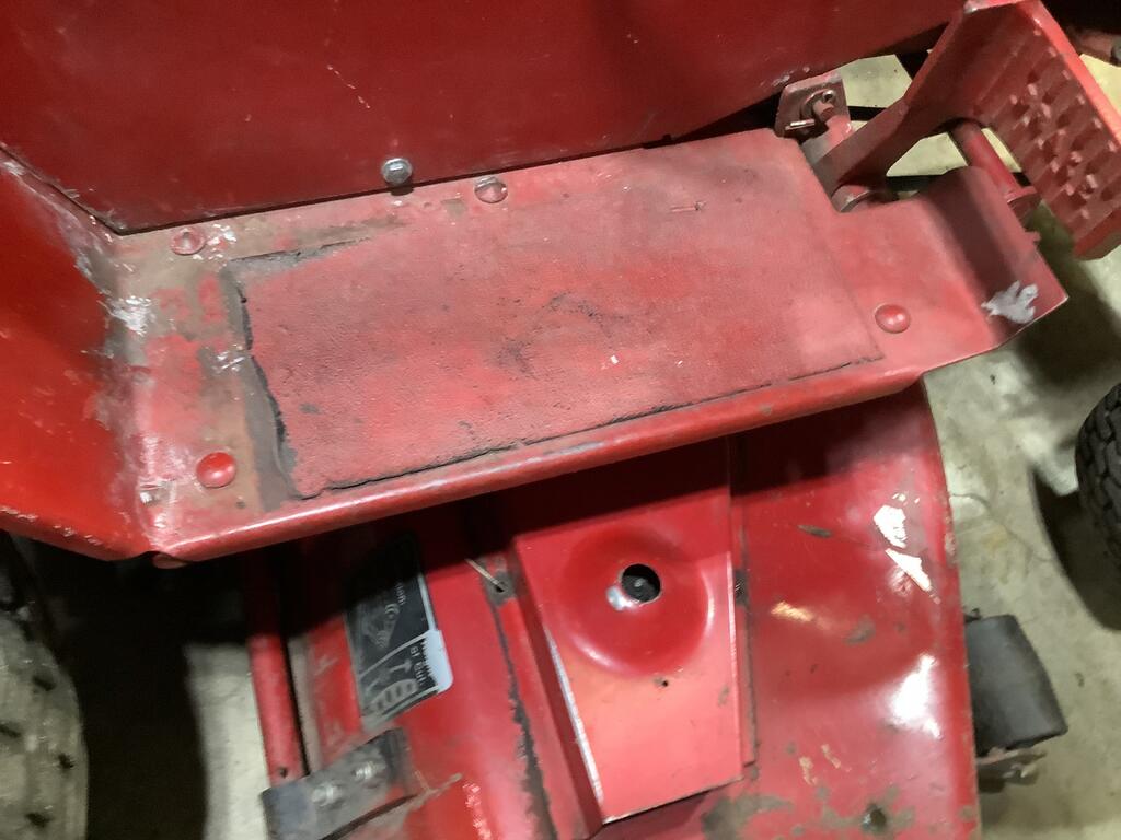

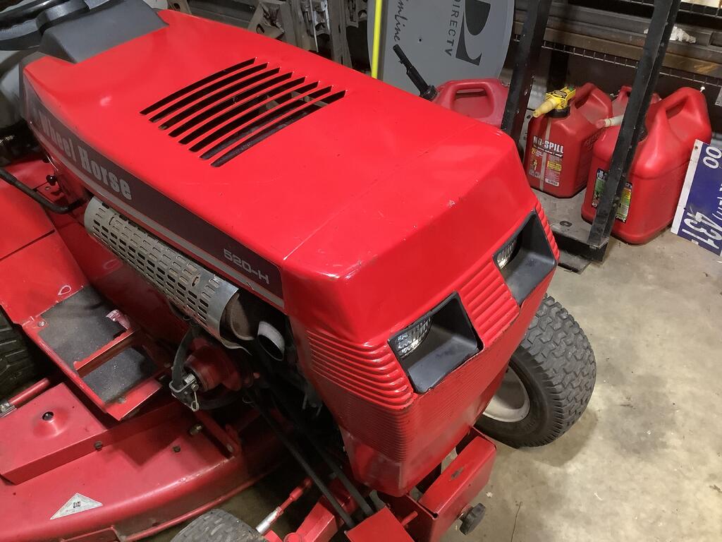

CRF857 1,401 #26573 Posted August 13 (edited) The safety tread on the C141 was worn and peeling. Heat gun and scraper made short work of removing them. I had more on the shelf. Used four smaller pieces rather than cutting into a large one. Good result for a little effort. Started to quit for the day, but Edy was mopping the utility room and kitchen floors. So I was marooned to the shop for a little while longer. Tried putting a shine on the hoods of the 520H and the C141. I will work on the rest of the tins a little at a time. The mower decks will get spiffed up this winter. Edited August 13 by CRF857 3 5 Share this post Link to post Share on other sites

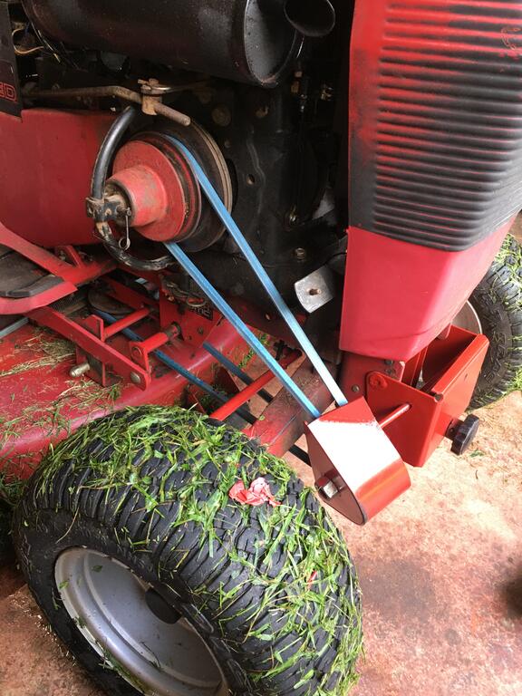

sqrlgtr 4,192 #26575 Posted August 13 Put my newly rebuilt mule drive and new belt on the 312-8 today. This drive and belt was destined for the 520H but the 312’s belt was wore out so just swapped both out while I was at it. Notice I bent gaurd on mule drive the belt was rubbing bad for some reason but it ain’t rubbing now . Have no idea what this mule drive came off of but didnt think there was any difference in any of them besides the ones for the 60” 520 decks. 2 2 Share this post Link to post Share on other sites
