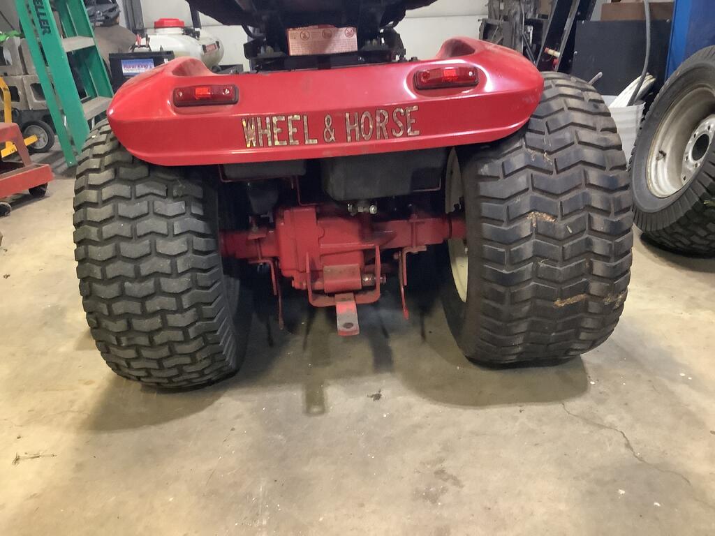

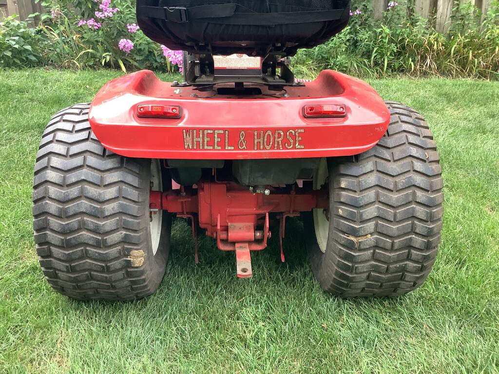

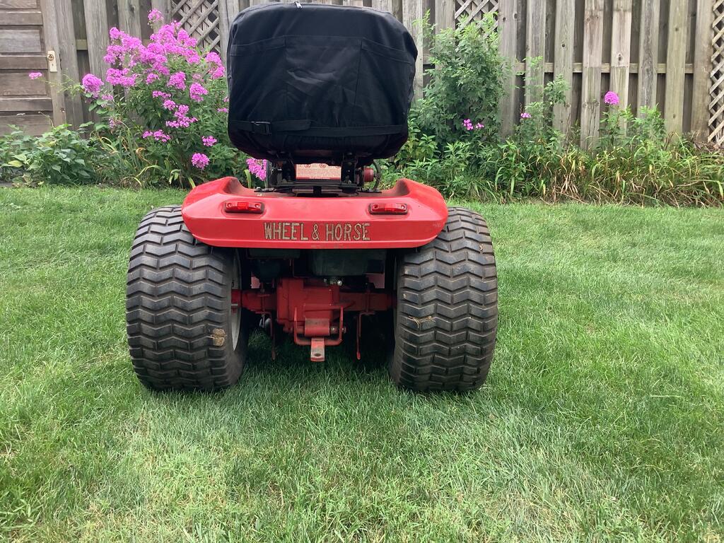

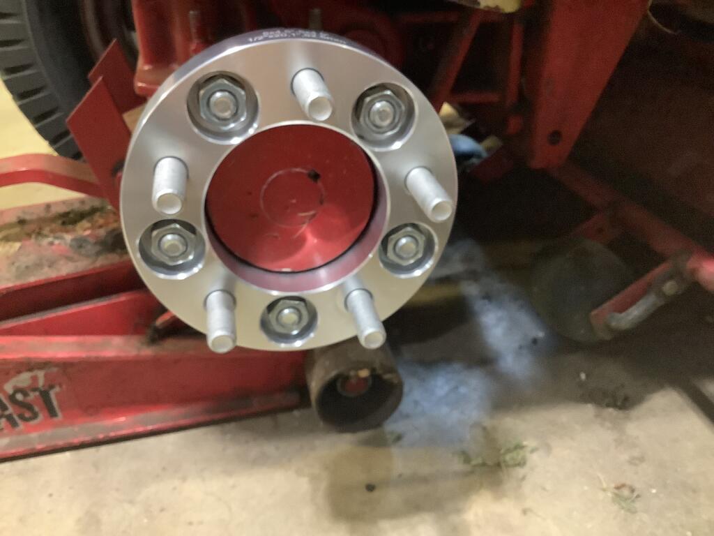

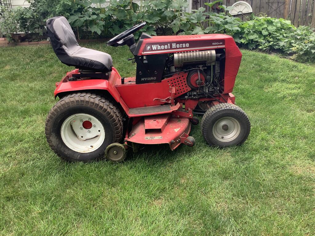

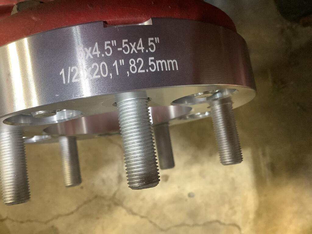

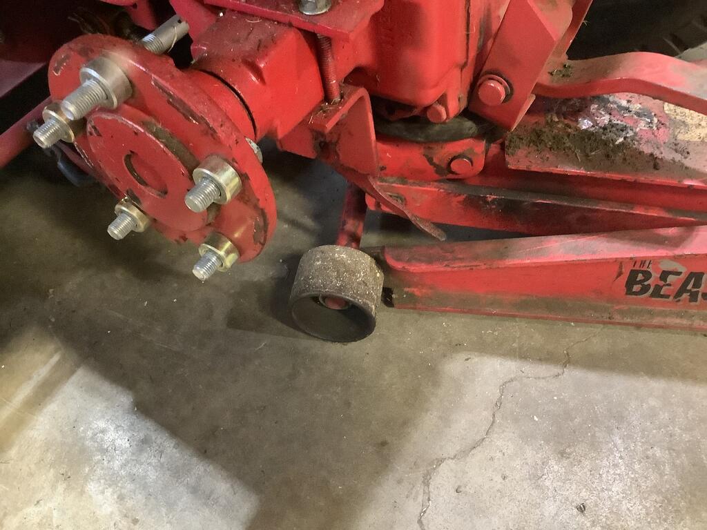

CRF857 1,401 #26529 Posted August 5 (edited) Swapped out tires/rims on the 520. Don’t know why but the original deep offset rims were not on this unit. The previous owner had spacers between the rims and hubs. I replaced the Sears 23x10.50-12 tires/rims with a set of 24x12-12 tires/rims. Also Sears, don’t recall how I got them. Since these rims were not offset enough I installed a 1” spacer on each hub. The tires just barely cleared the mower deck enough to install without removing the deck first. picture #4 is with one of each size. If I push snow with this tractor tis winterI may have to swap back in order to install a set of chains. Edited August 5 by CRF857 10 Share this post Link to post Share on other sites
sqrlgtr 4,192 #26530 Posted August 5 40 minutes ago, CRF857 said: Don’t know why but the original deep offset rims were not on this unit Ive come to the conclusion that not all 520's had the wider rims must be a year model thing. Just curious did you have to drill rims for the 1/2" lug studs? 1 Share this post Link to post Share on other sites
lynnmor 9,073 #26531 Posted August 5 5 minutes ago, sqrlgtr said: Ive come to the conclusion that not all 520's had the wider rims must be a year model thing. Just curious did you have to drill rims for the 1/2" lug studs? I bought a pair of tires and wheels that supposedly were on a 520, the tires were the correct size, brand and tread, but the offset was too little. I too wonder if there were differences early on, perhaps I need to download some of the early owners manuals. 2 Share this post Link to post Share on other sites

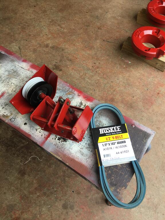

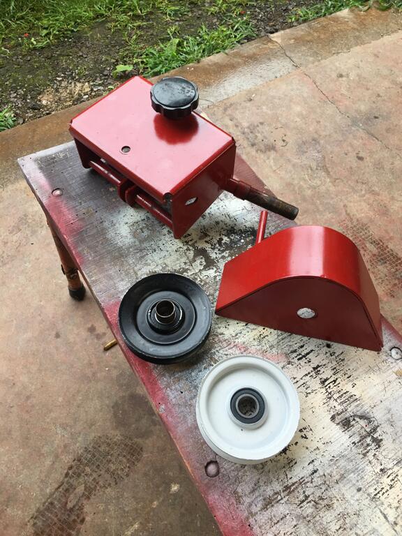

sqrlgtr 4,192 #26532 Posted August 5 Rebuilt the mule drive for the 520H today. Lirrle paint, 2 new pulleys and new belt ready to be put back in use. 3 8 Share this post Link to post Share on other sites
CRF857 1,401 #26533 Posted August 5 39 minutes ago, sqrlgtr said: Ive come to the conclusion that not all 520's had the wider rims must be a year model thing. Just curious did you have to drill rims for the 1/2" lug studs? This one needs the deep offset rims. And , yes I did drill the rims. 7/16ths to 1/2 didn’t take much effort. 4 Share this post Link to post Share on other sites
Lee1977 7,810 #26534 Posted August 7 On 8/5/2026 at 6:10 PM, sqrlgtr said: Ive come to the conclusion that not all 520's had the wider rims must be a year model thing. Just curious did you have to drill rims for the 1/2" lug studs? The 1988 and 1989 520 H came with 7" wide wheels and 23 x 950 x 12 tires. Stright front axle with 3/4" spindles 16 x 650 x 8 tires. 4 Share this post Link to post Share on other sites

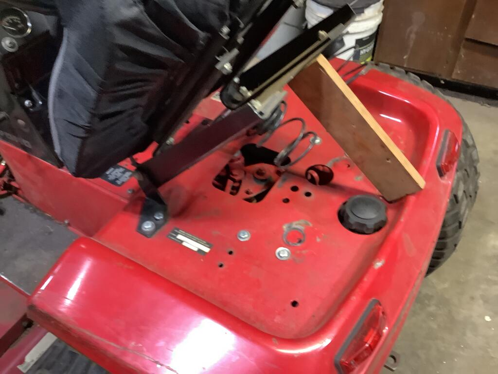

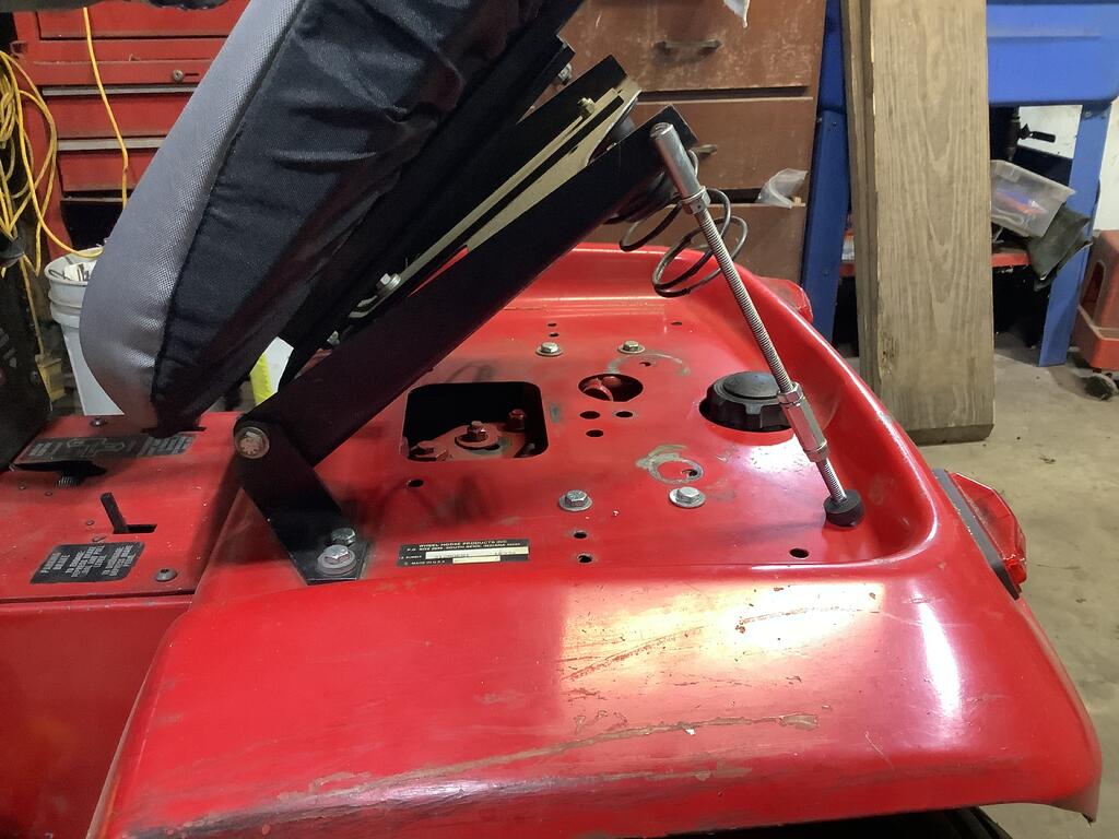

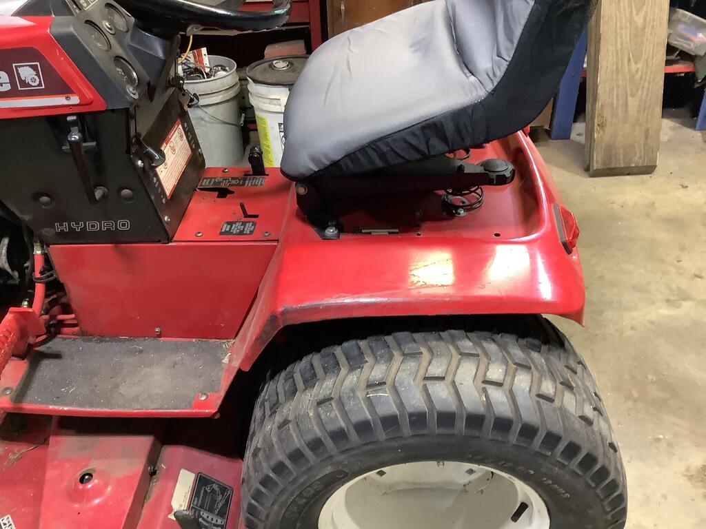

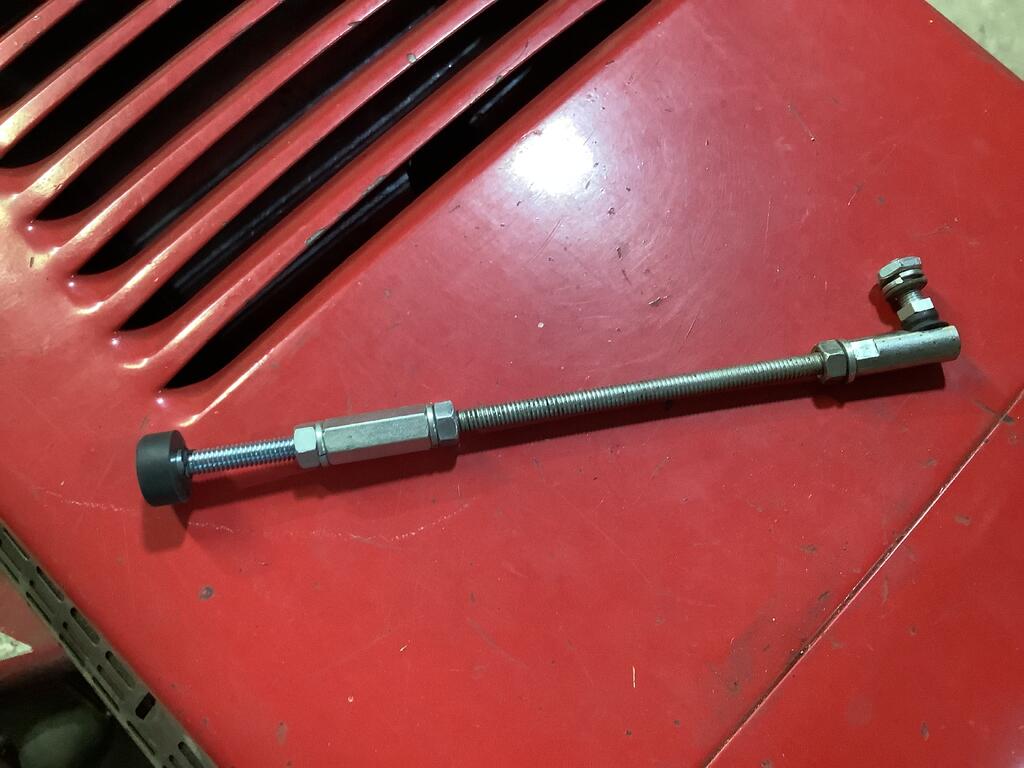

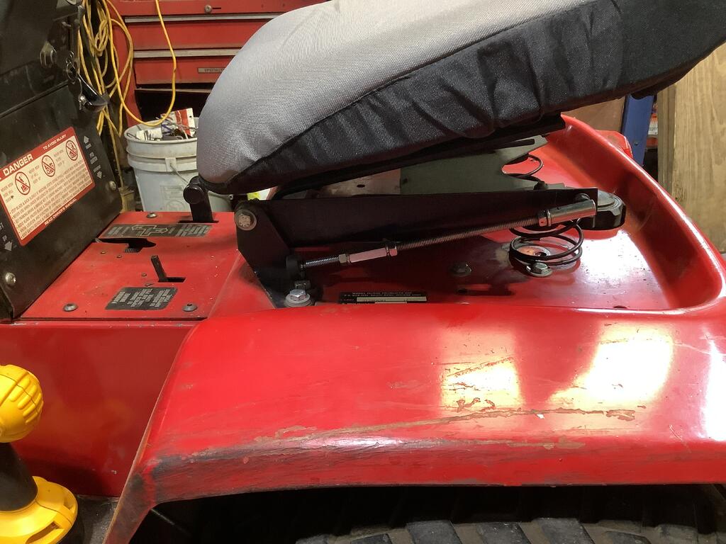

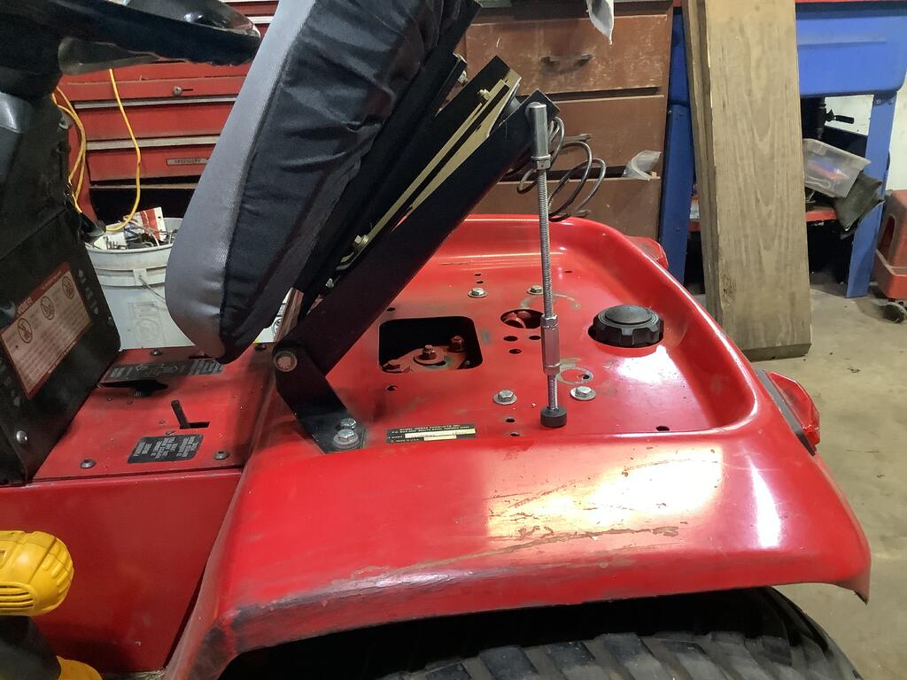

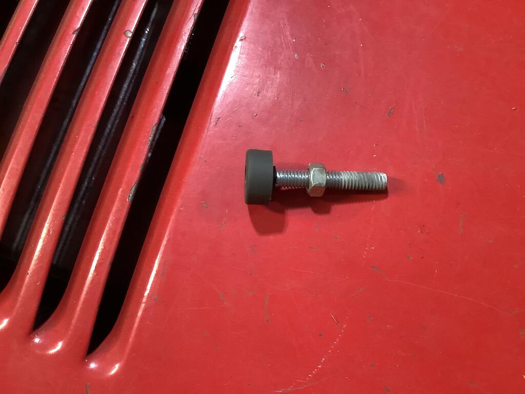

CRF857 1,401 #26536 Posted August 8 On my 520 the gas cap and hydro dipstick are underneath the seat. The seat doesn’t flop forward enough to stay up. Got tired of finding something to prop it with. I already have some rubber stops with 5/16s thread. After scrounging around a little I found a short piece of 5/16s all-thread, a matching rod end, and coupling nut. After drilling a hole I bolted on the assembly. Raise the seat and it falls into a vertical position, or push it to the back where it won’t move. Flip it forward when lowering the seat and it rests next to the seat bracket. Much better. 6 8 Share this post Link to post Share on other sites
Handy Don 17,689 #26537 Posted August 8 4 minutes ago, CRF857 said: Much better. Clearly a clever solution to a serious annoyance. Still, I’m wondering what happened to the gas shock and bracket that would normally hold the raised seat? Share this post Link to post Share on other sites
CRF857 1,401 #26538 Posted August 8 3 hours ago, Handy Don said: Still, I’m wondering what happened to the gas shock and bracket that would normally hold the raised seat? That would make two of us!🤨 Share this post Link to post Share on other sites

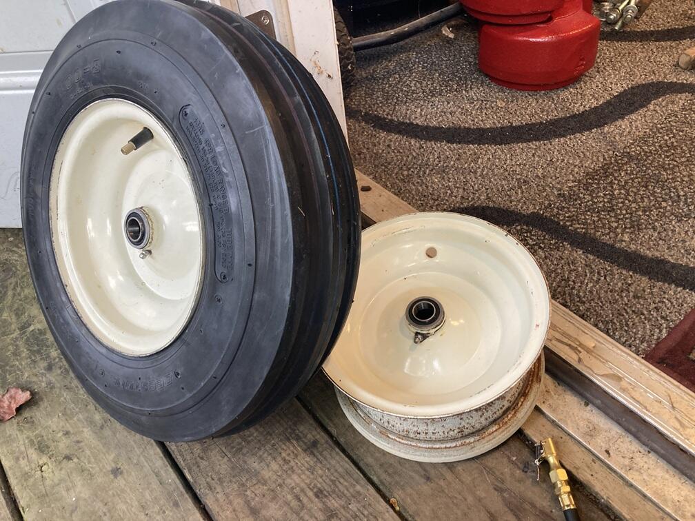

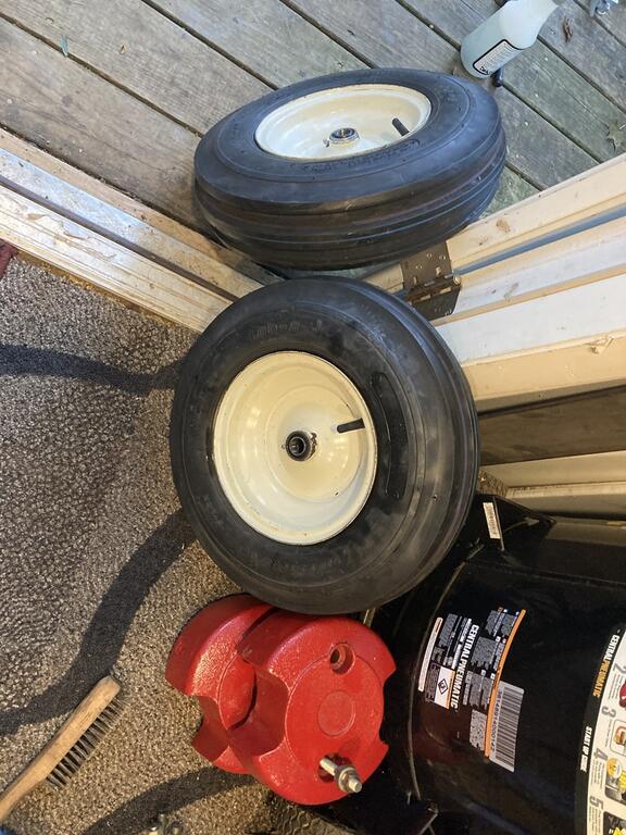

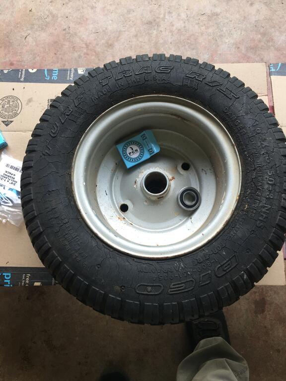

ineedanother 2,885 #26539 Posted August 8 Haven't done it yet but these might go on the 161 with the FEL to improve the strain on steering components. Crappy, dirty looking rims with wheelbarrow tires came on an off-brand cart I acquired somehow. Bushings and zerk fittings and when I stripped the junk tires and knocked the bushings out, they were really nice looking 4" x 8 rims with potential. Hit them with some degreaser and ordered some decent bearings and a pair of 4 ply Deestone tri-ribs. 6 2 Share this post Link to post Share on other sites

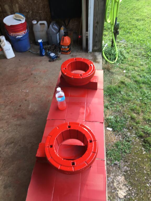

sqrlgtr 4,192 #26540 Posted August 9 Replaced front wheel bearings on last 312-8 I acquired and sprayed some Regal Red on a set of WH rear weights, that are allocated for a 520H. 4 1 Share this post Link to post Share on other sites

lynnmor 9,073 #26542 Posted August 9 6 hours ago, Handy Don said: Clearly a clever solution to a serious annoyance. Still, I’m wondering what happened to the gas shock and bracket that would normally hold the raised seat? The early models had no gas spring, the geometry was such that the seat would lay on the steering wheel. Modified springs, adjustment tracks and aftermarket seats cause a problem. 2 1 Share this post Link to post Share on other sites

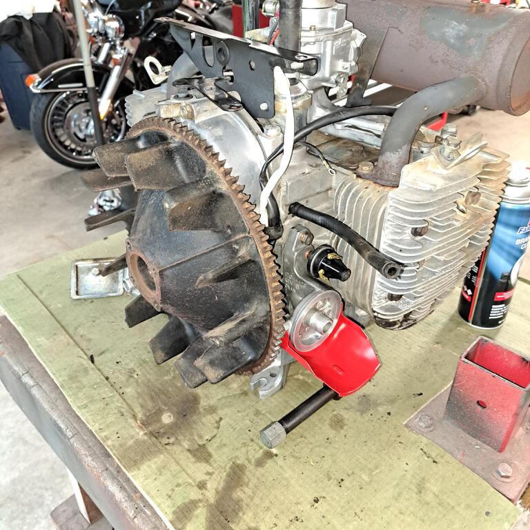

WHX?? 58,347 #26543 Posted August 9 Tied into a Onan I got from @Blasterdad at @Pullstart plow day. Someone started taking it all apart and don't know why. He said it ran when parked and debating whether or not to pop the heads and check things out. Seems to have good compression. Hear tell new head gaskets are junk tho. Cleaned up nice & maybe give the flywheel some red bling. 5 2 Share this post Link to post Share on other sites
Sodaking27 1,411 #26544 Posted August 9 Painted the footrests and side panels. Now it’s got me to thinking I need to paint the hood and fender pan. 2 5 Share this post Link to post Share on other sites
sqrlgtr 4,192 #26545 Posted August 9 1 hour ago, WHX?? said: Tied into a Onan I got from @Blasterdad at @Pullstart plow day. Someone started taking it all apart and don't know why. He said it ran when parked and debating whether or not to pop the heads and check things out. Seems to have good compression. Hear tell new head gaskets are junk tho. Cleaned up nice & maybe give the flywheel some red bling. I would most defiantly reseal manifold, carb kit, and decarb while I had it on workbench may save a lot of headaches later on. 2 Share this post Link to post Share on other sites
lynnmor 9,073 #26546 Posted August 9 1 hour ago, WHX?? said: Tied into a Onan I got from @Blasterdad at @Pullstart plow day. Someone started taking it all apart and don't know why. He said it ran when parked and debating whether or not to pop the heads and check things out. Seems to have good compression. Hear tell new head gaskets are junk tho. Cleaned up nice & maybe give the flywheel some red bling. You are to de-carbon the heads regularly so it isn't a waste of time to pull the heads. You can have OK compression with a loose valve seat, so check carefully when the heads are off. Adjust the valves, clean the carb, check the intake manifold and paint the exhaust. Use only genuine Onan gaskets for the intake, valve covers and heads, others may fail 1 1 Share this post Link to post Share on other sites
sqrlgtr 4,192 #26547 Posted August 9 (edited) 1 hour ago, lynnmor said: Adjust the valves, This, I knew I was forgetting sumin. The valves were all tight on mine. Edited August 9 by sqrlgtr Share this post Link to post Share on other sites
peter lena 10,114 #26548 Posted August 9 @CRF857 like the bolt on stud hubs , noting your rear seat under spring , have regularly enhanced mine to this type of bolt on compression spring , also added , stiff vibration pad strips under seat frame rails , for more height , more to my liking . all my paints are lubrication soaked , staged , recovery . where did you get the bolt on stud hubs ? thanks , pete Share this post Link to post Share on other sites

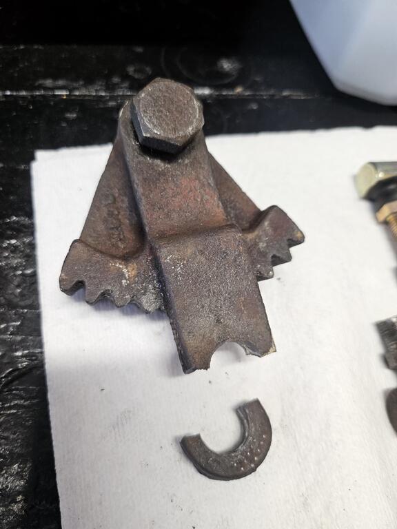

ML3 2,557 #26549 Posted August 9 Lost steering on Suburban rat rod. Guess this is why...... Ugh! #3607 steering sector 7 Share this post Link to post Share on other sites

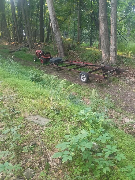

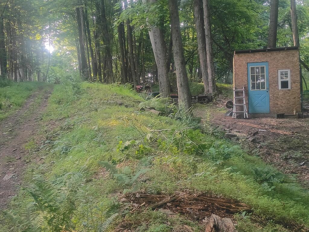

C100guy94 127 #26550 Posted August 9 (edited) Moved my old camper trailer to the back of the property today. Leveling an area for it now Will be the new goat pen. Trailers been sitting around for 2 years since I tore the 30 foot camper shell off it. Old lady wants a goat so figure this is a hell of a good base to level with some 8 inch block and build off of. Let me know what y'all think! She wheelied up on me 3 times climbing this hill. Now I'm pondering some weight bracket of some sorts for the front Maybe that brand new weight set I had to have an have used 4 times will be a victim for this project. Edited August 9 by C100guy94 5 Share this post Link to post Share on other sites
