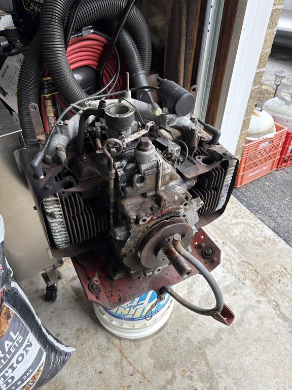

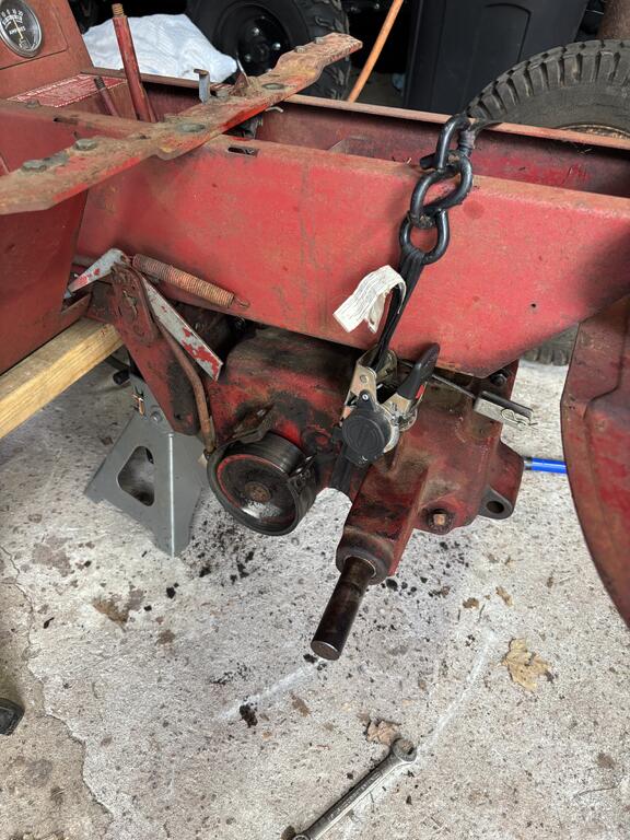

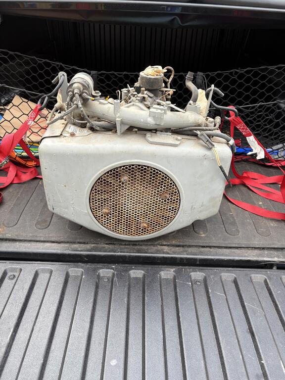

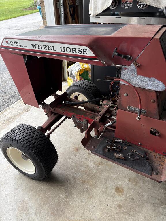

Sodaking27 1,348 #25829 Posted April 28 (edited) Finally got some time to start the engine swap on the C175. Next up is a good pressure wash before starting the install. Need to find a 5.25” (hydro) pulley. I broke a chunk out trying to get it off. Edited April 28 by Sodaking27 4 3 Share this post Link to post Share on other sites
ebinmaine 80,600 #25830 Posted April 28 40 minutes ago, Sodaking27 said: Need to find a 5 1/2” pulley. Check with @76c12091520h Brian Badman Share this post Link to post Share on other sites

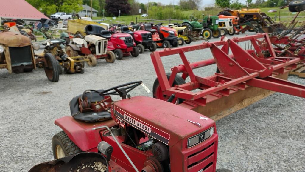

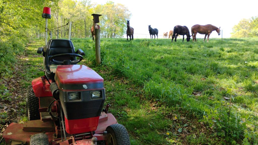

Ed Kennell 47,255 #25831 Posted April 28 Got some fence lines mowed before the rain starts. Checked out tomorrows auction. An interesting boat. And a Commando 800 11 1 Share this post Link to post Share on other sites
squonk 48,063 #25832 Posted April 28 30 minutes ago, Ed Kennell said: . Checked out tomorrows auction. An interesting boat. That would look good in @Pullstart's pool! 1 9 Share this post Link to post Share on other sites

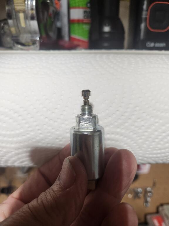

CasaytheMann 265 #25834 Posted April 29 (edited) Decided to try to locate a fuel leak in the carburetor area. I ended up finding that the fuel solenoid rod head (don't know the real name) was slightly bent and not sealing 100%. I'm posting a picture but the bend might not be enough to see in it. I installed a new solenoid and associated wire harness, because the original connector was too loose. The new solenoid has a rubber covering over the head. Edited April 29 by CasaytheMann 7 Share this post Link to post Share on other sites
Pullstart 71,207 #25835 Posted April 29 @CasaytheMann nice work! Make sure to use no ethanol fuel with that rubber snubber, ethanol tends to wreak havoc on rubber components 2 1 Share this post Link to post Share on other sites
CasaytheMann 265 #25836 Posted April 29 I thought all gas has ethanol. Share this post Link to post Share on other sites
ebinmaine 80,600 #25837 Posted April 29 4 minutes ago, CasaytheMann said: I thought all gas has ethanol. Depends where you live. Here in Maine non ethanol fuel is readily available. CT, not so much. Avoid ethanol if at all possible. Search here: Pure-gas.org Share this post Link to post Share on other sites
19richie66 17,932 #25838 Posted April 29 23 hours ago, Sodaking27 said: Need to find a 5.25” (hydro) pulley. I broke a chunk out trying to get it off. I may have one. Have to check. Message later to remind me. Yours for shipping cost 5 Share this post Link to post Share on other sites
Sodaking27 1,348 #25839 Posted April 29 4 minutes ago, 19richie66 said: I may have one. Have to check. Message later to remind me. Yours for shipping cost I’ll be sure to send you a message. Thanks.. 1 Share this post Link to post Share on other sites
Handy Don 17,461 #25840 Posted April 29 2 hours ago, ebinmaine said: Depends where you live. Here in Maine non ethanol fuel is readily available. CT, not so much. Non-ethanol seems to be more available in areas that have lots of agricultural equipment, boating, and general aviation customers. Metropolitan areas, rarely. Where it is available, it’s frequently 91 Octane and priced at or a bit below super premium. Often it is a separate hose or even a separate pump. In some upstate NY stations, I’ve seen the pump have its own island! When storing non-ethanol gas be sure to keep the container very tightly sealed. Since “pure gas” has no alcohol to bind with moisture, any water that enters the container (condensation, for example) remains separate--possibly causing rust or being transferred to your tractor when refueling. 2 Share this post Link to post Share on other sites
CasaytheMann 265 #25841 Posted April 29 (edited) No non-ethanol stations anywhere near me, unfortunately. I just looked at the Owner's Manual. It says unleaded gas with less than 10% ethanol is ok. Edited April 29 by CasaytheMann Share this post Link to post Share on other sites

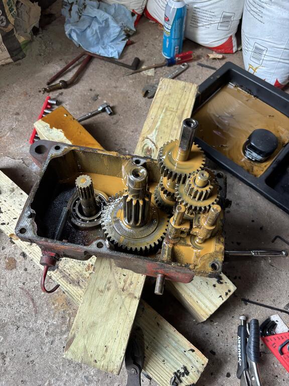

Chris689 323 #25842 Posted April 29 (edited) Finally got to split the trans for the 10-8 today. Sure did have some water in it. Got it cleaned up, replaced all the seals and reassembled. Got it back installed but now needs some new woodruff keys for the axles and drive pulley. In theory it’ll be back up and moving under its own power Monday. Edited April 29 by Chris689 5 5 Share this post Link to post Share on other sites
ebinmaine 80,600 #25843 Posted April 29 40 minutes ago, CasaytheMann said: Owner's Manual. It says unleaded gas with less than 10% ethanol is ok. They HAD to write that .... Reality is a little different. Just be sure to carefully check ALL rubber fuel components. Replace all the lines. Rebuild the carb. Rebuild the fuel pump. Carefully clean out the tank. A little work now saves multitudes of headaches later. 3 2 Share this post Link to post Share on other sites

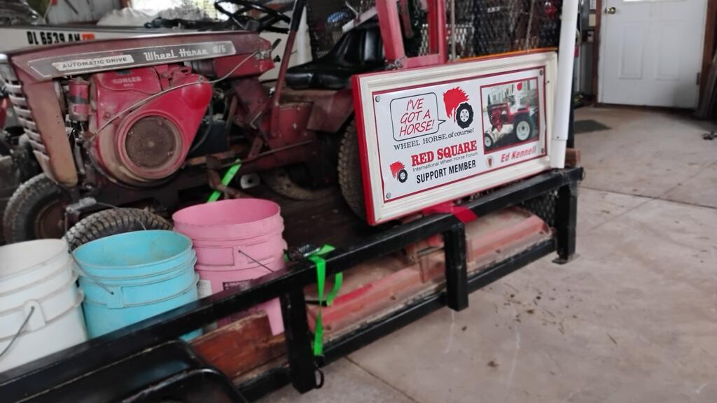

Ed Kennell 47,255 #25846 Posted April 30 Loaded the 1076, plow, and deck for the Steam-o-Rama show tomorrow. Hopefully this rain will stop tomorrow. 8 1 Share this post Link to post Share on other sites
CasaytheMann 265 #25847 Posted April 30 (edited) Per your questions and input I've done some more research. I used different terminology in my web search. There is a gas station 10 minutes away that sells ethanol free gas. I'll drive by soon and verify it. Because of what you all said about the damage to rubber I disassembled the carburetor. I found 2 o-rings that were in bad shape. I'm sure that had something to do with the carb leaking gas. I did put Stabil 360 in my last purchase of gas. Supposedly it deals with ethanol, although it doesn't specify how. I ordered a rebuild kit for the carb, and I'm installing new fuel line and fuel filter. I will also clean the fuel tank because it's currently empty. Ebinmaine mentioned a fuel pump too, but I don't think my B & S 15.5hp engine has one. Fuel goes from the tank right to the carb. Thanks for helping this "frowned upon" vertical out.😉 Edited April 30 by CasaytheMann 1 3 Share this post Link to post Share on other sites
ebinmaine 80,600 #25848 Posted April 30 4 hours ago, CasaytheMann said: Stabil 360 in my last purchase of gas. Supposedly it deals with ethanol, although it doesn't specify how A#1 note here. I'm not a scientist. That said, to the best of my knowledge, no off the shelf chemical does anything to cancel the negative effects of ethanol on rubber. 8 hours ago, lynnmor said: Knock on wood but I haven't had an ethanol related problem for about 20 years despite using E10 in everything but the 2 cycle equipment. You've done exceedingly well. I've had first hand personal experience with at least a dozen machines that were affected by ethanol over the years. Dried up carb components. Fuel lines aged prematurely. Carbs and pumps leaking. We've seen ethanol destroy (someone else's supplied) cheap rubber fuel line in just one mowing season. Disgusting stuff and it has no place in an engine. Period. 3 Share this post Link to post Share on other sites
