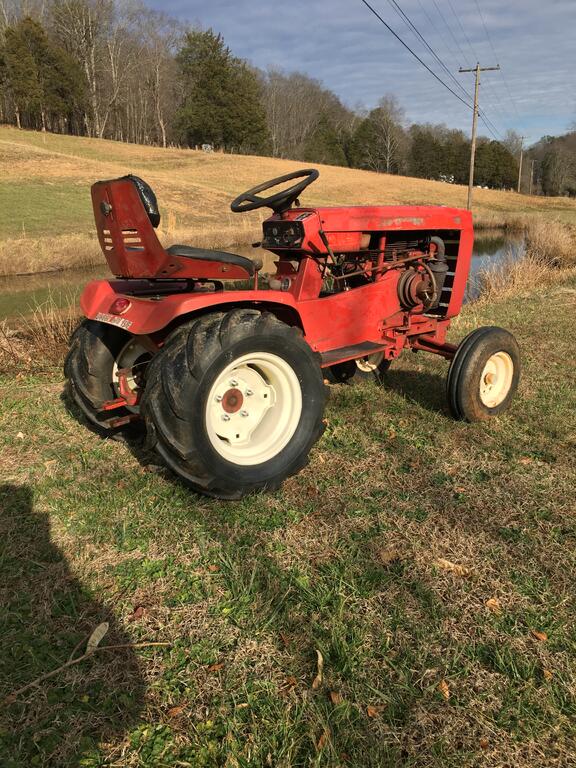

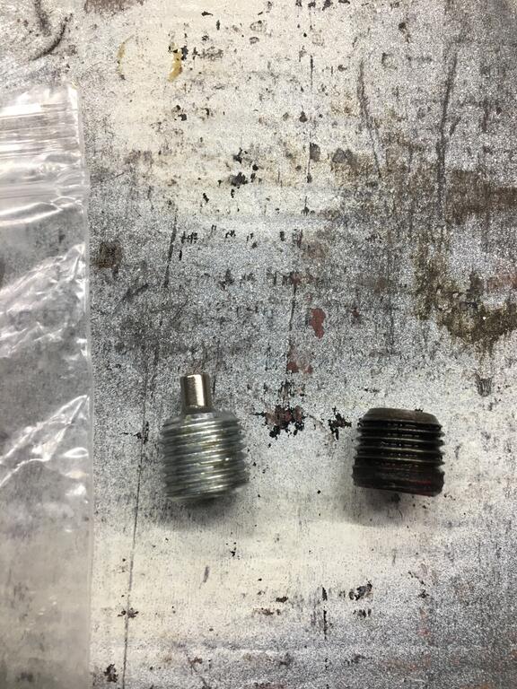

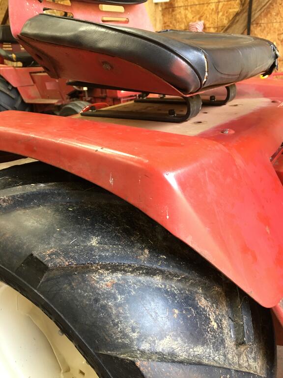

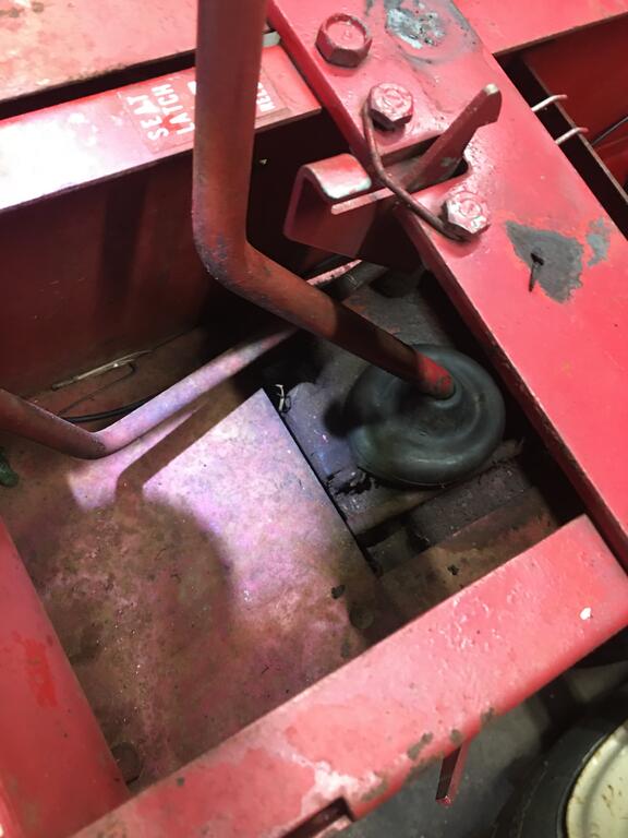

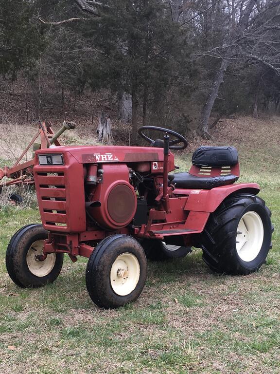

sqrlgtr 3,860 #25254 Posted January 6 (edited) Finished transaxle drain and refill on the 12hp-8 No Name today. New shifter boot, magnetic drain plug and swapped the 8.50’s for some 10.50’s on back. Oh yeah installed bolts/studs on back wheels. Made mounting the loaded Carlisle alot easier. Edited January 6 by sqrlgtr 3 10 1 Share this post Link to post Share on other sites

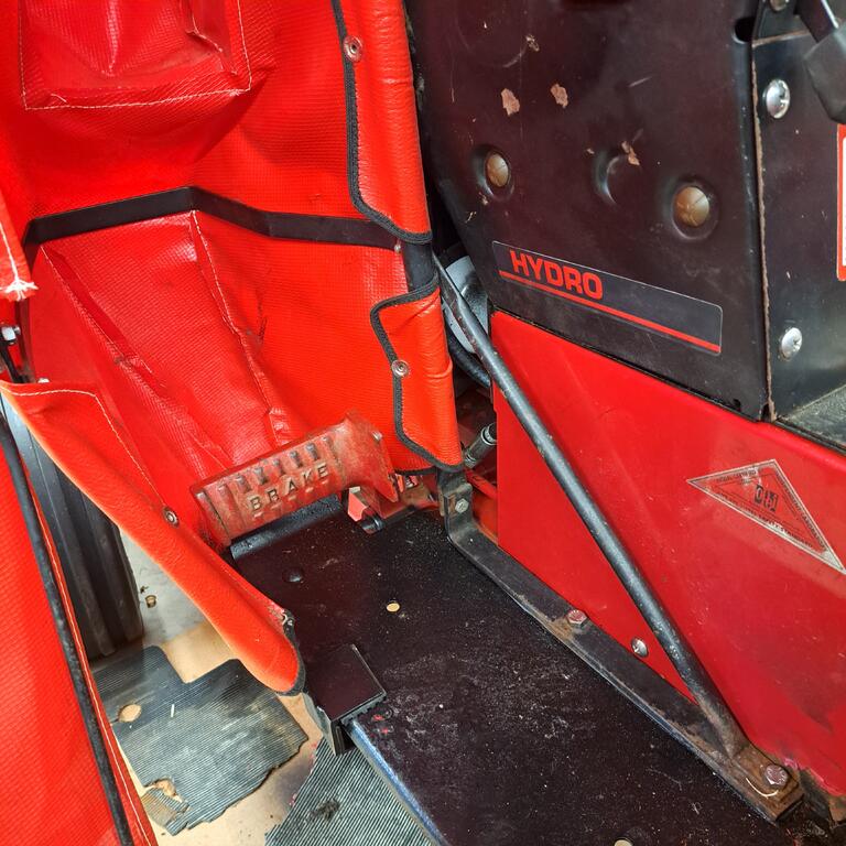

OoPEZoO 609 #25259 Posted January 8 Man, I really wish my 314 was an auto with a hydro lift. That makes plowing look so much easier. Not that its hard, and my tractor does great as is, but wow that's MUCH more efficient than all the monkeying I have to do with my levers to get my driveway done. I suppose one of these days I'll have to bring home a dedicated plow tractor.......or maybe a good roller that I can swap all my guts and mods over onto. 1 3 Share this post Link to post Share on other sites

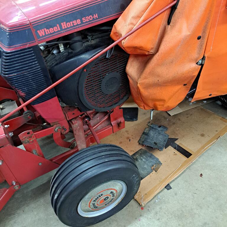

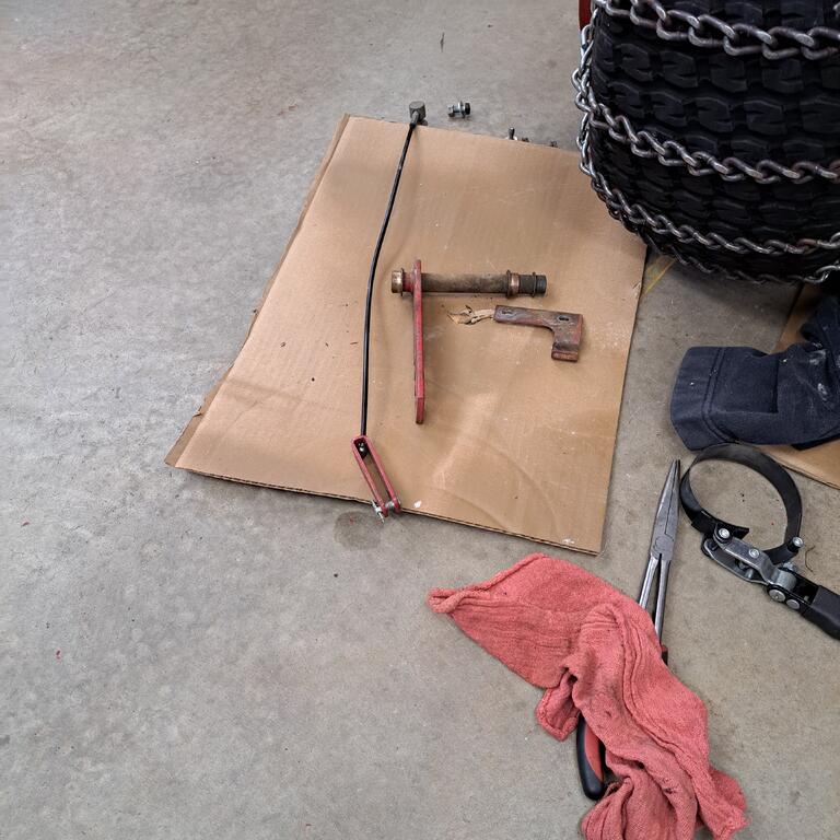

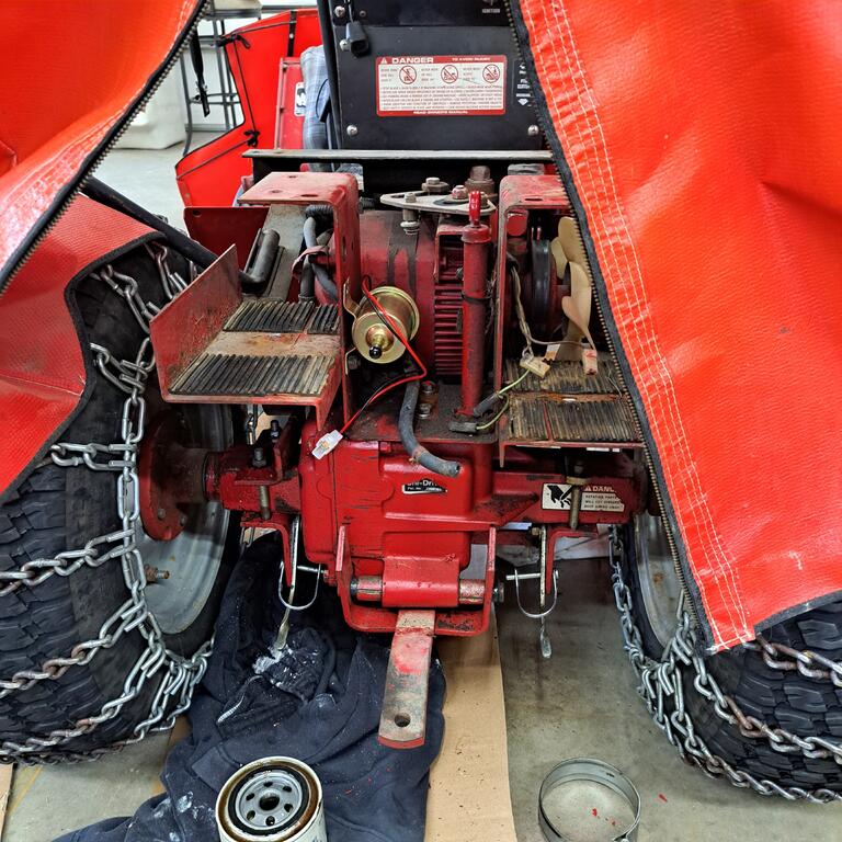

WHX?? 58,052 #25260 Posted January 8 Put a electric fuel pump on a 520. Only real place to put it near the tank. Had to remove the rear rockshaft which will probably go in classifieds since I have a dedicated tiller tractor. Anybody have a tip for getting the cable tube out? 3 3 Share this post Link to post Share on other sites

Ed Kennell 47,254 #25262 Posted January 8 43 minutes ago, OoPEZoO said: Man, I really wish my 314 was an auto with a hydro lift. That makes plowing look so much easier. Not that its hard, and my tractor does great as is, but wow that's MUCH more efficient than all the monkeying I have to do with my levers to get my driveway done. I suppose one of these days I'll have to bring home a dedicated plow tractor.......or maybe a good roller that I can swap all my guts and mods over onto. Hydro tranny with foot pedal motion control and hydraulic lift...only way to plow when you have 5 driveways to clear. My 312 H at work last year .312H snow plowing - Wheel Horse Tractors - RedSquare Wheel Horse Forum 3 4 Share this post Link to post Share on other sites

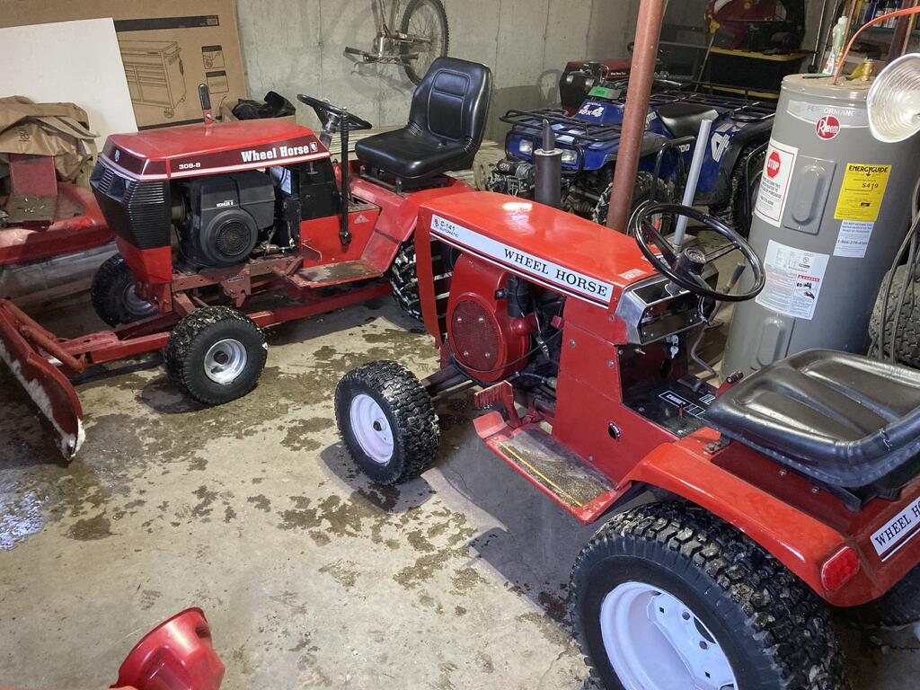

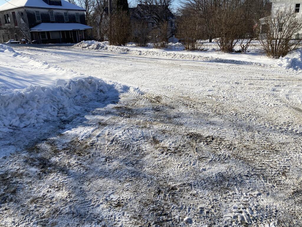

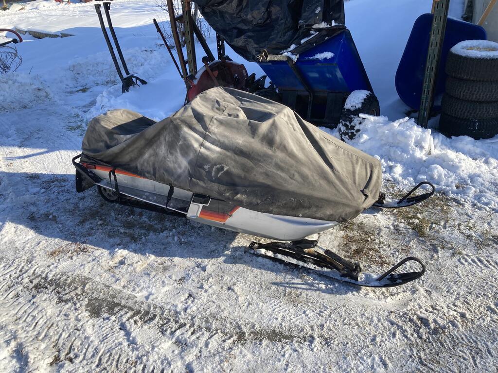

MainelyWheelhorse 3,129 #25263 Posted January 8 Today I plowed off what my nephew didn't get last night off my driveway with the 308. While I was at it took out the C-141 for a ride and got it mildly stuck on slush/ice. I also figured I'd stretch the legs on my ATV as well and in the process of plowing moved my Snowmobile to plow around it. Then took that for a spin. 8 Share this post Link to post Share on other sites

lynnmor 9,037 #25266 Posted January 9 9 hours ago, WHX?? said: Put a electric fuel pump on a 520. Only real place to put it near the tank. Had to remove the rear rockshaft which will probably go in classifieds since I have a dedicated tiller tractor. Anybody have a tip for getting the cable tube out? Pliers and some colorful language should get the tube out after the clamp is removed. What kind of monster fuel pump did you put on there? 4 1 Share this post Link to post Share on other sites
Handy Don 17,460 #25267 Posted January 9 28 minutes ago, lynnmor said: Pliers and some colorful language should get the tube out after the clamp is removed. What kind of monster fuel pump did you put on there? The only “attachments” are the clamp and a press fit where the tube fits into a hole in the transaxle flange above the F plate. 4 Share this post Link to post Share on other sites
WHX?? 58,052 #25268 Posted January 9 (edited) 14 hours ago, lynnmor said: Pliers and some colorful language should get the tube out after the clamp is removed. I tried that and damn near bent the tube. It's wedged in there tight and wondered if there was another clamp in there but I don't think so. I know they can be easily installed if you buy the kit from Parts N More. 14 hours ago, lynnmor said: monster fuel pump did you put on there? A real cheapy that @Achto posted a link to but yes somewhat bulky. I have used them before with good luck. Mounted such that replacement would be easy. 520 with the FEL is next and will spring for a better one for that. Just tired of all that cranking if they sit for a bit and check valves just don't work. Electric ones do. Edited January 9 by WHX?? 6 Share this post Link to post Share on other sites
lynnmor 9,037 #25269 Posted January 9 (edited) 1 hour ago, WHX?? said: I tried that and damn near bent the tube. It's wedged in there tight and wondered if there was another clamp in there but I don't think so. I know they can be easily installed if you buy the kit from Parts N More. A real cheapy that @Achto posted a link to but yes somewhat bulky. I have used them before with good luck. Mounted such that replacement would be easy. 520 with the FEL is next and will spring for a better one for that. Just tired of all that cranking if they sit for a bit and check valves just don't work. This does. Where the tube goes into the F plate can be very tight, I had one that just wouldn't go in and drilling was impossible since the metal was so hard. You might try going under and hammer it out using a punch but that might destroy it. Of course penetrating oil could help. I know that some use those cheapy pumps, I had no idea that they were so large. I haven't found a reasonable place to locate electric pumps on a 520H since I want the rear lift, perhaps the Facet square pumps are the best option. Did you ever notice that when you stop cranking, then wait a few seconds, it will start as soon as you hit the key again? All four of mine act that way, I don't know if the spark weakens or the fuel continues to flow for a bit after cranking. I use full choke and half throttle for a cold start, then push the choke off as soon as it starts, sometimes it needs a quick jab of choke if it starts to die. Edited January 9 by lynnmor 4 1 Share this post Link to post Share on other sites

WHX?? 58,052 #25271 Posted January 9 (edited) 6 hours ago, lynnmor said: haven't found a reasonable place to locate electric pumps on a 520H since I want the rear lift, With rear lift real difficult especially if one goes by the gospel they work best closest to the tank. I even looked for one that mount inside the left side cover but only a inch there. 4 hours ago, Handy Don said: marine-grade squeeze bulb has been working for us for priming. No real room for that with a cab on unless it goes inside the cab somehow. I guess there would be room inside for it. Edited January 9 by WHX?? 2 1 Share this post Link to post Share on other sites
lynnmor 9,037 #25272 Posted January 9 36 minutes ago, WHX?? said: With rear lift real difficult especially if one goes by the gospel they work best closest to the tank. I even looked for one that mount inside the left side cover but only a inch there. No real room for that with a cab on unless it goes inside the cab somehow. I guess there would be room inside for it. I have the same cab and snowblower, a squeeze bulb or an electric pump would be a pain. Of course I could eliminate the rear lift on that tractor but I hate to do that in case I need to change the duties of it. I did see on here that someone attached a squeeze bulb to the gas cap and pumped air in to push the gas, that may be my answer. 2 Share this post Link to post Share on other sites
Handy Don 17,460 #25273 Posted January 10 15 hours ago, lynnmor said: I have the same cab and snowblower, a squeeze bulb or an electric pump would be a pain. ... I did see on here that someone attached a squeeze bulb to the gas cap and pumped air in to push the gas, that may be my answer. Yep, cab is definitely in the way. Did you notice @ri702bill's technique of adding a pushrod to reach the squeeze bulb? 1 Share this post Link to post Share on other sites
WHX?? 58,052 #25274 Posted January 10 16 hours ago, lynnmor said: . I did see on here that someone attached a squeeze bulb to the gas cap and pumped air in to push the gas, That would have been @cleat which is a real good idea. Lay the bulb beside the seat, give it a couple of pumps and she starts right up Cleat ? 1 Share this post Link to post Share on other sites
cleat 9,324 #25275 Posted January 10 10 minutes ago, WHX?? said: That would have been @cleat which is a real good idea. Lay the bulb beside the seat, give it a couple of pumps and she starts right up Cleat ? Yes, just pump it a few times and you will see the fuel filter fill up then you can start the tractor. It should start quickly at this point. You can then remove it and install the regular fuel cap. And as a bonus, you only need one so long as all your tractors use the same fuel cap. 2 2 1 Share this post Link to post Share on other sites
