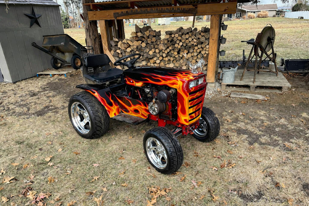

Bar Nuthin 3,545 #25226 Posted January 2 Decided ol' Johnny needed spruced up a bit, so I slapped a quick paint job on him. AI paint job, that is. 2 9 1 3 Share this post Link to post Share on other sites
ebinmaine 81,183 #25227 Posted January 2 33 minutes ago, Bar Nuthin said: Decided ol' Johnny needed spruced up a bit Some folks like flames on certain vehicles. Some don't. Me personal-like. It depends on the mo-chine. This'n... Yessir. I like it. IMHO those wheels need to be a solid dish like the old steelies or whatever. I do like the chrome wheels on a tractor. 1 Share this post Link to post Share on other sites
sqrlgtr 4,192 #25228 Posted January 2 @Bar Nuthin parking to close to wood pile not a good idea 6 Share this post Link to post Share on other sites

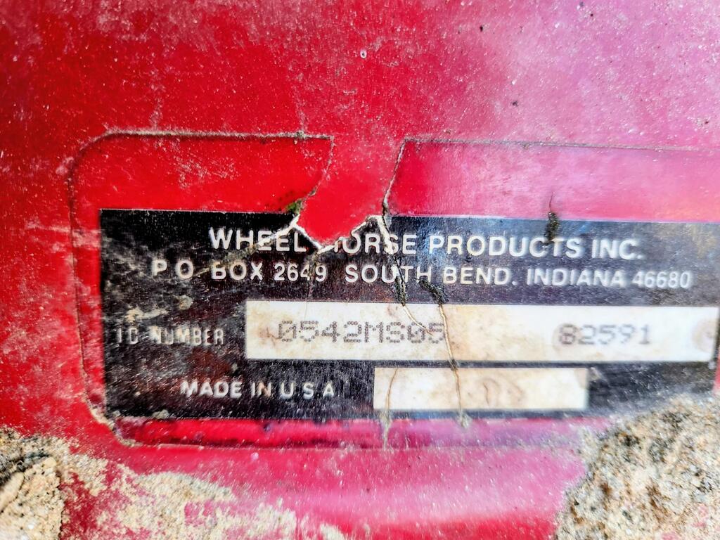

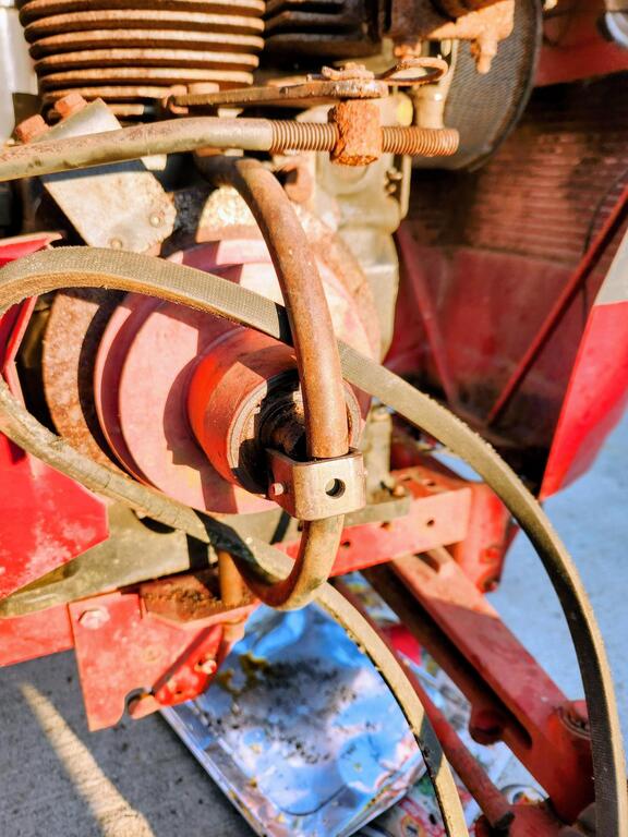

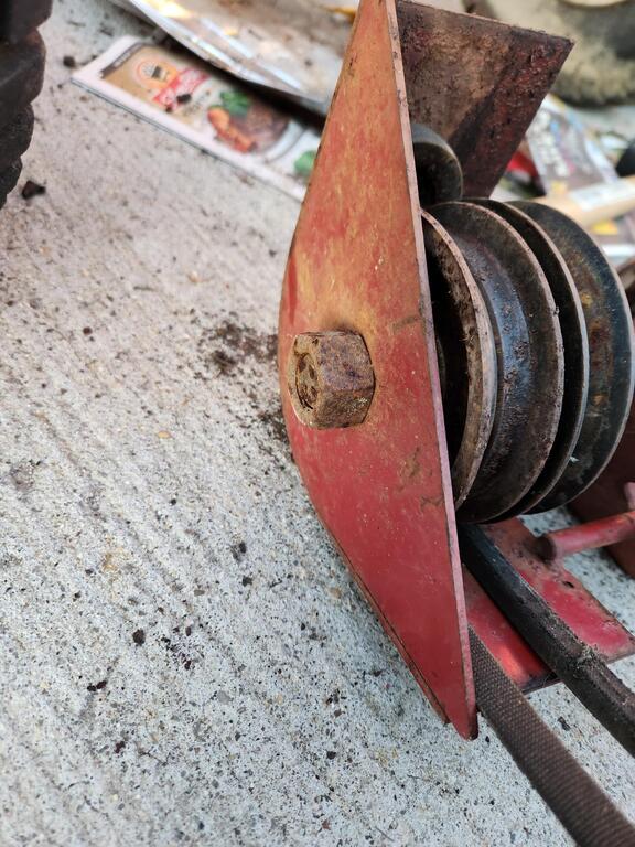

CD Long Jr 203 #25229 Posted January 2 Well let's see, I put up the WD40 & got PB Blaster. I aired the tires up to get her off the trailer. All the valve stems are on the inside. Is that normal or has someone rotate them for a wider stance? Only 1 has a 90-degree adapter on the valve stem. Rolled her off the trailer and applied the brakes. No brakes. thank God for 96-gallon trash cans or I might have ended up in the shed. Parking brake doesn't work, (lock), either. Removed deck & mule drive. Finaly figured out and unfroze the quick attach pins. I think she's sat a heck of a long time. Mule drive adjuster is frozen & the black knob just turns so I assume the roll pin the holds it in place is rotted. I had to remove the clips & pry the arms off the adjuster to get the belt loose. The bar on the PTO won't move front to rear or up & down enough to get the belt off. Do I remove the big nut on the mule to get the belt out? Busted the rubber cover on the dash side of the choke cable, but now it's easier to get PB down the cable to try to free it. Got all the deck pulleys and deck spindles to turn. I assume it's a 42-inch deck. Otherwise, everything' just peachy. 2 2 Share this post Link to post Share on other sites
peter lena 10,114 #25230 Posted January 2 @Bar Nuthin do you have to fire suit up , like top fuel , to run that ???? looks very good , pete 2 Share this post Link to post Share on other sites
Handy Don 17,689 #25231 Posted January 2 20 minutes ago, CD Long Jr said: Well let's see, I put up the WD40 & got PB Blaster. Liquid Wrench and Kroil are MUCH better All the valve stems are on the inside. Is that normal or has someone rotate them for a wider stance? Normal (valve stem likely changed at come point, maybe tubes) Rolled her off the trailer and applied the brakes. No brakes. Lots going on there 20 minutes ago, CD Long Jr said: There should be a removable pin securing the clevis on the outer bail to the stud in the center of the PTO. Get that out, disengage the PTO (the PTO actuator rod must move fore and aft freely--get that first) and wiggle the bail away from the PTO bell 20 minutes ago, CD Long Jr said: Only if the pulley bearings indicate need of repair/replace does this need to come off. I’d just put some good penetrant (Liquid Wrench or Kroil) every couple of days and leave it. 1 2 Share this post Link to post Share on other sites
CD Long Jr 203 #25232 Posted January 2 Thanks for the great info. I found a video on installing the deck & see I need to remove the clevis. How do I get the belt out of the mule drive, it's as far as I can pull it? Share this post Link to post Share on other sites
Ed Kennell 47,837 #25233 Posted January 2 (edited) 21 minutes ago, CD Long Jr said: I need to remove the clevis. Where is this clevis? How do I get the belt out of the mule drive, it's as far as I can pull it? Remove the big nut to get the guard off. There are different width spacers on the shaft, don't get them mixed up when you reassemble. Glad to see your posts on this project, but may I suggest you start a new post on your project. Information tends to get lost in this long general thread and a dedicated thread may make it easier for us to follow your project. Oh and to the Edited January 2 by Ed Kennell 7 Share this post Link to post Share on other sites

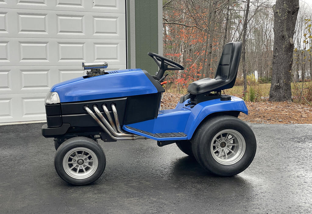

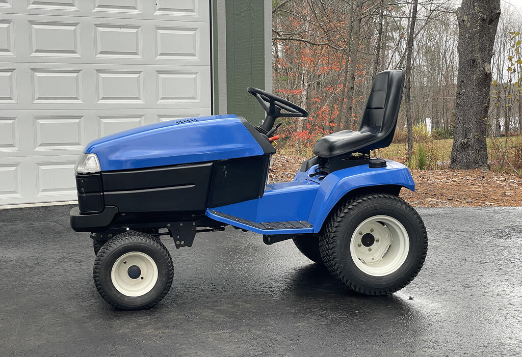

Blue Chips 881 #25234 Posted January 2 3 hours ago, Bar Nuthin said: Decided ol' Johnny needed spruced up a bit, so I slapped a quick paint job on him. AI paint job, that is. I love your AI paint job, and it inspired me. I've been having some fun playing with Photoshop and AI, and I thought I'd see what my GT18 would look like if it had a small V8 with a four-barrel, headers, mags, and racing slicks. Current (real) condition: After some AI-assisted modifications and a bunch more tweaking in Photoshop: And of course, it would be irresistible to the local bears: 14 2 Share this post Link to post Share on other sites
ebinmaine 81,183 #25235 Posted January 3 26 minutes ago, Blue Chips said: irresistible to the local bears: As THE local Bear. Can confirm. So listen here Mr Chips.... when's the real V8 getting wedged in there? 1 2 Share this post Link to post Share on other sites
sqrlgtr 4,192 #25236 Posted January 3 57 minutes ago, Blue Chips said: I thought I'd see what my GT18 would look like if it had a small V8 with a four-barrel, headers, mags, and racing slicks. Still the wrong color 1 Share this post Link to post Share on other sites
Blue Chips 881 #25237 Posted January 3 42 minutes ago, ebinmaine said: As THE local Bear. Can confirm. So listen here Mr Chips.... when's the real V8 getting wedged in there? Don't tempt me. I've been known to do crazy things like that. 11 minutes ago, sqrlgtr said: Still the wrong color Perhaps the New Holland GT series could be considered the 'blue sheep' of the 5xi family, but hopefully still welcome at Wheel Horse family gatherings. 3 Share this post Link to post Share on other sites

kpinnc 19,065 #25240 Posted January 3 13 minutes ago, Blue Chips said: Perhaps the New Holland GT series could be considered the 'blue sheep' of the 5xi family, but hopefully still welcome at Wheel Horse family gatherings. Just a 5xi in different paint. I like the blue ones! My tractors dislike green garden tractors, but they won't bother blue ones. 3 Share this post Link to post Share on other sites

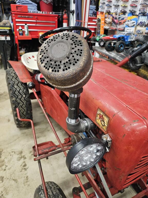

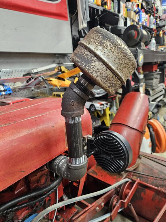

ML3 2,557 #25242 Posted January 3 Doing some mid season inspection/maint on the 702. Relocated the exhaust because it was originally turned down on the snowblower controls. Used what I had in garage for that project. Adjusted the governor also. Found a few loose bolts too. The 654 is next for inspection. All the Tecumseh haters can say what they want but that tractor is the most reliable of my entire collection. 5 2 Share this post Link to post Share on other sites

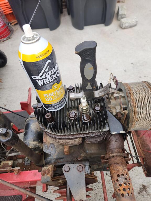

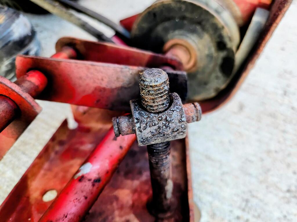

CD Long Jr 203 #25245 Posted January 5 (edited) Lots of runnin' today so it was a walk by, spray, hammer kinda day. I've been known to be abusive with hammers, so I got my little one. Edited January 5 by CD Long Jr 7 Share this post Link to post Share on other sites
ebinmaine 81,183 #25246 Posted January 5 2 minutes ago, CD Long Jr said: Lots of runnin' todays so it was a walk by, spray, hammer kinda day. I'm been known to be abusive with hammers, so I got mt little one. Liquid Wrench. Baby hammah. Niiiiice! 3 Share this post Link to post Share on other sites
kpinnc 19,065 #25247 Posted January 5 14 minutes ago, CD Long Jr said: I've been known to be abusive with hammers, so I got my little one. So THAT is what those are for! 1 1 3 Share this post Link to post Share on other sites

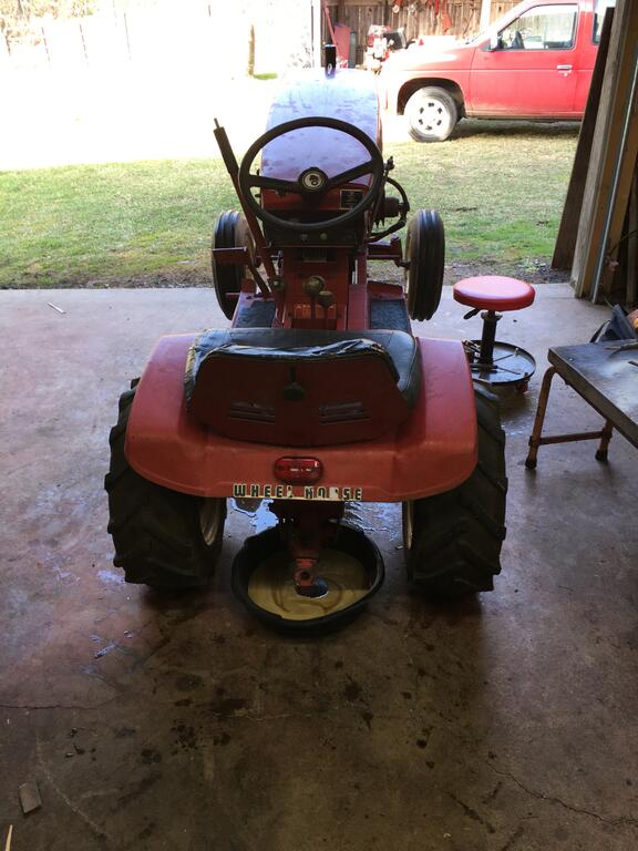

sqrlgtr 4,192 #25248 Posted January 6 Started transaxle change after pressure washing all the garden dust off the 12hp no name. Going to let her drain overnight. New shifter boot, Engine oil and brake drum seal next on the list.. 7 2 1 Share this post Link to post Share on other sites
lynnmor 9,073 #25249 Posted January 6 41 minutes ago, sqrlgtr said: Started transaxle change after pressure washing all the garden dust off the 12hp no name. Going to let her drain overnight. New shifter boot, Engine oil and brake drum seal next on the list.. A good flush or two with diesel fuel would be in order. 4 Share this post Link to post Share on other sites
