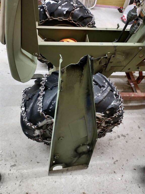

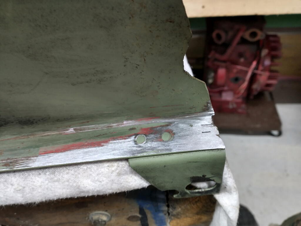

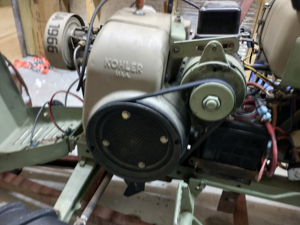

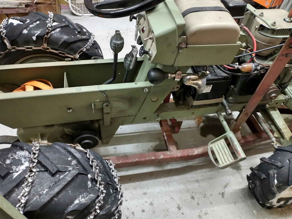

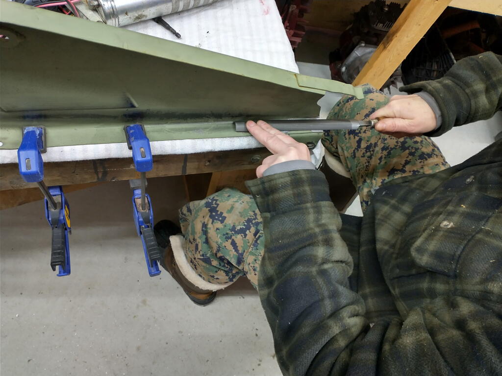

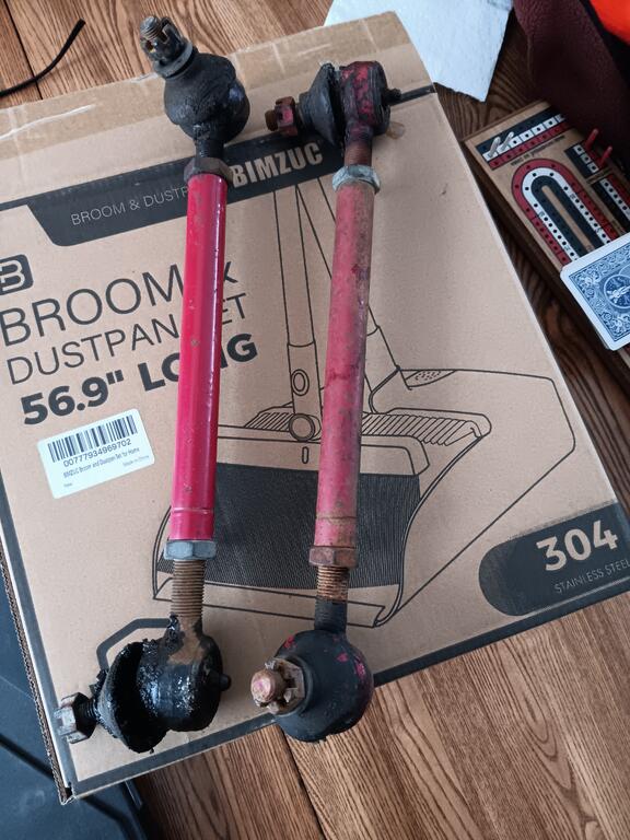

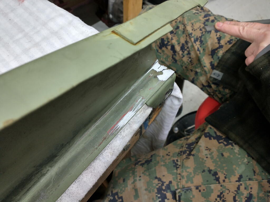

ebinmaine 80,600 #25126 Posted December 14, 2025 Got some shop time today. Popped a couple 520H tie rods off for a fellow Redsquare member. Trina got the Military Tribute Tractor "Millie" in for a couple belts. The S/G belt was so worn the unit was barely charging. The drive belt was also well worn. We did some investigating here and found that the universal transmission pulley was too wide and also too deep. 68" belt is far too short. 70" too long... Unfortunately the middle option of 69" belt was also about two hairs too long. This tractor has a 6 speed that had no pulley with it. I believe the best course would be to get a bushing from 3/4" down to 5/8" so she can use the original 3 speed pulley. We do need to figure out how to find that bushing/ adapter. @Achto @kpinnc or others? We also found the belt guard is bent and/or has a broken section near the engine. Trina filed that down. 7 6 Share this post Link to post Share on other sites
Achto 32,630 #25127 Posted December 14, 2025 19 minutes ago, ebinmaine said: We do need to figure out how to find that bushing/ adapter. @Achto @kpinnc or others? https://www.ebay.com/itm/374229841487 2 1 Share this post Link to post Share on other sites

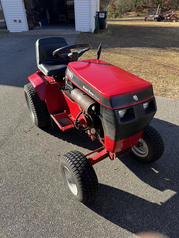

sqrlgtr 3,860 #25129 Posted December 14, 2025 1 hour ago, Lane Ranger said: Sunday December 14, 2025 after the big and cold snowstorm! 6 inches of snow and about ten degrees this am. I cleaned off my driveway and my neighbors! The 1974 Wheel Horse 8 hp B-80 worked great! Those little 8's sure punch above their weight. 3 Share this post Link to post Share on other sites

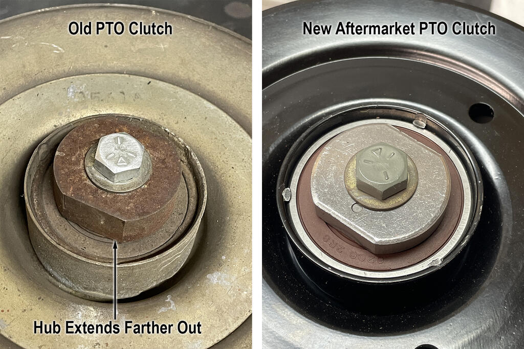

Blue Chips 854 #25132 Posted December 15, 2025 (edited) I got one step closer to putting the snowblower on my 522xi. I replaced the flaky old PTO clutch (which slipped intermittently when it was warmed up) with a new aftermarket unit. As far as I can tell, the build/fit/finish looks as good as the old clutch, which I assume is the original, since the machine had very low hours on it when I bought it years ago. The only difference I noticed is that the new clutch hub doesn't extend as far forward as the old one, making it a bit harder to get a good grip on it with a 1-1/2" wrench. The new clutch came with a 1/4-inch-thick washer to make up for it (based, I suppose, on the assumption that the user would install a replacement bolt of the same length as the old one), but instead of using the thick washer, I installed a replacement bolt that is the same as the OEM bolt, but 1/4" shorter and torqued it per the service manual instructions. After installing the clutch, in hindsight it occurred to me that I 'might' have been able to swap the old hub for the new one to make it easier to get a wrench on it, but it's in now and working fine, so it will stay that way. Edited December 19, 2025 by Blue Chips 7 1 Share this post Link to post Share on other sites

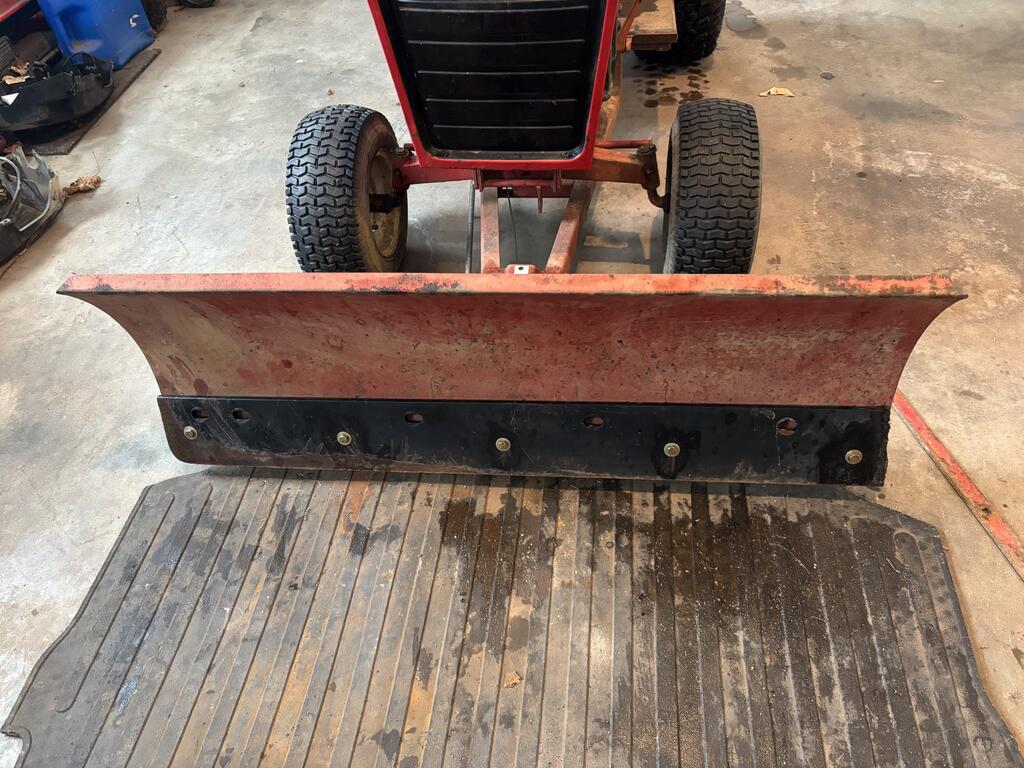

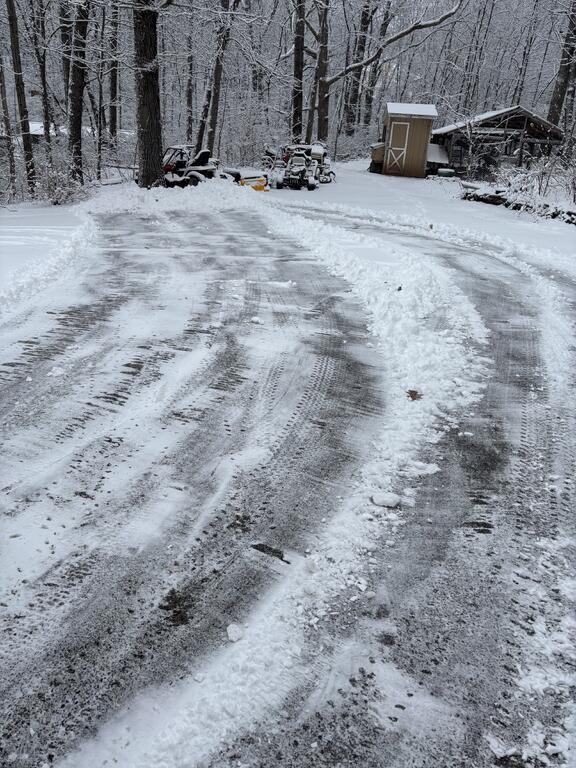

TonyToro Jr. 2,535 #25133 Posted December 15, 2025 Yesterday we got some snow. Saturday I put the blade on the c-145 since my C-120 that is supposed to have a plow on it is in pieces. Yesterday morning put a new scraper blade from a public works snowplow on. That should last awhile! Then it was time to shine. Love plowing fluffy snow! And today did a bit more cleanup. IMG_1281.mov 6 9 Share this post Link to post Share on other sites

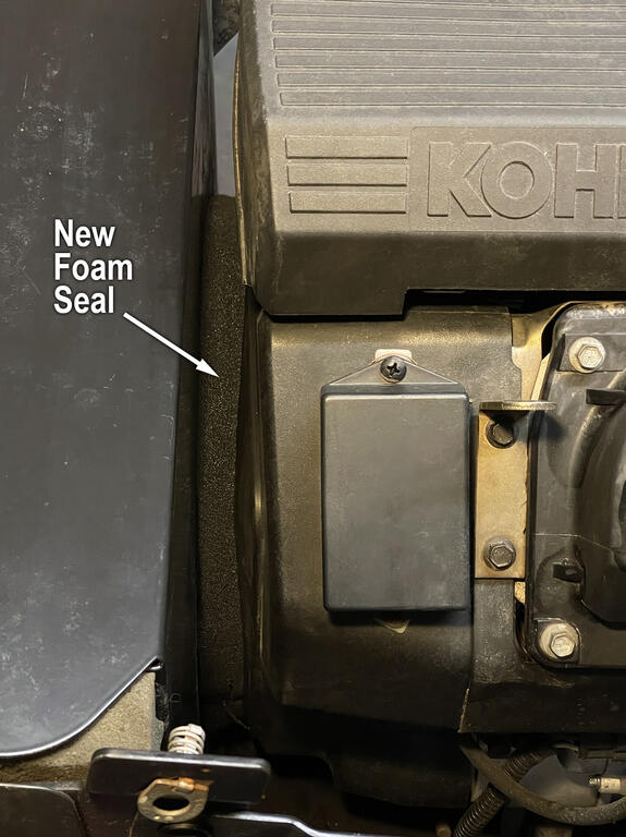

Blue Chips 854 #25136 Posted December 16, 2025 (edited) The foam seal between the engine blower housing and the bulkhead had deteriorated on both my GT18 and my 522xi, so I installed new foam seals today. I managed to do it without removing the bulkheads or pulling the engines, but it was a bit tedious. I thoroughly cleaned the surfaces with a solvent rag wrapped around the end of a rod, cut new foam strips out of oil-resistant, closed-cell foam, brushed 3M 90 adhesive onto the bulkhead surfaces, and pushed the foam strips into place with a rod while the adhesive was still wet. It turned out pretty good, and I was able to get them sealed about 95% of the way around the fan openings. The foam seal should improve the cooling air flow by reducing the amount of hot air around the engine that gets drawn back past the bulkhead and into the engine's fan inlet, so hopefully these engines will run a little cooler. Edited December 16, 2025 by Blue Chips 2 1 Share this post Link to post Share on other sites

Handy Don 17,459 #25138 Posted December 16, 2025 22 minutes ago, Blue Chips said: so hopefully these engines will run a little cooler. Might also take out a bit of noise? 2 Share this post Link to post Share on other sites

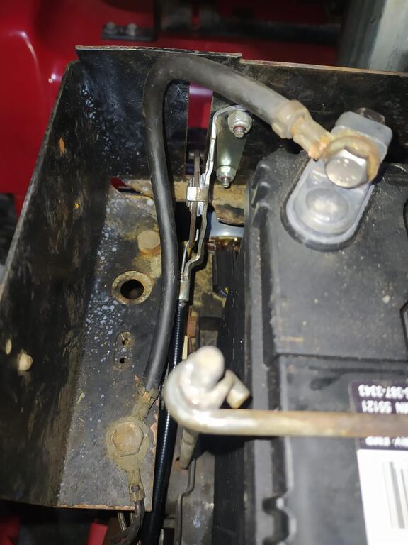

Stan50 218 #25139 Posted December 18, 2025 New throttle cable installed, way better performance. Thanks to Forum I've been able to remove that knob with ease.... 10 Share this post Link to post Share on other sites

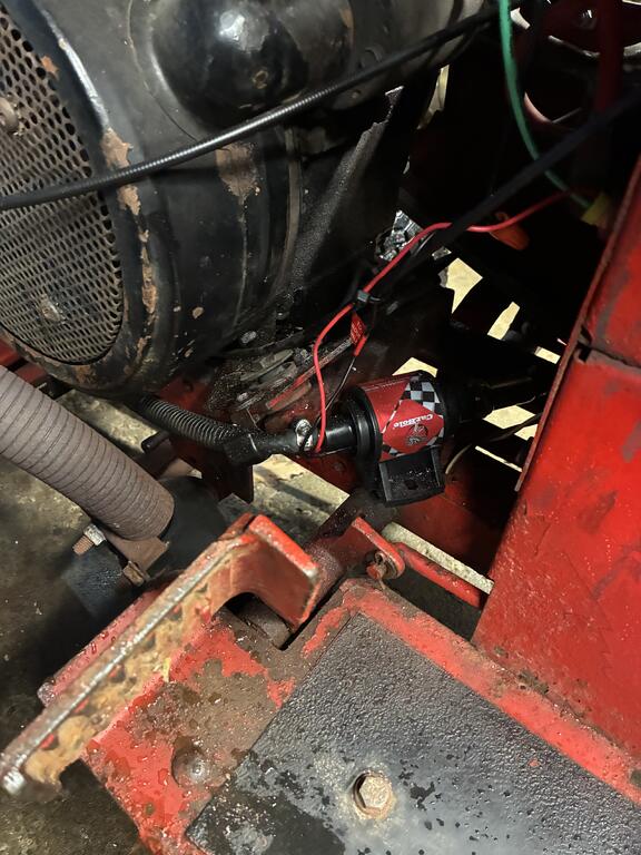

SylvanLakeWH 32,457 #25140 Posted December 18, 2025 Added a fuel pump to the C-105 snow plow tractor... wow what a difference... Primer bulb worked great for a few years but this year I was doing the "on the fly prime" to many times while plowing snow... so Game changer. Separate switch to operate... 10 1 Share this post Link to post Share on other sites
WHX?? 58,052 #25141 Posted December 19, 2025 1 hour ago, SylvanLakeWH said: "on the fly prime" You mean you had to work the bulb on the fly when running? Why not just wire to the ig switch? 1 1 Share this post Link to post Share on other sites
SylvanLakeWH 32,457 #25142 Posted December 19, 2025 9 hours ago, WHX?? said: You mean you had to work the bulb on the fly when running? Why not just wire to the ig switch? Yes - only after about 1/2 hour or so... seems related to amount of gas in tank. I am not a wiring guy... keeps it isolated and simple for the dumbbell that uses it... There is zero start up hesitation now and it runs / idles way better... 7 Share this post Link to post Share on other sites

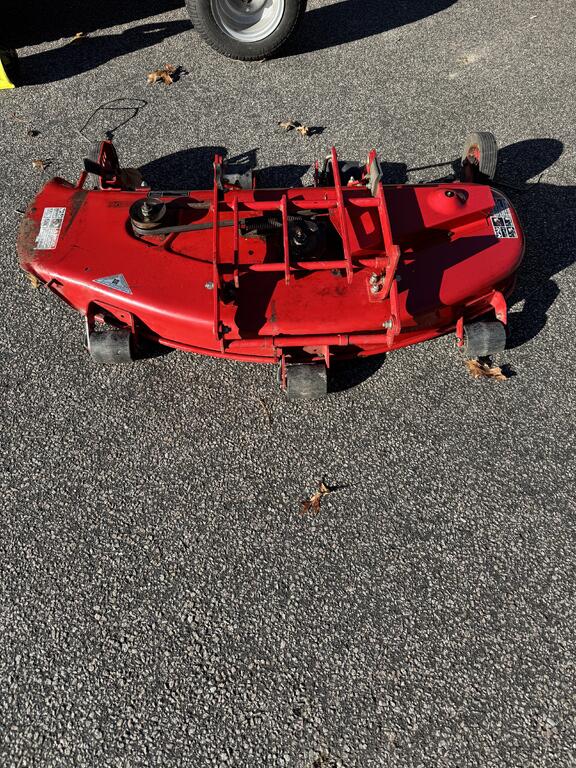

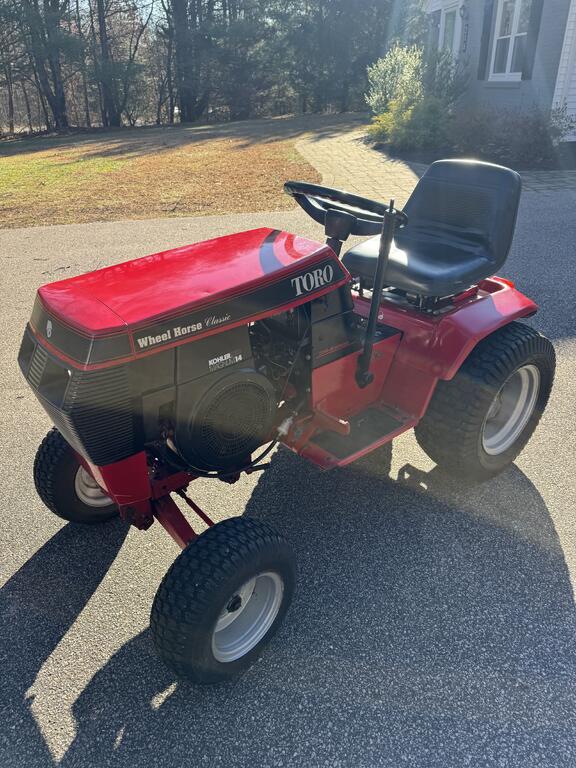

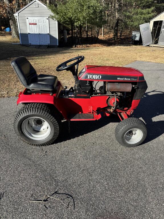

PWL216 1,278 #25145 Posted December 21, 2025 It’s a warm day here in MA so I brought out the 1993 314-8 and the deck for a last cleaning of the season. 8 6 Share this post Link to post Share on other sites

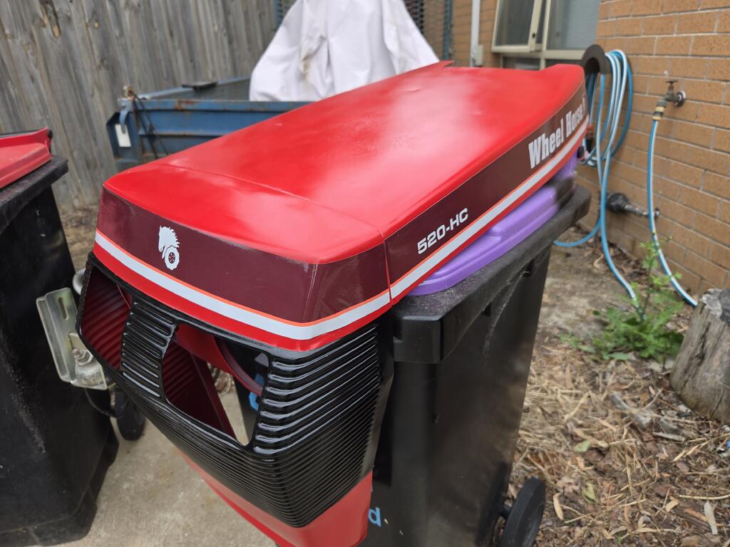

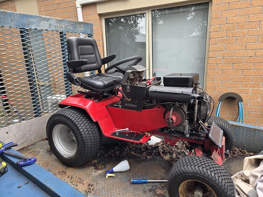

Red Stallion 231 #25146 Posted December 22, 2025 Nearly time to get the bonnet back on! 4 1 Share this post Link to post Share on other sites

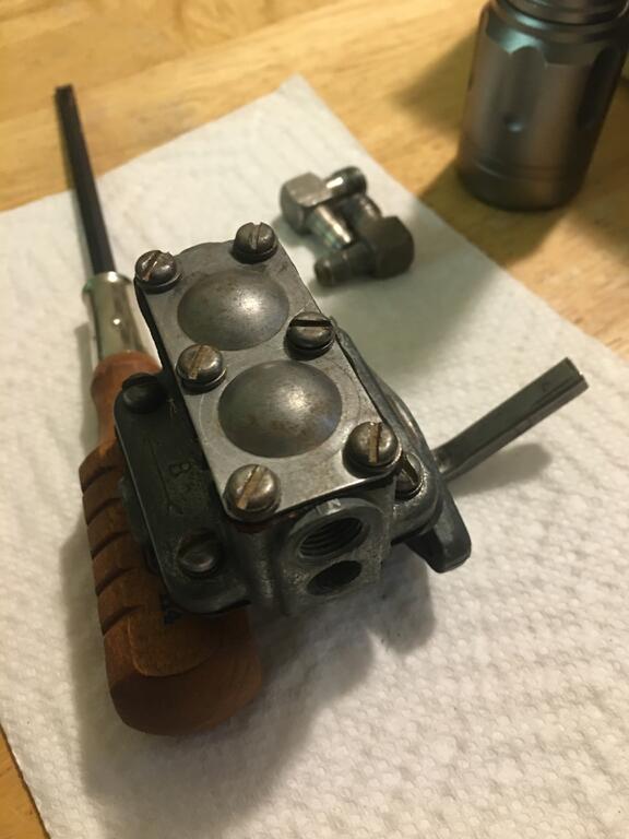

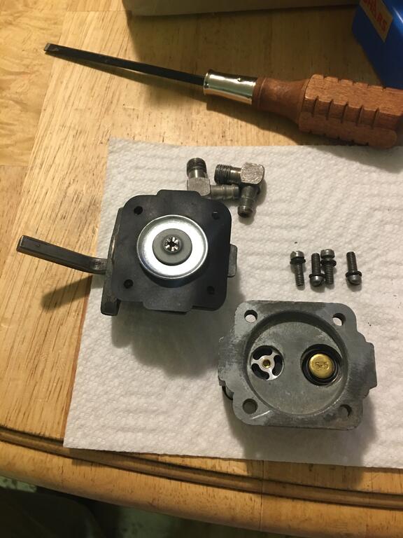

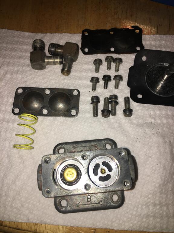

sqrlgtr 3,860 #25149 Posted December 23, 2025 Finished fuel pump rebuild for C160. Try and install on tractor tomorrow . 9 4 Share this post Link to post Share on other sites
sqrlgtr 3,860 #25150 Posted December 24, 2025 Put fuel pump back on C 160 (OL Thumper) and it leaked like a sieve (tried to reuse old gaskets). . Took back off and went back through and made a couple gaskets one for the 6 hole top and one where main body goes together. Kinda disappointed in the then and now auto kit (missing gaskets) and the top cover gasket is not included in kit although is in picture . In their defense, they are trying to make it right, but I hate it when pictures show stuff and it's not included. 3rd time a charm I guess first two rebuilds went without a hitch, but this is a later model pump and has more complicated gaskets. Will try and put back together tomorrow, I guess. Forgot to take pics of homemade gaskets so you will just have to take my word, they were beautiful . 4 Share this post Link to post Share on other sites
