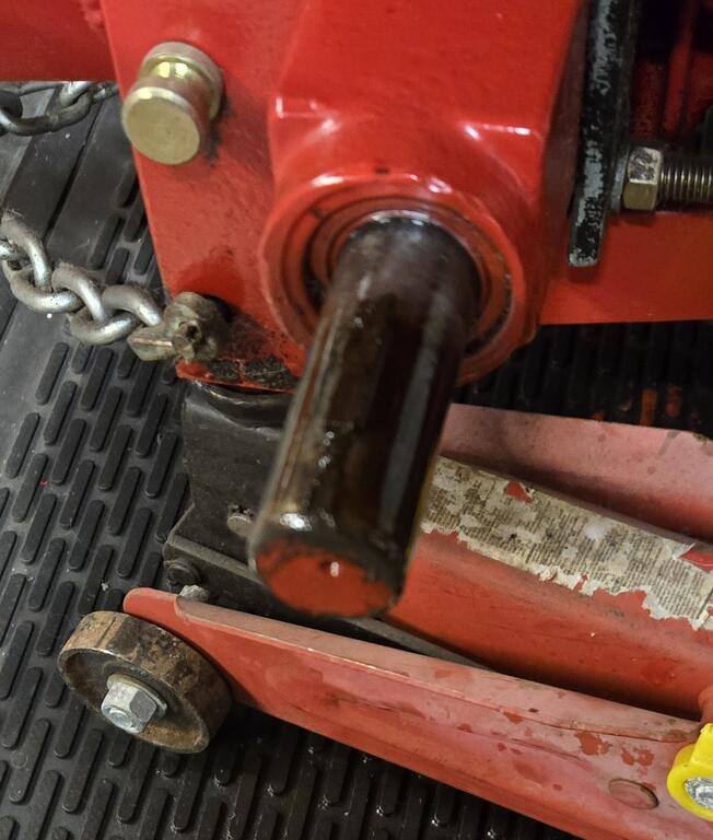

kpinnc 19,065 #25056 Posted December 7, 2025 I got several things I need to get finished, but my Bronco has been marking it's territory in my garage. One axle seal was leaking quite a bit, and I had not seen it because of how it was previously parked. Guess I should get it out more, right? As is usually the case, a leaky axle seal left alone long enough made the hub removal super easy. Didn't even need my puller for it (lucky since I couldn't find the darn thing). Anyway the hub came right off with some wiggles. Made a couple small dings in the metal face of the new seals because it was crazy tight but it shouldn't affect it. The axle and bearing seems fine. A couple hours after and no leaks yet. I'll try to get it out over the holidays and see for sure, but so far so good. 13 3 Share this post Link to post Share on other sites

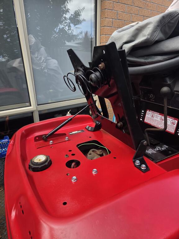

Red Stallion 231 #25057 Posted December 7, 2025 I'm back on the Wheelhorse wagon now that winter has passed. Finished up the last of my painting, and started putting it all back together... But now I can't remember how it all goes together! Anyone got a picture of their seat pan and seat assembly? I don't think my springs are right. 5 1 Share this post Link to post Share on other sites

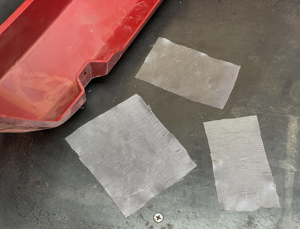

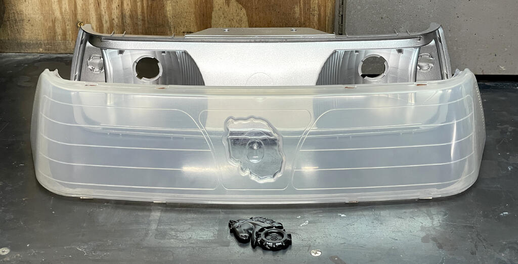

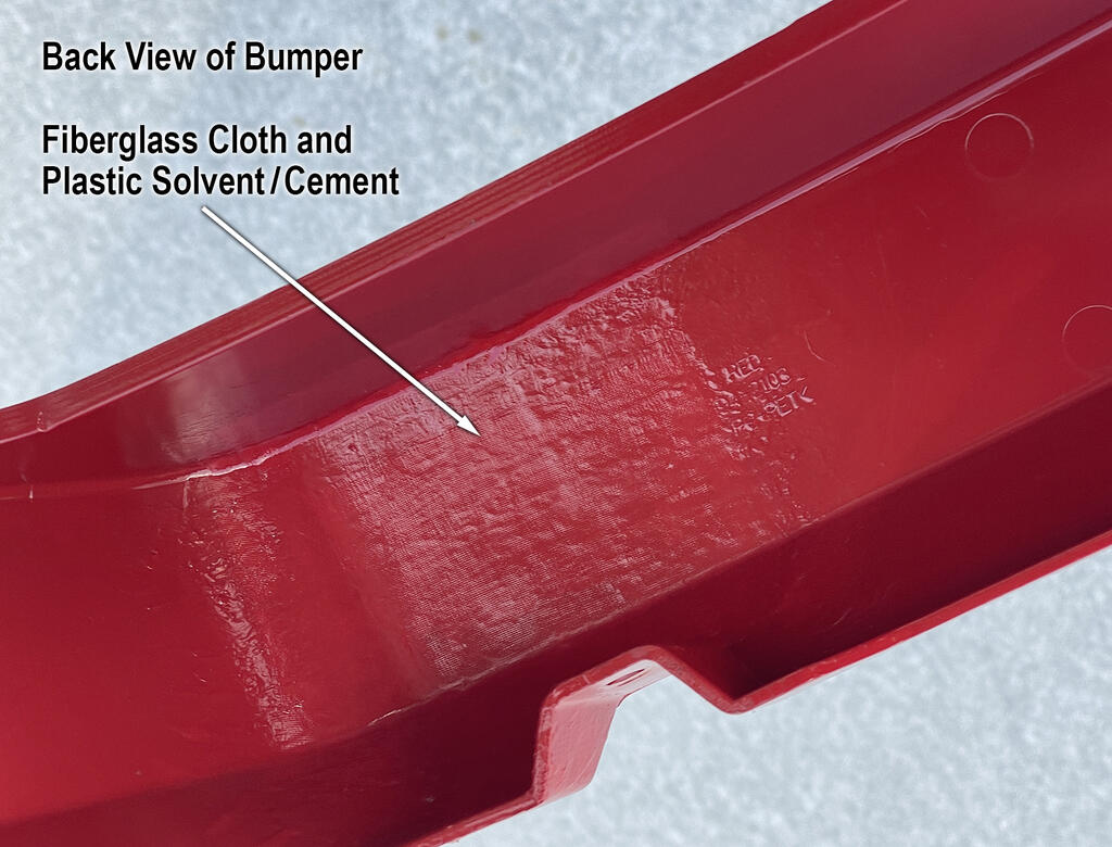

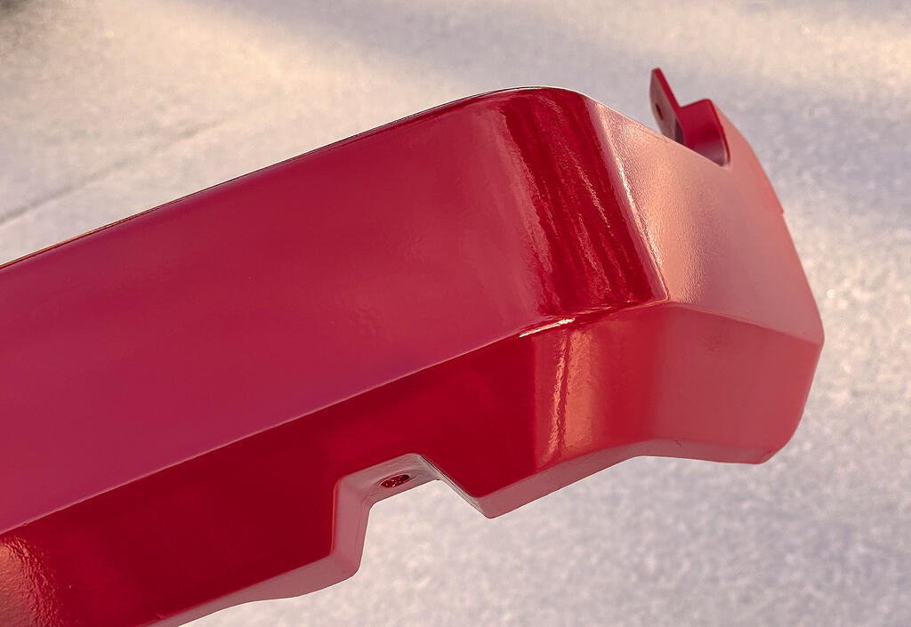

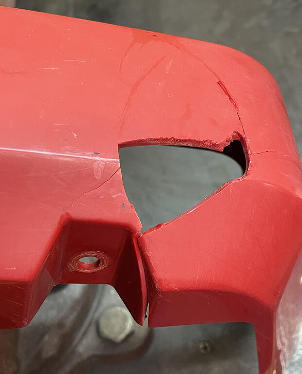

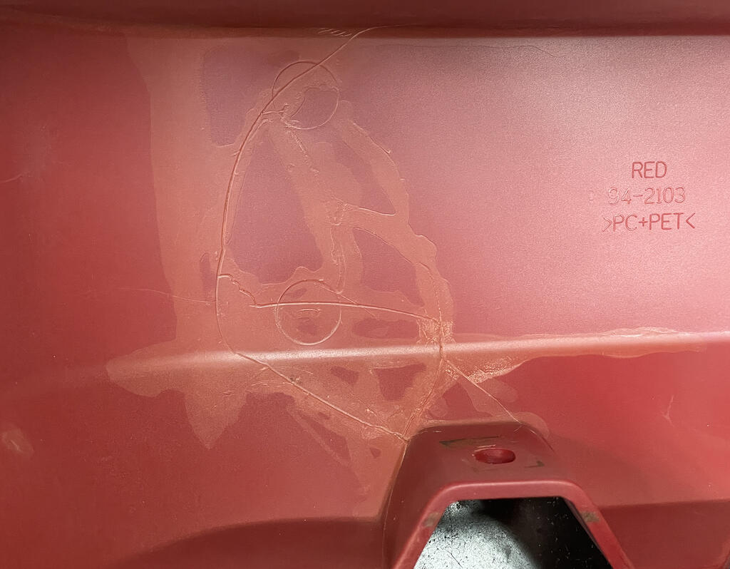

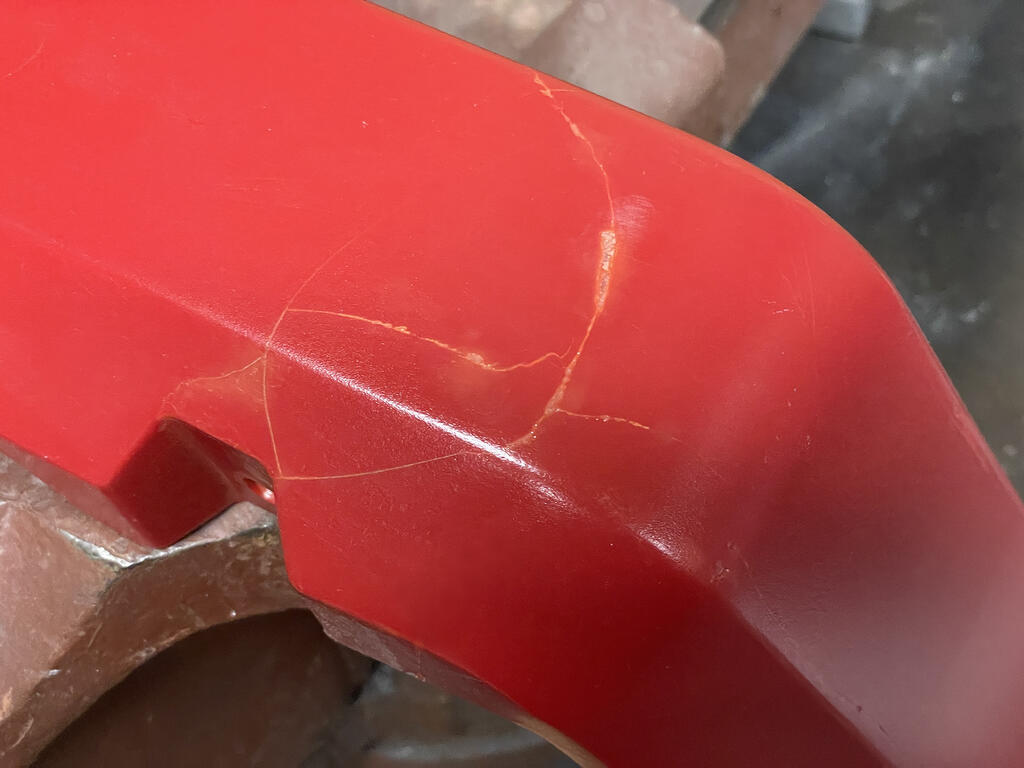

Blue Chips 881 #25058 Posted December 7, 2025 (edited) The plastic front ‘bumper’ (for lack of a better term) of my 522xi had a chunk broken out of it and several cracks radiating from that spot. Fortunately, I had the missing piece, which made the repair a little easier. After thoroughly cleaning and degreasing the area around the breakage, I stuck the piece back in and cemented the cracks with a water-thin plastic solvent cement that had good capillary action to flow into the cracks. Here’s the back view of the breakage area after applying a few applications of the cement. It seemed to work very well. Even though the cracks were completely welded shut, I shifted into my usual over-engineering mode and decided to reinforce the back of the repair with a few layers of thin fiberglass cloth. I wanted a molecular bond between the fiberglass cloth cement and the plastic, rather than mechanical, so instead of something like epoxy or polyester resin, I used a thickened plastic cement that exhibited some solvent action on the plastic. Here's the back of the bumper with at least three layers of fiberglass cloth adhered with the plastic solvent cement and with a coat of red paint over it. This part of the bumper won't be visible. Here's the front after gluing, sanding, and a coat of clear “Adhesion Promoter” primer: And the damaged area after the first coat of Regal Red paint (two more coats to go). The color looks a bit off because the photo was taken in the shade. Note: The red bumper is made of PC-PET plastic (a blend of polycarbonate and polyethylene terephthalate). The black bumpers on similar models (such as my New Holland GT18 / 518xi clone) are made of ABS plastic. However, the cements that I used were actually designed to be used with other types of plastic, such as acrylic or PVC, but they still had a solvent action on the bumper and seemed (to me) to work fine. I guess time will tell. Edited December 10, 2025 by Blue Chips 1 12 Share this post Link to post Share on other sites

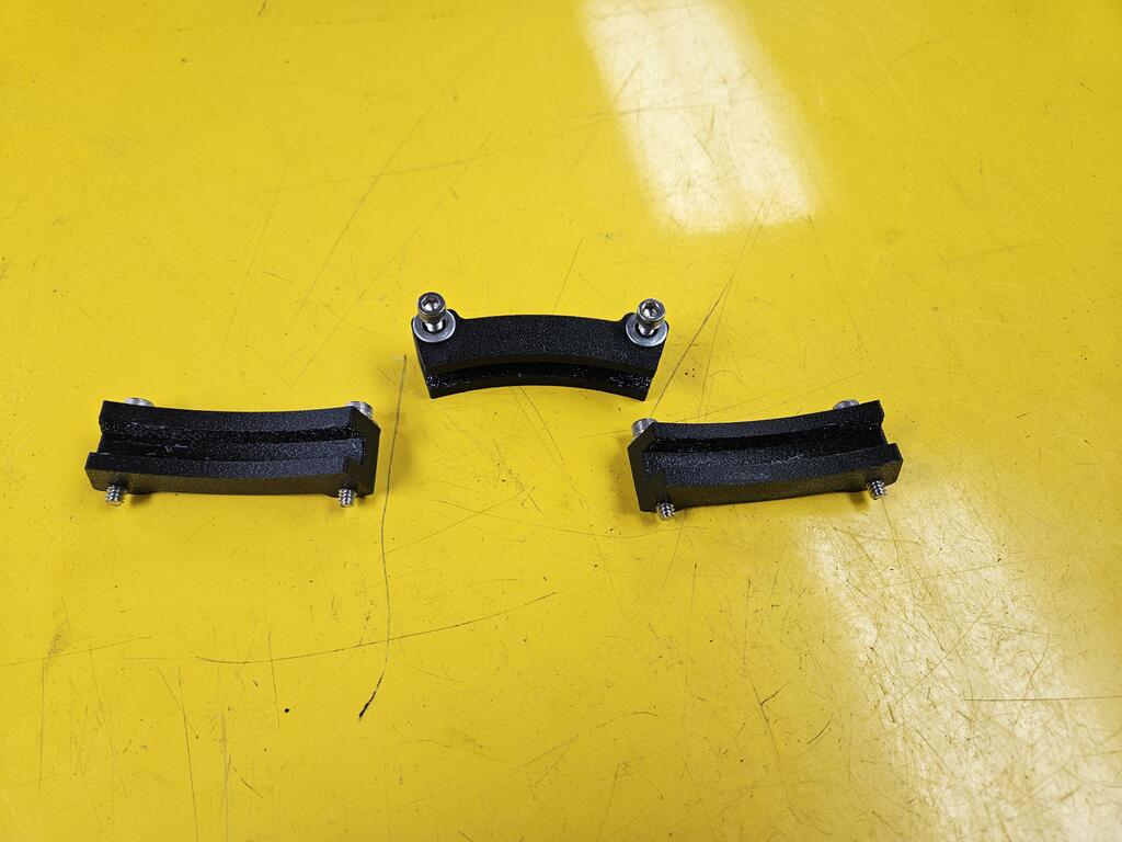

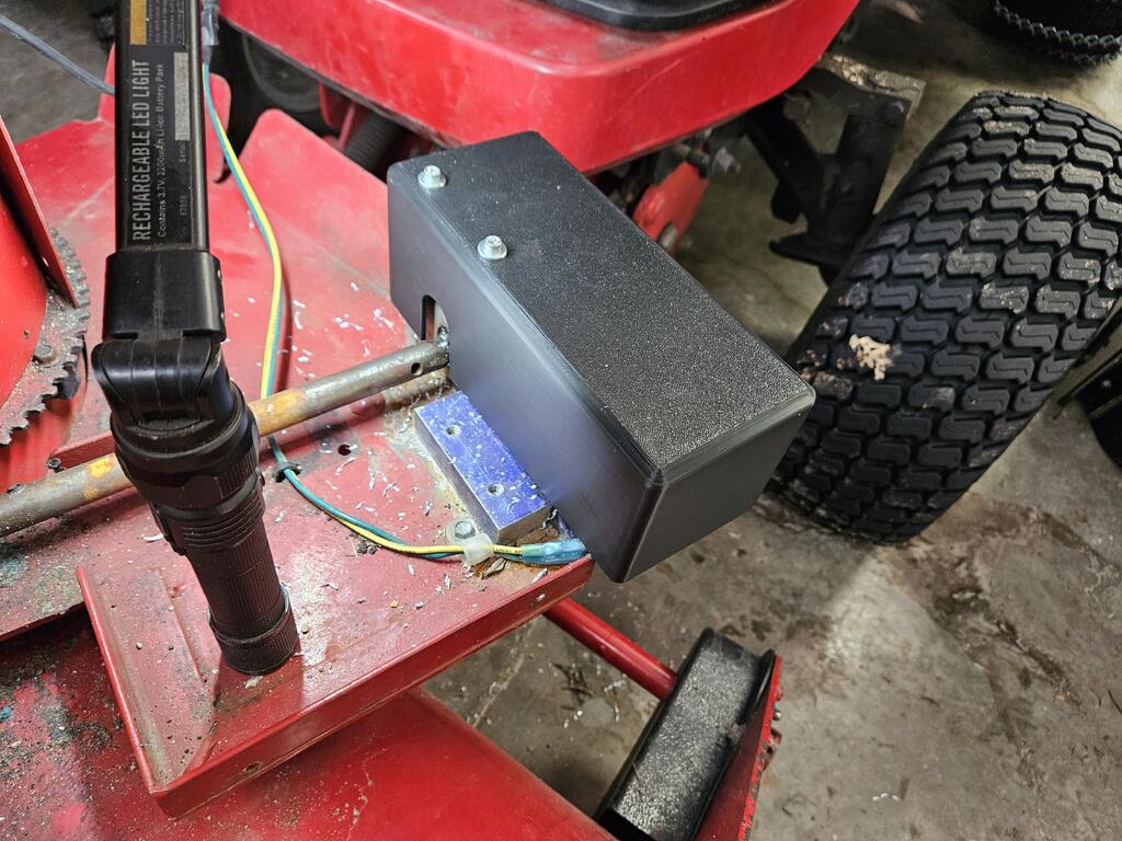

Shynon 7,729 #25059 Posted December 7, 2025 Installed 3d printed chute retainers and motor cover on the XI 3 10 Share this post Link to post Share on other sites

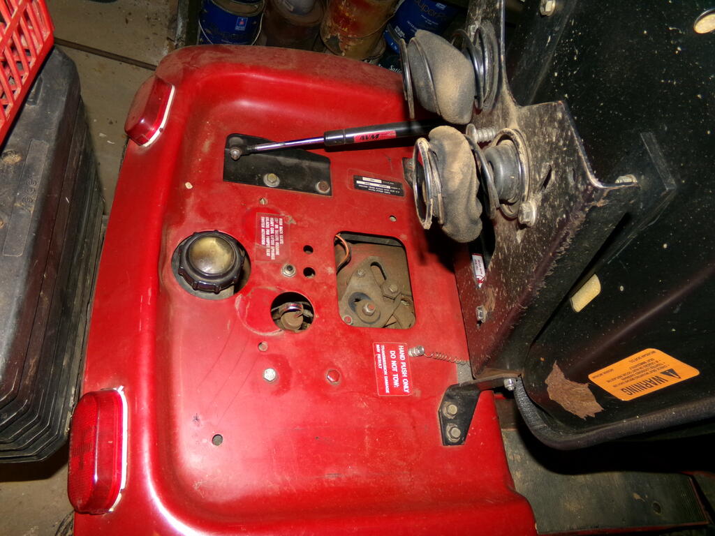

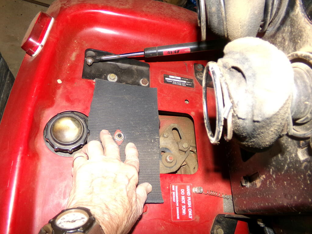

Ed Kennell 47,837 #25060 Posted December 7, 2025 8 hours ago, Red Stallion said: I'm back on the Wheelhorse wagon now that winter has passed. Finished up the last of my painting, and started putting it all back together... But now I can't remember how it all goes together! Anyone got a picture of their seat pan and seat assembly? I don't think my springs are right. That looks correct to me. I added a chunk of rubber to stiffen each spring. I also add a piece of rubber for the springs to rest on. Make sure you leave a hole for the seat switch. 9 1 Share this post Link to post Share on other sites
Lee1977 7,810 #25061 Posted December 7, 2025 12 hours ago, Red Stallion said: I'm back on the Wheelhorse wagon now that winter has passed. Finished up the last of my painting, and started putting it all back together... But now I can't remember how it all goes together! Anyone got a picture of their seat pan and seat assembly? I don't think my springs are right. I see you have a 520-H and the seat is adjustable. The seat springs will bolt up eater way. You can move the seat closer or farther back by witch way they are mounted. 1 Share this post Link to post Share on other sites
Red Stallion 231 #25062 Posted December 7, 2025 Thanks guys! I was thinking the rubber trick as I have some left over from the foot wells. The paint is so soft that the springs will chew through it within the first 100m of me bouncing on it. 2 Share this post Link to post Share on other sites

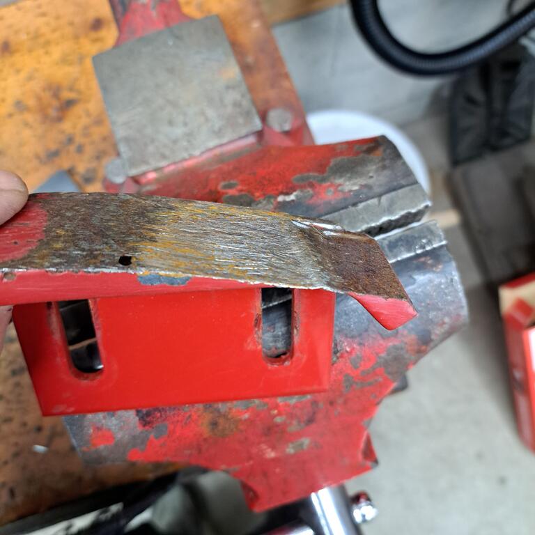

WHX?? 58,347 #25063 Posted December 8, 2025 (edited) A snow shoe needed repairing and I need to practice my welding. Laid piece over it and buzzed away. Didn’t get a pic when done ... . Actually didn't do the worst considering my welding skills suck. Edited December 8, 2025 by WHX?? 11 1 Share this post Link to post Share on other sites
Handy Don 17,689 #25064 Posted December 8, 2025 10 minutes ago, WHX?? said: Is there a reason why it wasn’t mounted to wear perpendicular to the mounting holes? 3 Share this post Link to post Share on other sites
wallfish 20,738 #25065 Posted December 8, 2025 48 minutes ago, WHX?? said: A snow shoe needed repairing That, or you coulda just used that thin part to set your points! LOL You got your money's worth outta that one 3 5 Share this post Link to post Share on other sites
WHX?? 58,347 #25066 Posted December 8, 2025 (edited) 12 hours ago, Handy Don said: Is there a reason why it wasn’t mounted to wear perpendicular to the mounting holes? Yep ... it seems no matter how tight those bolts are they always seem to be they always move. In the heat of the battle the blower gets dropped a little hard and that's what does it. Then they get covered with snow & ice & go unnoticed until spring thaw. Along with the scraper blade they are meant to wear I guess. Actually a good thing to advance my welding skills. PO had them like this but the adjustability goes out the window. Edited December 8, 2025 by WHX?? 5 1 Share this post Link to post Share on other sites
lynnmor 9,073 #25067 Posted December 8, 2025 29 minutes ago, WHX?? said: Yep ... it seems no matter how tight those bolts are they always seem to be they always move. I Apparently it is a common problem, every time I check mine they need a readjustment. 1 Share this post Link to post Share on other sites

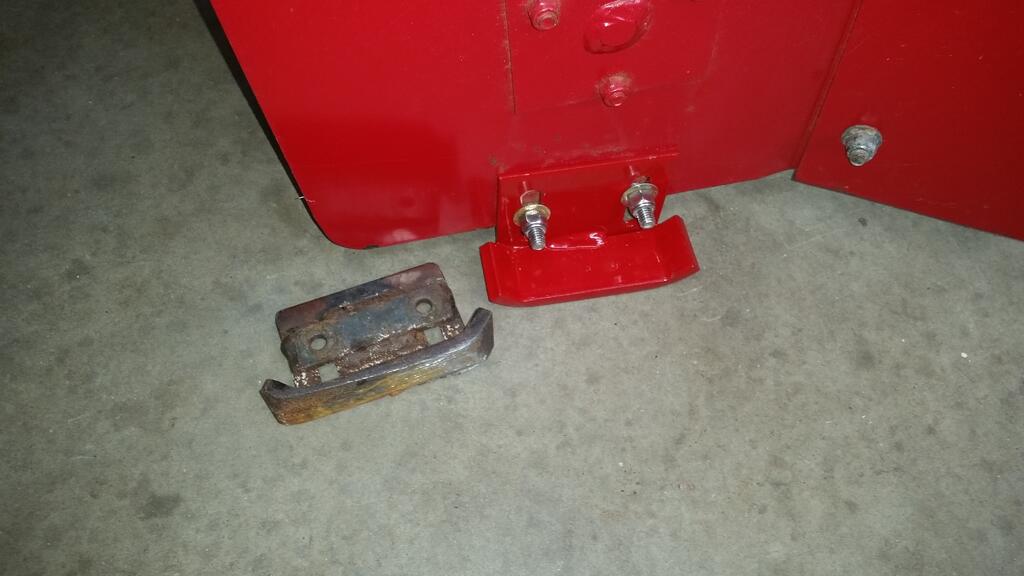

Lane Ranger 12,161 #25068 Posted December 8, 2025 1 hour ago, WHX?? said: Yep ... it seems no matter how tight those bolts are they always seem to be they always move. In the heat of the battle the blower gets dropped a little hard and that's what does it. Then they get covered with snow & ice & go unnoticed until spring thaw. Along with the scraper blade they are meant to wear I guess. Actually a good thing to advance my welding skills. PO had them like this but the adjustability goes out the window. This is one example of where Wheel Horse employees downgraded their quality in my opinion. The old steel wheel snowblower setup was a better idea. 6 2 Share this post Link to post Share on other sites
Ed Kennell 47,837 #25069 Posted December 8, 2025 13 minutes ago, Lane Ranger said: The old steel wheel snowblower setup was a better idea. When I still had blowers., I also liked the old style with wheels. Made the blowers so easy to move around when off the tractor 8 1 Share this post Link to post Share on other sites

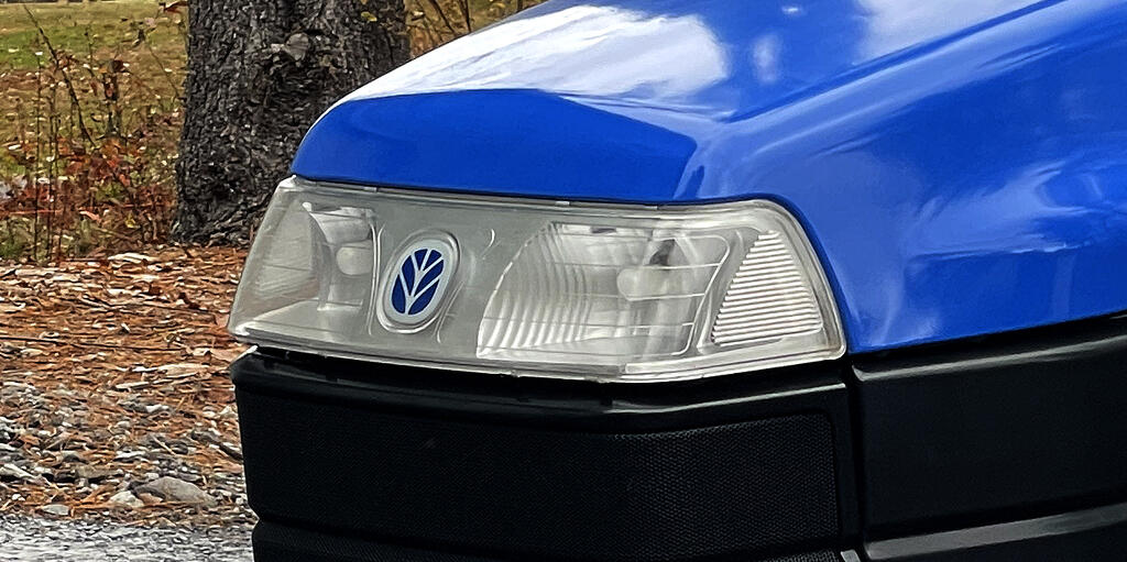

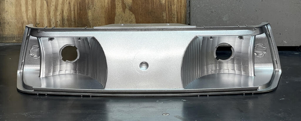

Blue Chips 881 #25070 Posted December 8, 2025 (edited) Worked on restoring the headlights on the 522xi. I had good luck with the headlight reflector, but not quite as good with the lens. For the reflector, after cleaning and a light bead blasting to roughen the surface slightly, I sprayed it with "Rust-Oleum Automotive 600 Degree Aluminum Engine Enamel," which is great paint. It's quite shiny and adheres really well, although the overspray is messy as it sticks to everything within several feet of where you're spraying. I then top-coated it with "Rust-Oleum Automotive 600 Degree Gloss Clear Engine Enamel." I think the reflector is 'almost' as reflective as the original surface, and it should hold up well. The headlight lens is much better than it was before (brownish yellow, almost opaque, and heavily oxidized), but it's still rather milky after I spent almost two hours polishing it halfway to China, using all kinds of approaches, including progressively finer sandpaper, headlight restorer kit, polishing compounds, wax, etc. I think the milkiness is very deep, so I guess I'll either have to put up with it or buy a new or used replacement lens. New ones are still available, but kind of expensive. By contrast, the headlight lens on my GT18 (the same kind of lens) cleaned up beautifully (below) and is crystal clear. I guess my 522xi must have spent a lot more time outside in the sun than the GT18. Edited December 9, 2025 by Blue Chips 6 3 Share this post Link to post Share on other sites
