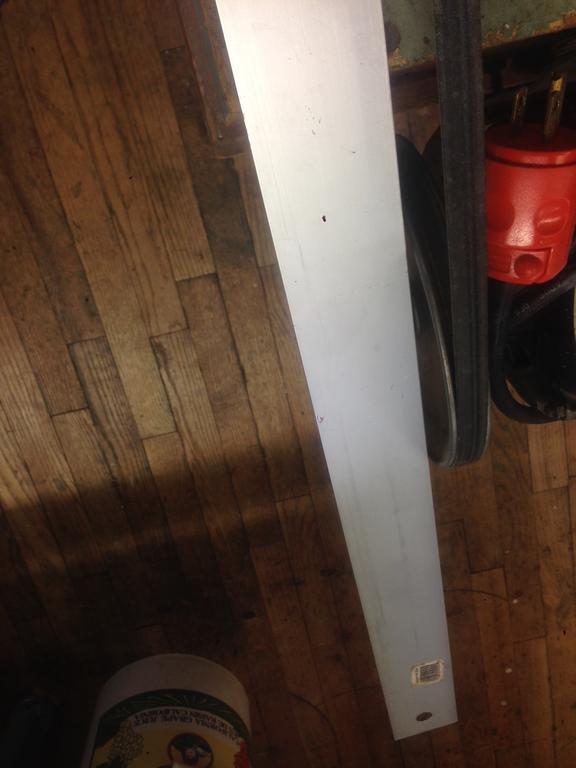

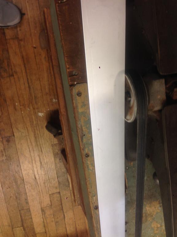

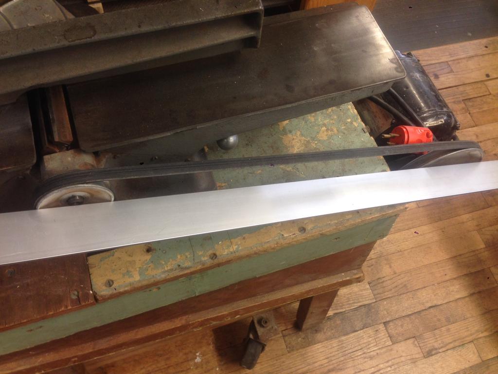

formariz 12,151 #2 Posted January 14, 2018 (edited) It depends on a few factors including where the transmission pulley is also. The best way is to place a straight edge across the face of all pulleys. Straight edge should be touching both edges of all pulleys in question. Now they are aligned. Check to see if they clear everything specially belt guard. If so you should be OK. If not you are going to have to move all pulleys in or out to achieve clearance. Pulley at engine probably got loose and moved inwards towards engine. That is known to happen. Make sure that set screws are tight once alignment is finished. Its a good idea to check that occasionally specially after extreme temperature changes. Here is an example on something else but same principle: Edited January 14, 2018 by formariz 4 2 Share this post Link to post Share on other sites
