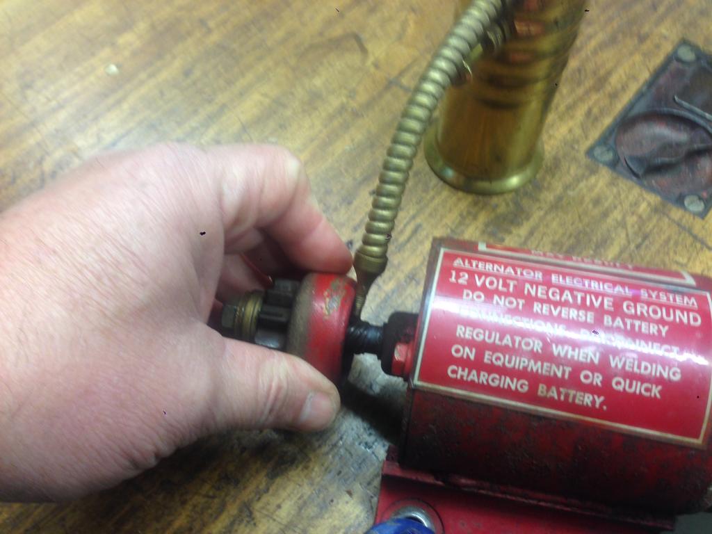

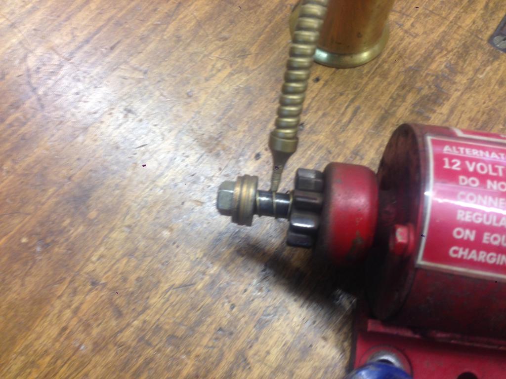

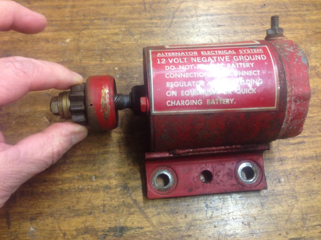

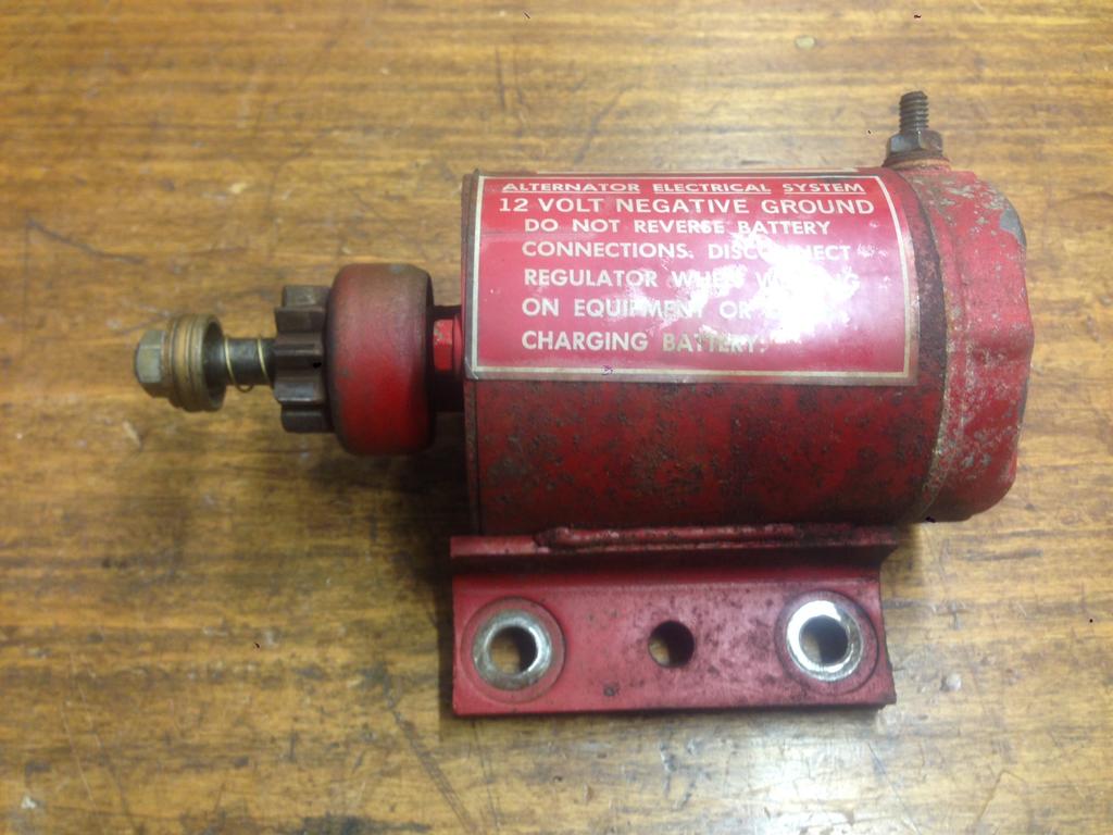

formariz 12,354 #7 Posted January 14, 2018 (edited) Hello Carlos and Welcome. Like it was mentioned before your starter is probably OK.Try the following first: If your starter turns when power is applied to it,but will not engage engine the Bendix is most likely stuck or frozen.Its an item that needs occasional maintenance. When power is applied to starter ,the gear at end of starter moves forward on the threaded shaft therefor engaging flywheel. Most likely that is not happening on yours and starter just spins therefor the sound you hear. You need to lubricate shaft. You probably can get it unstuck by just applying a little pressure to that part of it with a screw driver's tip. Refer to photos below, and to video to see how it operates. IMG_0945.MOV Edited January 14, 2018 by formariz 1 5 1 Share this post Link to post Share on other sites

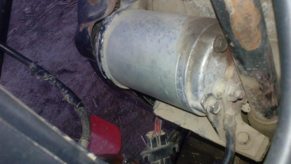

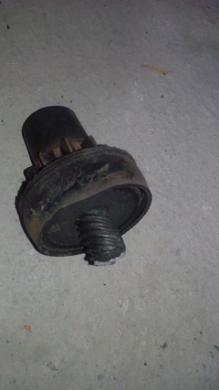

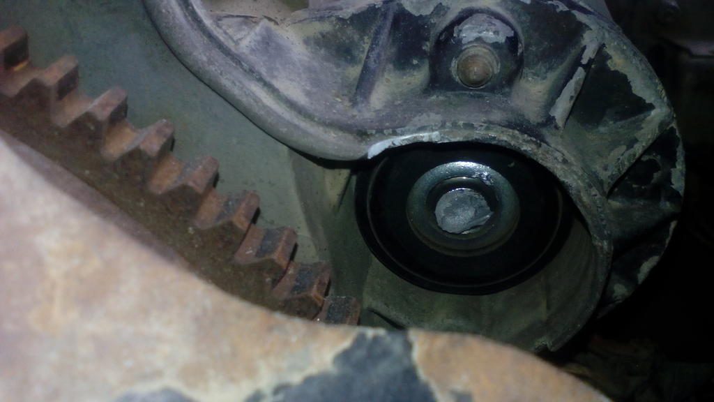

Carlos VB 14 #18 Posted February 27, 2018 Hello again Finally I decided and have time to bring out some screws and I found this: the "axis" is broken. Some ideas ? I don´t know the starter model yet, Thanks Share this post Link to post Share on other sites
wildbill59 43 #19 Posted February 27, 2018 Wow - that's not good... I've never seen that happen before! If you have a mechanic that you can trust, and he can rebuild that starter for you at a reasonable price, you can probably find someone to send you a used armature (I'm sure I have one somewhere). Otherwise, like Formariz suggested, those starters are cheap and plentiful in the states. Check to see what shipping costs would be, I'm sure one of us can help you with the starter or parts that you need. Welcome to Red Square! 1 Share this post Link to post Share on other sites

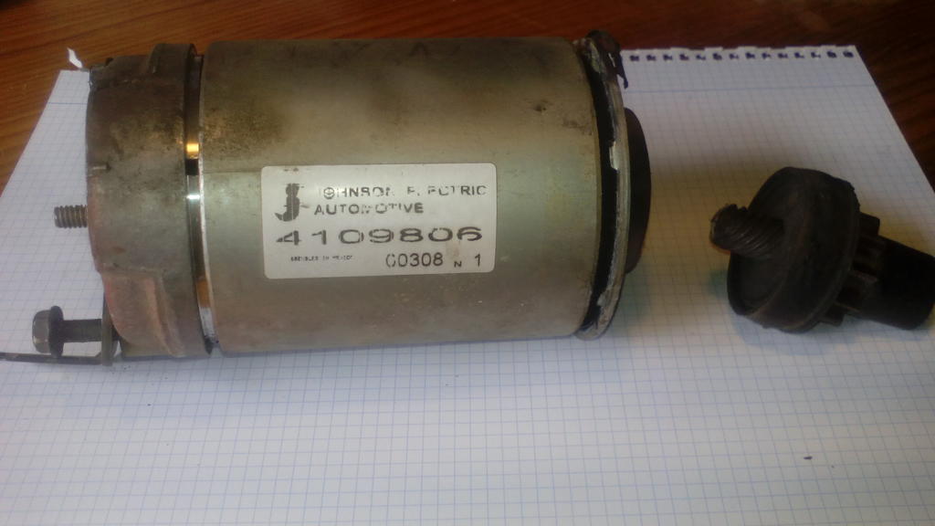

Carlos VB 14 #23 Posted March 6, 2018 Great, here it is !! Share this post Link to post Share on other sites

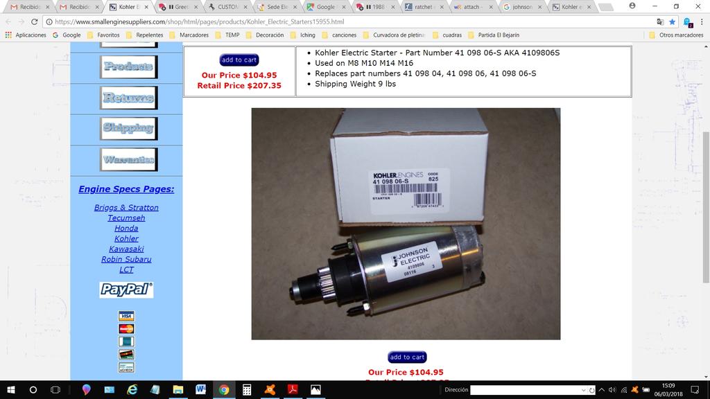

Carlos VB 14 #24 Posted March 6, 2018 And this is the new one... I will try to find it here in Europe Share this post Link to post Share on other sites
formariz 12,354 #25 Posted March 6, 2018 (edited) That is pretty high priced Carlos.You can use a aftermarket one . Same as the Kohler. Most likely all made by the same people unless it is NOS. I am not sure if it goes that high from here even with shipping . you should be able to get one for about $50.00. How long could you wait for one? Are you in a hurry to get it going? Edited March 6, 2018 by formariz 2 Share this post Link to post Share on other sites
