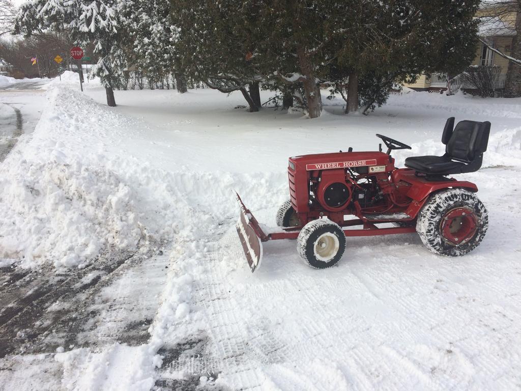

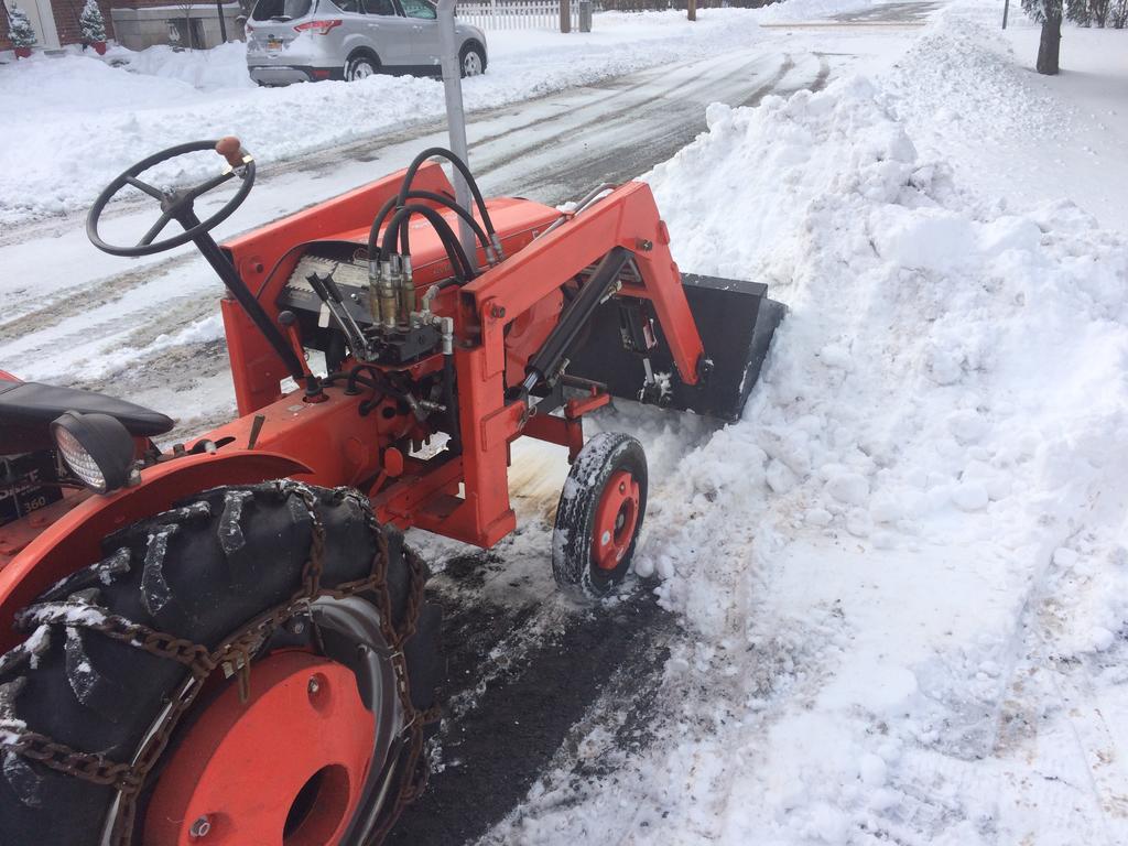

squonk 44,036 #1 Posted January 13, 2018 12-16" of the white stuff. Had the 520 out first with the blower but no pics. Throttle froze after the first 5 min of blowing. Seems to be freezing where it loops under the engine. It froze on me last year too. going to have to try to figure out why. But got it knocked down enough to get the C-160 out to scrape it down. Lots of ice under it and it made it heavy. Had to move the piles with Elvis. This lovely couple hung out on my porch warming up from the dryer exhaust. 17 4 Share this post Link to post Share on other sites
Mikey the Monkey 701 #2 Posted January 13, 2018 I'm envious if that c-160. She's a beaut! 3 Share this post Link to post Share on other sites
squonk 44,036 #3 Posted January 13, 2018 18 minutes ago, Mikey the Monkey said: I'm envious if that c-160. She's a beaut! The motor in my 1267 went sour fast. I had to dig the 160 out of the shed and swap all the snow stuff over on Thursday night. 1 Share this post Link to post Share on other sites

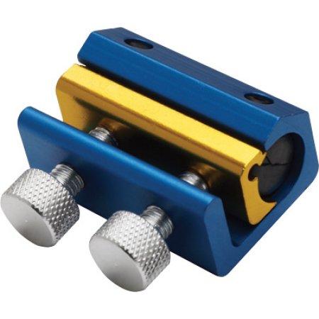

Cee245 846 #7 Posted January 13, 2018 @squonk have you tried a cable lube tool like this one? I haven't tried in on a WH but use it on lots of other things. Cory Share this post Link to post Share on other sites
Retired Wrencher 5,937 #8 Posted January 14, 2018 Mike have you ever tried a cable lubricator? Like this? these work great. Never had a sticky cable using these. I some times cover the hosing with 1/4" shrink tubing to seal it. Enjoy. Share this post Link to post Share on other sites
Sparky-(Admin) 23,435 #9 Posted January 14, 2018 Anyone want to explain how this cable lubricator works? Never seen or even heard of it before. Share this post Link to post Share on other sites

jeff lary 173 #12 Posted January 14, 2018 (edited) I saw this thread and I do it myself without a tool .Total is (maybe .50 cents ) for a small hose clamp which you probably already have. 1) Disconnect the cable from the Carburetor end so the cable is free from all connections on this end. 2) First I take a piece of some scrap gas line that is large enough to go on over the cable. 3) Then I and Cut off about 6" of this gas line preferably see through. 4) Slide about 1" of this line on over the cable, and Use a small hose clamp to clamp the line tight around the cable. 5) Fill the remaining empty portion of the gas line with Marvel Mystery oil . 6) Now get your compressor air gun and wedge the end of your gun nozzle into the line so it fits tightly, and hit it with compressed air. 7) This will force the oil into the cable, I do this a couple times till oil comes out the other end. This whole procedure takes about 10 min including removal and reinstallation of the affected cable. And It works wonders good luck with whatever you choose to do but this is easy and free. Edited January 14, 2018 by jeff lary 2 2 Share this post Link to post Share on other sites

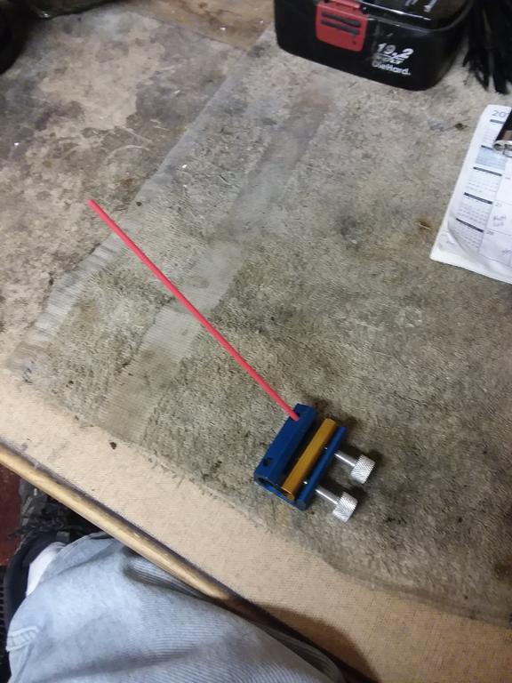

squonk 44,036 #17 Posted January 14, 2018 I'm thinking Super Buffet in Rochester followed by a trip to Harbor Freight for some free entertainment tomorrow. Gonna hit a couple of bike shops looking for a cable luber. Can get one from Amazon but I'd rather but local. 3 Share this post Link to post Share on other sites
Retired Wrencher 5,937 #18 Posted January 15, 2018 15 hours ago, squonk said: I'm thinking Super Buffet in Rochester followed by a trip to Harbor Freight for some free entertainment tomorrow. Gonna hit a couple of bike shops looking for a cable luber. Can get one from Amazon but I'd rather but local. Mike you will like it. I have had mine 15 years now. I used to race snowmobiles. Still works fine. Like I said if the outer housing is chewed up clean the sharps parts of and run some 1/4' shrink tubing over it to seal in the lube. You will be happy. 1 Share this post Link to post Share on other sites
