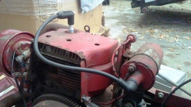

Rustyred 63 #3 Posted January 11, 2018 Too true. Thanks. A friend had told me this was something I really had to pay attention to so I thought I'd throw it out there. So thanks. BTW - I am missing the wire that runs from the ignition coil to the battery. See picture below. Any idea where I can acquire one? Thanks. Share this post Link to post Share on other sites

Rustyred 63 #5 Posted January 11, 2018 Oh dear - I wrote this wrong. Thanks for the patience. ( it's Thursday) I meant the wire which runs from the ignition coil to the Spark Plug! Share this post Link to post Share on other sites
Ed Kennell 47,403 #6 Posted January 11, 2018 https://www.jackssmallengines.com/jacks-parts-lookup/part/onan/167161501?msclkid=e52ed0ff9674156b4f2f8aa8ef86d392 3 Share this post Link to post Share on other sites
rmaynard 17,589 #7 Posted January 11, 2018 Standard plug wire. Available almost anywhere small engine parts are sold. Also available on Amazon and eBay. 2 Share this post Link to post Share on other sites
