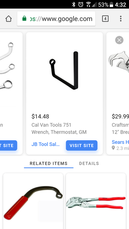

WHX?? 55,748 #10 Posted January 9, 2018 Not to steal your thread Dave but what is involved in taking the carb off? I have never had a reason to pull one but I got a feeling unless I sell all my Onans eventually I am going to have to. It appears the carb is bolted up thru the bottom of the manifold and the bolts are impossible to get off without the manifold coming off? I have gotten by with just cleaning the carb in place but gotta feeling those good times are gonna end some day. . Share this post Link to post Share on other sites
WVHillbilly520H 10,378 #11 Posted January 9, 2018 5 minutes ago, WHX14 said: Not to steal your thread Dave but what is involved in taking the carb off? I have never had a reason to pull one but I got a feeling unless I sell all my Onans eventually I am going to have to. It appears the carb is bolted up thru the bottom of the manifold and the bolts are impossible to get off without the manifold coming off? I have gotten by with just cleaning the carb in place but gotta feeling those good times are gonna end some day. . Yep you gotta pull the intake manifold, but if you're real creative with a wrench I suppose you could finagle the carb loose from the intake ,kinda like this guy ,Jeff. 1 2 Share this post Link to post Share on other sites
WHX?? 55,748 #12 Posted January 9, 2018 Couldn't get at them with a crowfoot wrench or something like that? Share this post Link to post Share on other sites
WVHillbilly520H 10,378 #13 Posted January 9, 2018 3 minutes ago, WHX14 said: Couldn't get at them with a crowfoot wrench or something like that? Maybe but I think the crowfoot isn't long enough from the square drive to nut flare, but a cheaper brand wrench ,a torch, a vise could get you close...maybe something like this... 1 Share this post Link to post Share on other sites
