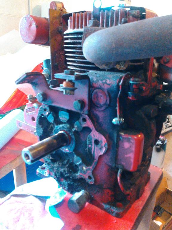

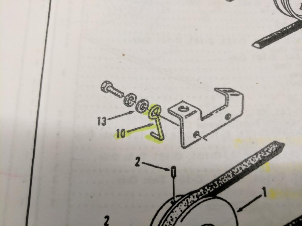

Rustyred 63 #1 Posted January 8, 2018 Hi again folks, So in putting our tractor back together we have noted in the drawings that there is a "belt guide" (part #107640) that is included in the drawing. As you clearly see on this photo taken BEFORE I disassembled the motor, there is NO such part on the motor. Do I need to add one? Or is it not necessary? Interestingly, the bolt the drawing recommends would not be long enough to include this guide! Something doesn't add up. Thank you for your assistance, Rustyred s... Max total size 2.63MB Insert other media Uploaded Images engine.jpg 1.7 mb · Done Share this post Link to post Share on other sites
wallfish 20,733 #2 Posted January 8, 2018 It helps guide the belt when the clutch pedal is pushed so the belt doesn't spin by contacting the engine pulley. You can just make one of those guides out of 3/16 or 1/4 inch rod if you find you need it. 3 Share this post Link to post Share on other sites
