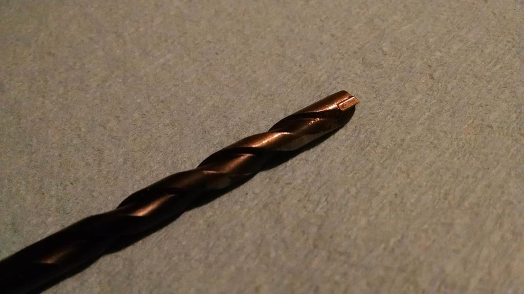

Achto 32,880 #1 Posted January 8, 2018 I disassembled a tractor this weekend to get it ready for a restoration. Of course there were a few things that were "brown welded" together, the worst of which was the roll pin through the steering wheel. I destroyed my 1/4" roll pin punch trying to remove the pin. I wanted to save the steering wheel, so heat was out of the question. Next option, drill the stupid thing out. If you want to wreck a perfectly good high speed drill bit, run it against a roll pin. If you want to shine the end of the roll pin up real nice, try a cobalt drill bit. Sooo, what to do? This is what will work - A carbide tipped drill bit will cut through the roll pin. I purchased a multi purpose carbide bit but you could also use a masonry bit. 9 1 Share this post Link to post Share on other sites

Joshn569 273 #9 Posted February 9, 2018 I have the same exact problem. You have a pic of the bit by any chance? My steering wheel is in really nice shape and i dont want to break it trying to remove as i think i can work around it possibly. 1 Share this post Link to post Share on other sites
Achto 32,880 #10 Posted February 10, 2018 7 hours ago, Joshn569 said: I have the same exact problem. You have a pic of the bit by any chance? I picked up my carbide tipped bit at a local True Value hardware store. You can also use a carbide tip masonry bit. One word or advise, don't be afraid to increase you drill speed. Fast with a lot of pressure will work the best when using a carbide tip bit on hardened steel. If you have any more questions, I'd be happy to help. 2 Share this post Link to post Share on other sites
