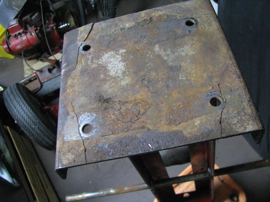

wh500special 2,354 #13 Posted January 24, 2018 (edited) Just to chime in that ramming snow piles isn’t the only thing that breaks frames... There’s no doubt that ramming things with the snow plow is cause for concern to the transaxle mounting plate, but I’ve parted out several tractors - especially 520h’s - that had broken and torn plates and which showed no signs of ever being wearing a plow. Worst break I ever saw was on a 312h that only ever mowed and carried a front mount generator. That tractor was held together only by the sheet metal tunnel and belt guard and the owner was none the wiser. Sometimes the welds let go. Sometimes the four little bolts work their way through the plate. Sometimes the plate cracks (as pictured )and rips apart...That’s what happened on the 312. The Combined weight of engine, implement, and - to a lesser extent - operator are conspiring at all times to break that plate over every bump. The 60” mower in particular is a killer...combine that with a hefty operator and you got the recipe for trouble my friends, right here in river city. Of course, you won’t be hanging a 60-incher under your oldie. Wheel Horse reinforced the mounting plate somewhere along the line, and even sold a reinforcement plate to help in that area. The D-series and 5xi’s went to full-length frames to get rid of the problem for good. That said, the vast majority of these tractors never suffer a broken frame...so if you drive your tractor like a reasonable person there’s not many tasks you should be afraid to put up against it. Like others have said, you’ll usually run out of traction before you can do any real damage. Although I do recall the legendary Dale from MI ballasted a tractor so heavily that he broke an axle... Work it as hard as you dare. They were built to mostly take it. Steve Edited January 24, 2018 by wh500special 4 1 Share this post Link to post Share on other sites

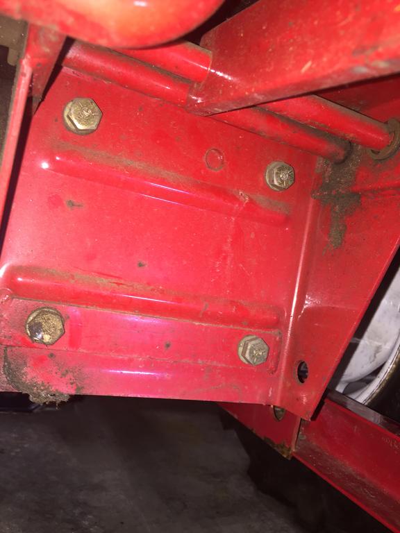

Red144runner 658 #16 Posted January 25, 2018 Here's my '96 3/12. Has the factory reinforced frame plate. 3/4" x 3/16" bar welded and drilled for bottom bolts. This tractor plows now but for its first 20 years wore a 300lb 44" snowblower in the winter 2 Share this post Link to post Share on other sites
