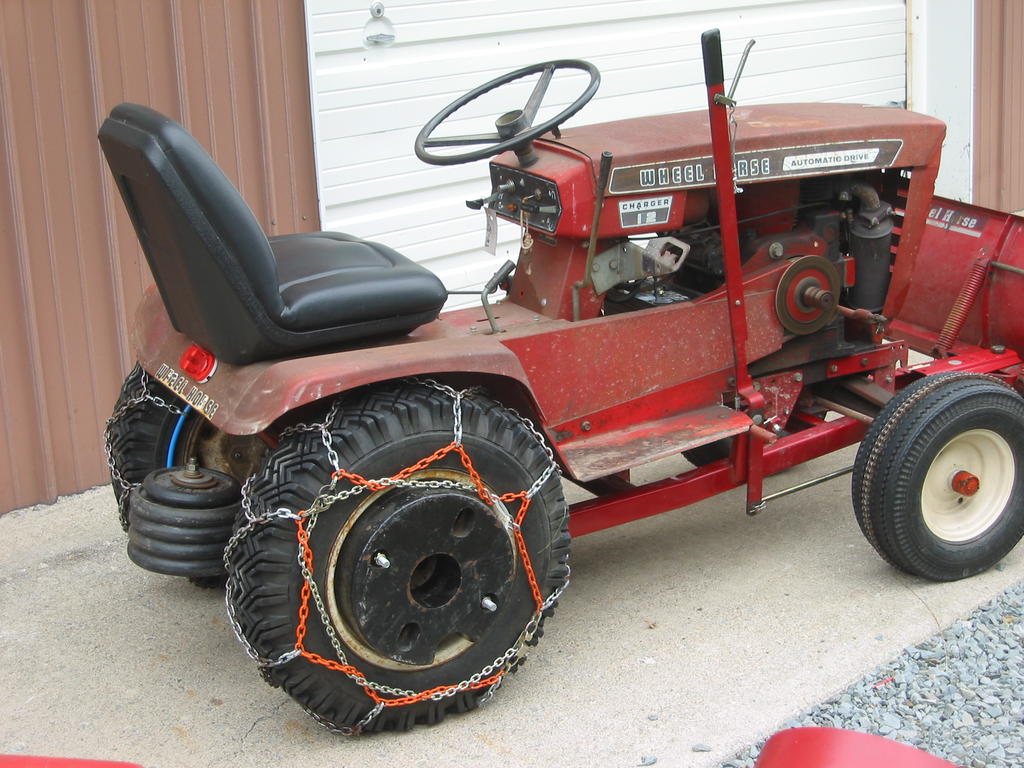

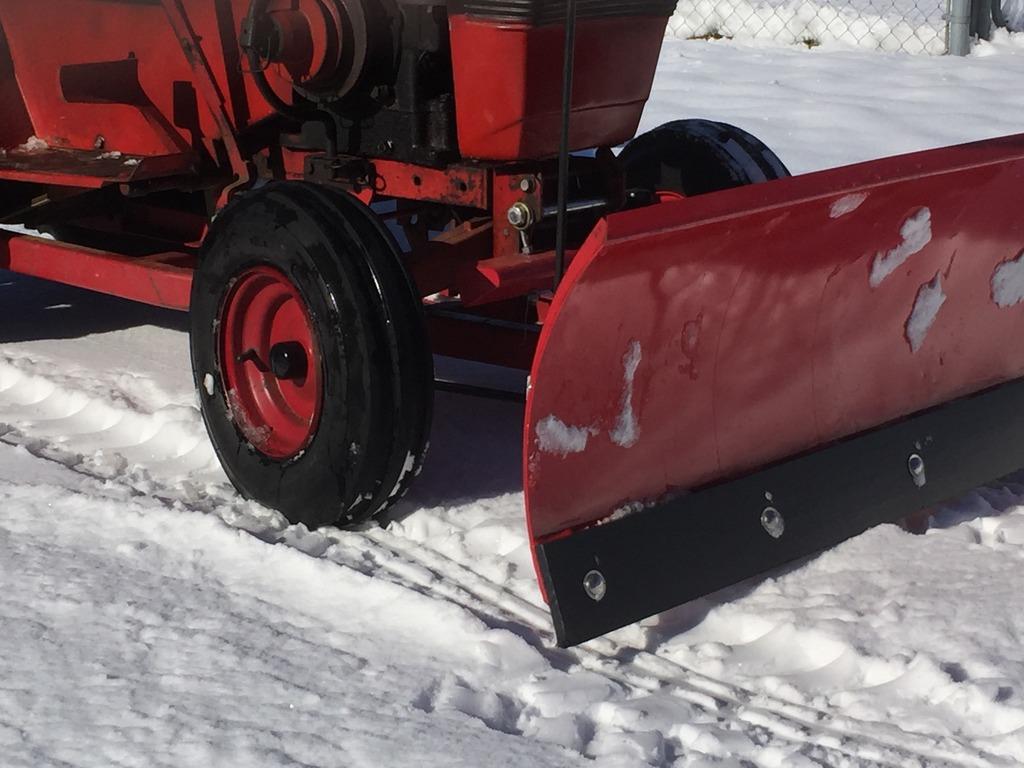

GlenPettit 1,719 #10 Posted January 9, 2018 (edited) I have tri-ribs on my snow-plowing tractor. On snow, they are excellent, on ice, not very good. There is 25# of Rim Guard in each tire plus a 25# lead bar hanging on the front (painted red in photo below); for a total of 75# of extra weight on the front, but with the blade down on ice, I do not have complete control, going straight is fine but with turns on the ice, I do slide sideways. I try to avoid ice and only have to suffer through it maybe twice each Winter (my 5th year with tri-ribs). On Snow, I really like the tri-ribs, and even with snow on the ice I've the tri-ribs do fine, but it's on the "pure glass ice" they are not good, that's where a chain is best. I have an asphalt drive, and don't want the marring from chains, that's also why I have the hard rubber scrapper on the blade. Do have 'Rubber Chains' on the rears of my snow-blowing tractor, over turf tires, and with bare tri-ribs on the front = same steering problem on ice. Glen Edited January 9, 2018 by GlenPettit 5 2 Share this post Link to post Share on other sites

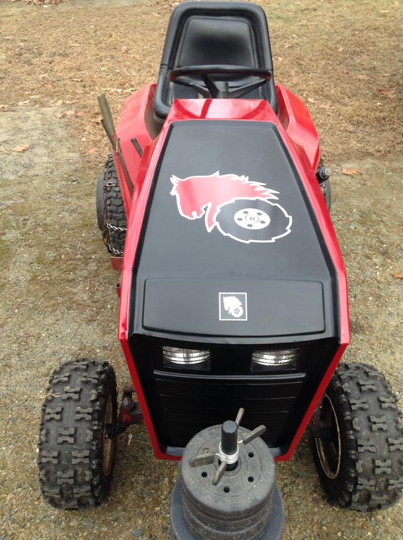

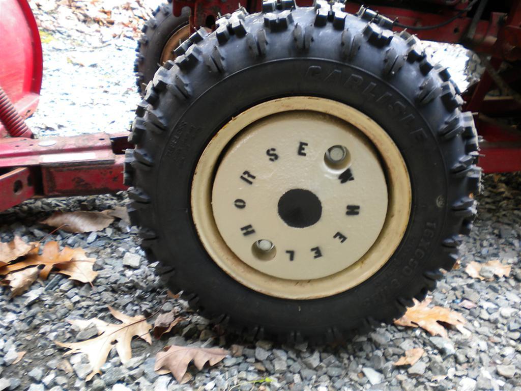

C-85 822 #17 Posted January 9, 2018 I put Carlise snow-hog tires on mine, and they really helped over the turf tires. But this is before I learned about the roller chain idea and had I know about that before, I think I would have tried that, that seems like it would be the best to make it steer! C-85 3 Share this post Link to post Share on other sites

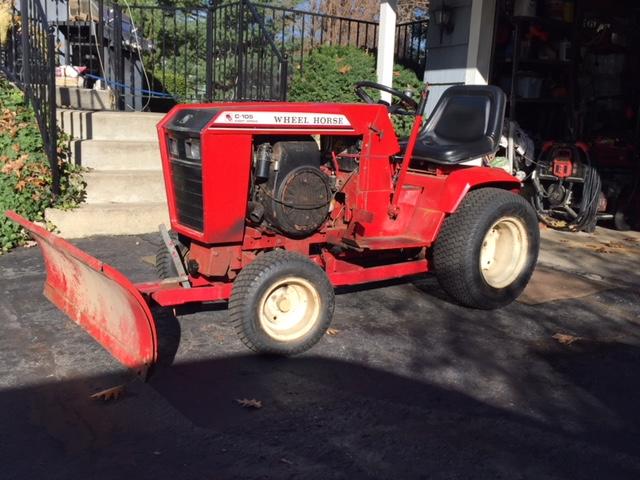

littleredrider 409 #20 Posted January 12, 2018 I have tri ribs on my 520 that I plow with. Even with the blade up, turning in the road with some snow, it does not turn. I have to slip the clutch or crawl in low gear to get it to turn. Tires are loaded, not sure of the weight, but doesn’t seem to help any. I think the chain will do the trick, just need to get some, find the time, and somewhere out of the weather to install em. No chains on the back, just plastic weights and firestone 23s.... 1 Share this post Link to post Share on other sites

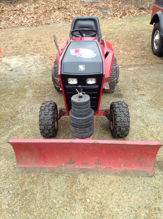

classicdmax 190 #24 Posted January 17, 2018 Well, for $59.70 for the pair I figured it would be worth the try. At the very least they look pretty cool, I’m sure their function in the snow will top the turf savers 5 Share this post Link to post Share on other sites
