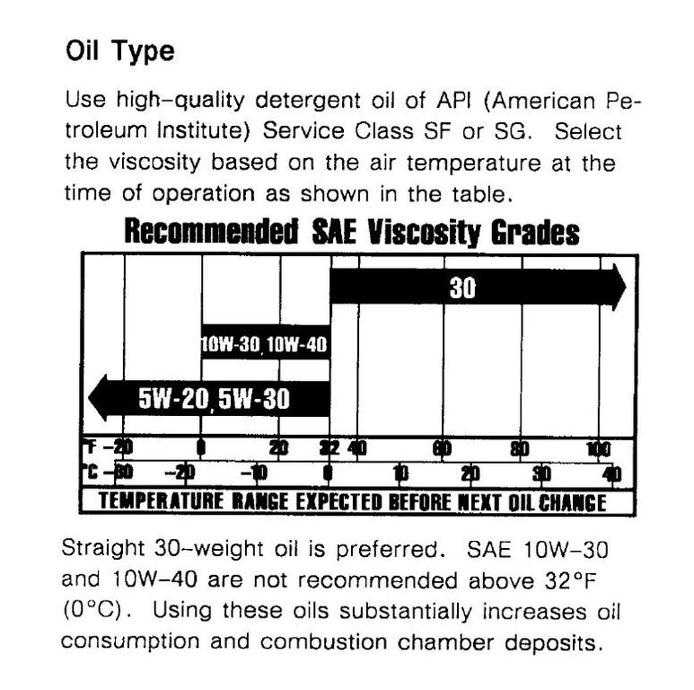

pfrederi
15 hours ago, Docwheelhorse said:
Here goes nothing... ---but--- straight 30 at 16 degrees is rough on the motor. Yes youve been getting away with it. Maybe think about 10w30 in winter and sae 30 in summer. Only 40 ounces to do full change.
Just my .02
Tony
:text-yeahthat:
From the Kohler manual
  • Excellent 1

Sarge
That is a very good point about the oil viscosity and is very commonly overlooked - Kohler printed those specifications for a reason. If you start and engine with even modern, high quality 30w oil you are causing damage to any splash lube engine quickly - you are starving the rod. 10W30 flows far easier in temps below 32* - you'd be surprised how much difference it makes in a splash lube engine. I use 10W30 Kohler engine oil in the winter, never had a rod problem other than previous damage from previous owners and just plain wear/abuse. I do not use a heater nor is the shed heated, some even sit outside under tarps and I'm not afraid to turn one over and start it well below zero. The D-180 and it's twin is pressurized, with 30W oil there is a long time gap before oil pressure shows at even 40*F, so in the winter it gets 10W30 and the oil pressure is instantly there when the engine starts spinning. Add to that the car battery that was added this fall - it spins over with no problem in super cold weather - started it yesterday at 12*F just as an example. I do like the idea of heating the oil first - that is always a good idea to prevent startup wear on any engine - always used to run block heaters on my older cars/trucks and never had a problem starting them in some crazy cold weather conditions while everything else around the area refused to start.
