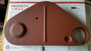

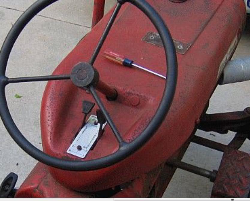

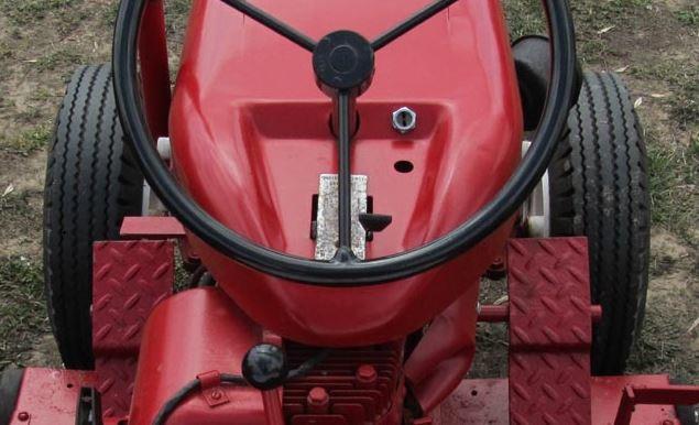

CasualObserver 3,417 #5 Posted January 6, 2018 Many of the 400s were made before the 550s... (400 production started in the fall of 1959, and the 550s weren't until December) No actual documentation supports any differences aside from the engine, and that on the 400 foot rests and toolbox/fenders were an add-on option. But observations of the past have shown that the early model 400s did not have a hole for an ignition switch in the hood, and did not have a reinforcing rib in the belt guard. After the 550s were in production though, they had those items, and the 400 received a knockout plug in the ignition hole. Some examples are listed below. early 400 belt guard common 400/550 belt guard (the cross line is a 1961 guard for those who wonder) early 400 hood (no plug) 400 hood (with plug) 550 hood with ignition switch (ignore 2nd hole, it's incorrect) 4 3 Share this post Link to post Share on other sites
