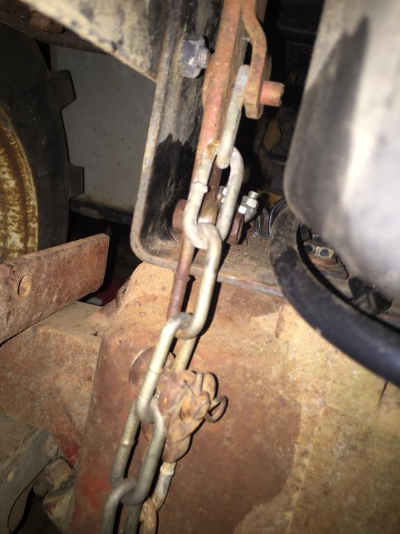

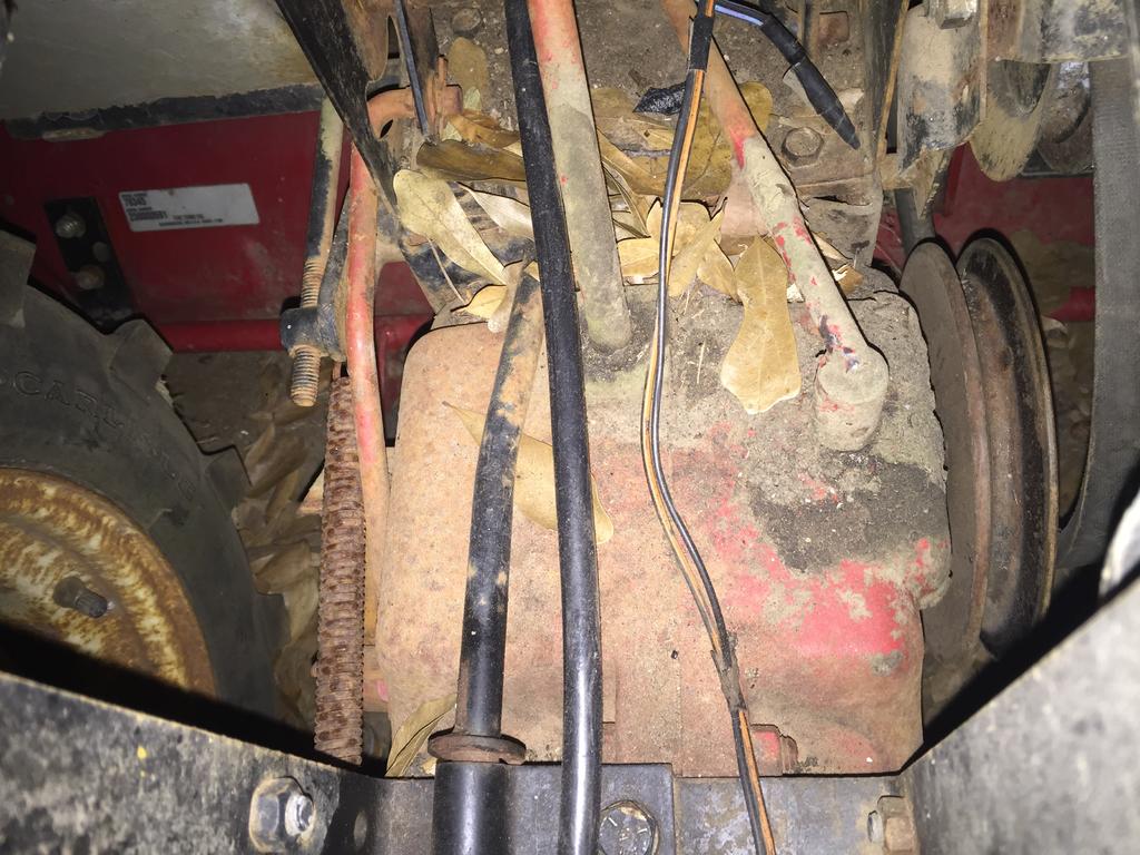

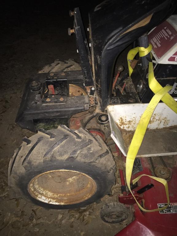

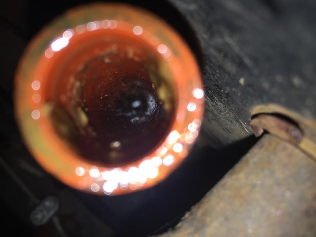

OneAmericanDude 3 #10 Posted January 2, 2018 19 minutes ago, 953 nut said: Lowell can fix you up. https://www.wheelhorsepartsandmore.com/transmissions.html#!/Wheel-horse-3577-shifter-boot/p/84932555/category=23548039 23 minutes ago, gwest_ca said: Water in the oil won't lock them up but if it sits idle the water will leave the oil and settle in the bottom. That's when ice will lock the differential to the case preventing the rear wheels from turning. Clear water will come out followed by the oil provided it is thawed out. Garry The first pic with the chain what does that do? Its a lever hooked to a cable that runs under the dash and I can't find it after that. I'm guessing the dipstick bent from ice? It wasn't bent this morning before I checked the rear end.... The oil is nasty but seperated from the water. No boot on the shifter and a look down the dipstick tube Share this post Link to post Share on other sites

gwest_ca-(File Mod) 12,478 #12 Posted January 2, 2018 The cable is part of the rear lift for attachments. Could be a tiller or anything that uses a slot or clevis hitch. Here is the clevis hitch. Click on the picture and again on the next page. Garry Share this post Link to post Share on other sites
