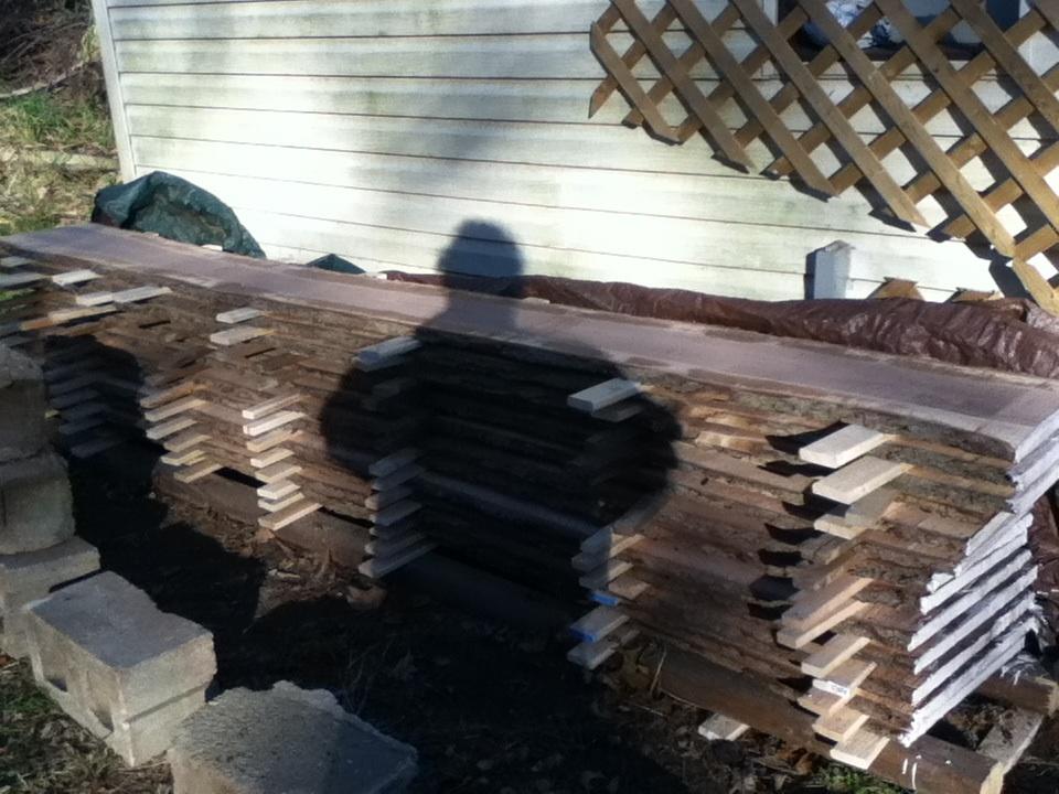

WNYPCRepair 1,924 #2 Posted January 1, 2018 Is that walnut? Share this post Link to post Share on other sites

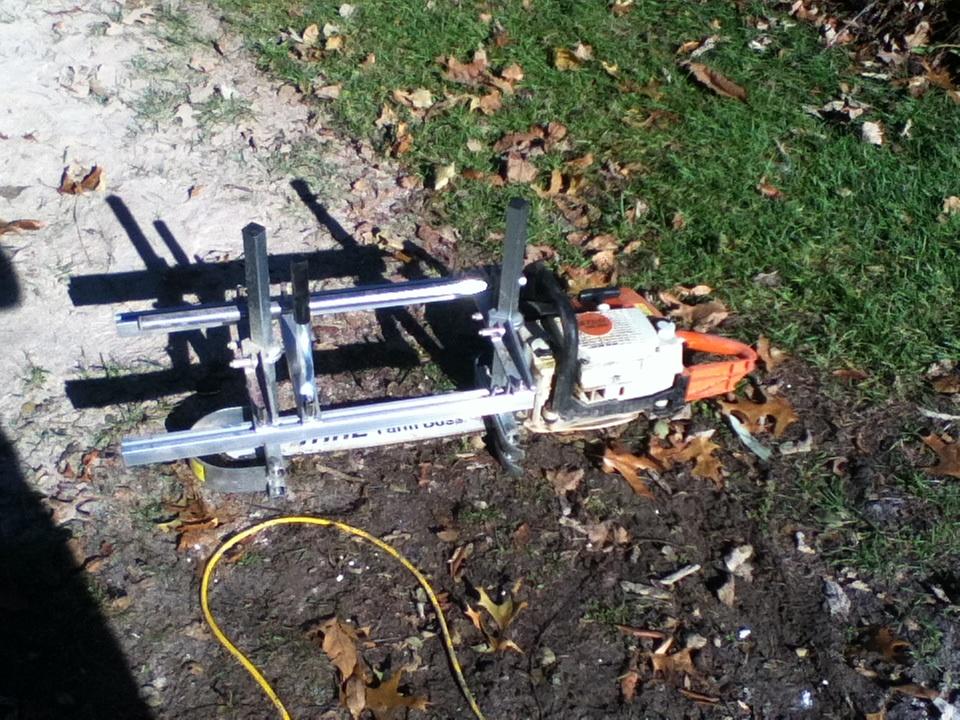

wallfish 20,718 #3 Posted January 1, 2018 NICE!!!! Does the chain need to be sharpened or modified a certain way to cut those long rip cuts? Share this post Link to post Share on other sites
Steiny 45 #4 Posted January 1, 2018 yes it is walnut. 5 minutes ago, wallfish said: NICE!!!! Does the chain need to be sharpened or modified a certain way to cut those long rip cuts? yes the chain has be mod to 10 degree angle or buy a ripping chain i ripp that stack of 26 planks 10'6" lg on one chain an hand sharpen one time 4 Share this post Link to post Share on other sites
Steiny 45 #5 Posted January 1, 2018 3 hours ago, wallfish said: NICE!!!! Does the chain need to be sharpened or modified a certain way to cut those long rip cuts? yes the chain has be mod to 10 degree angle or buy a ripping chain i ripp that stack of 26 planks 10'6" lg on one chain an hand sharpen one time im goin to mill black cherry this spring Share this post Link to post Share on other sites

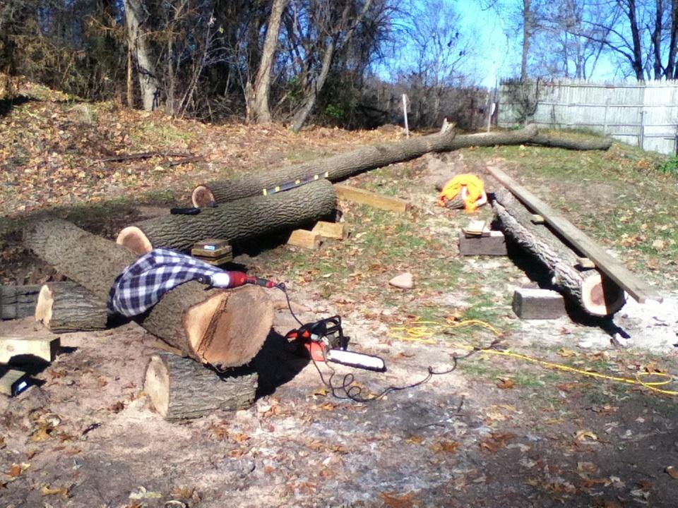

JAinVA 4,638 #6 Posted January 2, 2018 Just curious how long to cut that stack? Share this post Link to post Share on other sites
Steiny 45 #7 Posted January 2, 2018 that was five logs most of saturday an sunday with stilh 290 farmboss gave the saw time to cut would go a lot faster with bigger saw like to have band saw mill but have to build a pole barn limted on space Share this post Link to post Share on other sites
Forest Road 595 #8 Posted February 19, 2018 I really didn’t think a saw of that size would be very effective. I’m impressed! Looks good! Share this post Link to post Share on other sites
