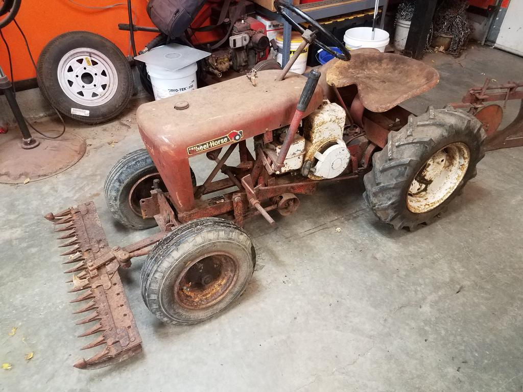

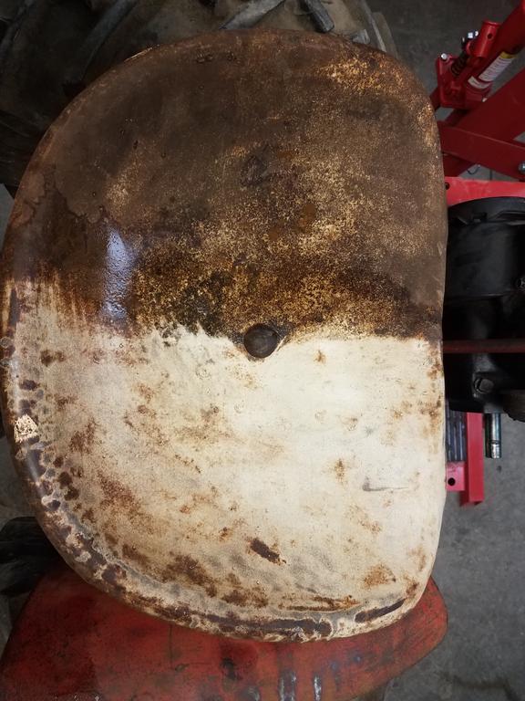

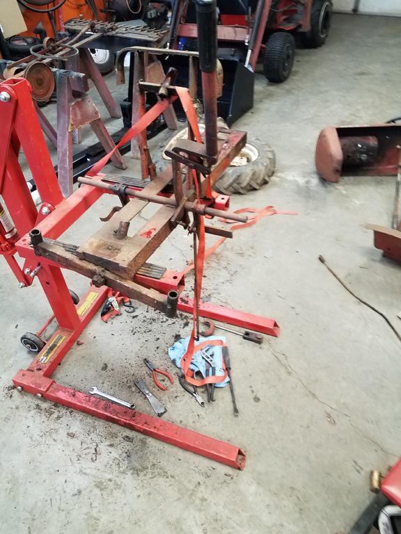

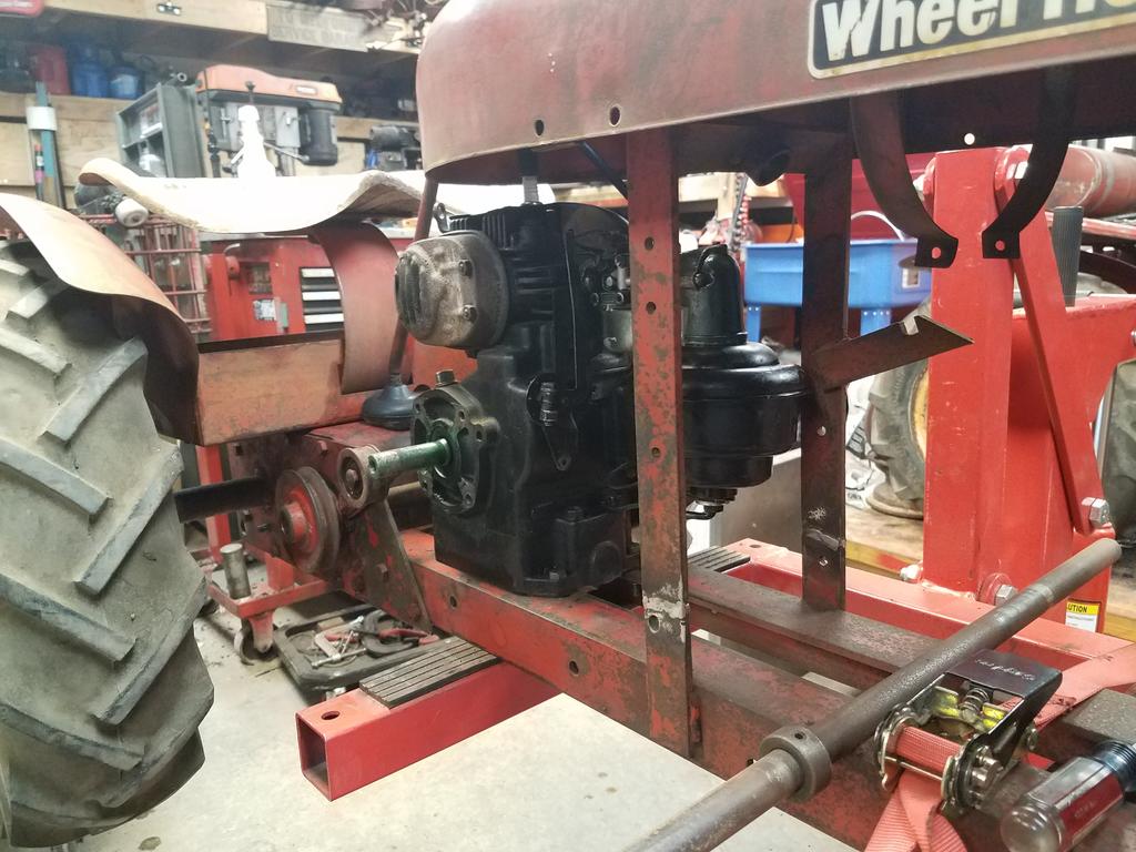

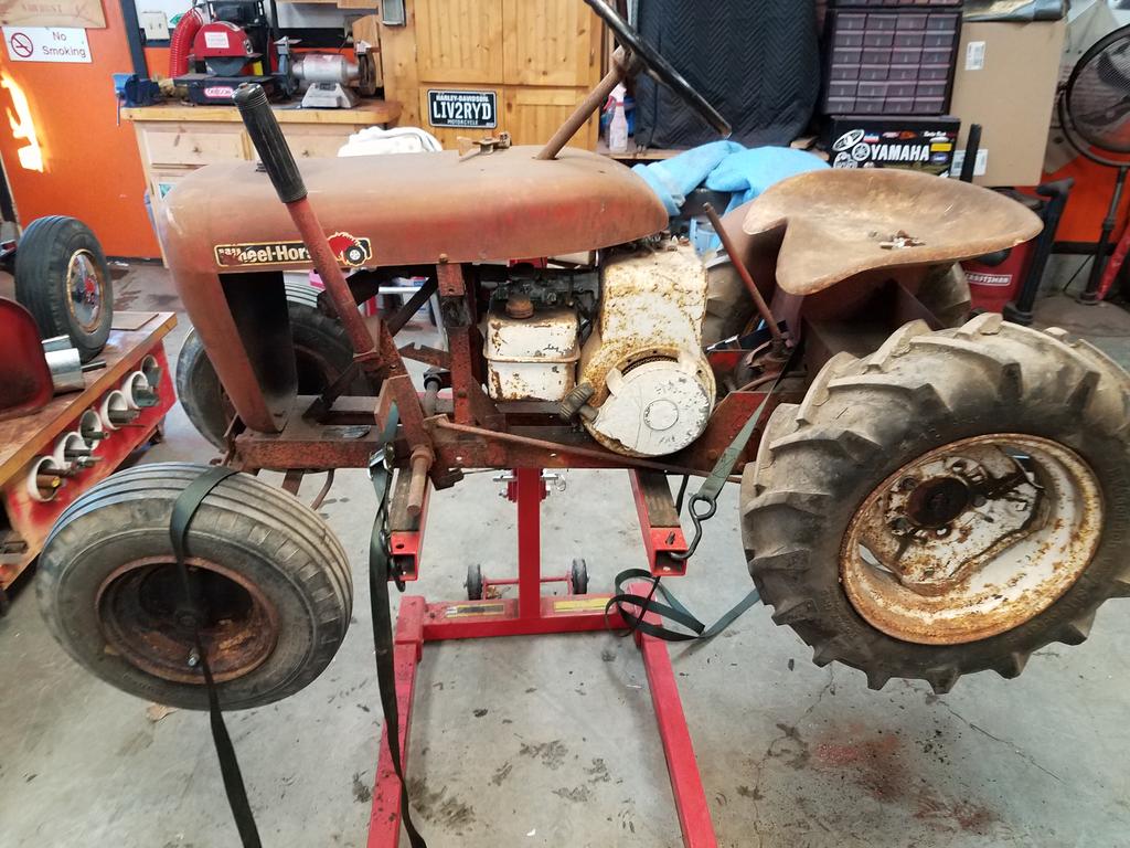

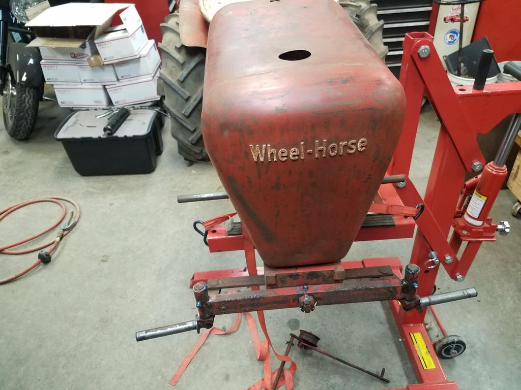

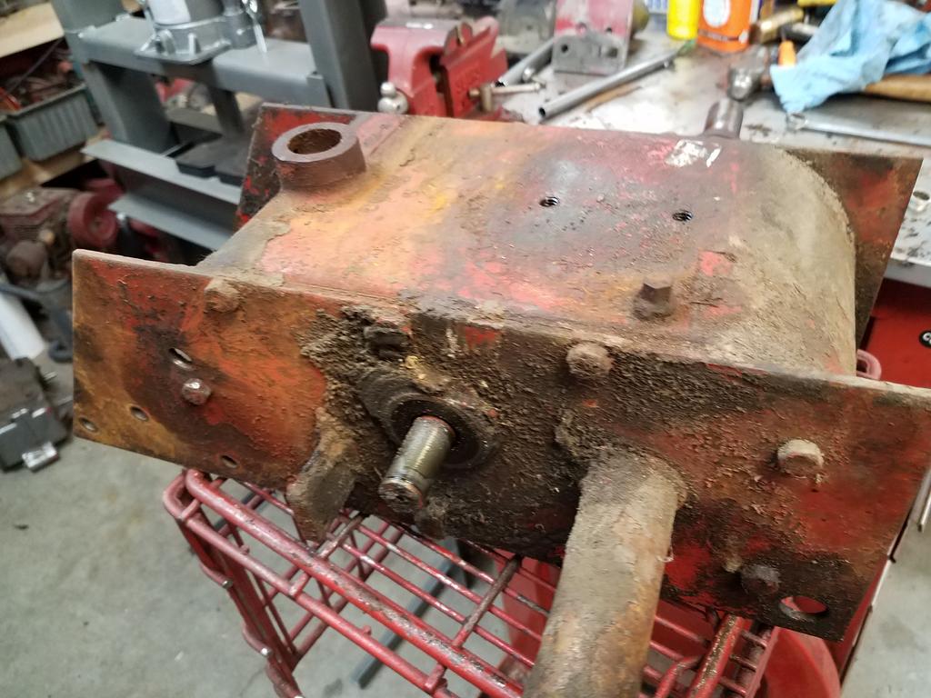

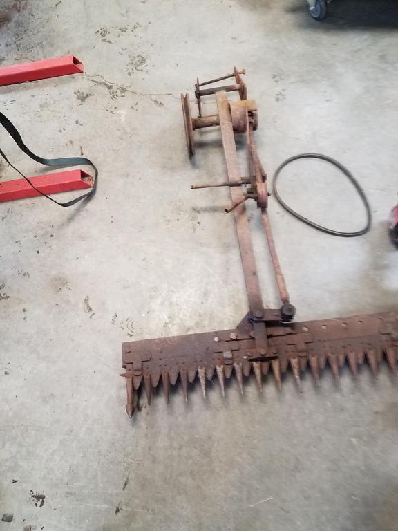

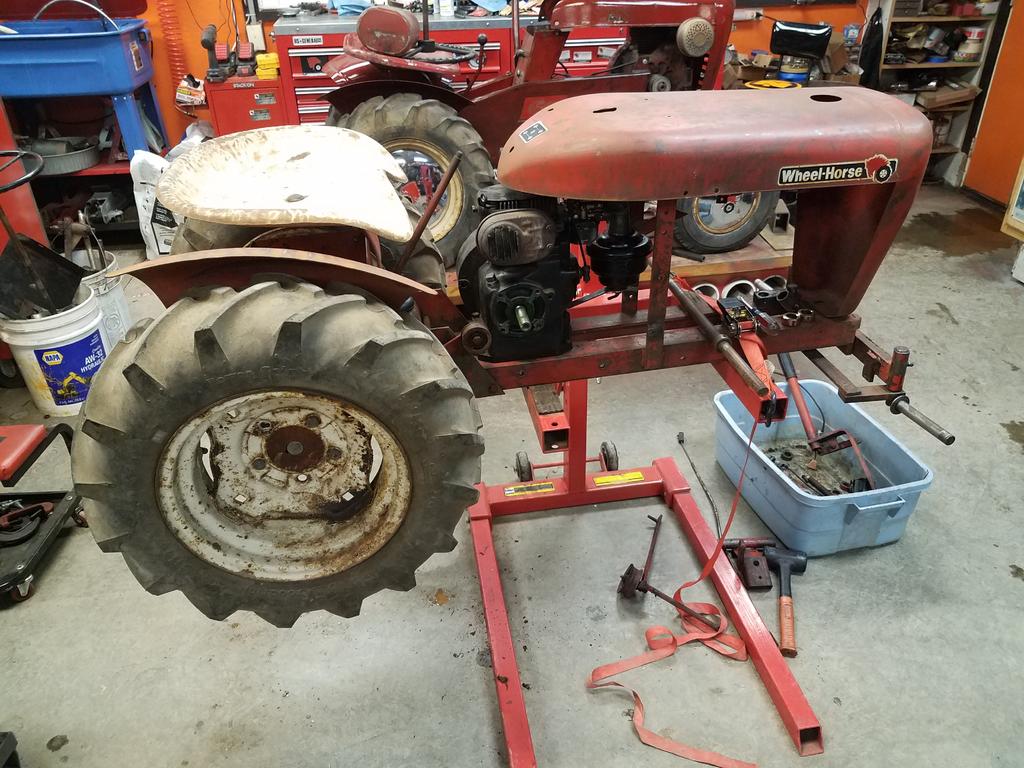

Shynon 7,543 #1 Posted December 31, 2017 Decided to pull the sickle mower off (tired of tripping on it). Well next thing you know I started another project. Pulled the Briggs. Had a hard time getting the steering apart then pulled the trans. Did a little wet sanding. Has some pretty nice red under the rust. 9 7 Share this post Link to post Share on other sites
953 nut 64,110 #2 Posted December 31, 2017 Looks like you are well beyond the point of no return. May as well do a full restoration! Love the motorcycle lift, saves the old back. 2 Share this post Link to post Share on other sites
Shynon 7,543 #3 Posted December 31, 2017 Just now, 953 nut said: full restoration Gonna be a clean up and oil up, gonna keep her original 10 Share this post Link to post Share on other sites
12 hp Kohler 1,020 #5 Posted December 31, 2017 48 minutes ago, Shynon said: Gonna be a clean up and oil up, gonna keep her original Good idea, once you sanded the frame a little it really brought out a nice patina. 1 1 Share this post Link to post Share on other sites
stevebo-(Moderator) 8,604 #6 Posted December 31, 2017 That is what I call a "proper" re fresh. Love the look for sure. 1 1 Share this post Link to post Share on other sites

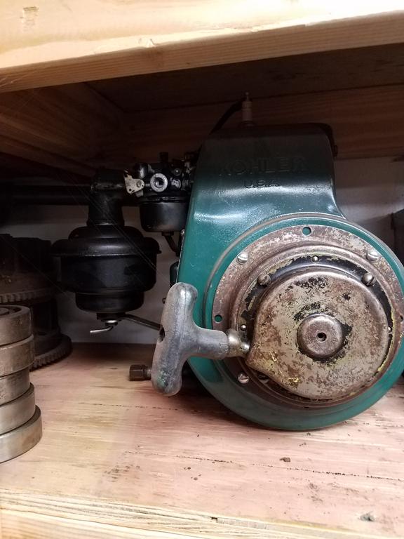

WHX?? 54,961 #7 Posted December 31, 2017 Nice Tom I'm sure you'll do it justice. Any thoughts on looking for a 90 or 91 for it? 1 Share this post Link to post Share on other sites
Shynon 7,543 #8 Posted December 31, 2017 I have a couple choices 8 4 Share this post Link to post Share on other sites

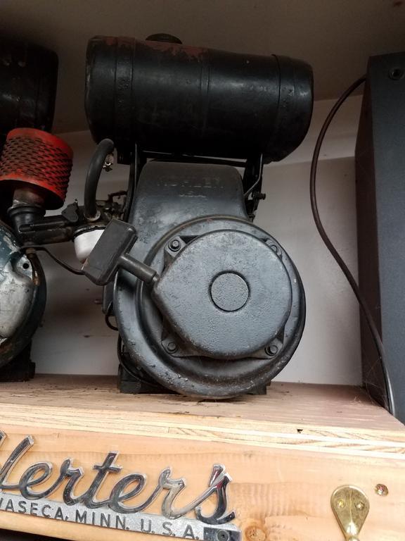

Achto 30,997 #9 Posted December 31, 2017 19 hours ago, Shynon said: I'm diggin' the Schnacke starter & oil bath air cleaner on this one!! 3 2 Share this post Link to post Share on other sites
953 nut 64,110 #10 Posted December 31, 2017 19 minutes ago, Achto said: diggin' the Schnacke starter & oil bath air cleaner 4 Share this post Link to post Share on other sites

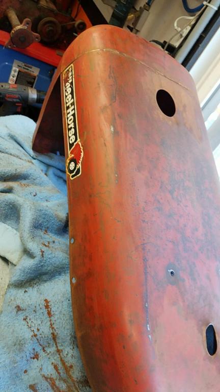

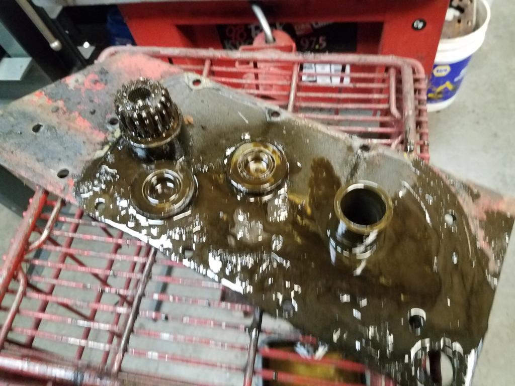

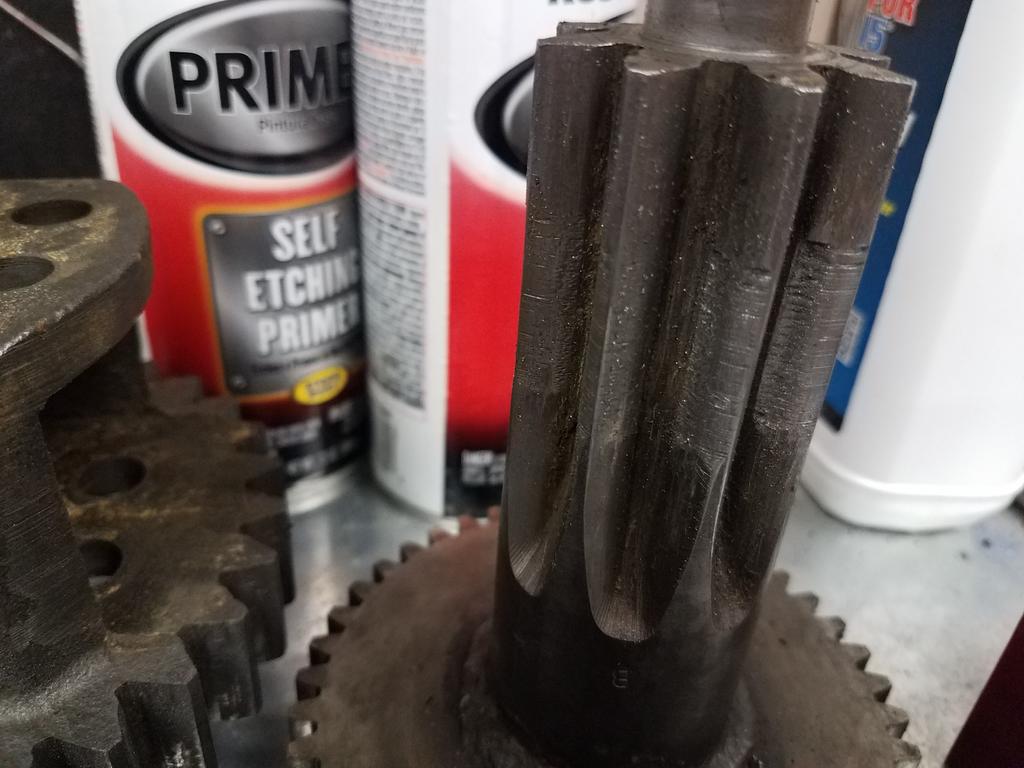

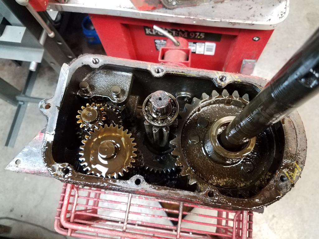

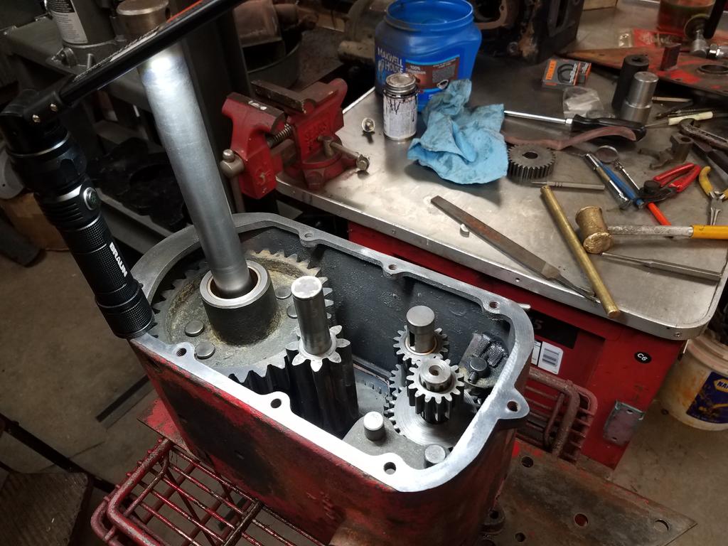

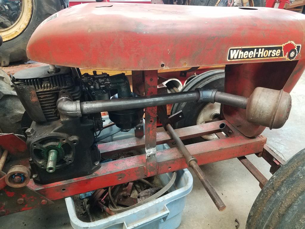

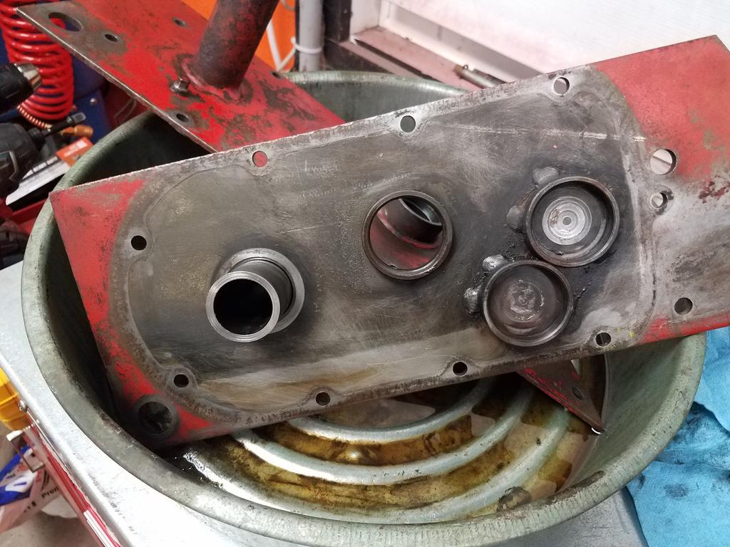

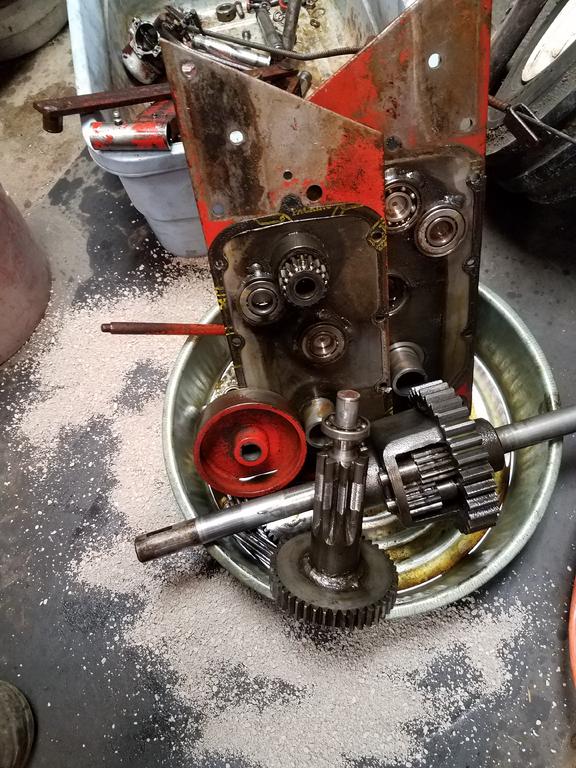

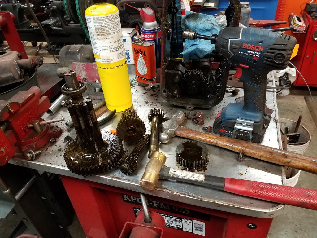

Shynon 7,543 #12 Posted January 1, 2018 Got some more done today. WOW the hood just pops. Cleaned up the front axle and spindles. Pulled the trans apart. Got a rusted shift fork, gears look pretty good, mushroom gear is worn. 1 hour ago, WHX14 said: Dan's got a good patina recipe 6 Share this post Link to post Share on other sites
jimkemp 528 #13 Posted January 1, 2018 The gear box is my biggest worry on the one I'm doing , I hope mine looks as good as yours does on the inside , Good luck with your project , Looking good 1 Share this post Link to post Share on other sites

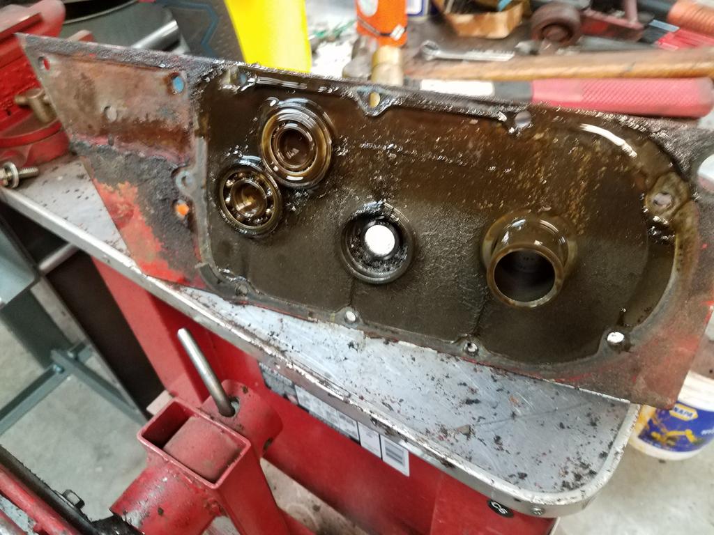

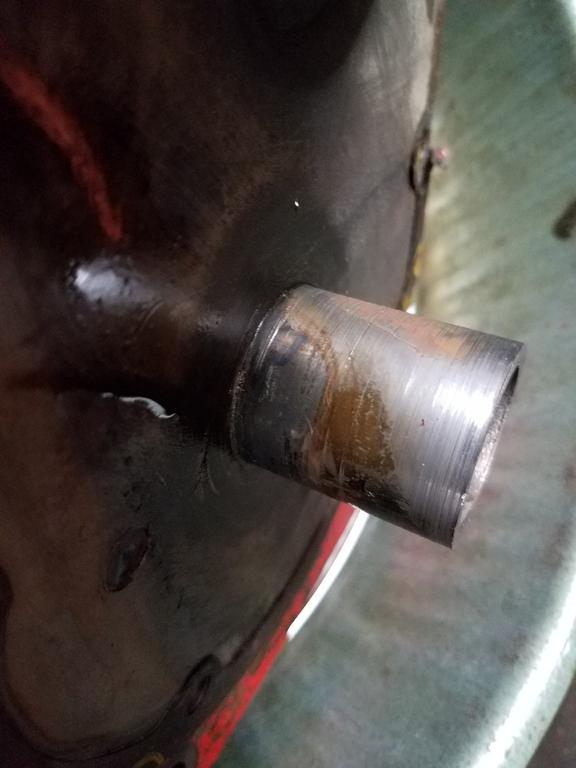

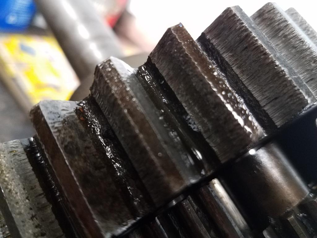

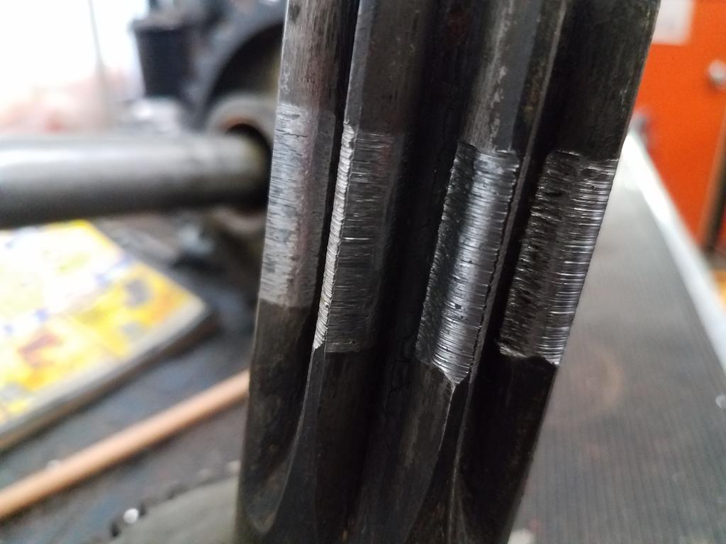

Shynon 7,543 #15 Posted January 16, 2018 (edited) Got the trans all cleaned up. Knocked out the bearings and bushings, axle bushings had little wear. Mushroom gear and diff gear a little worn. Smoothed them out a little with a file as they are going back in. Edited January 16, 2018 by Shynon 8 6 Share this post Link to post Share on other sites

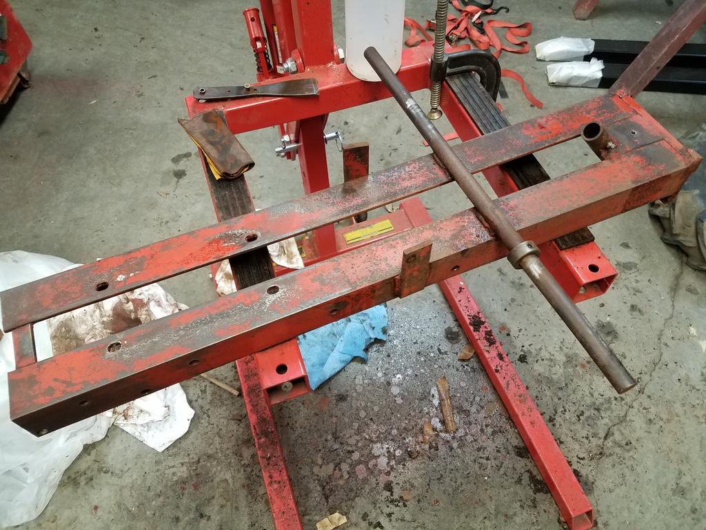

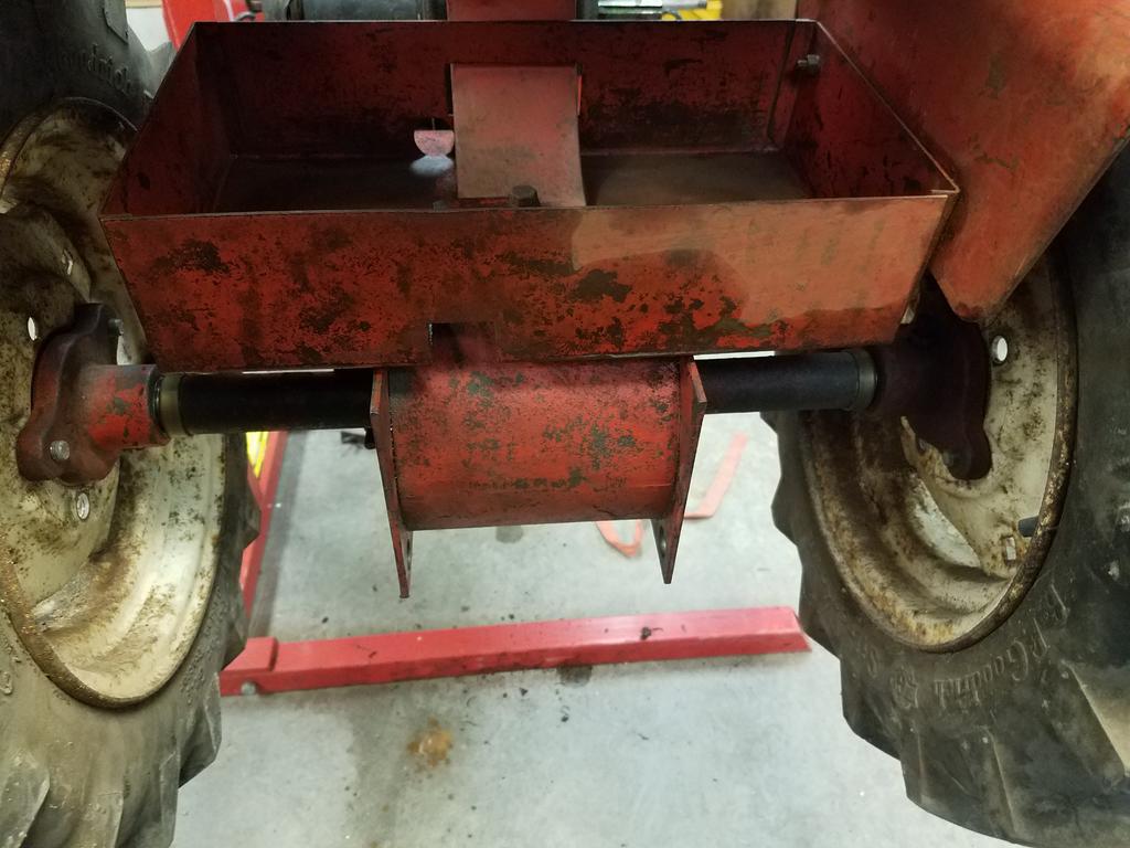

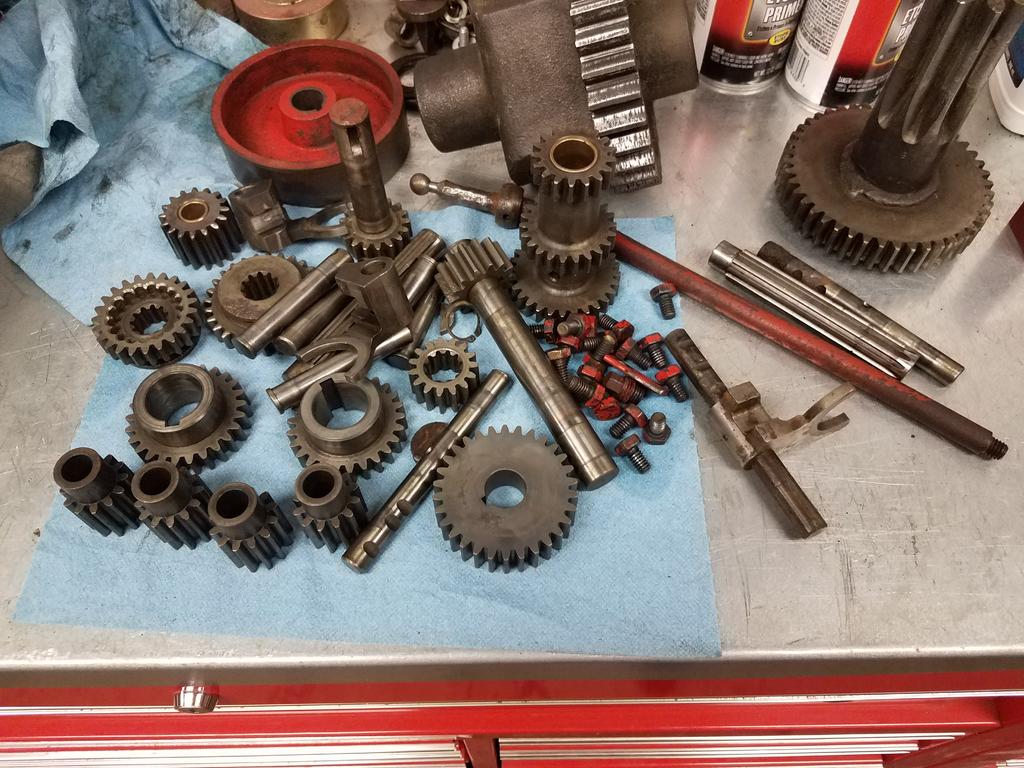

Shynon 7,543 #21 Posted February 18, 2018 Trans all buttoned up, new bearings bushings and seals, flipped the axles . Pretty tight but it all turns properly. Bolted up to the frame, dropped on the power. Did some more wetsanding. 6 Share this post Link to post Share on other sites

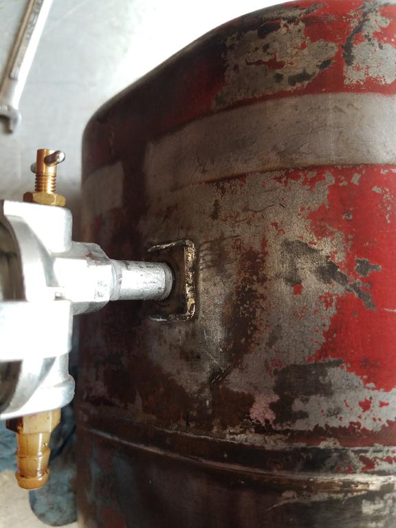

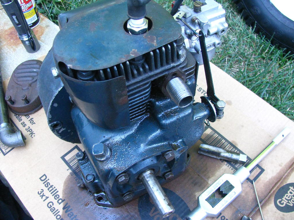

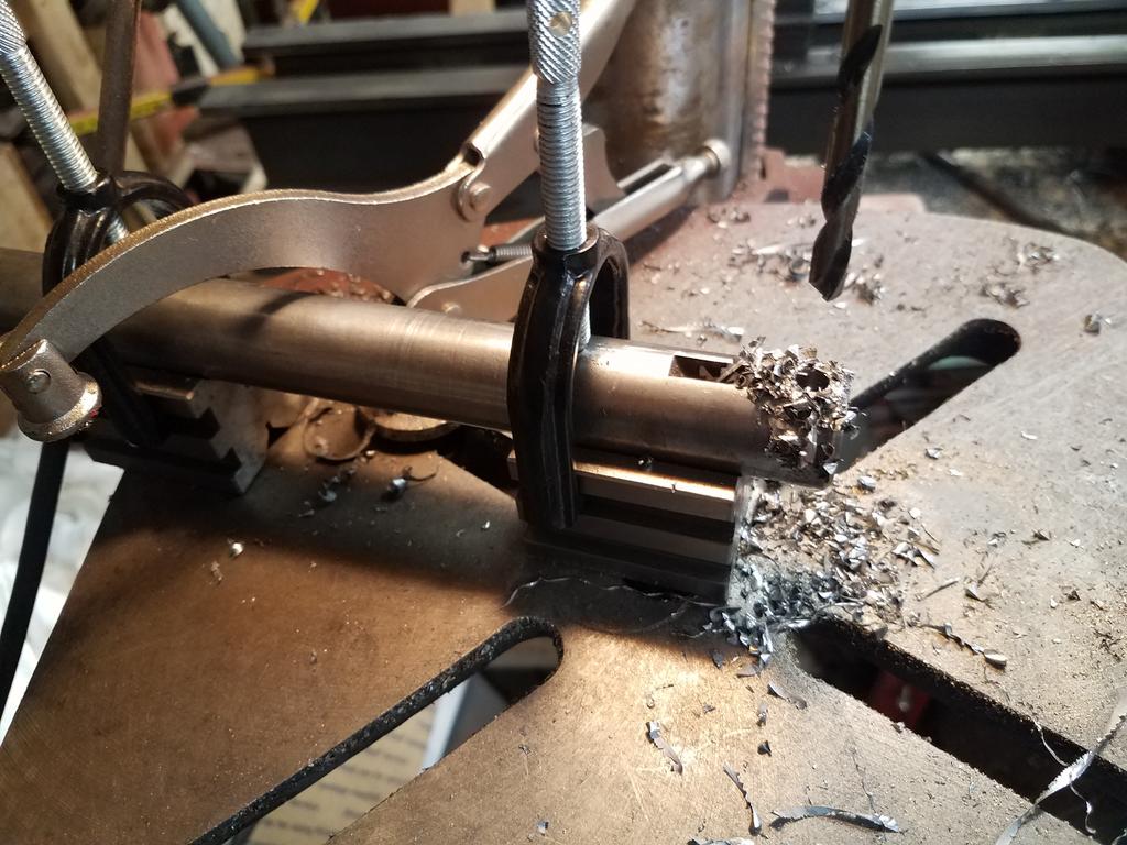

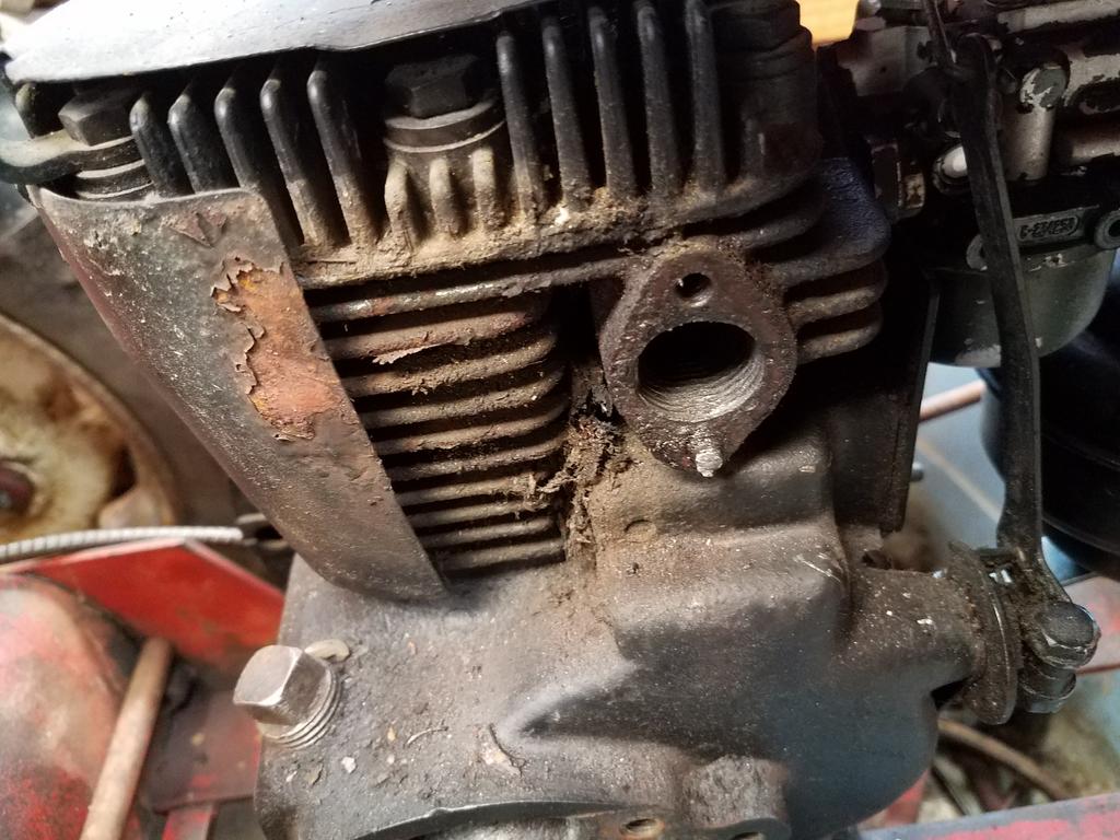

Shynon 7,543 #25 Posted March 18, 2018 (edited) Had some time today, soldered in the threaded insert for the fuel bowl. Threaded the block for exhaust. Edited March 18, 2018 by Shynon 6 3 Share this post Link to post Share on other sites
