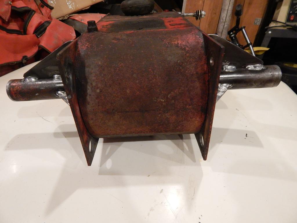

Achto 31,528 #10 Posted December 27, 2017 (edited) Given the the machine in question ( '60 Suburban ) I would definitely say wheel weights only. You need to take into consideration that the axle tubes are only welded to the thin side plates on the transmission. Just running 23-10.50 x 12 tires alone, no added weight ( other than my butt ) on my Suburban caused the rear axle tubes to sag. The welds even started to crack around the tubes. When I rebuilt my tranny the last time I added gussets to keep this from happening again. If it were a '61 Suburban with a 2 piece trans, then a weight box might be an option. Edited December 27, 2017 by Achto 8 1 Share this post Link to post Share on other sites
