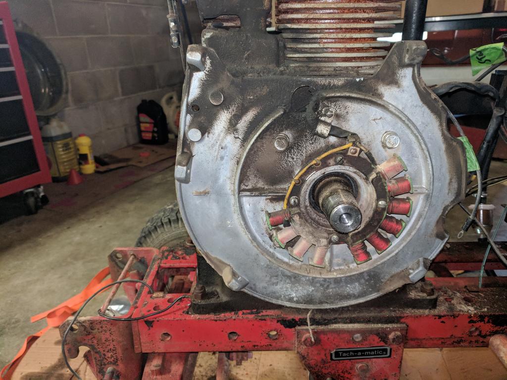

Busman 14 #1 Posted December 26, 2017 I've got an 85 314-A with a kolher k321s. I am rebuilding the engine and trying to figure out if this is the right stator. I was not getting any AC headlights and it wouldn't charge well before I took it apart. Share this post Link to post Share on other sites
Aldon 4,826 #2 Posted December 26, 2017 Looks like your missing some of the statir windings. They should be around the entire 360 degrees. Share this post Link to post Share on other sites
gwest_ca-(File Mod) 10,488 #3 Posted December 26, 2017 This one should have the 3 amp charging system with a diode in the stator output to charge the battery and a 2nd stator producing AC current to power the lights only. I don't know what they look like but you do have 2 outputs. Find the connector where those 2 wires plug into the tractor wiring and pull that connector apart. Stick an ohmmeter to the 2 terminals and see if you have continuity. Then reverse the leads and try again. One way you should have it and the other way you should not. One of those terminals is connected to a diode and the diode to the wire. Feel the tape wrapped around the diode to locate it. The body of the diode is likely about 3/16" in diameter and 3/8" long. Not much else you can do to test without have the flywheel back on and the engine running. Does it look like any of the magnets are missing inside the flywheel? Garry 2 Share this post Link to post Share on other sites
Busman 14 #4 Posted December 26, 2017 22 minutes ago, gwest_ca said: This one should have the 3 amp charging system with a diode in the stator output to charge the battery and a 2nd stator producing AC current to power the lights only. I don't know what they look like but you do have 2 outputs. Thanks for the reply. So are you saying I am missing a part of the stator winding? The magnets are in tact and in good shape. Share this post Link to post Share on other sites
gwest_ca-(File Mod) 10,488 #5 Posted December 26, 2017 This is the manual you need On page 8.10 and 8.11 the test procedure is listed. There is a black lead and a yellow lead shown so think you have everything. There are some resistance measurements you can take with the flywheel off and the expected results are in the manual. If you don't understand let us know and we will explain. Garry 2 Share this post Link to post Share on other sites
Busman 14 #6 Posted December 26, 2017 Awesome this helps thank you. Share this post Link to post Share on other sites

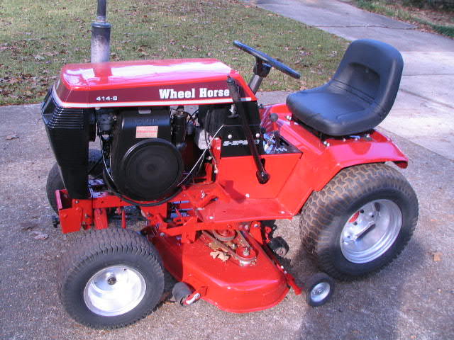

pacer 3,159 #16 Posted December 27, 2017 (edited) I just finished a refurb on a 414-8 with a K-341 (non-magnum) that had this 3 amp stator set-up. When I saw it I was as flummoxed as yall, but - as usual - Garry straightened me out. The wiring was a nightmare on the tractor and what with the maze of safety features it had, that would be almost impossible to to get corrected - I just ripped all the original wiring out and went back with a simple start-run-stop wiring. To help with this change over I had a K241 sitting on the bench and a quick inspection showed that the 15 amp stator/flywheel would change over to the K341 (the flywheels would NOT interchange) With that and a different regulator the wiring was quickly done! Edited December 27, 2017 by pacer add picture 1 Share this post Link to post Share on other sites
Busman 14 #17 Posted December 27, 2017 55 minutes ago, pacer said: I just finished a refurb on a 414-8 with a K-341 (non-magnum) that had this 3 amp stator set-up. When I saw it I was as flummoxed as yall, but - as usual - Garry straightened me out. The wiring was a nightmare on the tractor and what with the maze of safety features it had, that would be almost impossible to to get corrected - I just ripped all the original wiring out and went back with a simple start-run-stop wiring. To help with this change over I had a K241 sitting on the bench and a quick inspection showed that the 15 amp stator/flywheel would change over to the K341 (the flywheels would NOT interchange) With that and a different regulator the wiring was quickly done! Good to know, thanks for the feedback. I guess I was mostly surprised because when I opened it up it almost looked broken. There are hardly any pictures of this stator on the internet. I'm going to clean up all of the connections and check the diode to make sure it's in good shape. If everything checks out I'm going to put it back together. Hopefully tonight I can get the rest of the block pulled apart and measured for the Machine Shop. Share this post Link to post Share on other sites
