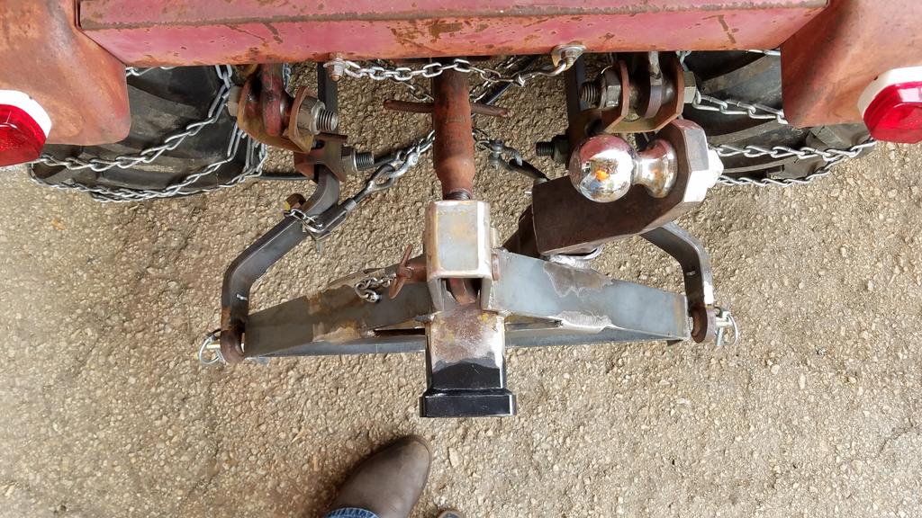

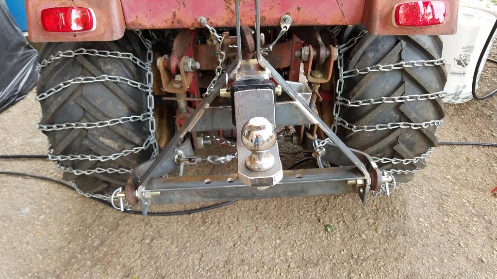

Sarge 3,473 #3 Posted December 28, 2017 I use the 3pt and set the chains fairly tight to keep it from swaying into the tire's chains - made my own A frame but even pre-built ones are fairly cheap . Plan to build another design for a sort of small equipment wrecker to lift dead machines by their wheels with a swivel plate and adjustable yokes for different tire sizes - like what is used on the highways , just smaller ... Sarge 1 Share this post Link to post Share on other sites
Seacrestbf 8 #4 Posted December 30, 2017 That looks great, the design is very sturdy. The height is nice for trailers, nice touch on the holder for the hitch, it will save your shins. Do you build and sell these? Thank you Share this post Link to post Share on other sites
Sarge 3,473 #5 Posted December 30, 2017 No , I don't sell them - it was just one I whipped up in an afternoon to use the D to work on a shed project as basically a wrecker , the shed fell off it's blocking with no floor under it from a storm . There are a ton of these A-frames out there , you could just buy a cheap one and modify it to suit your needs easily or prep the parts , mark where you want them and have a welding shop nail them together cheaply . I guess I could make some copies but it wouldn't be until decent weather here . Sarge 1 Share this post Link to post Share on other sites
Seacrestbf 8 #6 Posted December 31, 2017 9 hours ago, Sarge said: No , I don't sell them - it was just one I whipped up in an afternoon to use the D to work on a shed project as basically a wrecker , the shed fell off it's blocking with no floor under it from a storm . There are a ton of these A-frames out there , you could just buy a cheap one and modify it to suit your needs easily or prep the parts , mark where you want them and have a welding shop nail them together cheaply . I guess I could make some copies but it wouldn't be until decent weather here . Sarge Thank you, Thank you, I will use your as a guide. Thank for the help. Brian 1 Share this post Link to post Share on other sites
Sarge 3,473 #7 Posted December 31, 2017 Just make certain you place the hitch holder square box with enough clearance to the rear panel by the fuel tank - I dented mine pretty good on the first test and had to move it . It would almost work better if it were horizontal instead of vertical . I think I set the holes on the cross bar at 2" centers , it's all 1/4" steel . The short weld-on hitch receivers are available at farm stores and some truck suppliers . I need to add a pair of weld on hooks to the side bars for towing yet , not until spring this year - too cold out and no garage . Sarge 1 Share this post Link to post Share on other sites
