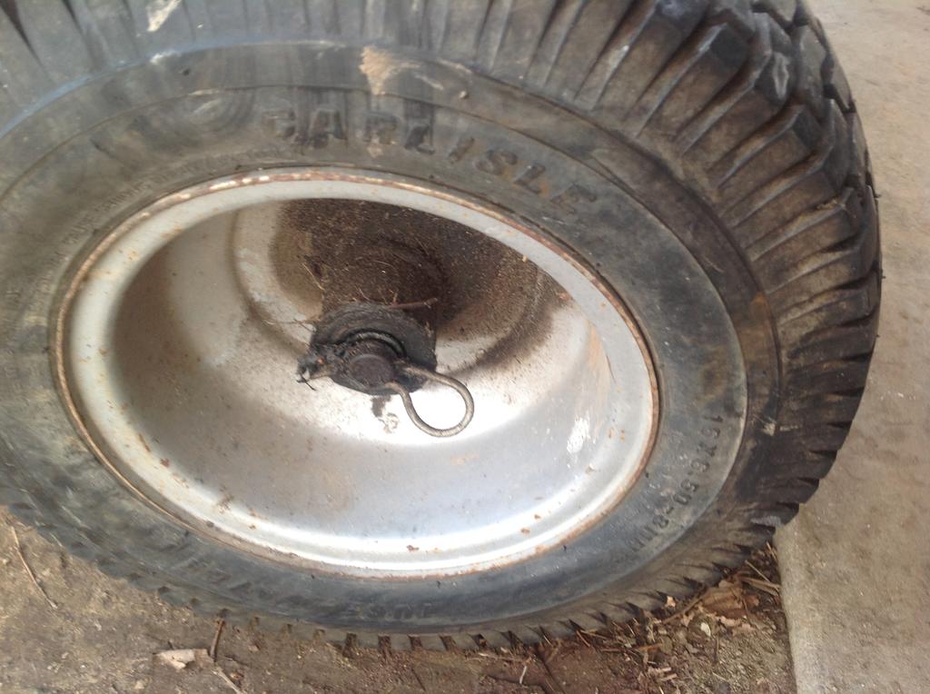

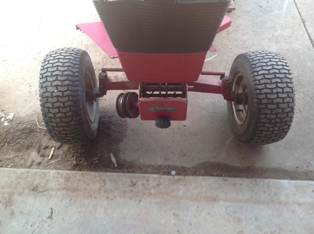

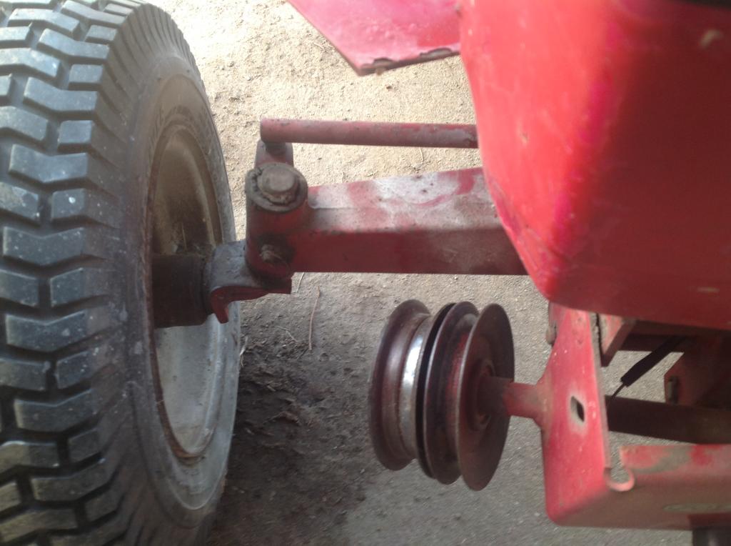

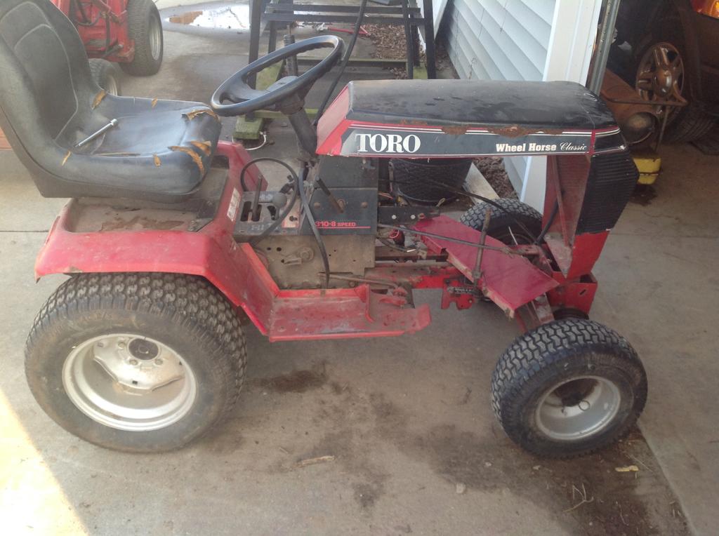

Adams94 1,071 #1 Posted December 24, 2017 I got this 310-8 when I bought my loader and I'm parting it out, I have noticed it appears to have bigger front wheels than the other 310-8s i found pictures of. Did the previous owner install the heavy duty spindle kit for loaders? How do you tell? Thanks Share this post Link to post Share on other sites
gwest_ca-(File Mod) 12,281 #2 Posted December 24, 2017 Here is one of the kits that were available. The angle at the bend in the spindle identifies it as HD. Click on the picture. Garry Share this post Link to post Share on other sites
roadapples 6,987 #3 Posted December 24, 2017 Those spindles have the braces Like the loaders call for... Share this post Link to post Share on other sites
953 nut 66,616 #4 Posted December 24, 2017 Probably came from a 400 or 500 series that have 8" wheels. Share this post Link to post Share on other sites
Adams94 1,071 #5 Posted December 24, 2017 41 minutes ago, gwest_ca said: Here is one of the kits that were available. The angle at the bend in the spindle identifies it as HD. Click on the picture. Garry Thanks! 40 minutes ago, roadapples said: Those spindles have the braces Like the loaders call for... Thanks 36 minutes ago, 953 nut said: Probably came from a 400 or 500 series that have 8" wheels. Thanks guys maybe I will keep the front end around 3 Share this post Link to post Share on other sites

ericj 1,580 #11 Posted December 24, 2017 12 hours ago, gwest_ca said: Some kits I believe included stronger rear axles as well. Garry I was told by my dealer friend that wheel horse / Toro offered a heavy duty axle for the 520's for use on loader tractors, I believe he said that they where hardened steel. I had heard of the heavy duty front axles for the loader for sometime now, I had heard about them I believe even before I bought my 416-8 from Wild Bill several years ago at the big show with my 2 stage blower attached to it. Bill had installed a brand new kit on the tractor when he installed the blower. I removed the blower but the kit is still on the 416-8. I believe that mine has 3/4" spindle through the axle, but 1" spindle axle for the tires and heavy roller bearings but not the jam nut just a cotter pin or hair pin clip. I know that the dust cap is bigger that the standard cap eric j 2 Share this post Link to post Share on other sites
wallfish 20,050 #12 Posted December 24, 2017 Both of mine are just 3/4 spindles with the support brace added. The rims are different and accept a larger wheel bearing. The HD spindles also came factory on the 418-C. 4 Share this post Link to post Share on other sites
Adams94 1,071 #13 Posted December 24, 2017 2 hours ago, ericj said: I was told by my dealer friend that wheel horse / Toro offered a heavy duty axle for the 520's for use on loader tractors, I believe he said that they where hardened steel. I had heard of the heavy duty front axles for the loader for sometime now, I had heard about them I believe even before I bought my 416-8 from Wild Bill several years ago at the big show with my 2 stage blower attached to it. Bill had installed a brand new kit on the tractor when he installed the blower. I removed the blower but the kit is still on the 416-8. I believe that mine has 3/4" spindle through the axle, but 1" spindle axle for the tires and heavy roller bearings but not the jam nut just a cotter pin or hair pin clip. I know that the dust cap is bigger that the standard cap eric j Thanks guys! 1 Share this post Link to post Share on other sites
